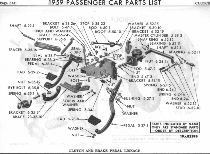

Mike, here's an explosion diagram of the clutch. Can you identify from this diagram the part you need?
Guest
Post by Guest »
sorry, computer died. is that a '59 manual?? it looks more like my buddys '54 setup (my clutch pedal "hangs" from under the dash instead of sticking out of the floorboards). I don't see what i need on there... were the linkages the same if that's and older drawing? If i had to make an educated guess i'd say my part would go in place of bracket (6-53-5) and bearing (6-52-11). Mike

Posts: 5172
Oops, quite right. The pic I originally posted was for a truck! Sorry 'bout that. I've fixed the post with the correct picture.

Post by forwardlooklunatic »
lol it's ok. the part i need is "stud" 6-52-10.

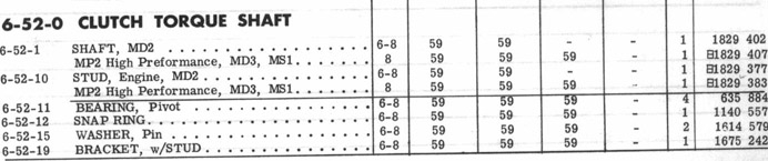

Posts: 5172
OK -- those are catalog numbers that are listed. When I get home tonight, I'll look up the part number -- then there are places we can check for the part.
BTW, this looks the same as the part on my old '55 with standard trans. I still have that parts book, I'll compare the numbers. The guy I sold the car to may still have that part -- I'll ask.
BTW2 -- when I redid my clutch, I replaced those bushings on both ends with Teflon ones. You can get them from Andy Bernbaum.
Posts: 5172
OK, here's what I know: The part is definitely a new part for '59. It does not cross check with the '55 part I could get my hands on.
Furthermore, there are two parts. Here's how it's listed in the book for Plymouths:
(The funny symbol in front of the "1829" denotes that the part has not appeared in any previous parts book.)
Now, Mike has a 318 -- but I don't know if it is a V-800 (or, even if it was available in the Savoy) -- the special power pack for the 318. Is that considered high performance? Or, is only the Golden Commando high performance?
I don't know. But, the answer to that question will determine which part Mike needs, and then we can figure out where to get it. I'm going to send a note to Ed Eckerson, he will undoubtably know.
i would not consider the v-800 (2 bbl) to be high performance, and i doubt anyone else would either, the reason being i'm not that lucky or rich!! however, i did install a 4-bbl intake and carb so maybe the torque is too much and snapped it?? i doubt that either, but something to consider... the car still has single exhaust.
