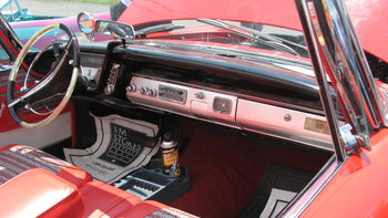

Saw this car listed for auction in today's Hemmings. This is the car Tom White, well known restorer, picked up at Carlisle in 2007 and redid it a bit... but much of it remains as it was, including the oddities of no dash pad, and brake and accelerator pedals have the pattern of an LA - built car, event though this is an Evansville car. It has a high serial number, in the "106XXX" series, don't know if there is documentation showing it's build date but is likely June or July 1959... just for us curiosity seekers as we have discussed these things in the past.

Well, no dash pad. Heater hoses are connected wrong on the valve.
Most stupid thing are the rear bumper guards with the rubbers in it. It should have the rubber strips on the front instead of the bumper wings.

if this car had a dash pad, what color should it be, red or black?? is the rest of the interior pretty much correct? i want to save the pictures in case i ever get around to doing my SP>
Re: Sport Fury Convertible
Grant - The Sport Fury with the red/gold cloth material and the red vinyl interior came with the Charcoal black dashboard with black dashpad, black cut pile carpet, black carpet kick strips on the bottom of the door panels and I think but I'm not sure the back of the front seats also had black cut pile carpet. That was how my car was when I got it but I changed it to Red dashboard with Red dash pad, and Red cut pile carpet.
If you are looking for an absolutely factory original interior condition there are also good reference pictures in the Showcase section of this website, some cars still sport their original interiors. Some are modified per their owners desires, though.
As Dick mentioned, there is carpeting on the back of the swivel seats, in a trapezoidal shape, up to the bottom of the rear seat ash trays. Carpet color varies with one of the four interior colors: red, blue, green, or copper. And the front door armrests are always white vinyl on top of white plastic bases. This red convert pictured was done up with non-original red and black armrests long ago. I'm quite sure it was that way when seen at Carlisle in 2007, I was one of about a dozen of us on this website who were there and saw the car in person. It didn't have a dash pad back in 2007 either. But it is an excellent reference minus a few non-stock appearing items. I had a chance to see it again about 4 years ago as the restorer lived about an hour away.

Bernie, your memory serves you well! I checked my Carlisle 2007 pics and they confirm everything you wrote about the car.
Here's picture proof that there was no dash pad in the car Ron
