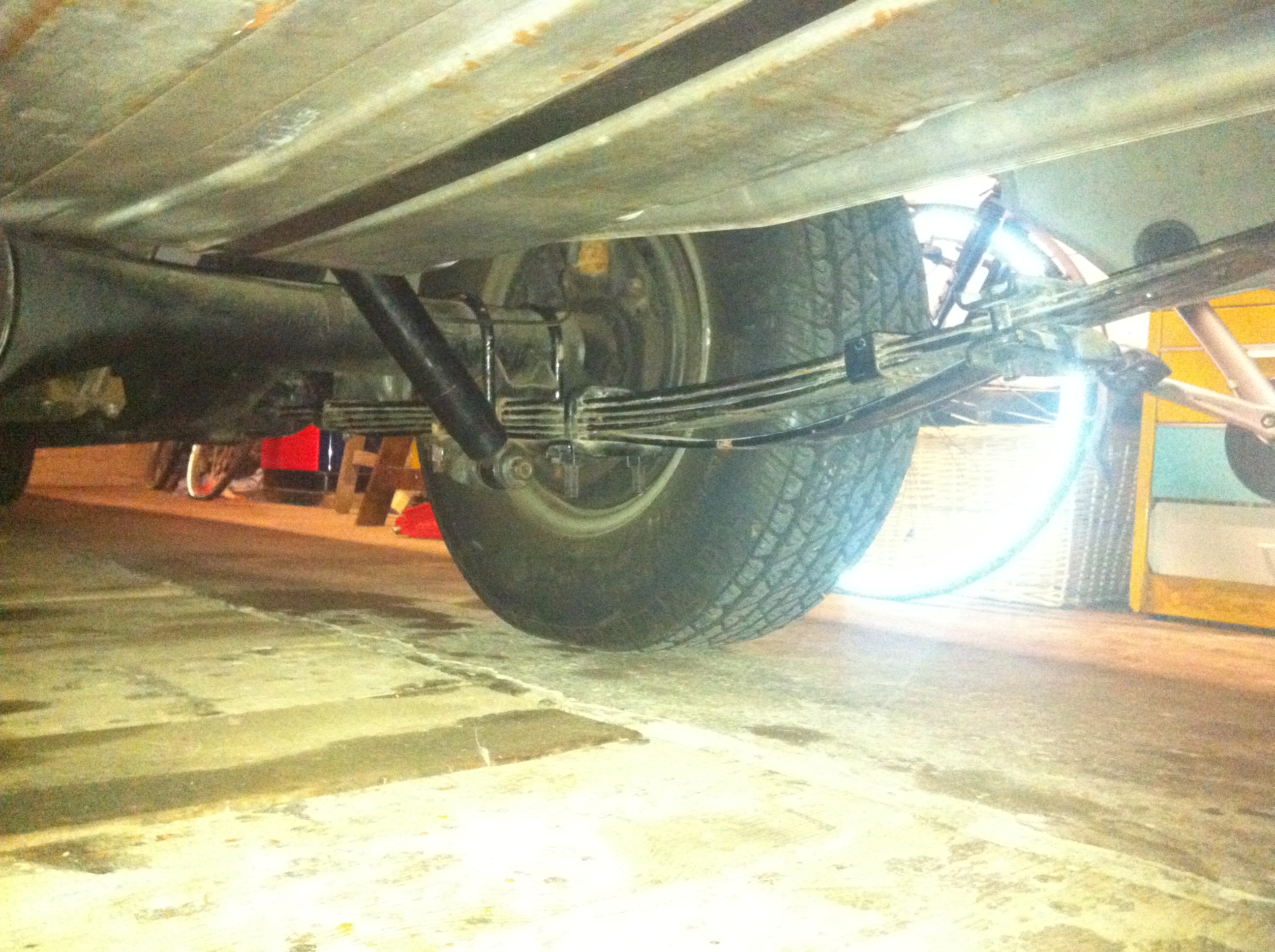

Ok, here are some pics

Matthew, What you have there in your photograph, is the good ol helper spring. I havent seen these for many years. They do work, in some cases they are just a crutch. You would jack up the rear of the car and bolt them on, thus adding to ride height and load capacity.

So, take them off?
Re: Ride height
Matthew - I would not take them off. I have helper springs on my Desoto and Green SF and even then sometimes when someone is in the back seat it will bottom out.
