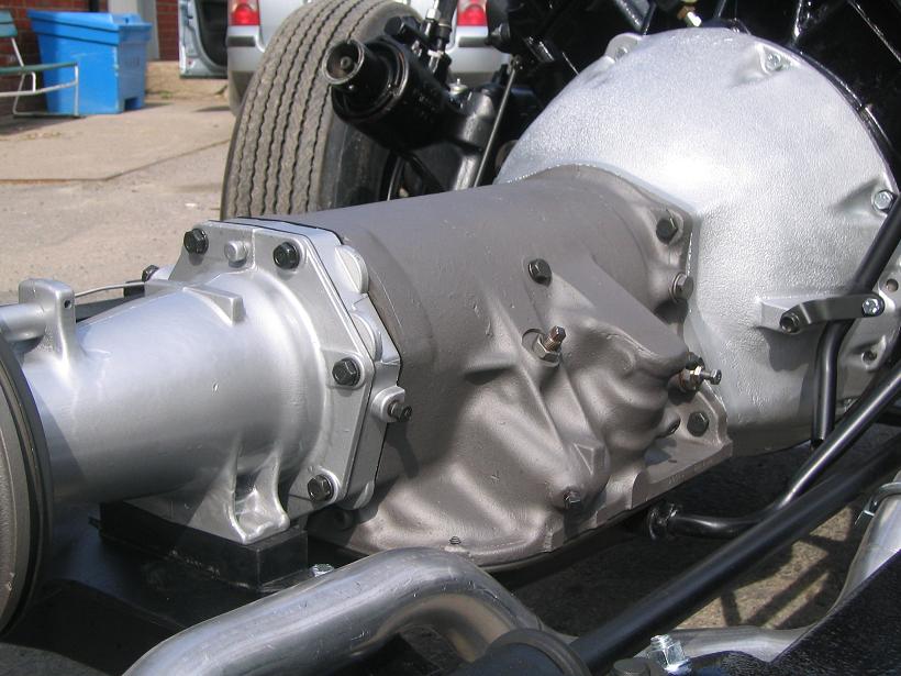

Anyone has some pics of how the breather tube runs and mounts?

Hi Matthew,
Here are pics of the road draft tube on the '59 Dodge 361 I picked up. It's identical to the Plymouth.
Re: Picture of a 361 breather tube
Thanks! That really helped me out good.
Can you get me a good pic of the point where it's bolted on?
Still struggling but I think the T/F dipstick is different
Matthew, Here is a pic from one of my archive pics, I think it is from a swedish Chrysler restoration. It is for a Big Block car but does show how the fill tube mounts to the TF Bell housing.
