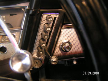

When you say temp control switch I'm thinking you mean the push buttons. I have 5 buttons and the lever. Buttons read from top down "OFF" "MC" "FC" "DEF" and "H". The "lever" says WARM on it, and has arrow pointing up.
There is a nice shiny knob attached to dash just below radio that says FLOOR AIR on it. I don;t know what this button does, if it turns or pulls out. Maybe it opens and closes fins on A/C unit under dash.

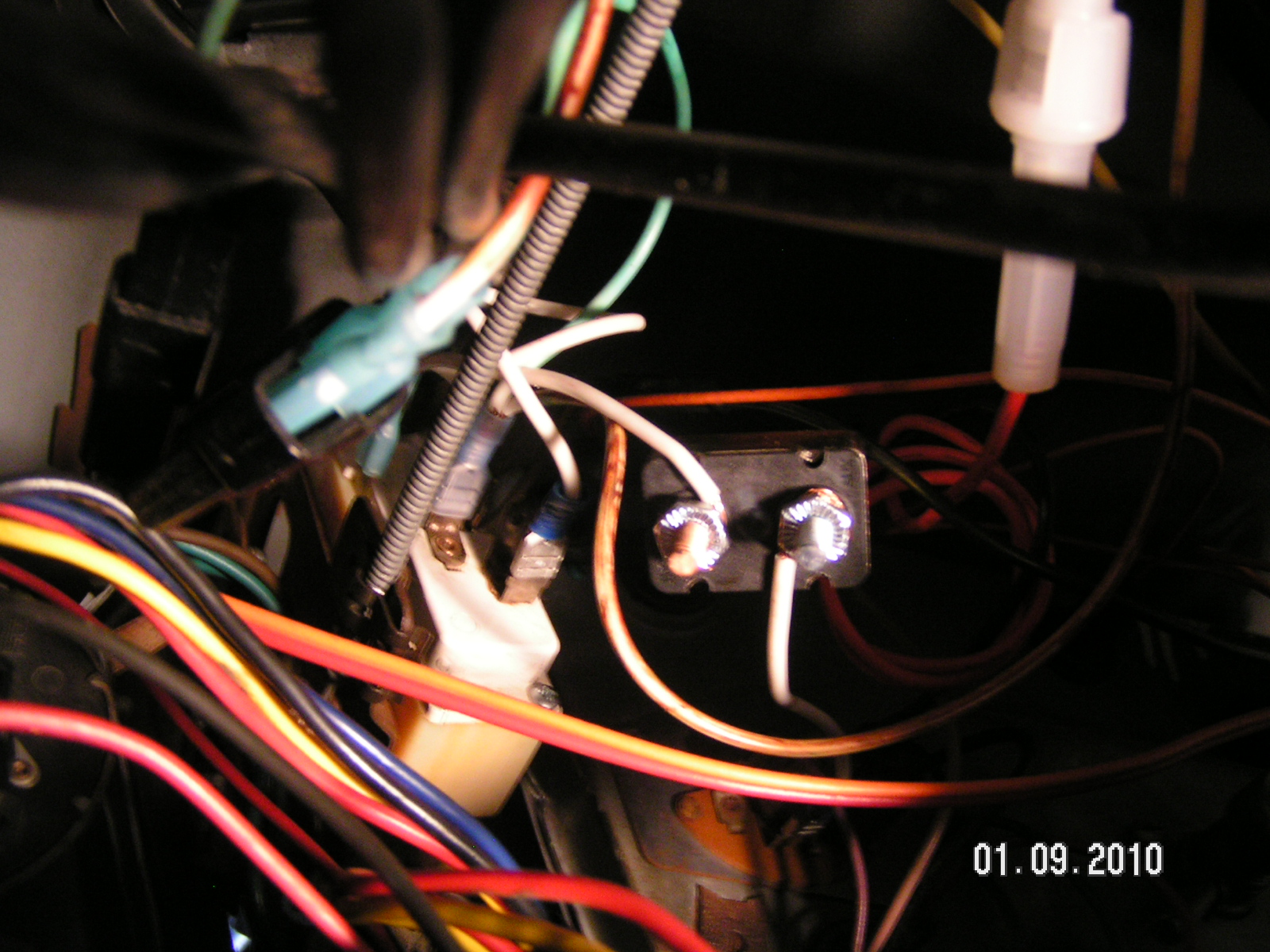

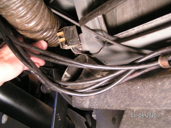

I think picture 2 shows a circuit breaker. I remember having it replaced, as the old one looked like it was no good.
Frank, Are you SURE the '59 a/c system used a resistor? The '58 did, as shown in the 58 Manual, but I do not see one in the '59 schematic.
Wire lengths:
1) 60"
2) 16"
3) this is a "given", comes with blower unit
4) 24-25"
You might see from these pictures that I never completed 1) and 2).
There is also a 2-wire (green/brown) line connecting PB controls. Green goes to the blower(fan) switch, brown goes to "T" connect of blower motor. Brown should be 24", green can be 8".
I hope you make these wires up yourself, Frank. The stumbling block I had was finding connectors which would mate with existing connectors. (I never did find them).
