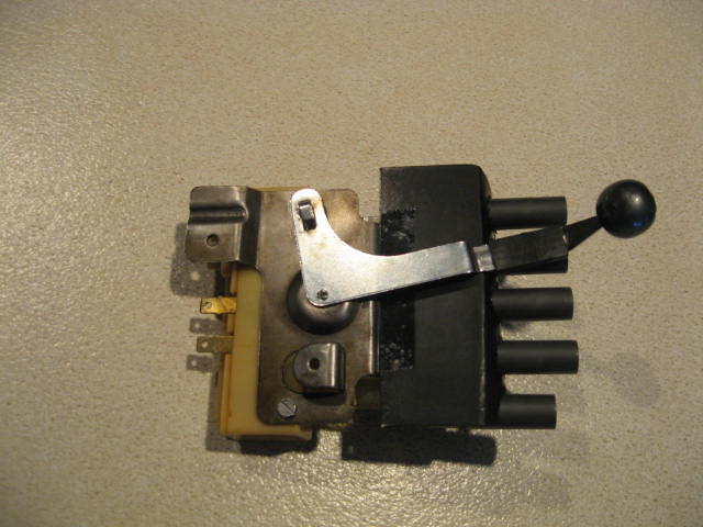

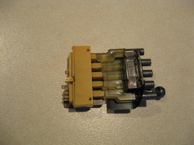

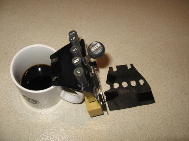

Still picking away at the heater issues,all is going well.Re-vamping the heater box so the dampers will open and close correctly,the old cardboard is A little warped but is basically in good shape.I soaked the push button switch overnight in A jar of thin weight oil and hit it with A little compressed air the next day,and is working smooth as silk,I also checked the switch with A multi- meter and is working correct(hi/lo). My light shield for the buttons was A little toasty,I thought of putting it in A lamenator(cover both sides in plastic)like you do for documents,but tried clear shipping tape instead but wasn't real happy with that.Instead I had A Christmas card of the right texture and A photo finnish,so I laid the old one on the card and hit it with A light spray paint to make A stencil,and cut it out,it turned out well.I also lubed the heater damper door joints and everything else under the dash,(was binding) now it works effortlessly.Next is to get the box back in and replace all the vacuum hoses. Mark M

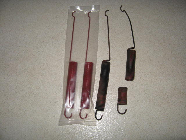

For what it is worth I found A pair of front bench seat return springs from Neil Jenks at Dynamic Restoration 25.00 A pair(new) mine was broke,it is the same springs to 69 Barracuda.

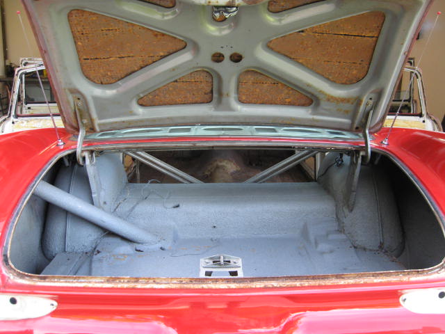

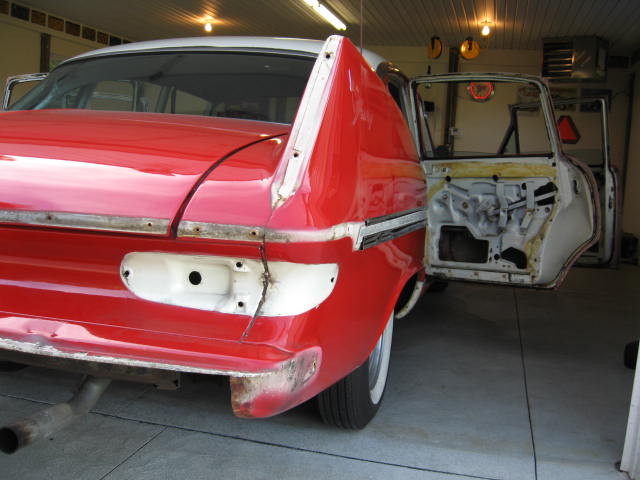

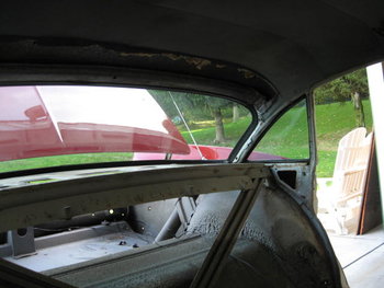

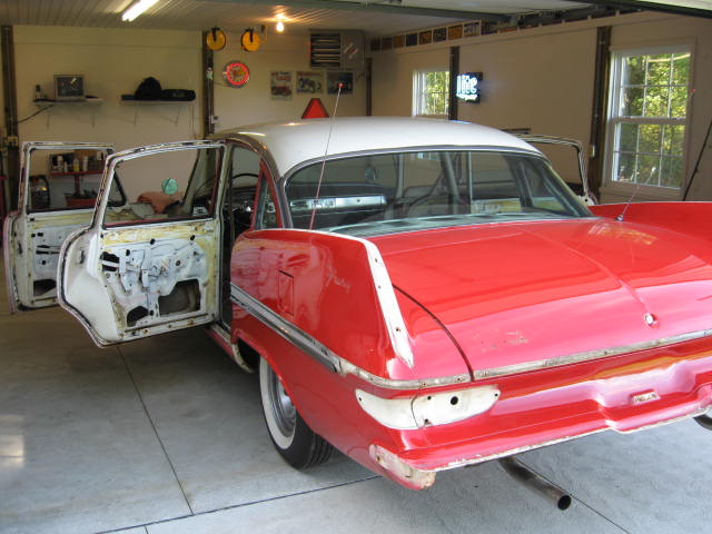

I'M going to do A "Faulkner Redo" so to speak,removal of trim,bumpers, grill,door panels,seats,carpet,headliner,door gaskets,and yes, windshield and rear glass.All in preparation for A paint job and interior.Any thoughts of do's and don'ts,it does not look too difficult to me,just going to take some time,(a winter project) it is what this car has needed for A long time!!!!! Will check on previous posts and research A few things,I have an excellent body man( and friend) for the body and paint,I will do the rest,windlace,cat whiskers,etc.etc.etc.Dick,or anyone, anytime you want to throw in your 2cents i'll gladly listen!!! Will probably start fairly soon. Mark P.S. I have ordered the carpet,head liner and door panels about A month ago and I know it takes A long time for the order to go through, would like to get this done by june of 16.We have put about 4,500 miles on since the rebuild in my previous posts, and all is well mechanicaly,I think the time is right to go farther.

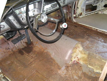

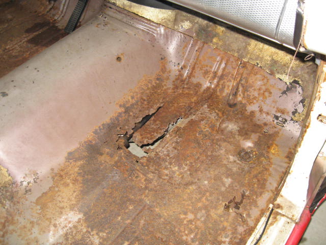

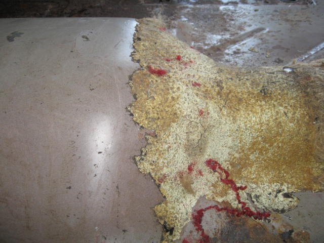

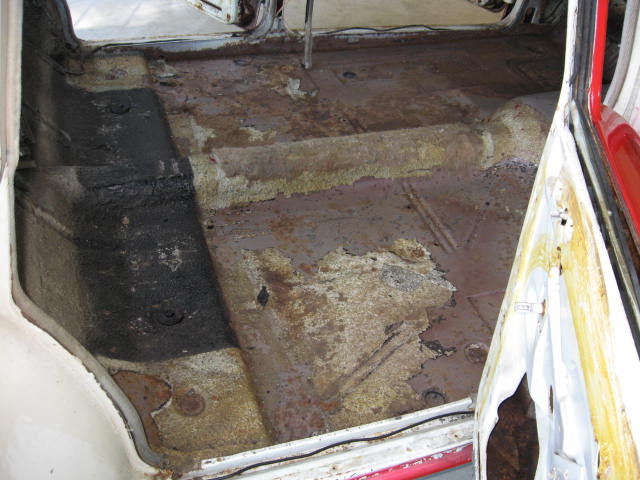

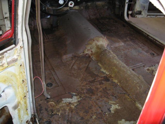

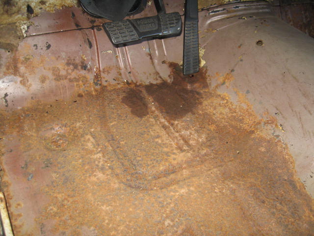

Got started getting my hands dirty.It is going well,the passenger floor needs patched,I already knew about that one.I think the car sat out from previous owners and I suspect water had leaked past the bad door gasket and puddled at that area over the years.Question,did all 59 plymouth assembley use an under coat on the interior floor surface? It looks kind of like tar,may have been soft,but now is brittle.I am scraping it off,it comes off pretty easy.Going to clean it up,paint,and put down hush matt or eastwood(foil/rubber).Question,is it easy to remove and install the window glass,front and rear? Should I remove the dash(would like to paint it),am also taking out the headliner,it is toast,later Mark

Mark, I chickened out on pulling out my dash - I got pretty good results without doing it:
viewtopic.php?f=4&t=1173&start=45#p6906
Here's a snippet from a longer thread, about my experience with my headliner:
viewtopic.php?f=4&t=1092&start=45#p7221
