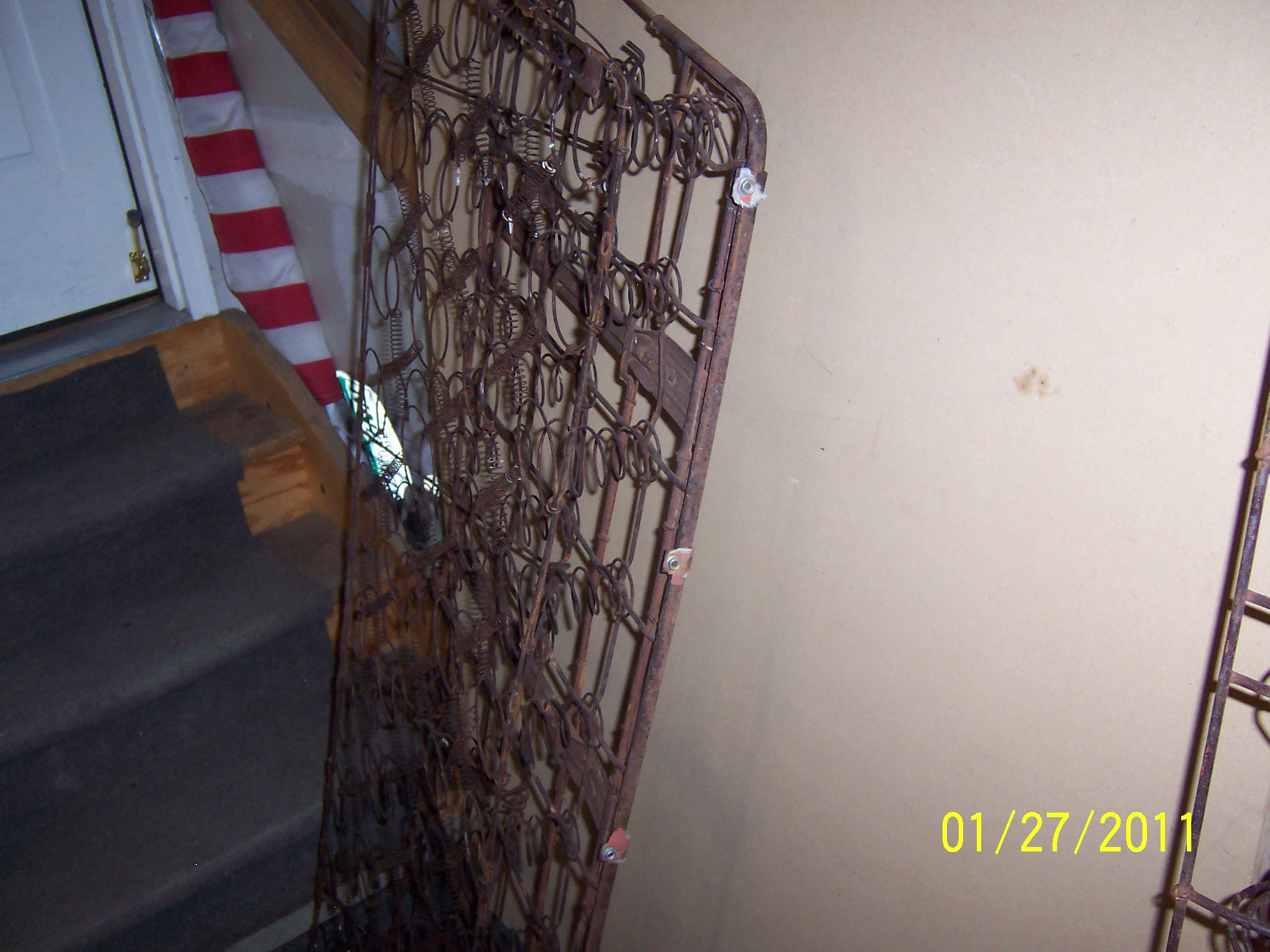

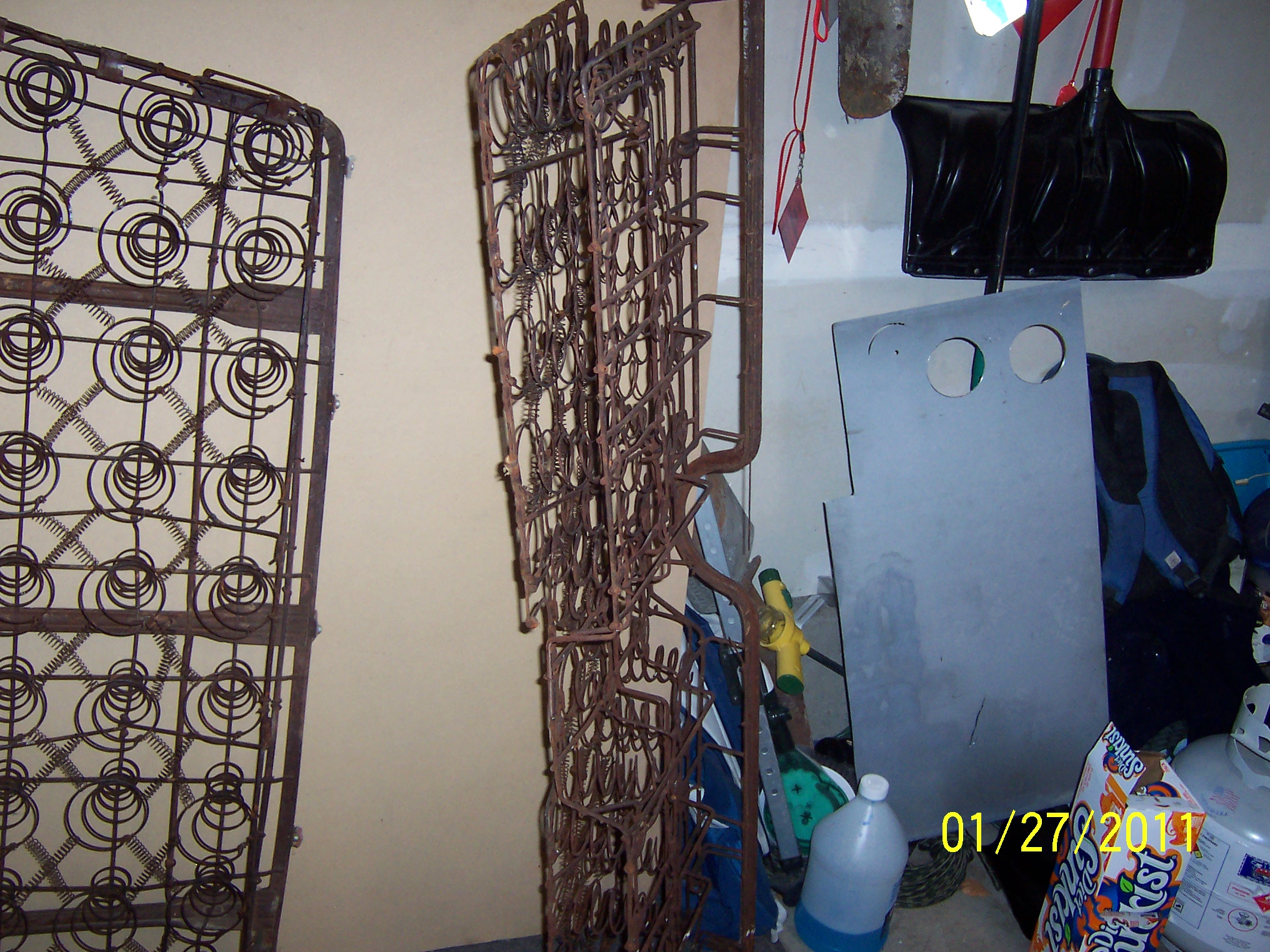

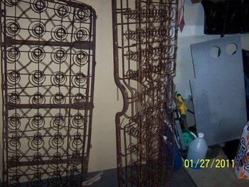

Ok, Dug them out and took the pictures in my Garage. Hope they help!
If there is a particular angle or view of any of the two pieces, let me know and I will zoom in on that part.

So out came all the interior pictures I took of other peoples Swivel seats cars and had an idea on what she wanted and explained it to my upholstery guy (sponsors our local Mopar clubs car show) And we will do a Belvedere Door panels and a type of pattern of a that I see on cars that looks like a SF seats but with out the Buckles, I will dig up that look on my Thread on my convert. Don't want to intrude any further on Dick's space.
Compare John Q's Picture #1, springset on the right,
with Dick's Pic #21 of springset. There are differences. I hope they fit!
If John measures the overall length of the seat he has, and compares that to John's, he'll have a better idea of the chances.
I can't recall now if any model's seat bottom fits a cvt.
