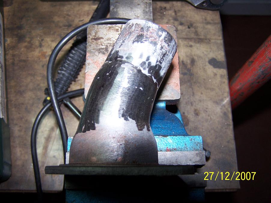

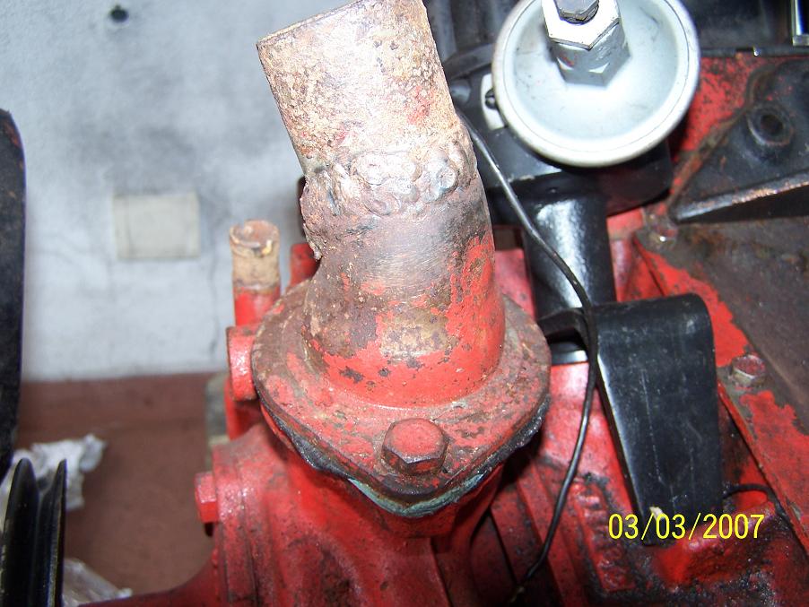

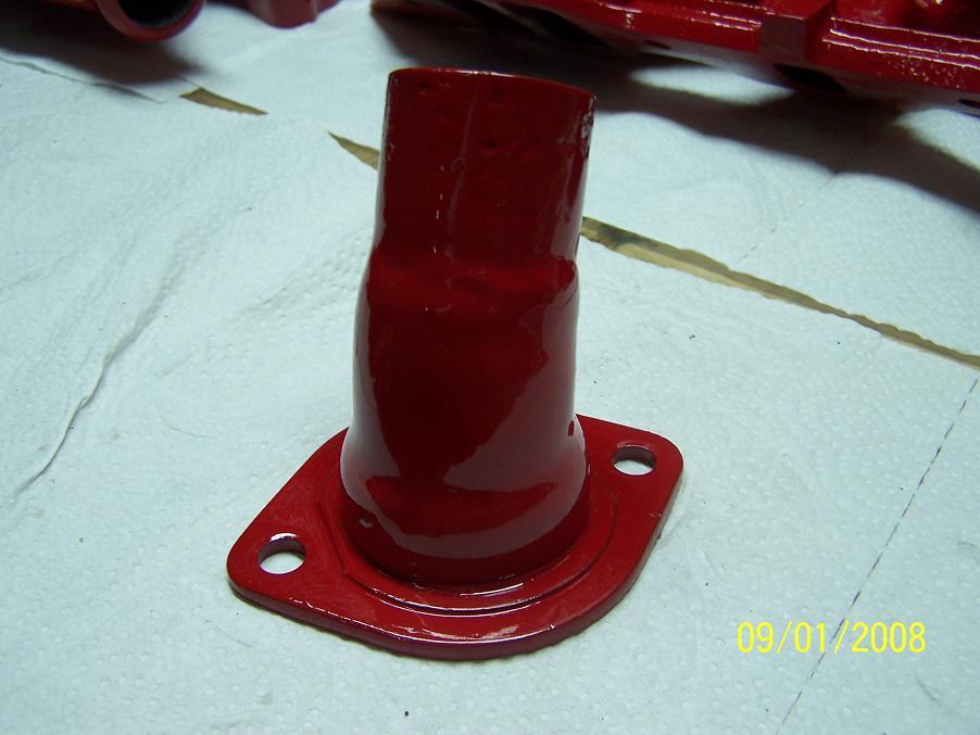

- As the missing parts are still in the custom office, I keep myself busy with some smaller improvements, for example this professionally welded water neck.

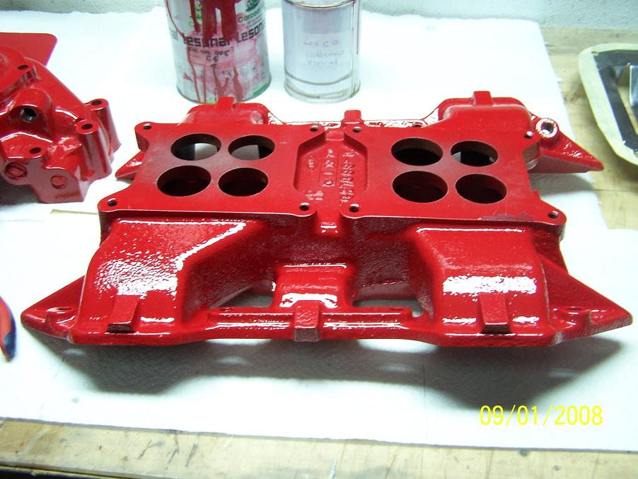

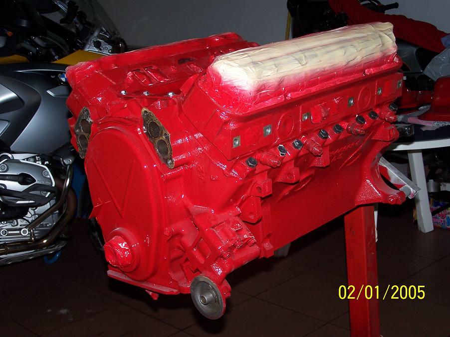

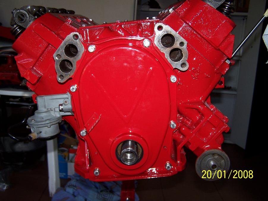

Well guys, meanwhile you proved yourself as a very tolerant or with a high pain level? :? Nobody complained about my intentions to pain the engine in “Kawasaki Racing Green” – or are you going for the pictures only? However, here we go...
Posts: 5138
sportfury1959 wrote:Well guys, meanwhile you proved yourself as a very tolerant or with a high pain level? :? Nobody complained about my intentions to pain the engine in “Kawasaki Racing Green” – or are you going for the pictures only? However, here we go...
Nah, we all recognize a prankster, Stefan, even if it isn't April 1st. 8)
However, the Candy Apple Red looks sweet to me...
sportfury1959
Posts: 417
Location: Portugal
Post by sportfury1959 »

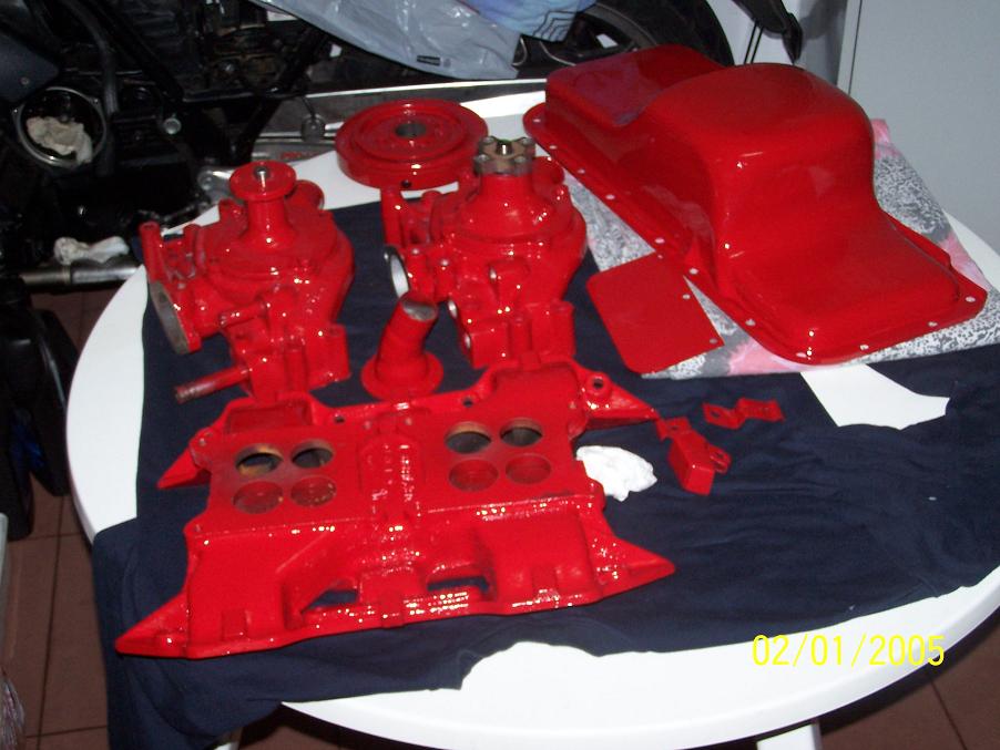

- The engine is back
- I chose exactly the same red that I have on the roof …
- … beautiful combination. Do you like it?

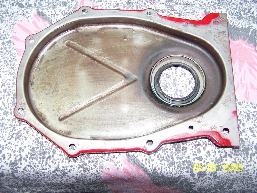

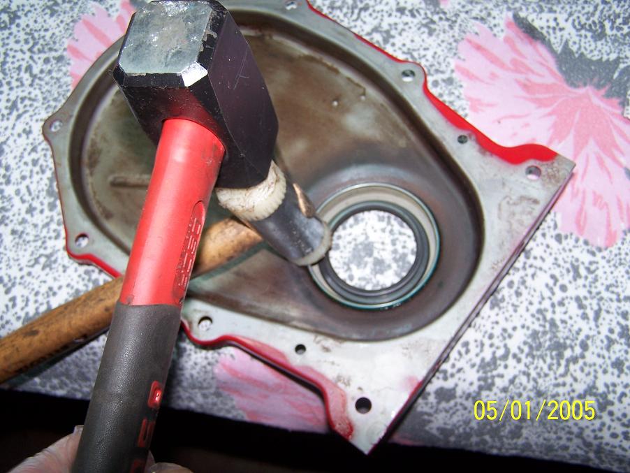

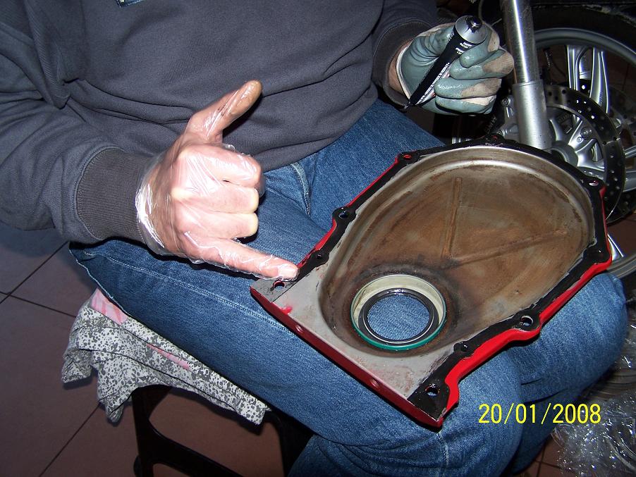

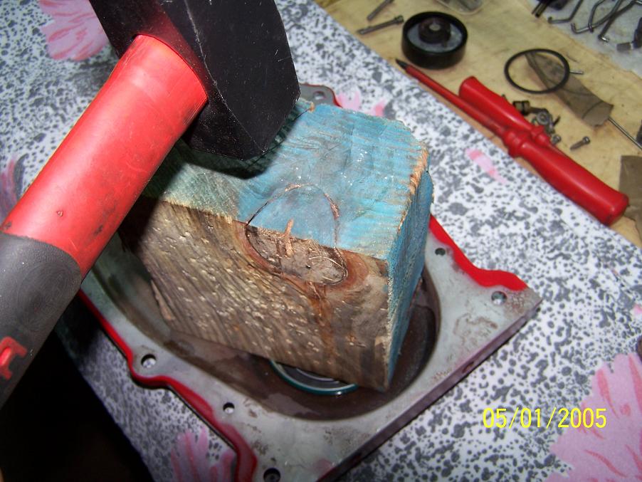

- New front seal for the chain cover
- I simply like this work, smooth, clean, perfect.

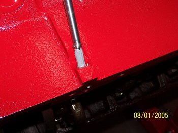

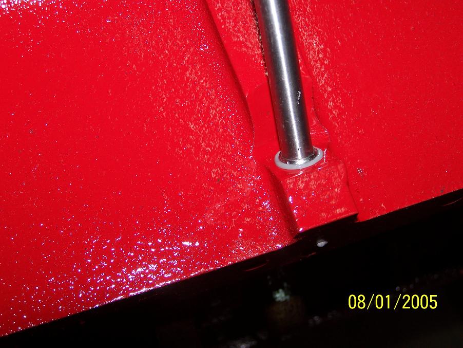

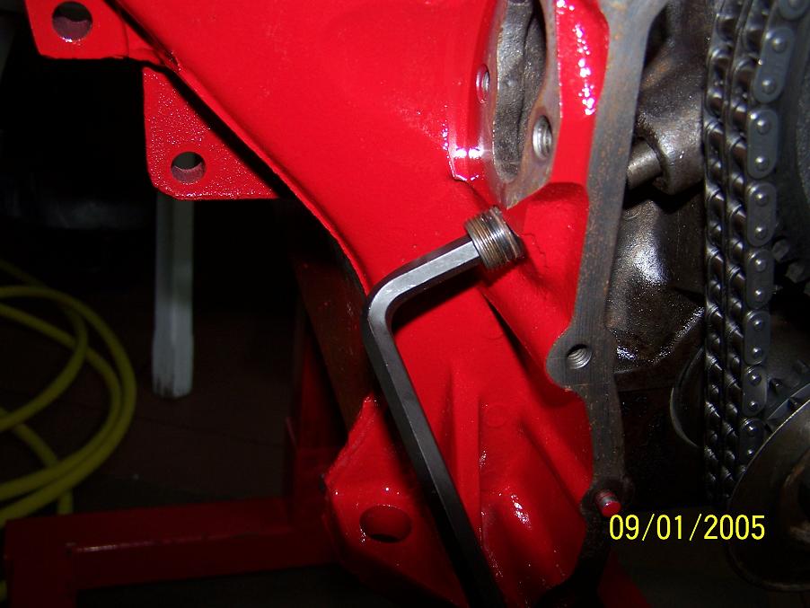

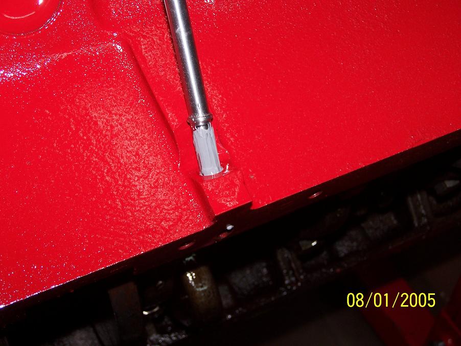

- To prevent oil leak the Dip Stick receives a special glue from M3
- Looks clean …
- … and seals perfect.

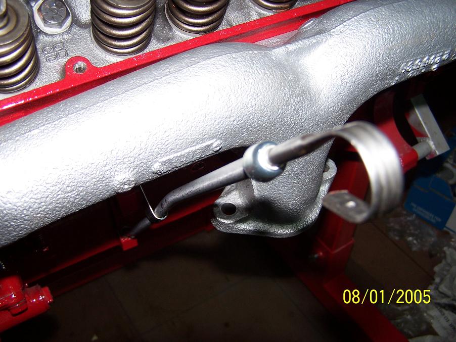

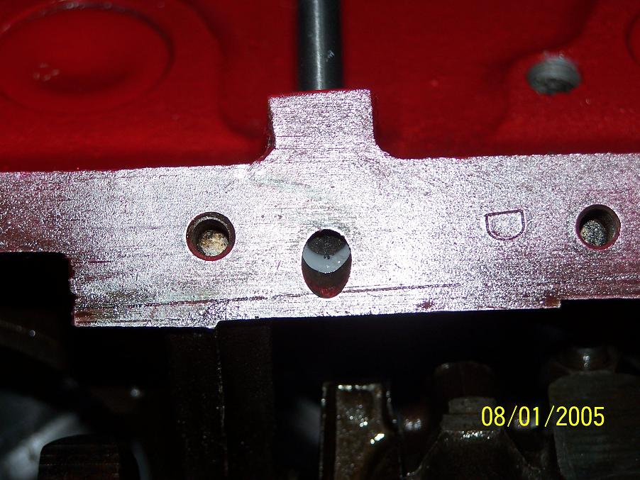

- Let’s see if there is enough clearance between the exhaust manifold and the dip Stick. The dip stick is an aftermarket from Mancini Racing. The hole, where the stick is bolt to the motor mount bracket was not in place, so I had to work on it. :( I hate that!
- I guess I already mentioned the sludge issue a hundred times. The oil passages are clean again and can be closed, hopefully for the next 50 years.

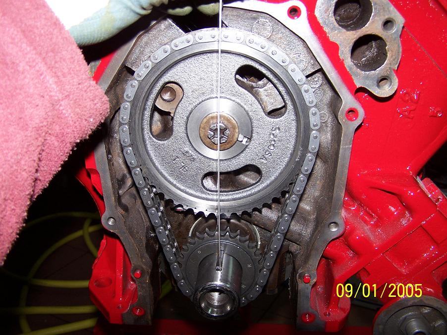

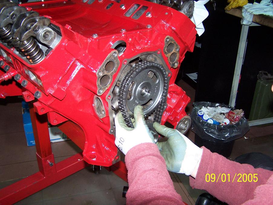

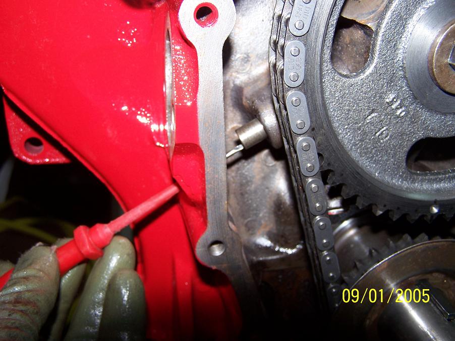

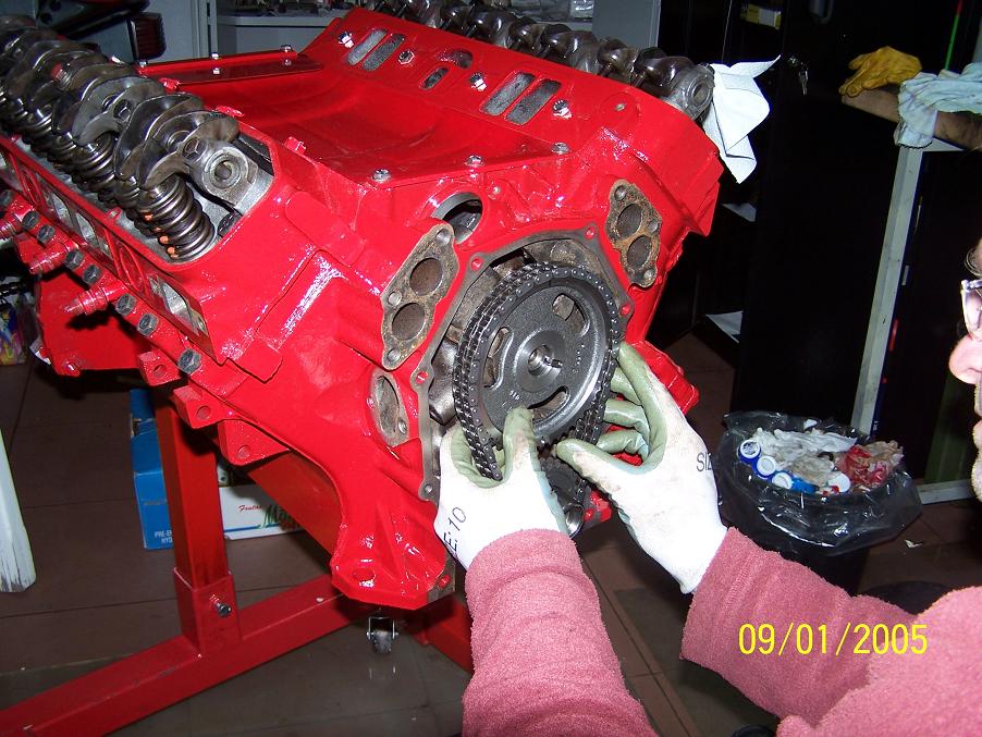

- Double Roller Timing Chain –
- Final installation and
- correctly lined up

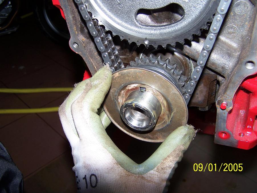

- Oil Slinger

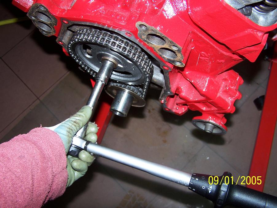

- Correct torque

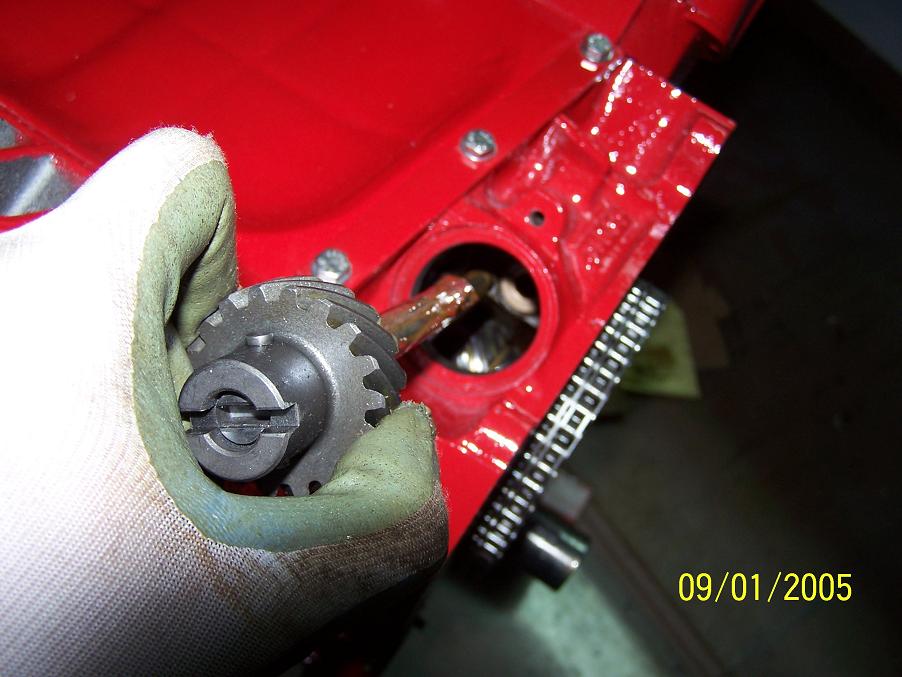

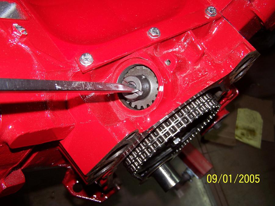

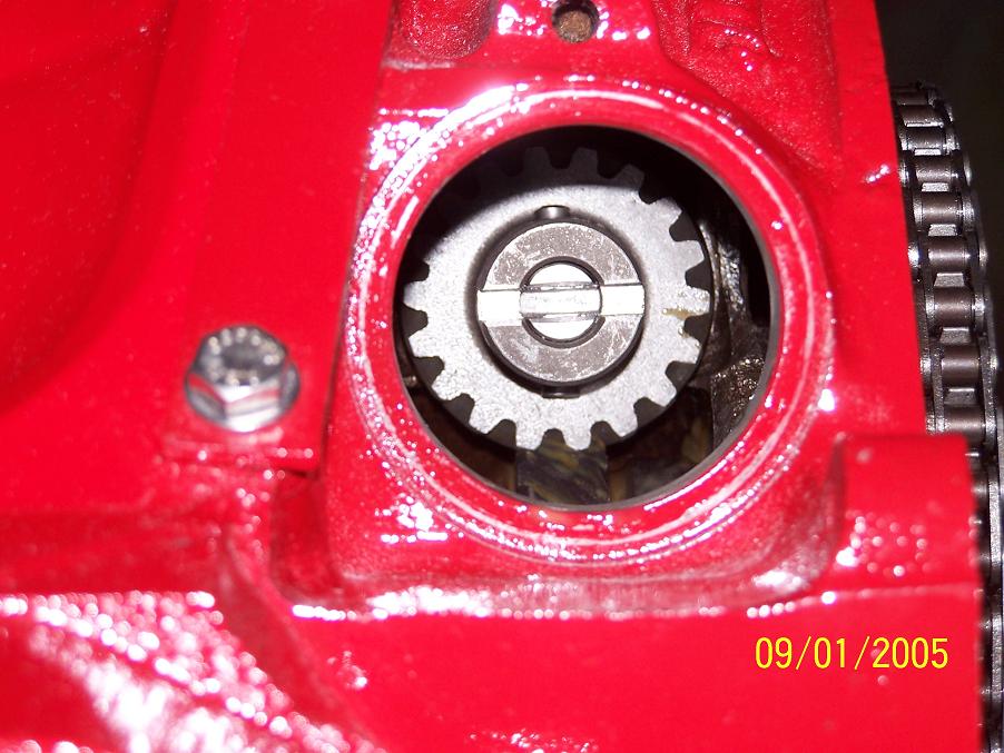

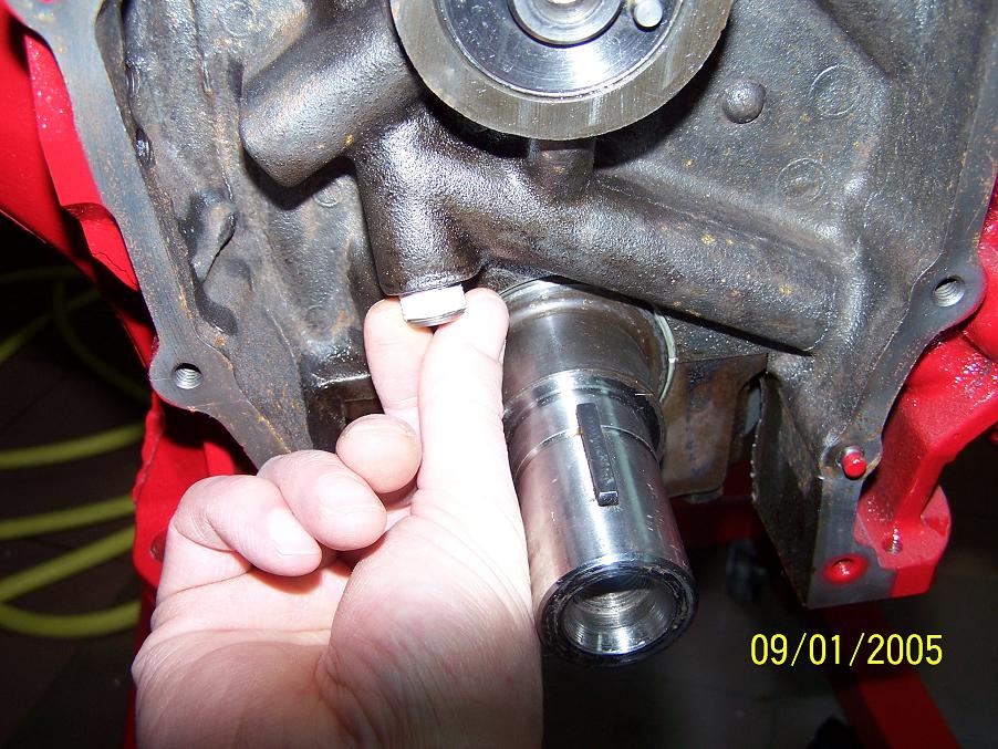

- The new oil pump drive shaft
- well lubricated
- and lined up, just as the manual requires

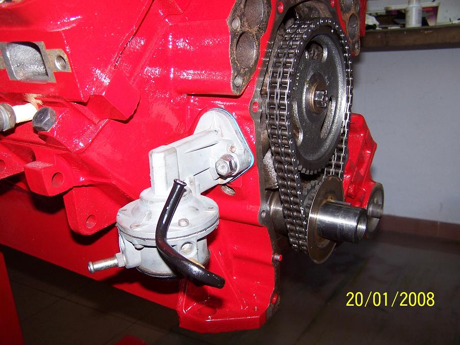

- Fuel Pump

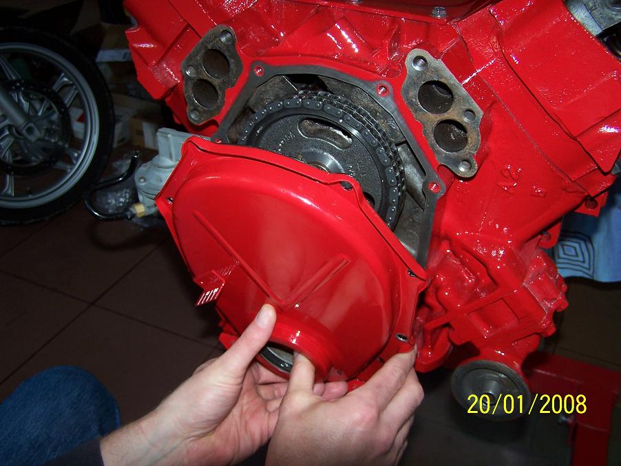

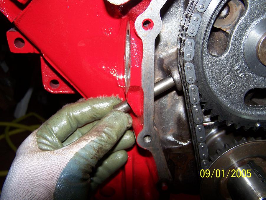

- and here comes the cover for the timing chain
- probably the last time I see this double roller chain – for the rest of my life
- it starts to look like an engine.
