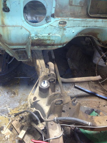

Ok so the front suspension has caused me much grief and displeasure...Here is a pic of the offending part....any suggestions on how to get it to budge? Tried flame, flame and break free, flame brake free and wax. Is this a unscrew counter clockwise or clockwise? Not that it matters because its not going either direction so far. Have the correct 1.91 inch remover and a long breaker bar....getting a 1/2 to 3/4 in impact driver tomorrow so will give that a try and see if i can get a move.

Jaydogg; I used an impact gun,it has A hammering effect and got it to move A little then went to A very long breaker bar. Turn to loosen counter clockwise.After it is out lightly wire brush the threads and install using a little never cease on the threads,careful not to cross thread(start it by hand) Mark M

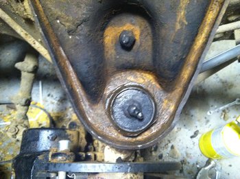

So finally got front ball joints off with soaking them in a lake of break free for a week...see pic

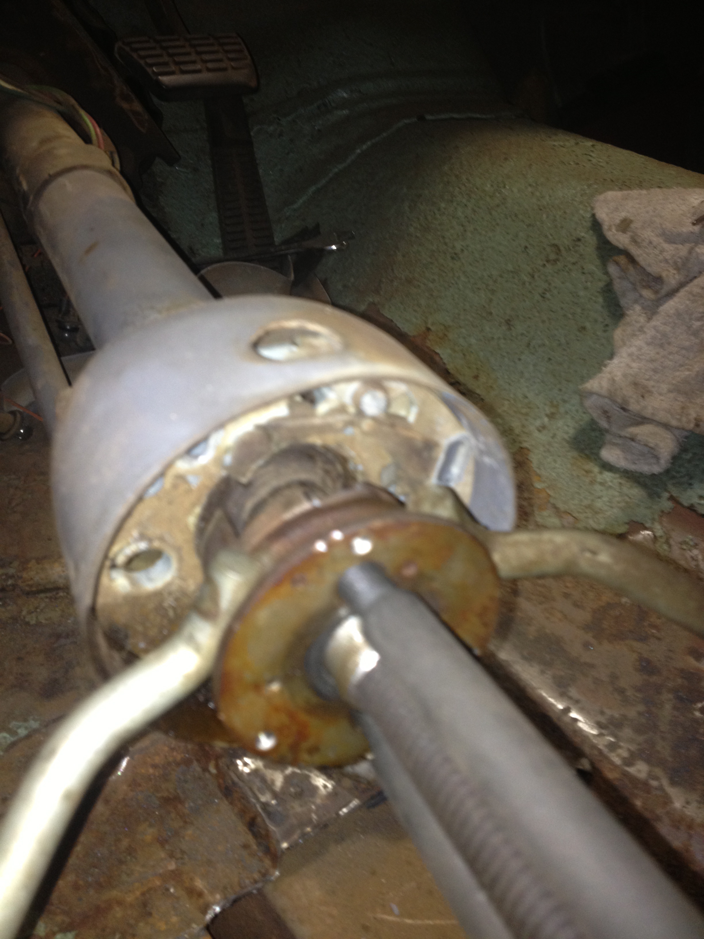

One problem is the steering wheel...it wont come off...what am i missing
All the screws are off the back the nut is off...tried a puller behing flange and bent flange now using harmonic puller but still wont budge...even after break free....any ideas?

A steering wheel puller is a smaller version of a rear hub puller...a beefy central threaded rod, this time with three moveable fingers or arms coming off the central hub (instead of five on the hub puller)....the key being these three fingers BOLT to the holes in the steering plate.
You've learned (too late) that the fingers having hooks will likely bend whatever they are hooked around.
When you find the correct tool, remember to put the nut back on the steering shaft to protect the threads as you apply pressure to the area.

Jay dogg; Sounds like your wheel is A tight one,put the nut on like roger said,flush with the top,I used A 3 arm geer puller (small one) but A steering wheel puller would be better,put A decent amount of tension on it and give the center A smack whith A hammer.That did it for me.Keep you torsion bars right and left the way they came off,when I cleaned mine up I also noticed red paint(from A brush) at the rear 6 inches or so,I think it was for assembley purposes identifiying that it goes to the rear. good luck. Mark M

After my reply, I researched "harmonic balancer"...and saw a photo on the Sears page...that gadget should do the job. Maybe the hammer whack is what's missing! See what your local auto parts store is willing to loan-rent to you.
Maybe you can figure a way to apply some heat, such as heating up a separate metal bar using a blowtorch, then holding the bar to the steering wheel hub? Good luck!
