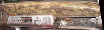

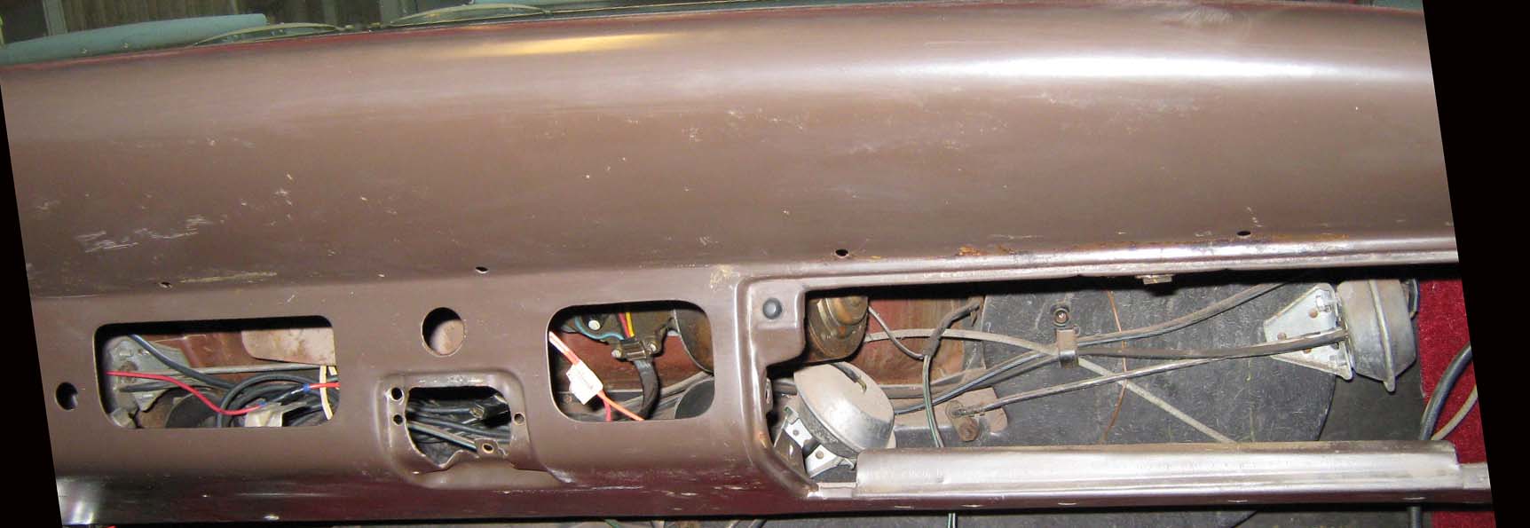

I find isopropyl alcohol to be useful for cleaning all sorts of things -- including, recalcitrant Carlisle sticker gum on the windshield! But it was great at softening up the glue that held on the replacement makeshift dash pad. Here's the before:
...and the after:
I used it to clean the whole dash. Next, to lightly sand, prep, and mask the dash for painting.

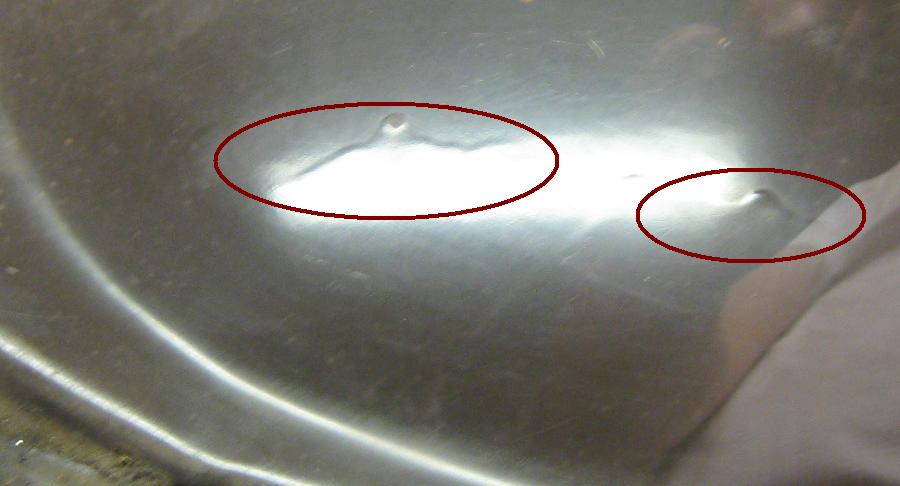

Here's something I always found interesting about Faulkner:
It's not a great pic, but you can see the runs in the original dash paint. Astute observers will note that the paint is running "up" -- so this is a run while the dash was held vertically for painting with the driver's side up. I guess it's true what they say about MoPar quality control in those heady days -- slap 'em together, get 'em on the showroom floor and sell, sell, sell!

Dan, The Dash is looking good! And happy B-Day too!
The dash cleaned up well. I Think you have a Monday build car or at least the dash was built on a Monday or a Friday before a 3 day weekend was always a sloppy, rush rush, lets get out of the plant day. Or at least it was when I worked in the Chrysler Stamping plant during my College days. I bet nothing has changed in the plant...
Are you going with the same color dash as you have now or something else in color?
