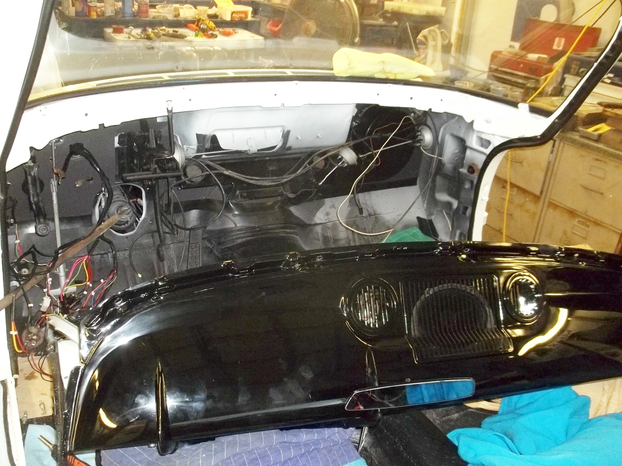

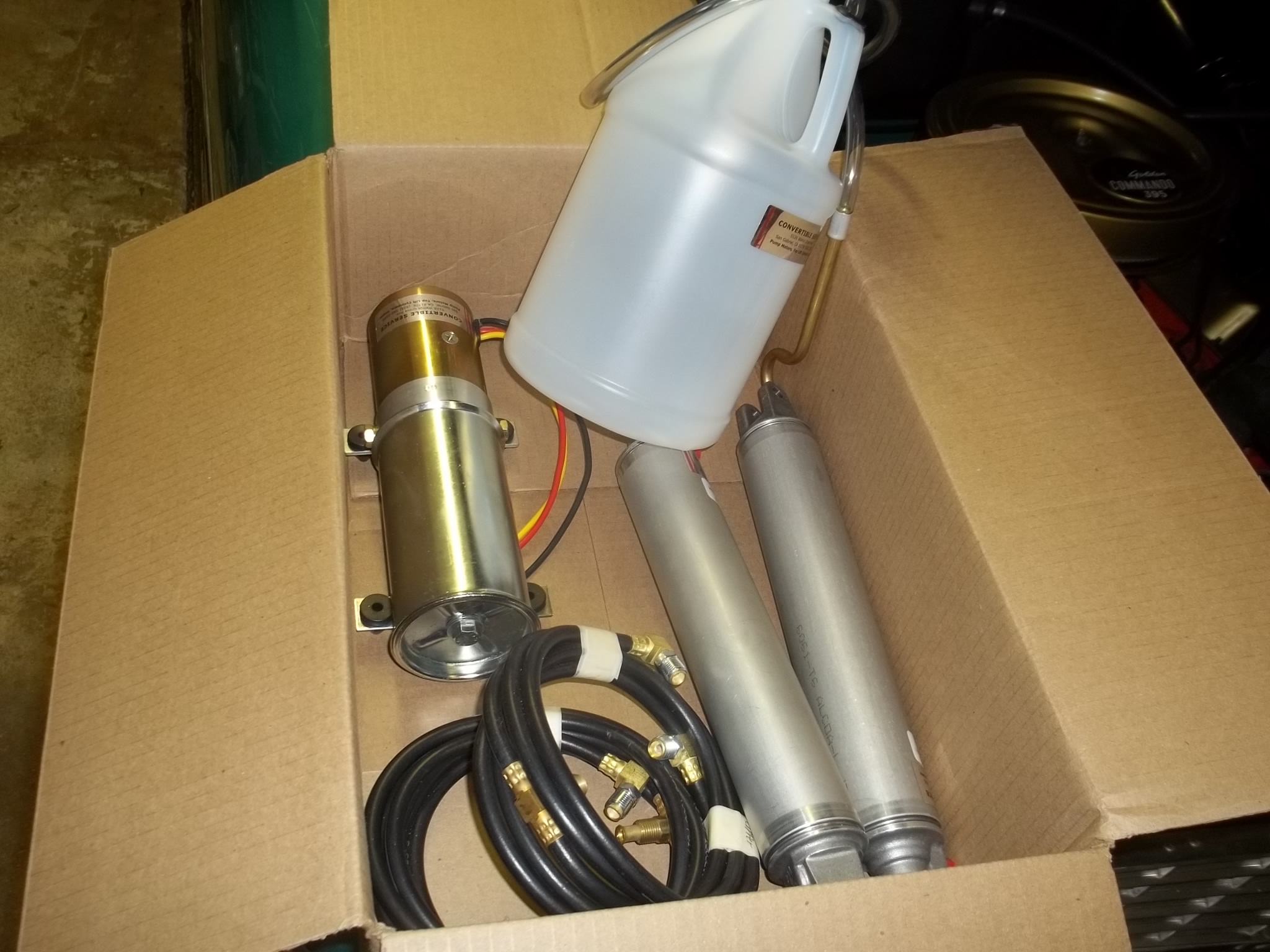

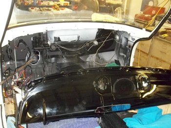

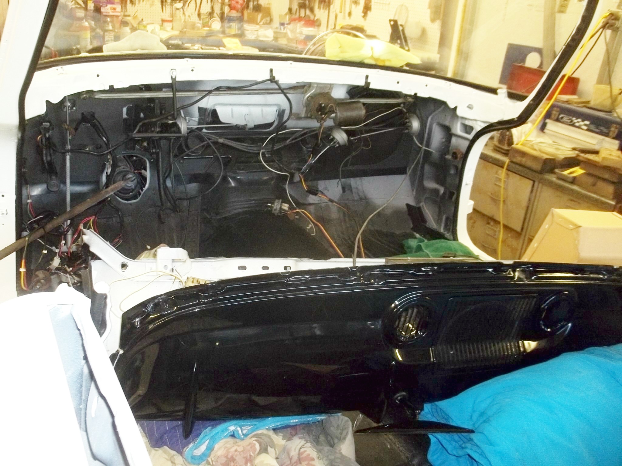

Listen up, I had a very serious Dash Delima and Dash learning experience. I installed the dash with the help of my son and found out the door weatherstrip has to be installed first. So I took the dash out and installed the weatherstrip and reinstalled the dash. I was going to use the single speed window washer system but I forgot to install it before I put the dash back in. It's not too bad to install with the dash in except the glove box is in the way!!!! So I had to take the dash out again for that. Since I had the dash was out I decided to remove the variable speed WW system from my 59 Desoto parts car and install it in the Convertible. Thats when I noticed the heater water valve operating cable in the Desoto opened the valve from the right hand side. I hooked up mine from the left hand side. Duh! John Quinn. I had the valve upside down, so I took off the hoses, turned the valve over and hooked up the cable correctly. Duh! John Quinn. Got all the wiring (very good shape) and the foot pump and installed it all in the Convert. and put the dash back in again. WHEW!!! Next I continued installing the wiring, switches, etc. YNZ makes it very easy with instructions that even and electrical dummy like me can do it, well maybe. The belvedere Convert. didn't have the rear arm rest courtesy lights but I was very fortunate to find a pair and with a very good wiring diagram in the Red 59 supplement I have all that wiring ready to install when I get my panels from SMS. I was also fortunate to find two front courtesy light that clip on the front kick panels and wired them up. I installed a momentary switch with a fuse for the fuel pump and an ON & OFF switch with a fuse to turn the front and rear courtesy light off and on when I want to, they will still operate with the door switches. Today I will finish hooking up all the wiring, switches, shift cable, speedometer cable etc. etc. etc. I have three Air Cleaner but they are for the larger 2 bb. carb. I was fortunate enough to get the correct Air Cleaner 2-5/8" dia. from John Fowlie. Then I was going to install the brake vacuum reservoir tank, I have three of those also but they are for the 59 Desoto and the mounting legs are different than on a 59 Plymouth. John is looking to see if he has one. Now I have to go get a present for Yvonne's birthday tomorrow. The first year we were married (1960) I forgot her birthday and have been paying for it ever since.

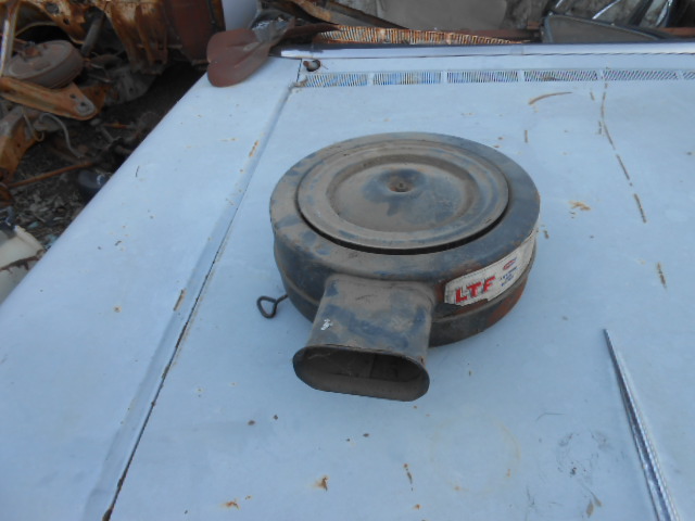

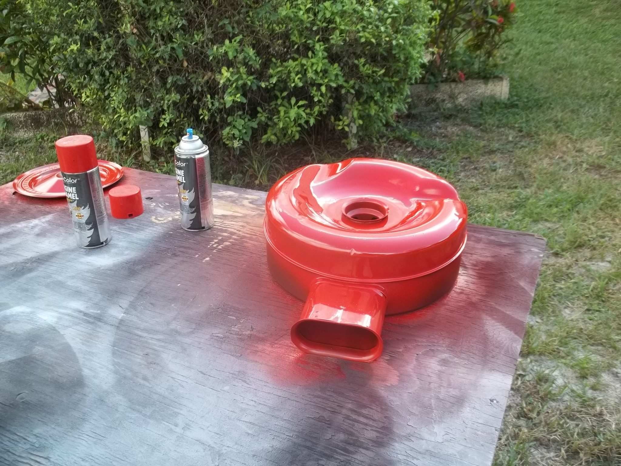

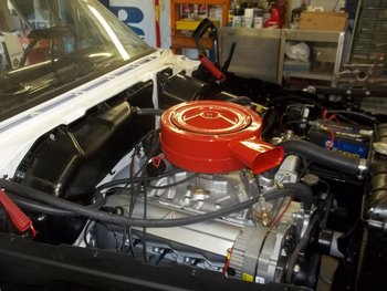

This is the Correct Air Cleaner from John Fowlie.

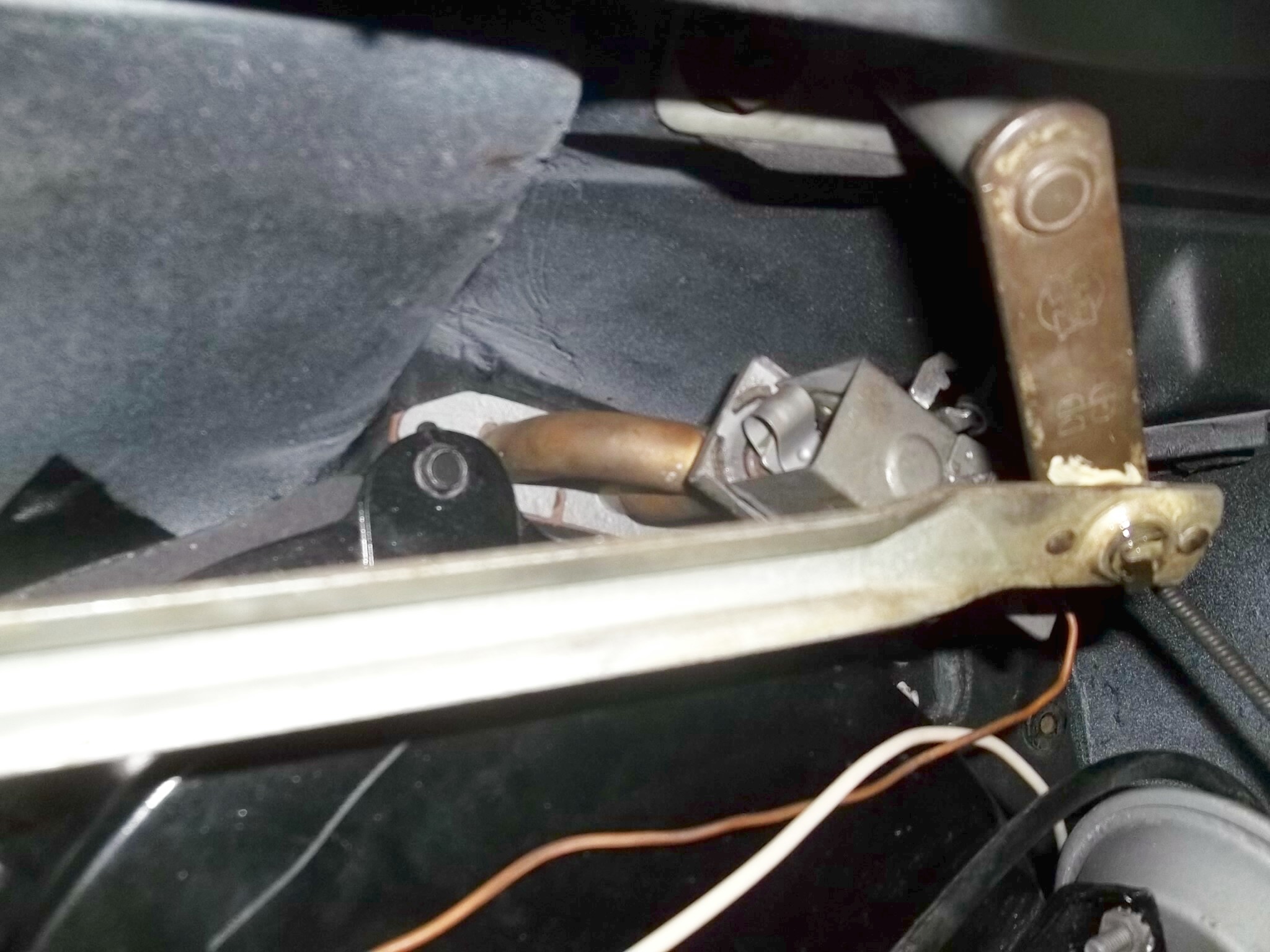

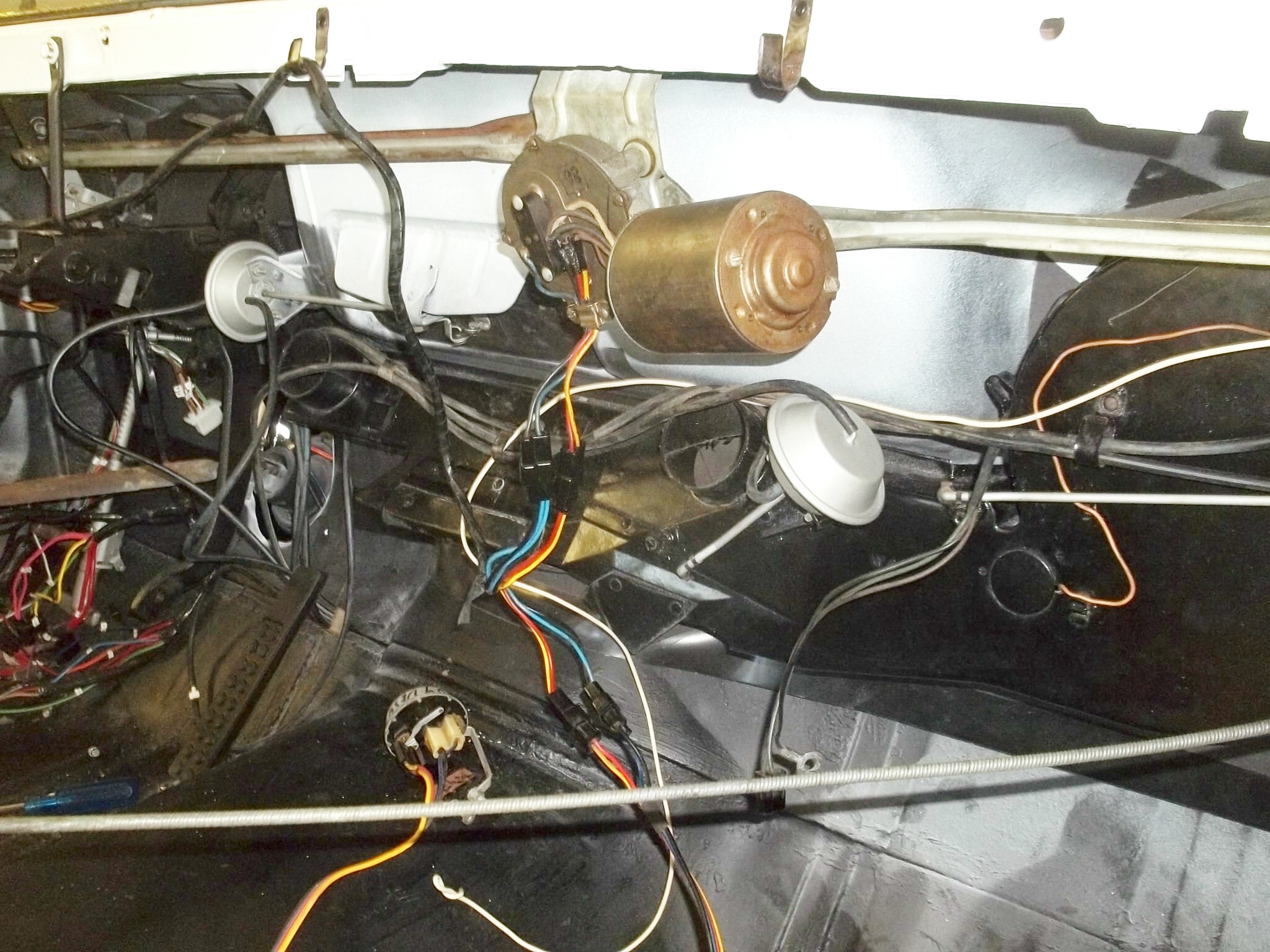

Variable speed wiper motor.

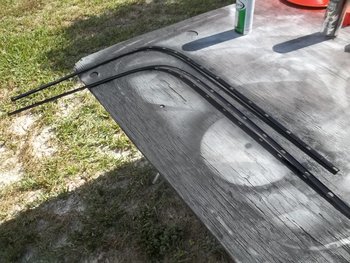

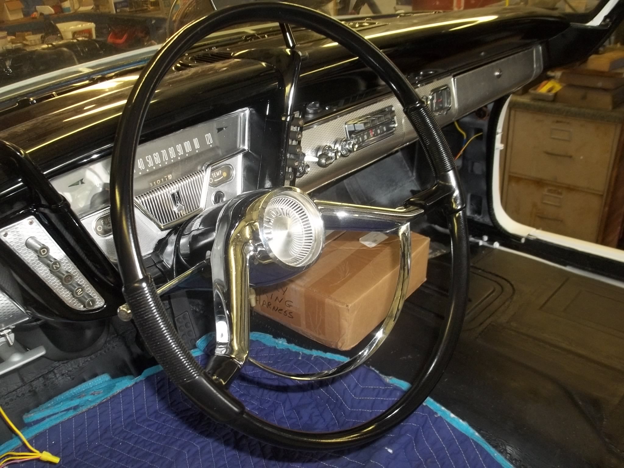

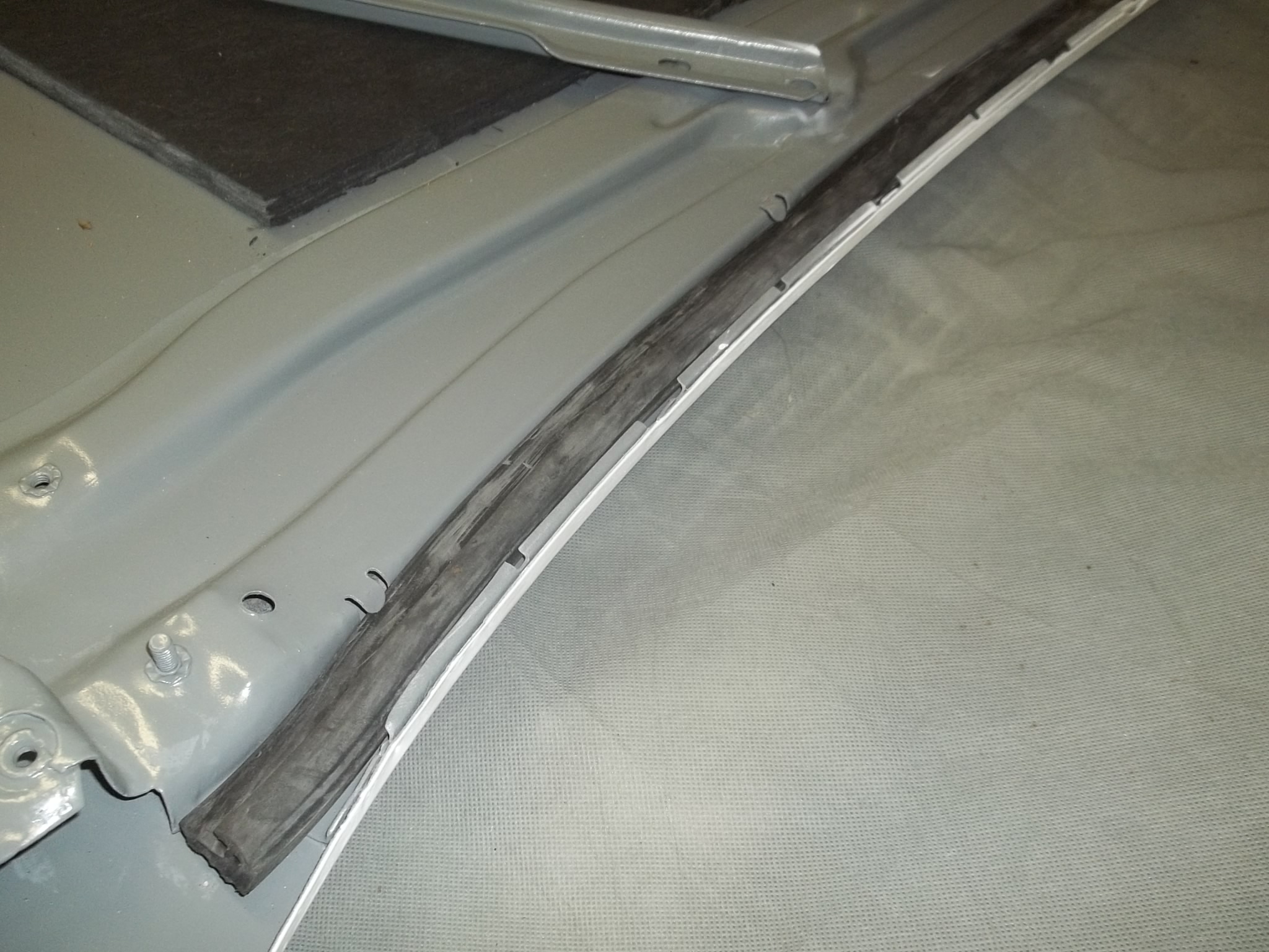

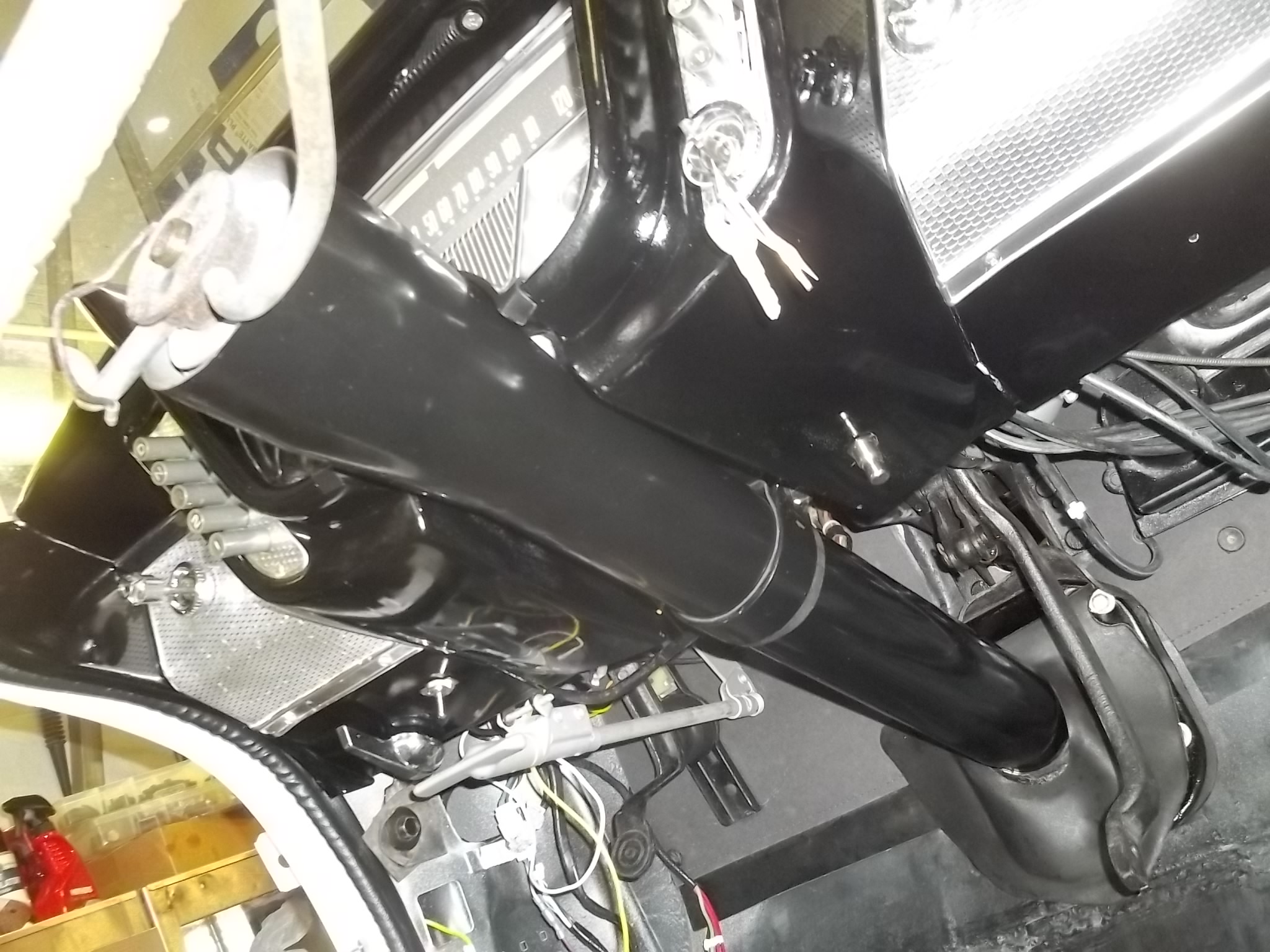

Well I got a few more things done. Got all the fuzzies installed (Gary Goers). The outer fuzzies on the doors and rear window opening I installed using factory clips (gary goers). The fuzzies on the garnish molding I had to use rivits and then paint them black, there is no way to use staples like the factory. Man, I gotta tell you installing the steering column by yourself is not easy. First make sure the rubber insulator is installed on the shaft and the pin is driven thru. Next make a brass ground strap for the rubber insulator that goes on the power steering box and put on column cover then put the clamp on. Next make sure the rubber splash shield, the metal retainer and the carpet cover are on the column cover. Install the plastic that fits across the column on the dash, make sure the rubber ring is on the column where the clamp holds the column to the dash, have the nuts and bolts ready along with the upper and lower clamp halves, then grow two more arms and hands and begin. Oh, I forgot have a plilips head screwdrive a short piece of 2 x 4 and a hammer ready. Push the insulator onto the steering box, when it won't go anymore take the screwdriver and find the steering shaft and guide it up thru the bearing, when it won't push anymore take the piece of wood and the hammer and tap it until it seats. Next laying on your back try to hold up the column with right hand No. 1, feel around for the upper clamp with left hand No. 1 and insert in place. Now with right hand No. 2 find the lower half of the clamp making sure the rubber ring is in the right place and push up on the upper clamp half. Using left hand No. 2 find a nut and washer and screw onto the stud sticking down, then find the bolt for the other side and screw it in. I seamlealed the front inner fenders where water and dirt accumulates to maybe retard the rust somewhat. The thing I fear the most was next, installing the rear windows, it wasn't as bad as I thought and got both sides done and working smoothly, I installed new rubber seals on the leading edge of the rear window. Next I got the front fenders out and sanded and filled where necessary and applied two coats urethane primer then three coats pure white urethane single stage paint. Roger note the runs, a good painter starts his wet sanding with 1000 grit wet or dry paper. Rembrandt here has to start with 400 working his way up to 2000 before he can buff.
See the pitchuhs.
GOT THE FUZZIES INSTALLED USING FACTORY CLIPS.

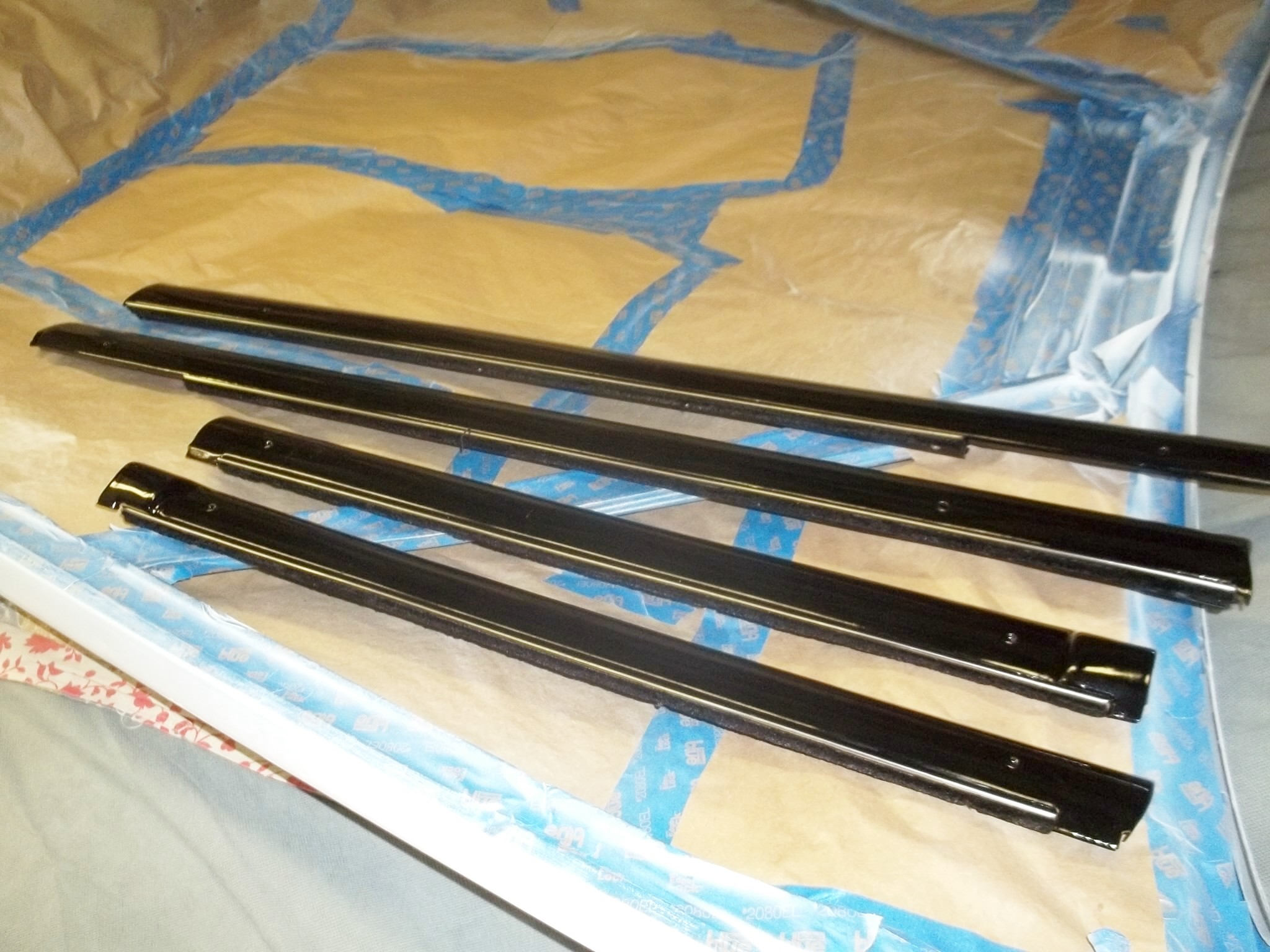

INSTALLED FUZZIES ON INTERIOR GARNISH MOULDING USING RIVETS THEN PAINTED BLACK.
STEERING COLUMN, A TOUGH INSTALL.

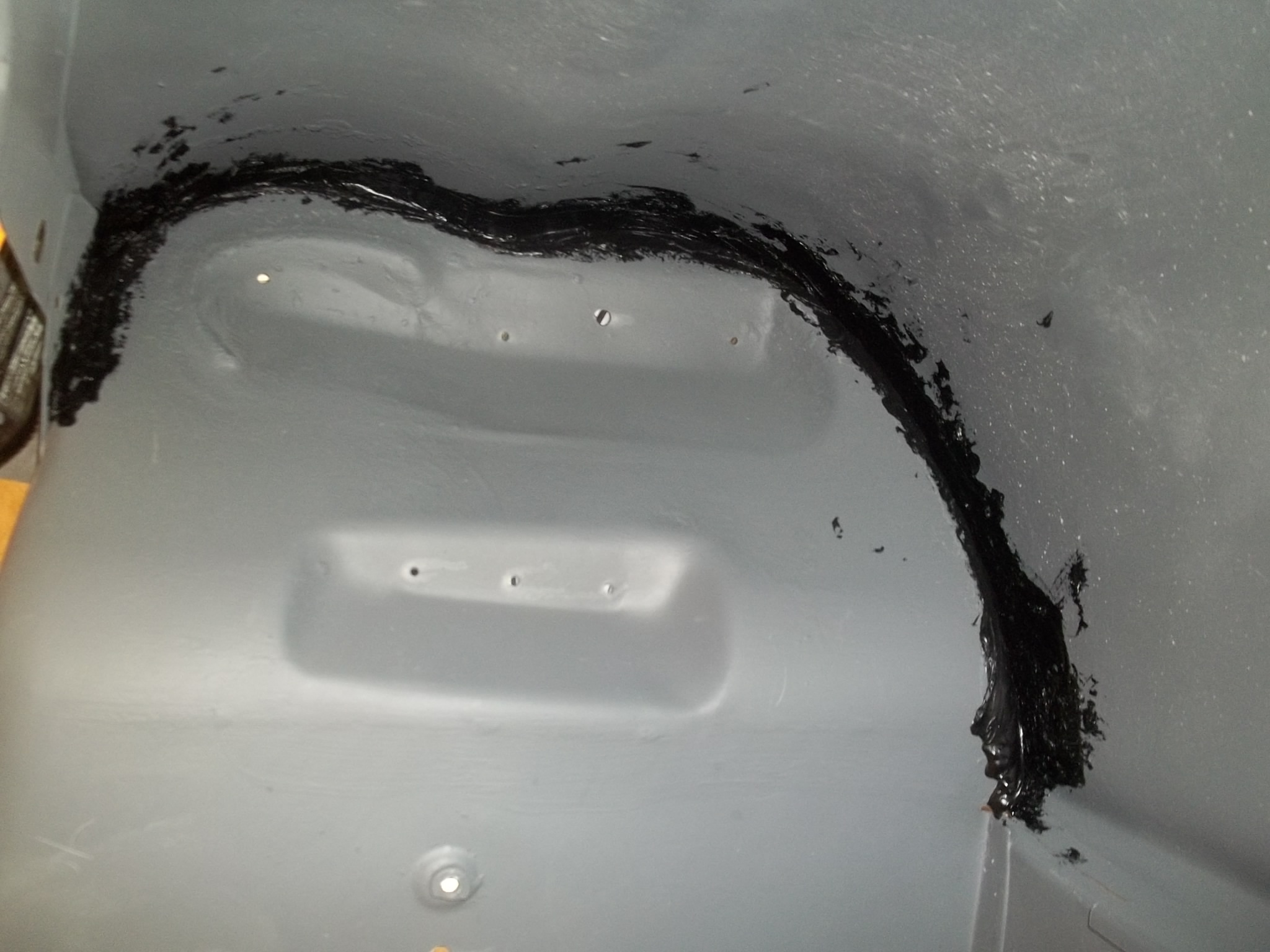

SEAM SEALER.

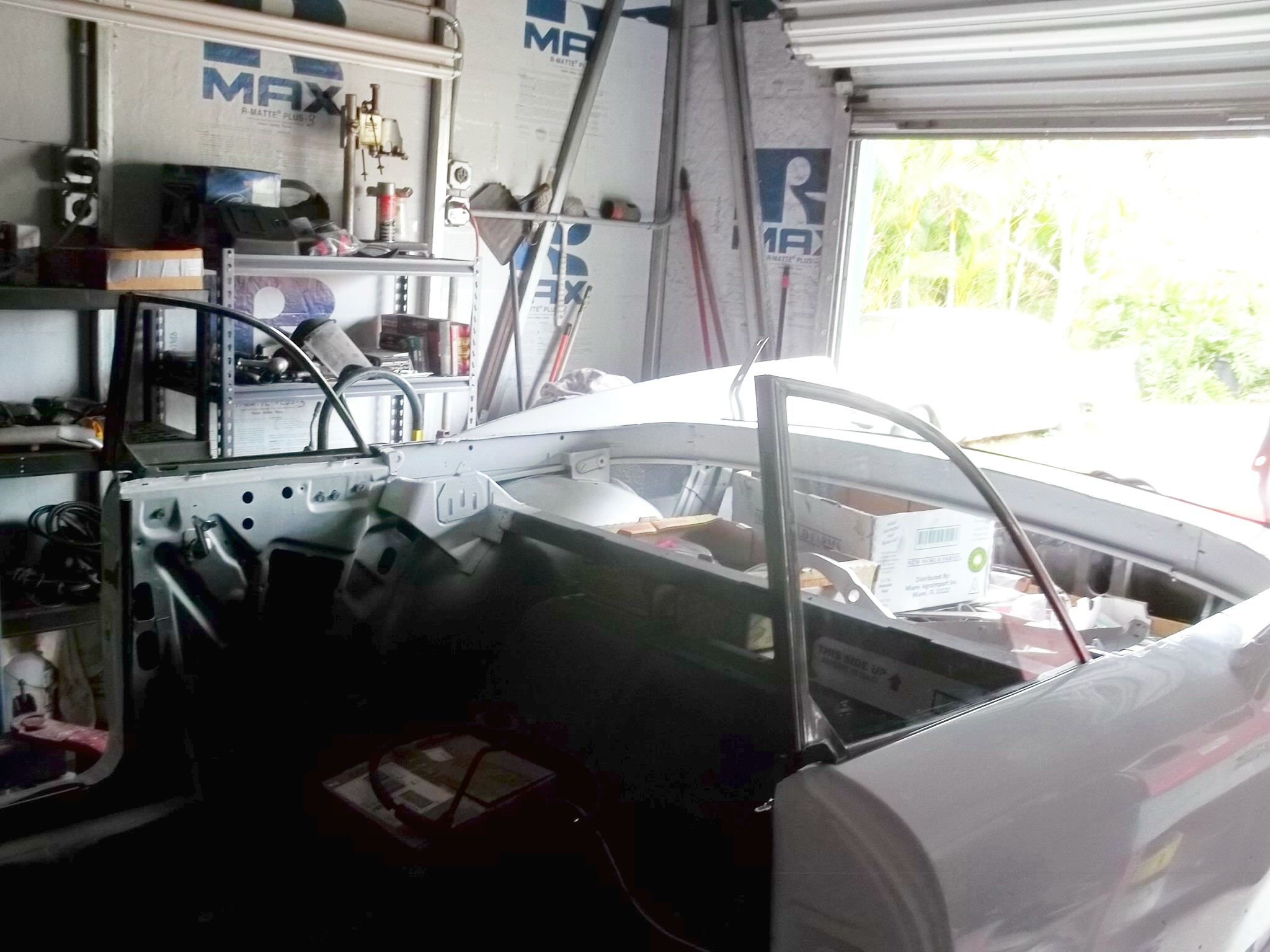

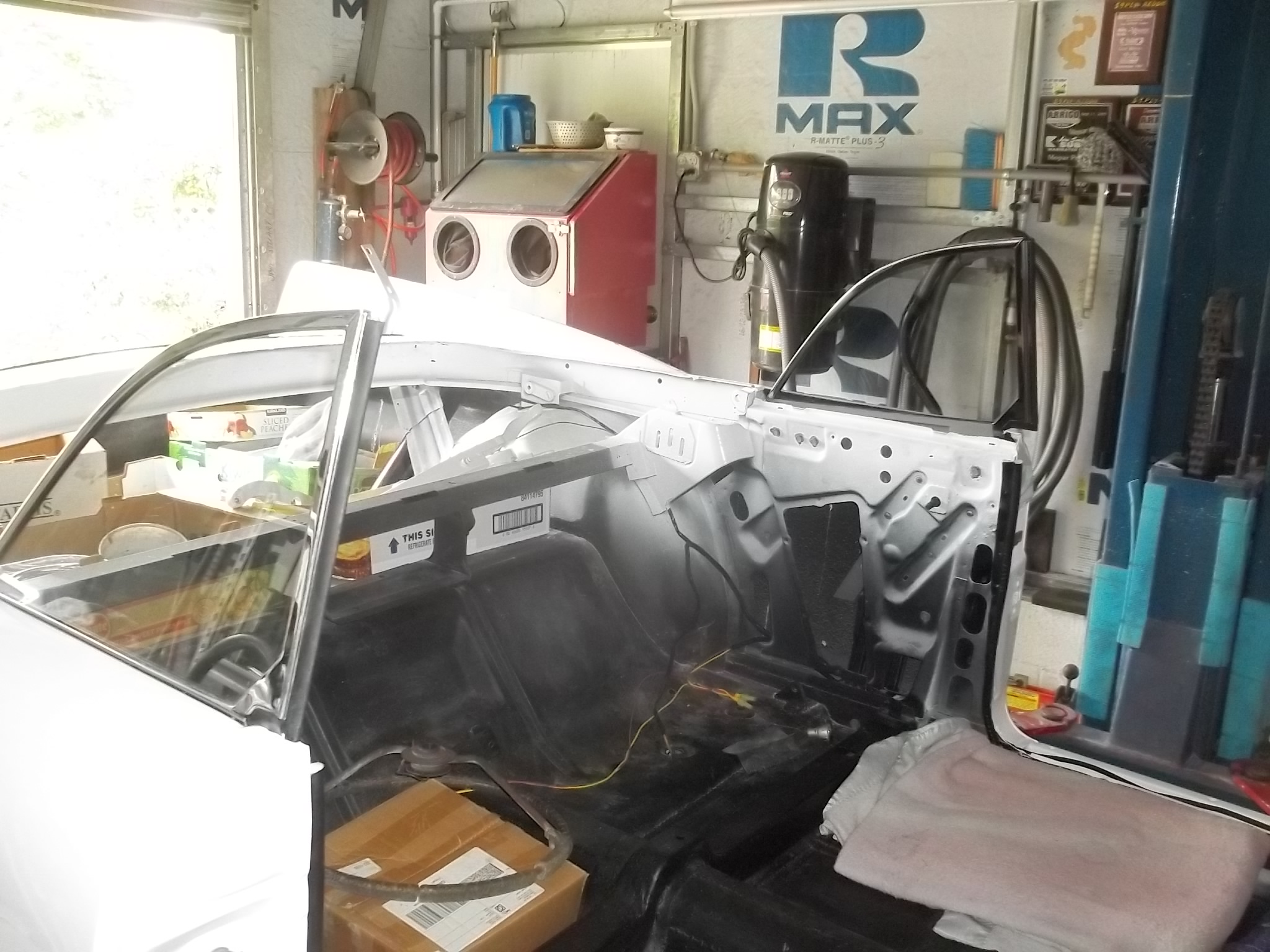

FEARED MOST, BUT GOTER DONE, CAN'T WAIT FOR THE DOORS.

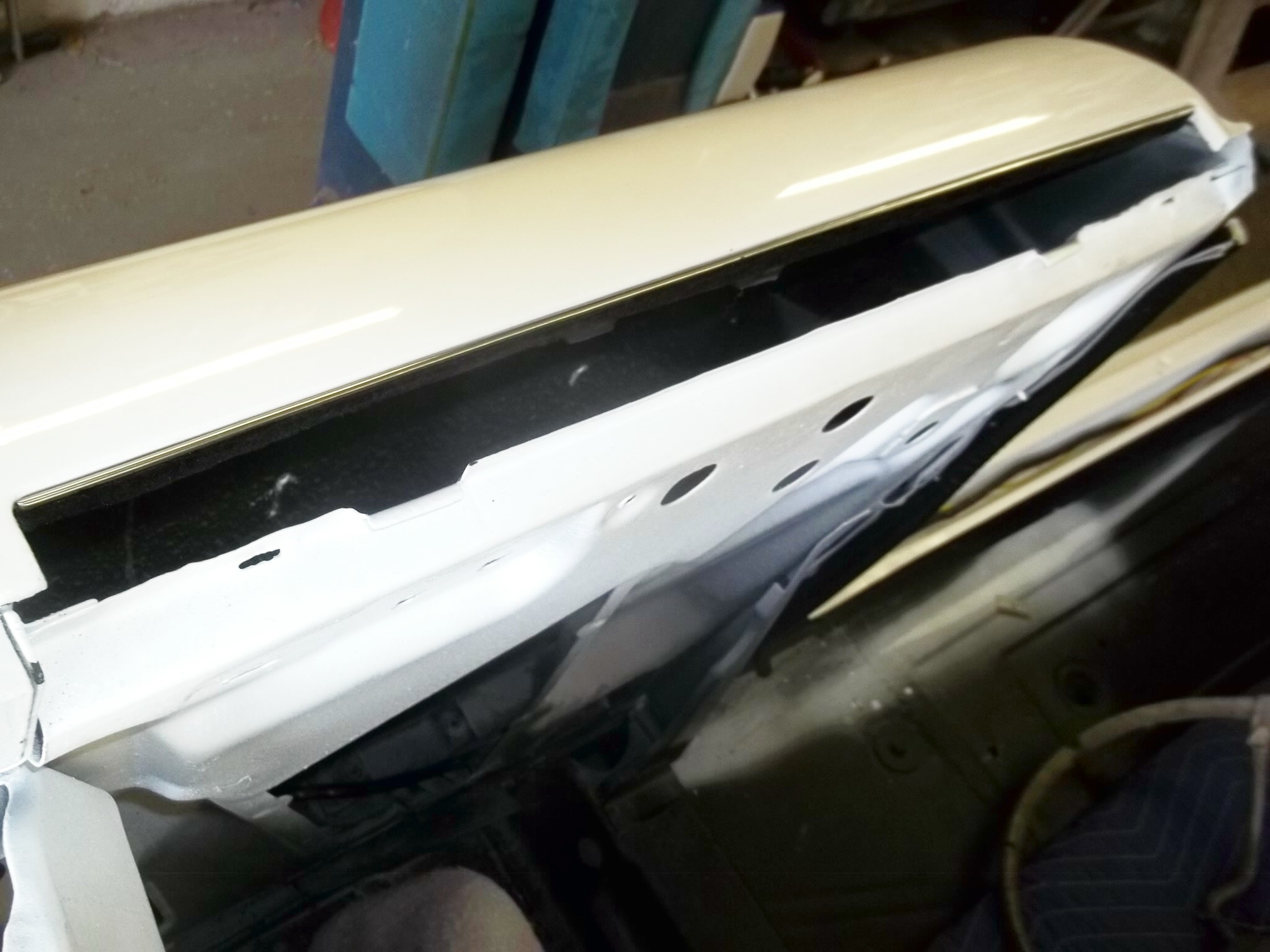

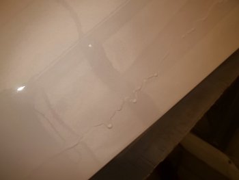

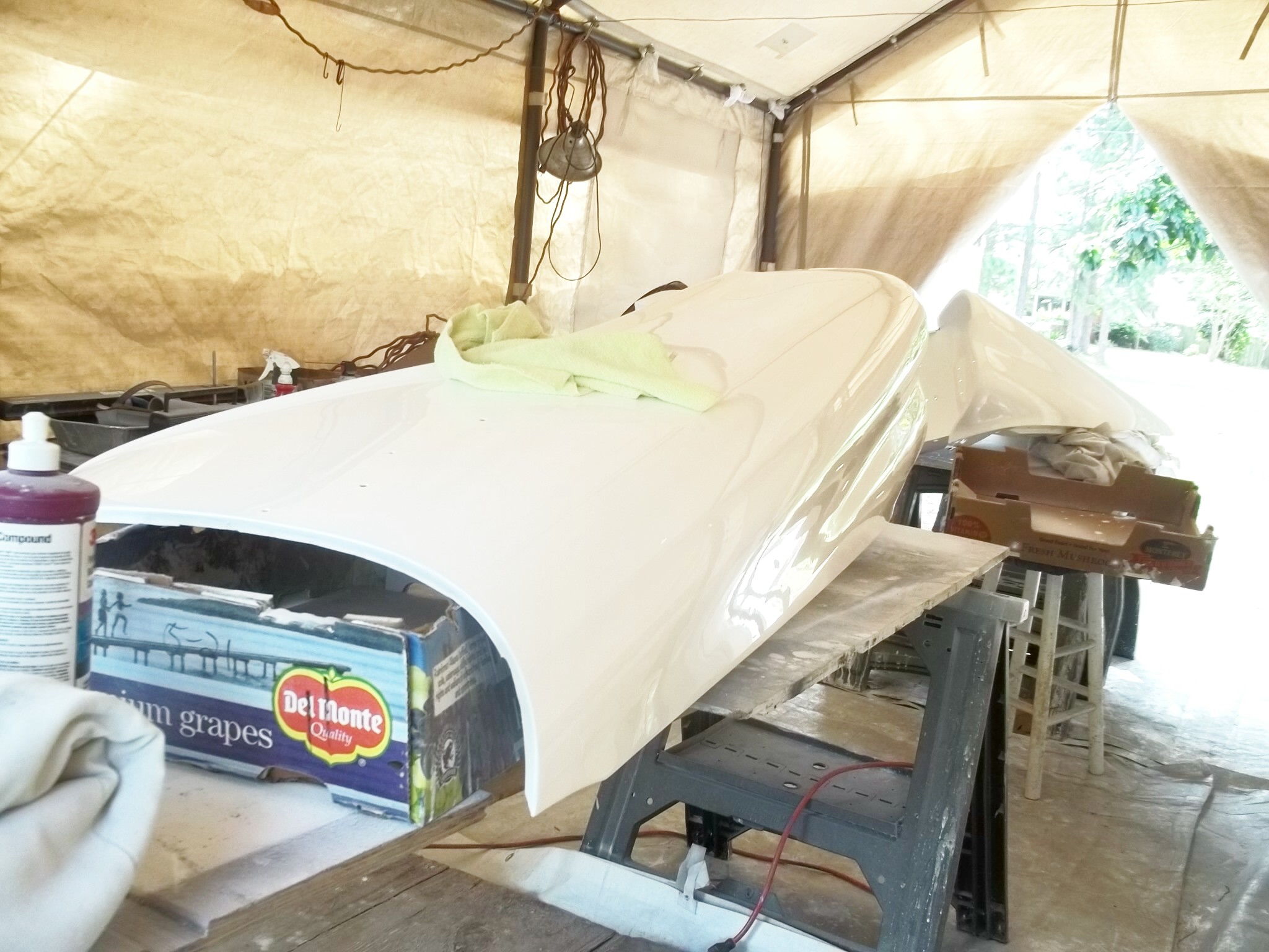

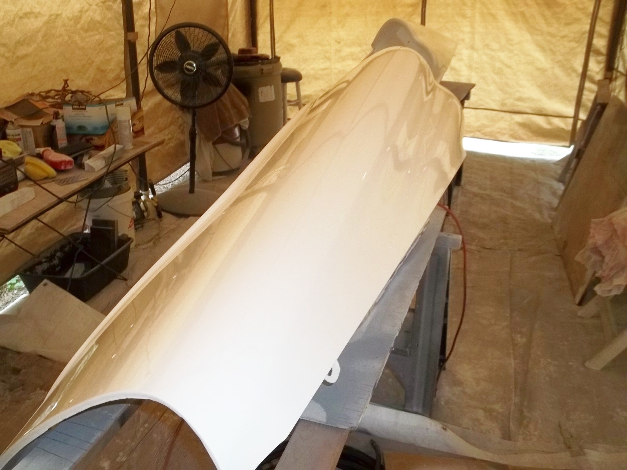

A PRETTY GOOD SHINE WITH 2000 GRIT WET OR DRY PAPER.
DRIVERS SIDE DONE.
BOTH SIDES DONE AND WORKING SMOOTHLY.
BUFFED AND SHINEY, SHINEY, SHINEY.

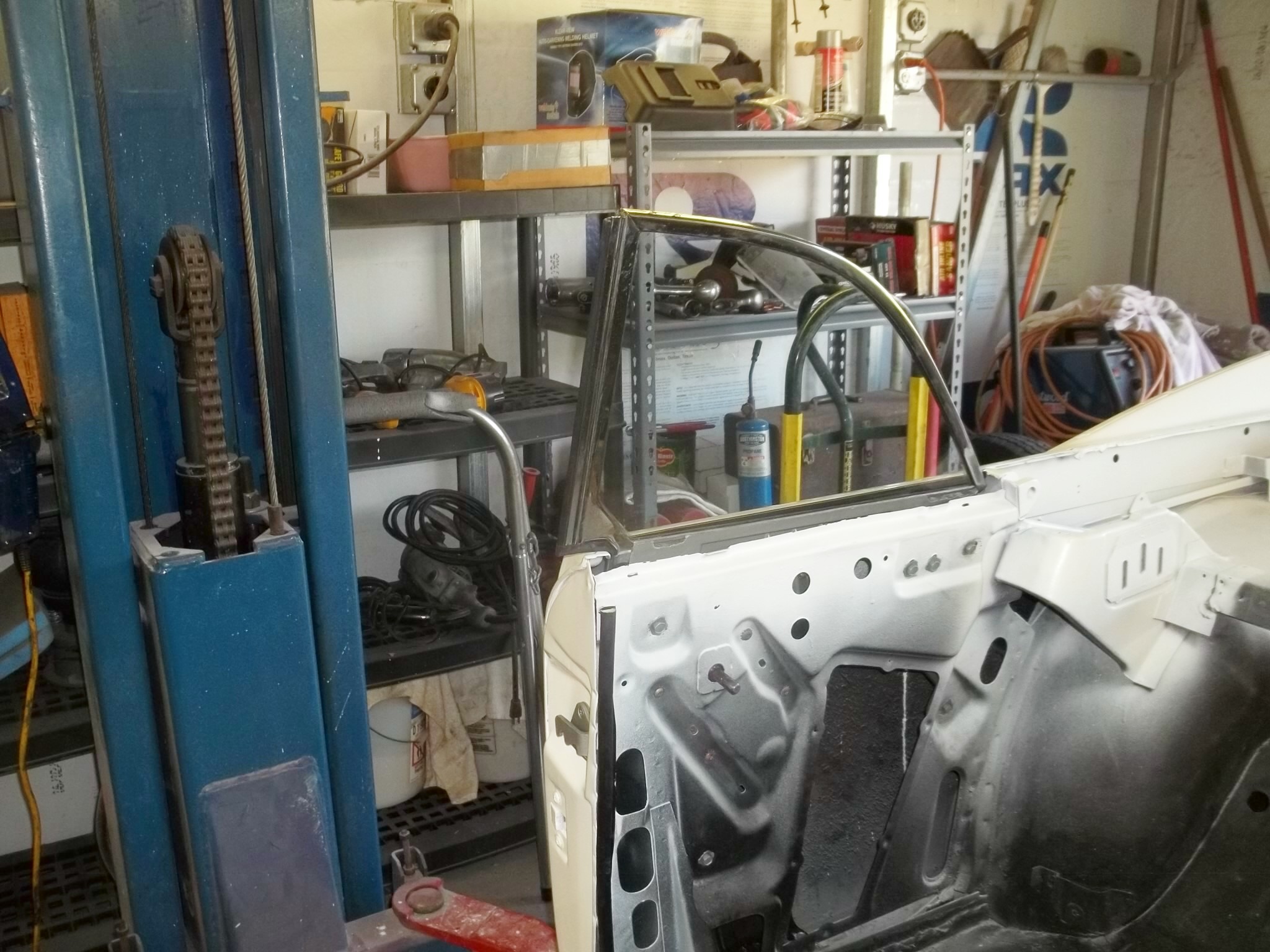

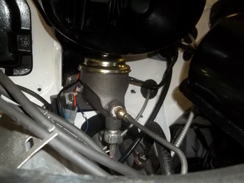

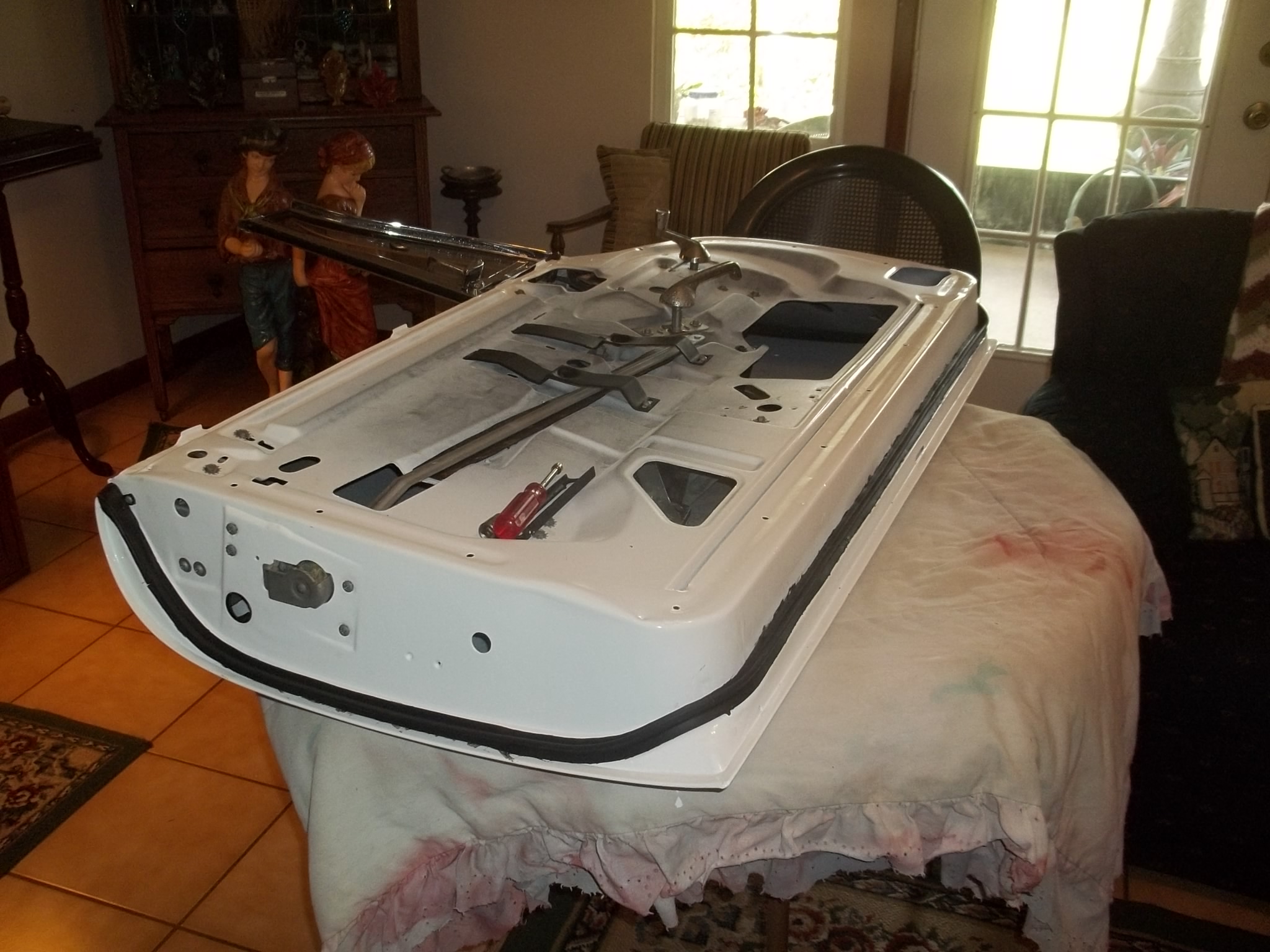

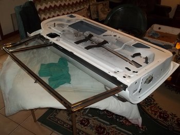

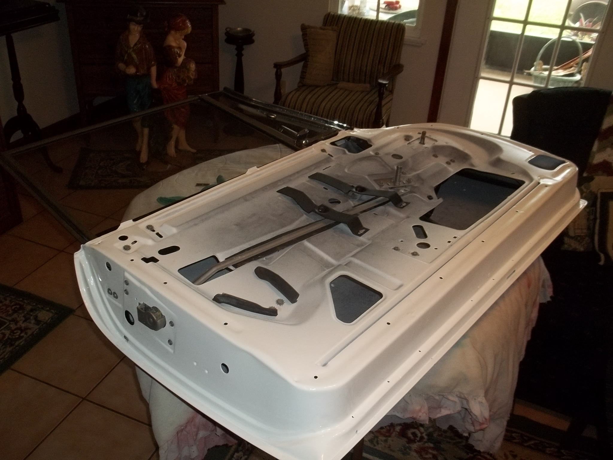

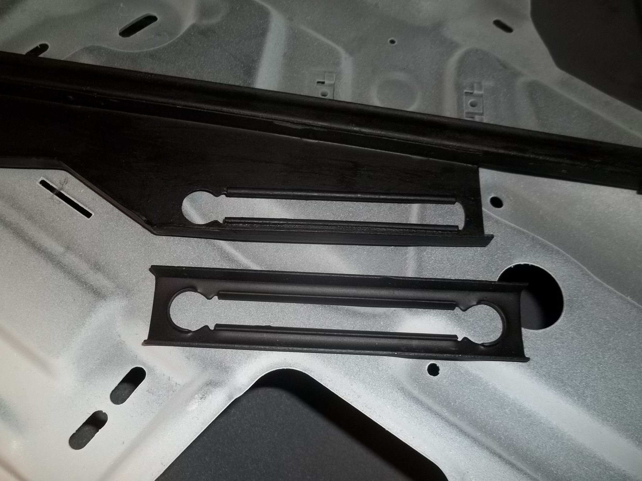

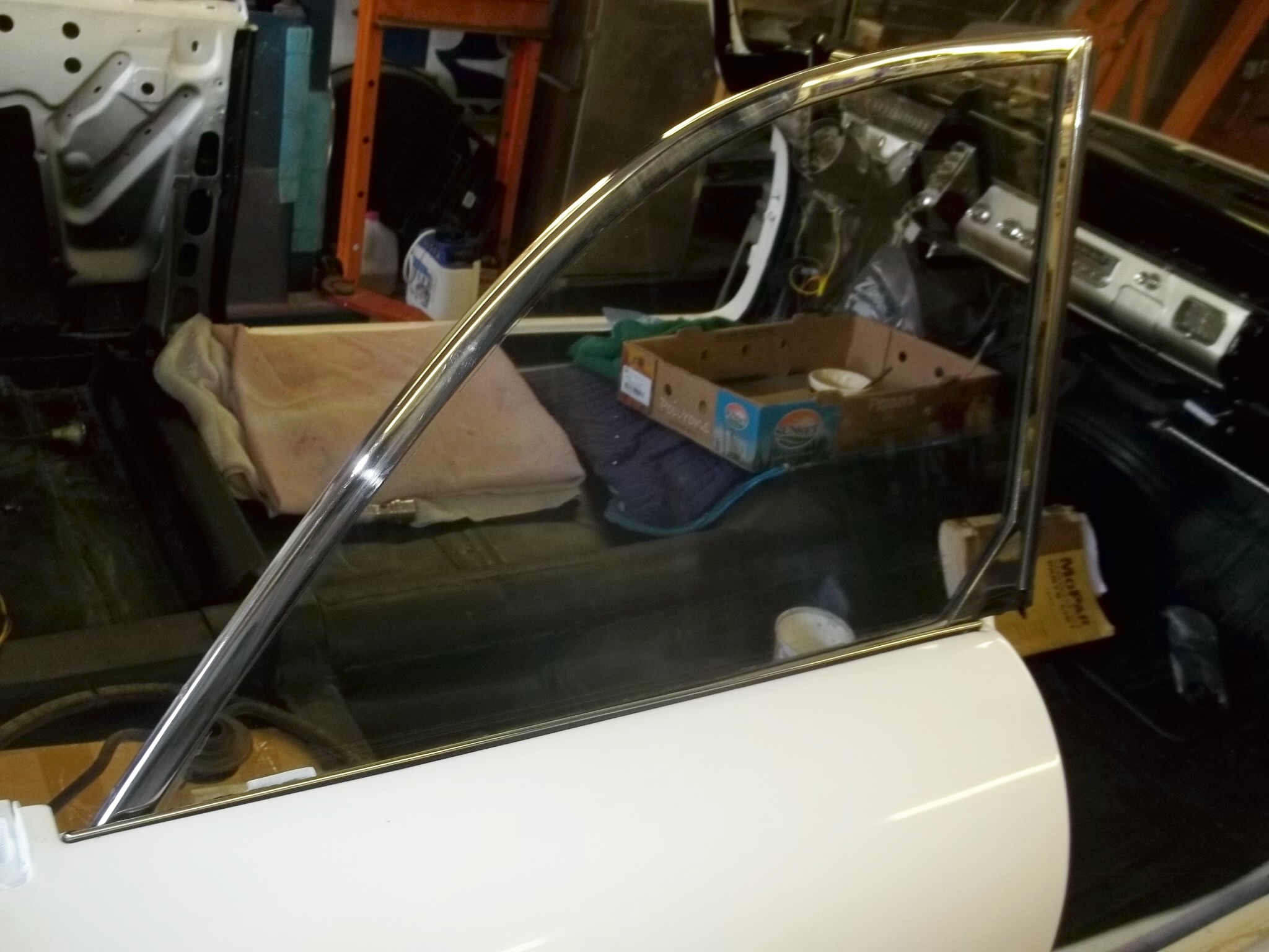

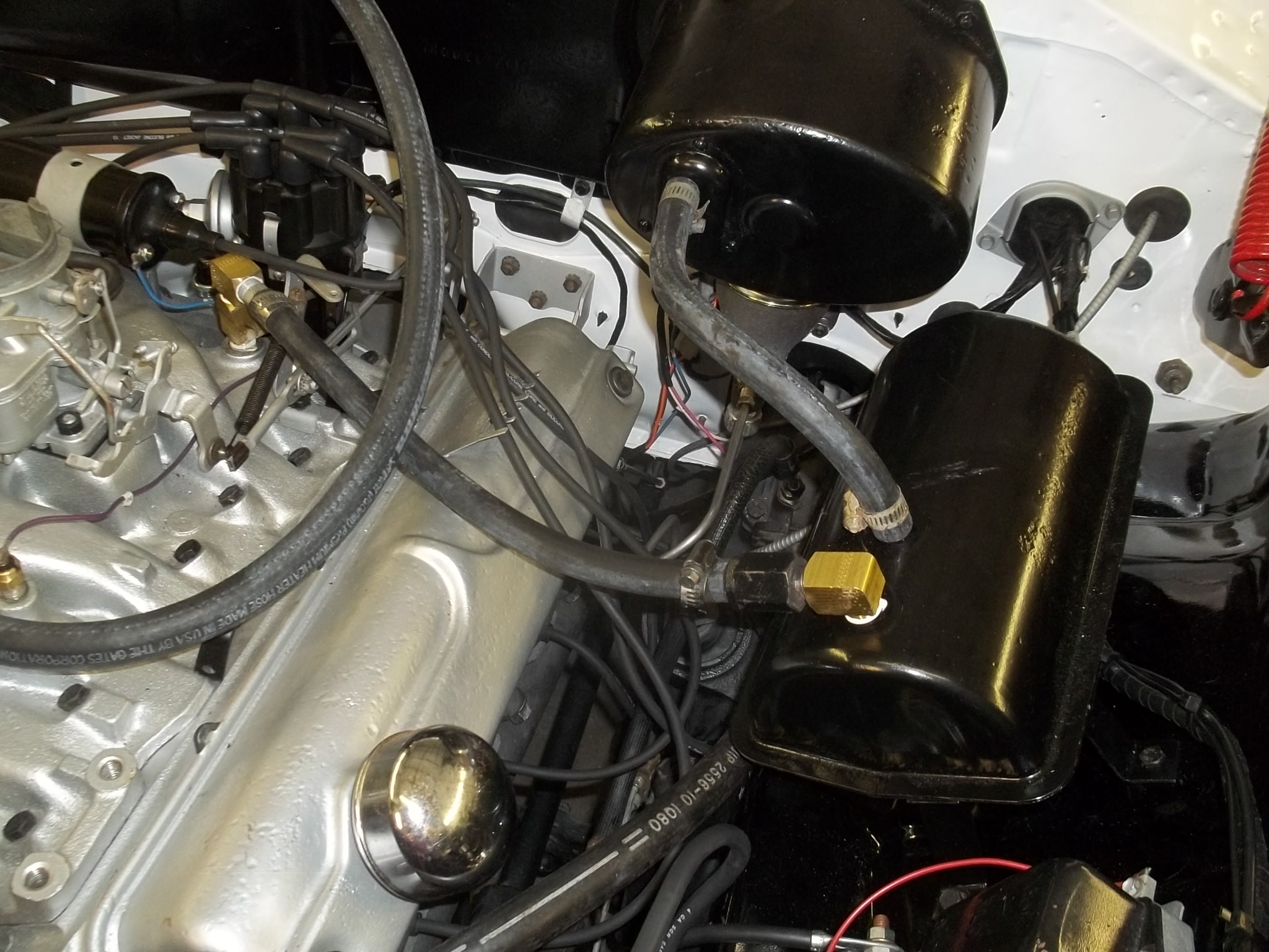

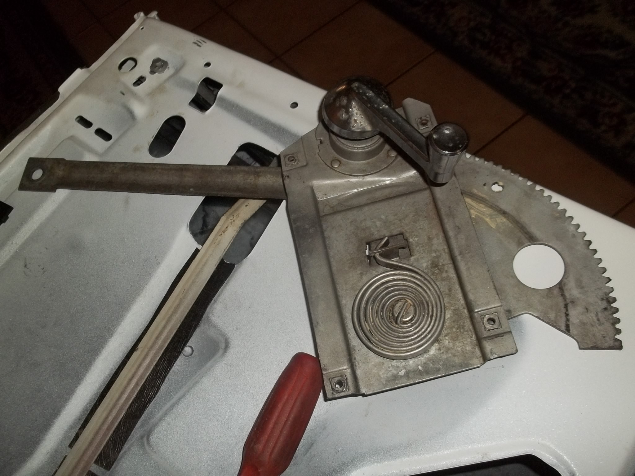

Hokay, here's some more. Completed the brake system, bench bled the master cylinder and connected all the brake tubing. I had three brake vacuum tanks and none were correct for 59 Plymouth, 59 Plymouth has a different leg arrangement for mounting than the ones I had. I used the one in my 59 Desoto parts car by bending the legs a little and drilling two mounting holes in the inner fender. Nobody will know except for usens! I thought that mystery part I inquired about looked kinda familiar, see picture 2429. Next I started to install the window mechanismes in the doors, starting with the right hand side. I kid you not, it took me four hours to fiqure it out and get everthing right only to find out the regulator I thought I brought back to life would jam every time I tried to turn it. I got it out after destroying all my previous work and could get it to work only when it wanted to, not when I wanted it to. So I set that door aside, immediately got on ebay and don't you know, the only one availabe for a two door hardtop, passenger side was there, it was listed buy it now, so I did, I received it today and can now finish the doors. I really learned a lot on that door so the driver side was a snap. The new glass runs make the windows hard to get up and down so hopefully they will loosed up with use. Also got the weatherstrip installed. The steering wheel was in great shape (from Keig/Morton) no cracks, sanded it, 3 coats appliance epoxy black and 3 coats clear. Came out pretty nice. I got the air cleaner from John Fowlie and sandblasted it along with the top holdown strips and painted them. Moved over to the hood and installed the latch mechanism, insulation and rubber seal. There are two convertible top parts suppliers in Florida but I ordered mine from an outfit in Californis, they cost less even with freight $16.00 and included a free Bledder valued at $42.00. I have the cylinders, motor and hoses installed and will include pictures next time.
MYSTERY PART.
Setting aside comments on your progress to inquire:
The UFO part...yes, it matches the cut-out on the window, but it's double-headed, whereas the actual window seems to have just the one end matching?
The problem with reproduction window seals is they are not "flocked" as were the originals. Flocking cut ssown on surface friction. I don't know how flocking is achieved, if you could do it, it would make a huge difference.
