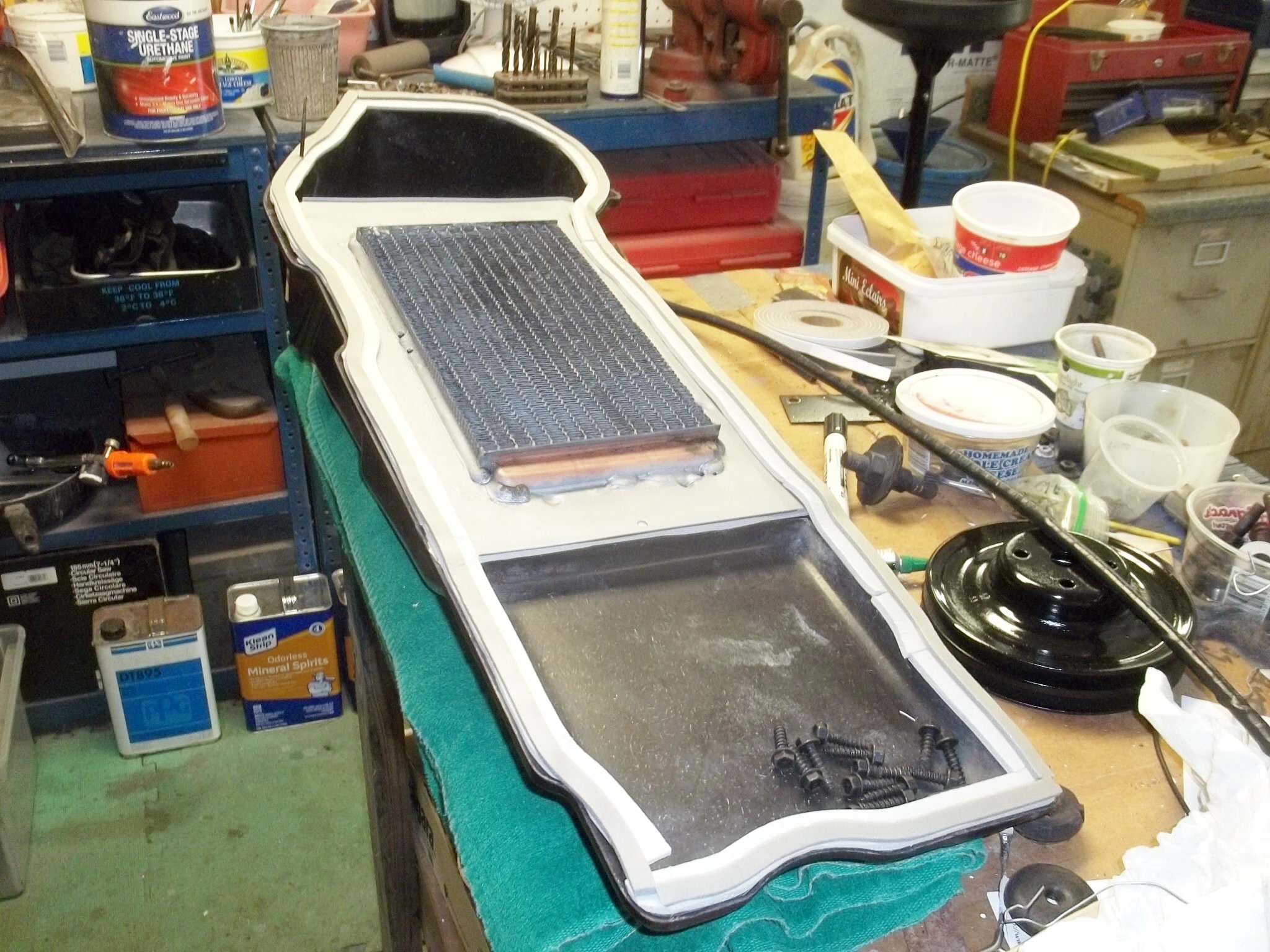

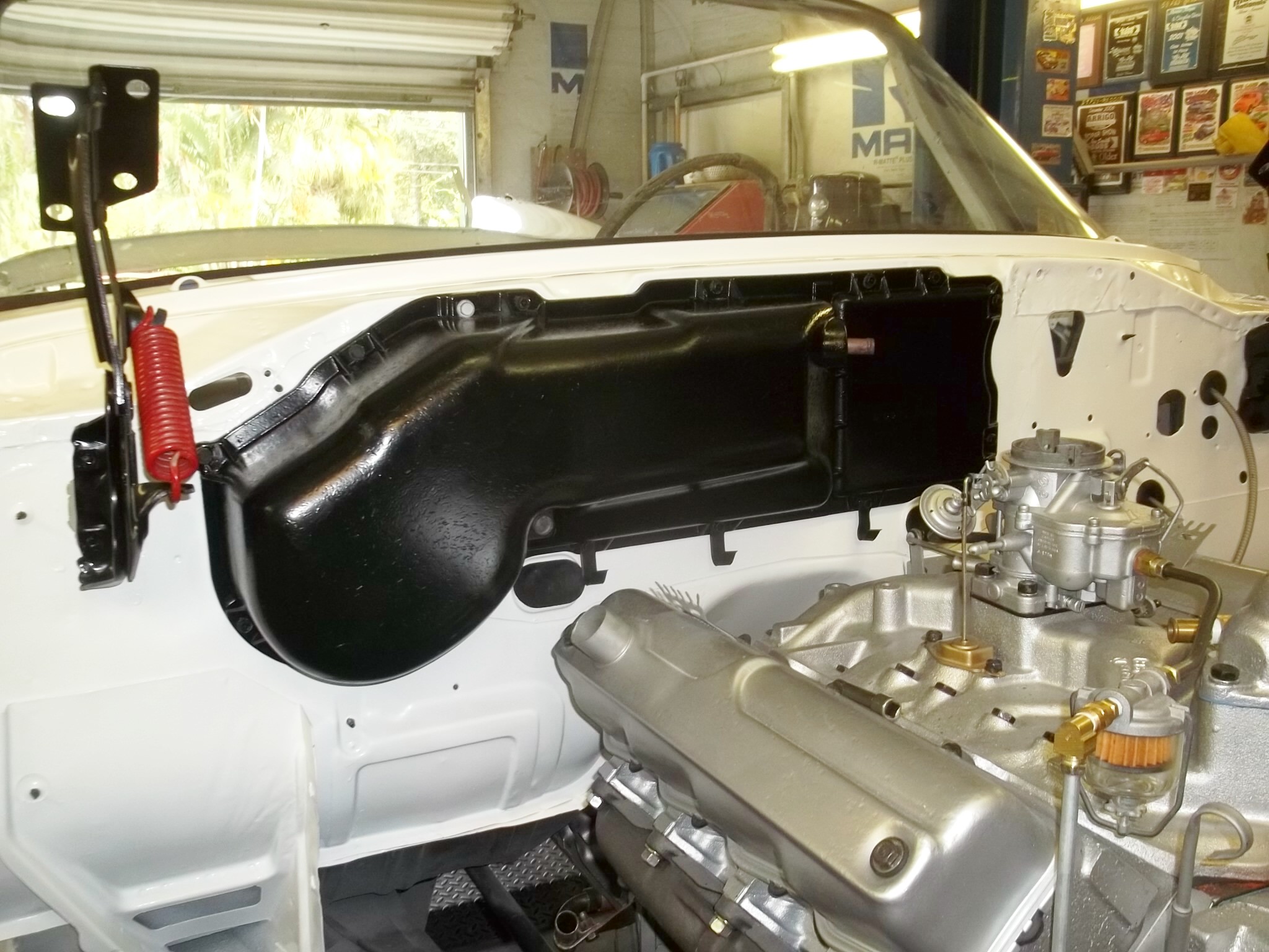

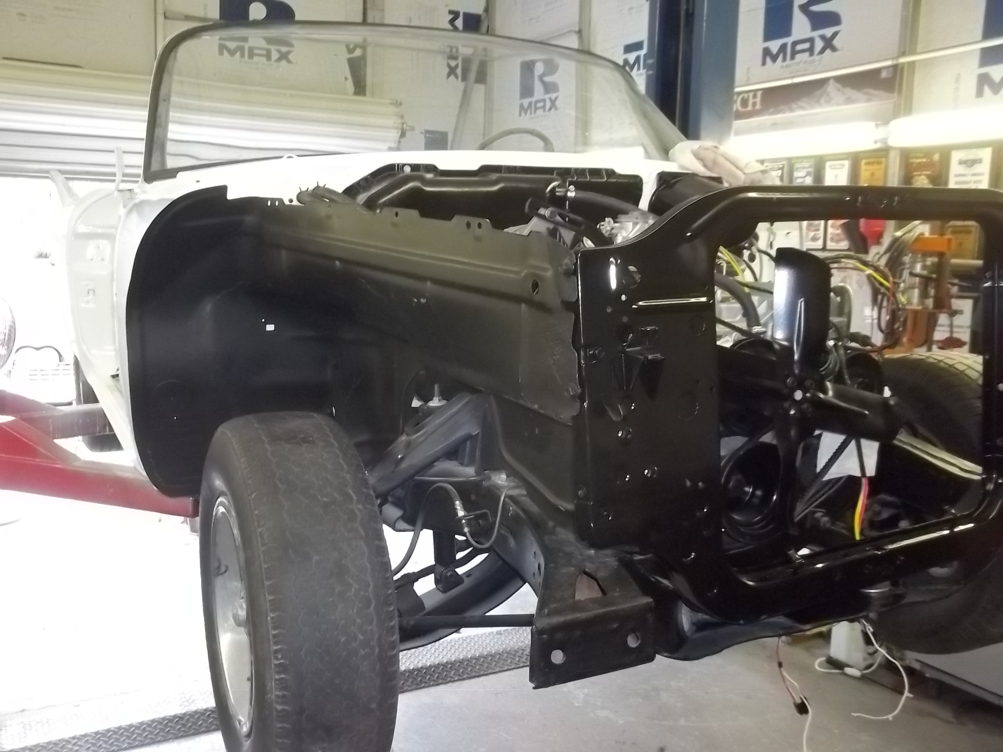

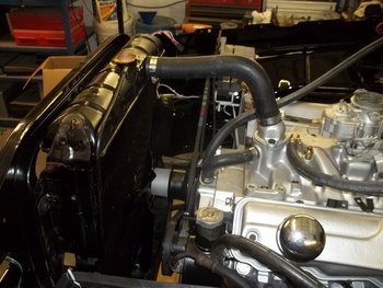

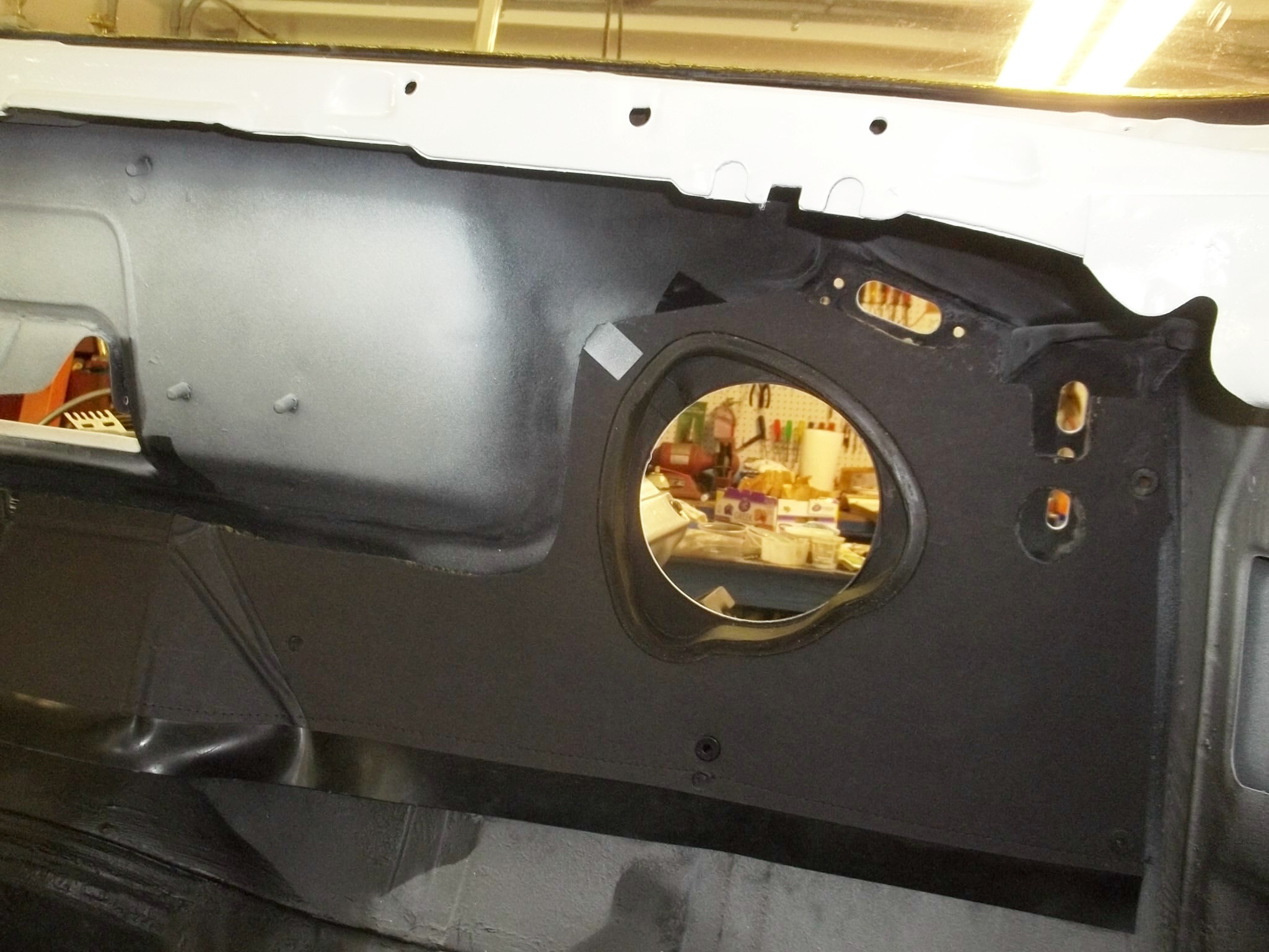

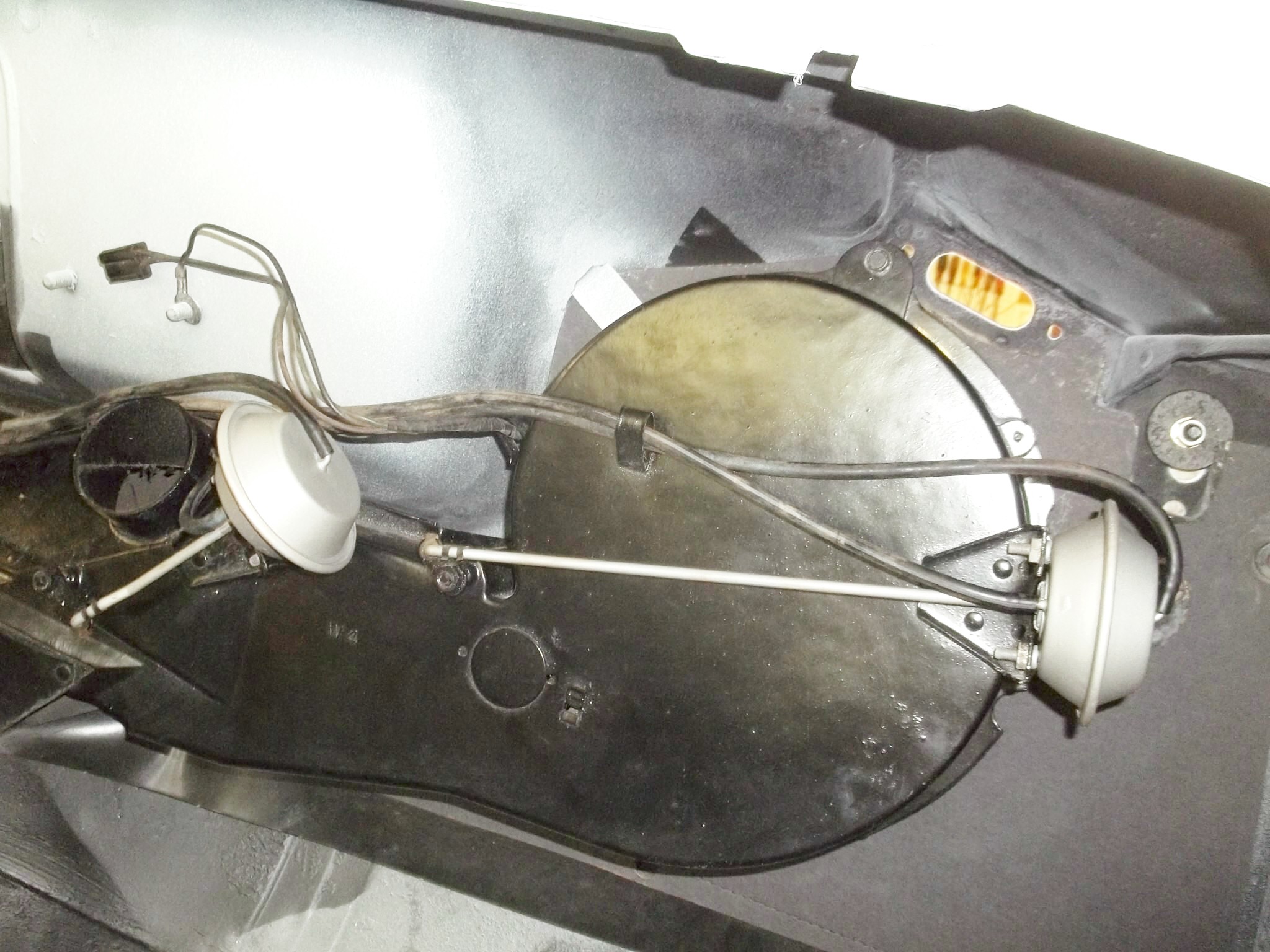

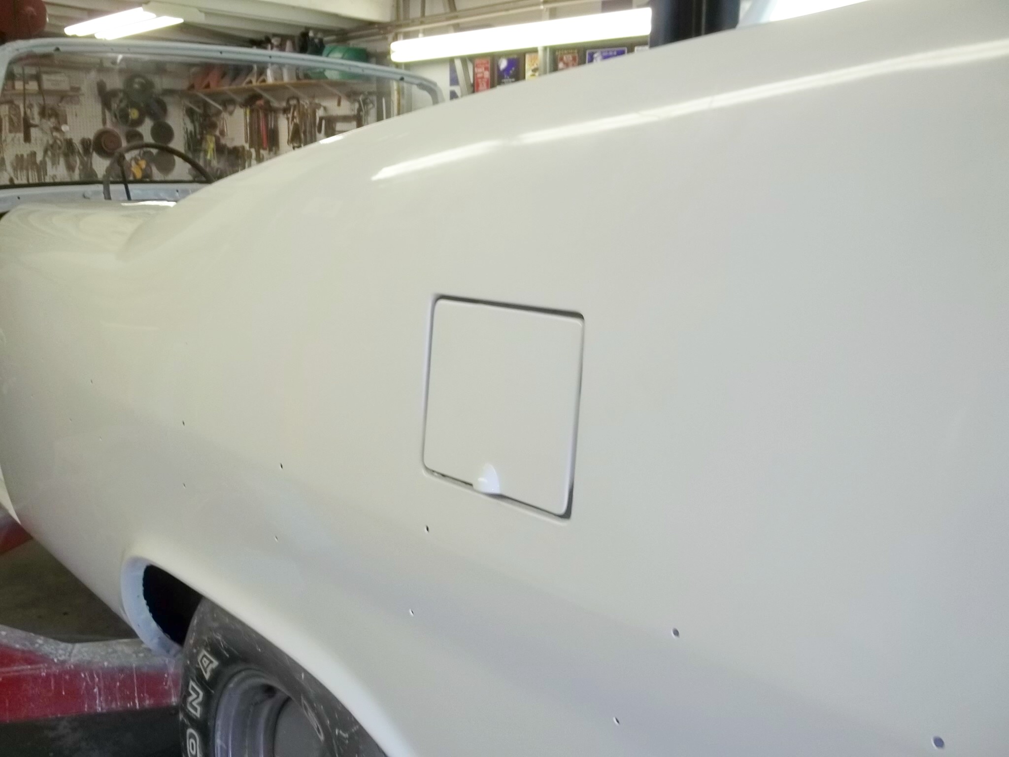

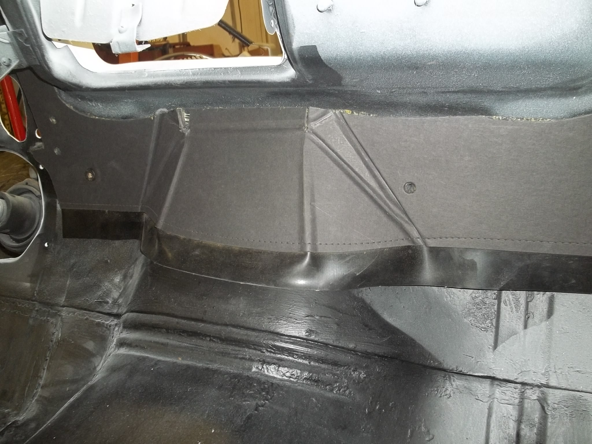

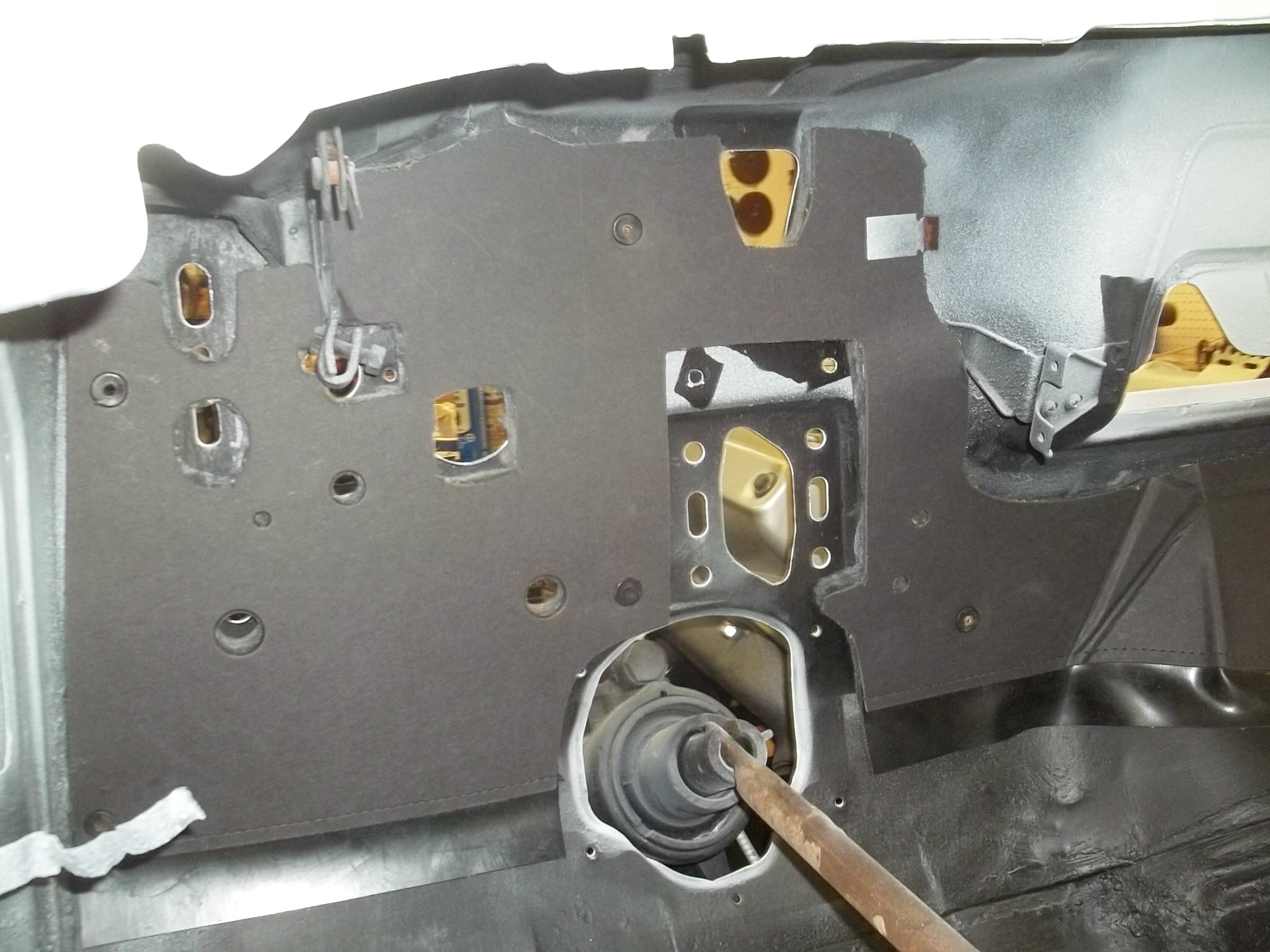

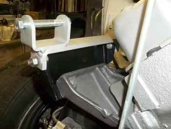

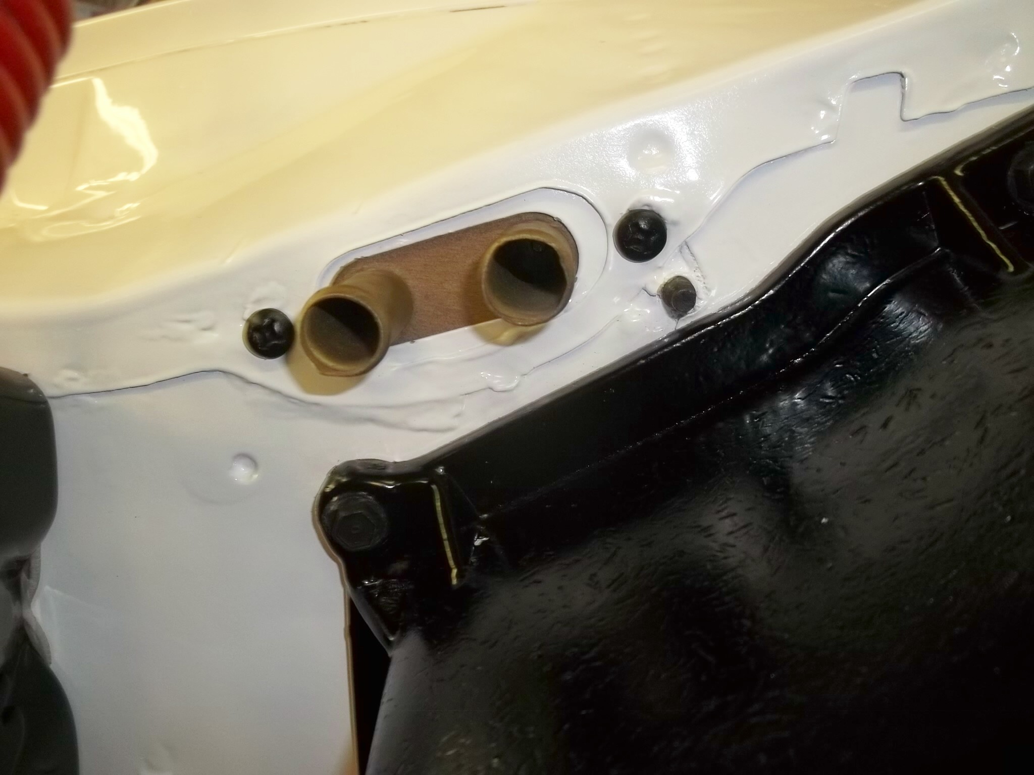

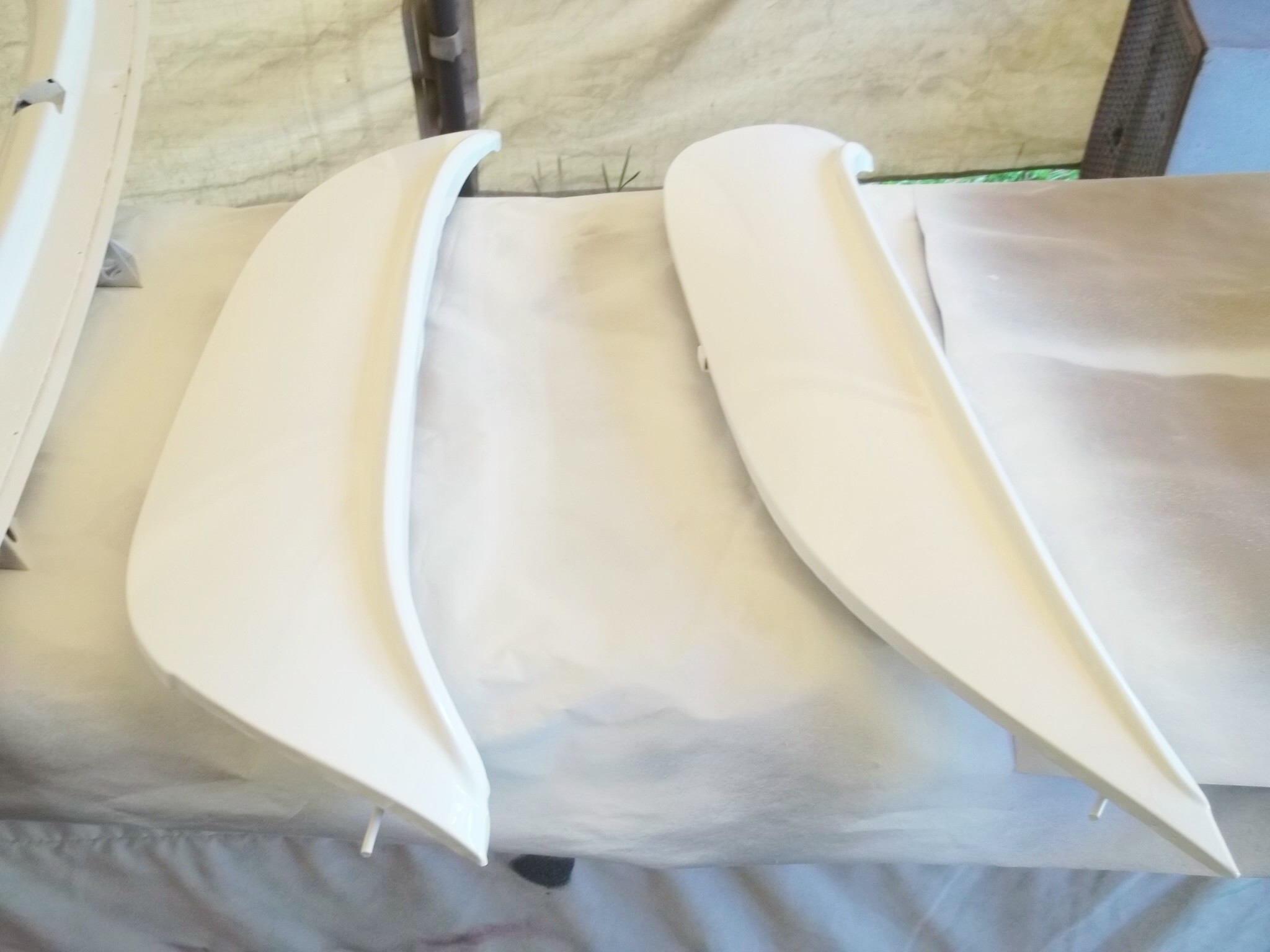

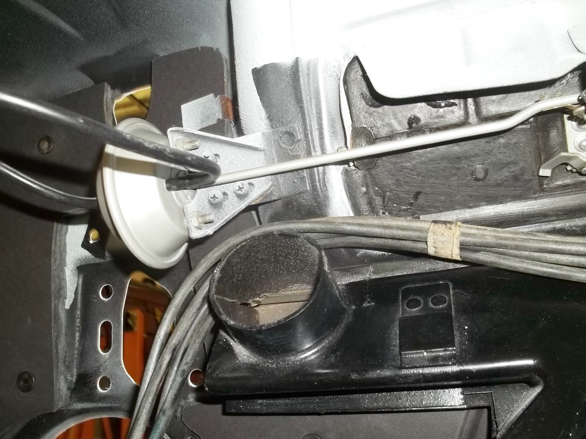

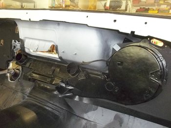

Mo pitchuhs - Got the body repainted, came out pretty good this time. Everything is painted except the front fenders. Was paid a nice visit by Mark Evans and his wife but they were unable to stay long, had to catch a flight back home. Took them for a ride in Charleen but I have to apoligize to Mark for the rought ride. Unbeknownsttome the right front tire was in the process of seperating and the vibration was pretty bad. I took a chance and went to my clubs weekly car show (20 miles one way) and made it there OK but on the way home the tire went flat on the turnpike. Fortunatly I found a relatively wide spot to change the tire. Question, have any of you ever changed a tire by brail? The only light was occasional flases of light from passing cars and trucks. Didn't think I had a flashlight but the next morning when putting the trunk back in order I found two of those suckers. Go figure. Installed a brand new firewall insulation board from Gary Gorers (perfect fit). Installed the inner plenum I saved from my 60 Desoto and the fresh air vent door rebuilt by Gary Gorers (great job). Next I installed the heater core and engine bay plenum, the hood hinges and the power brakes vacuum chanber. Installed all the vacuum actuators and hoses, parking brake cable, shifter cable, got all the accelerator and kickdown linkage installed (correctly I think). speedometer cable. Broke out the wiring harness from YNZ (they make it easy). installed the taillights, license light and connected wiring. Installed gas filler door and Belvedere emblems on rear fenders, Got fan and pully on, installed V-belts, spark plugs and wires, distributor, coil, and on and on and on. I'm exhausted and I'm going to bed will post pictures and finish tomorrow.

ALTERNATOR BRACKET, GOT ON EBAY.

Dick, A question for you on the interior installation part of the heater box install. What length metal screws did you use at what location on the box? On my car I had two different length screws to work from.
It seems like that due to the internal slope of the inside firewall, That the smaller screws should be used on the top part (or so I believe) and the longer screws are to be used on the bottom part of the heater box when attaching it to the interior fire wall. (I did use the hollow out bell end ferrules as stand offs that were on the heater box when I took it off)
Just want to make sure I did mine correctly...
thanks!
John - I went and looked at the inner plenum on my car, there are three screws with ferrules to prevent it from crushing the firewall insulation board. The screws and ferrules are all the same length. One mounts above the fan housing right next to the water valve, one mounts at the bottom of the fan housing and one mounts at the very far end of the plenum. If it hasen't fallen out yet you did it right. :lol: :lol: :lol:
Thanks! It has not fallen out yet but I had ferrules of two different lengths..... I do have some more that I can make all of them the same length. Looks like another winter project to do!!!

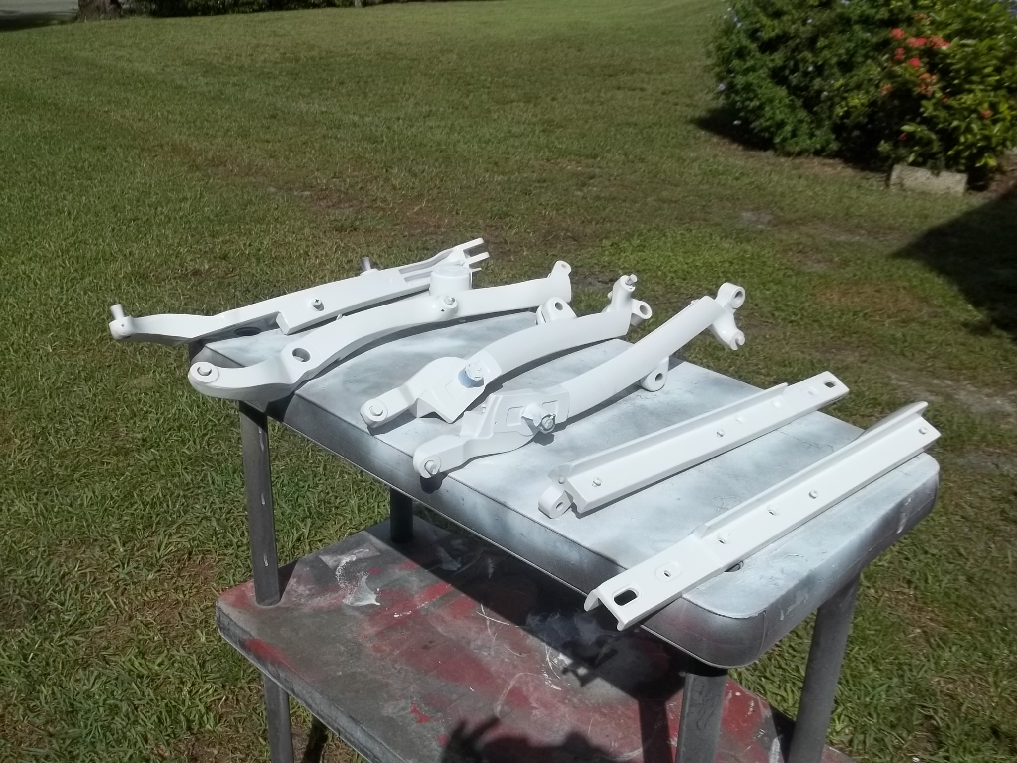

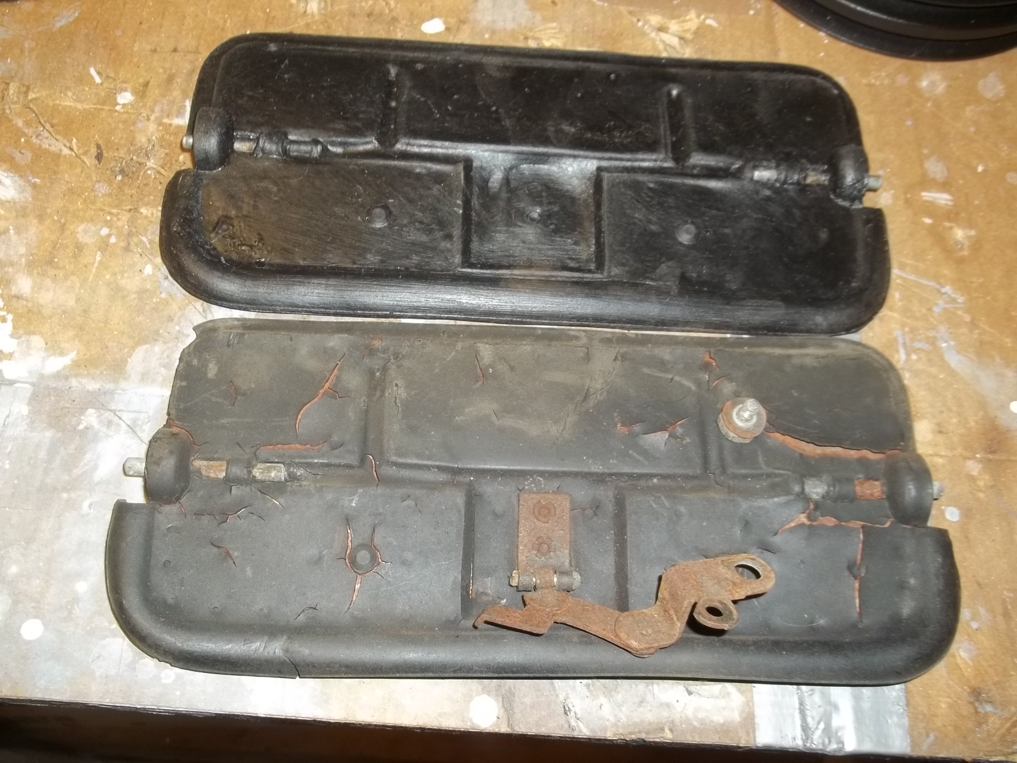

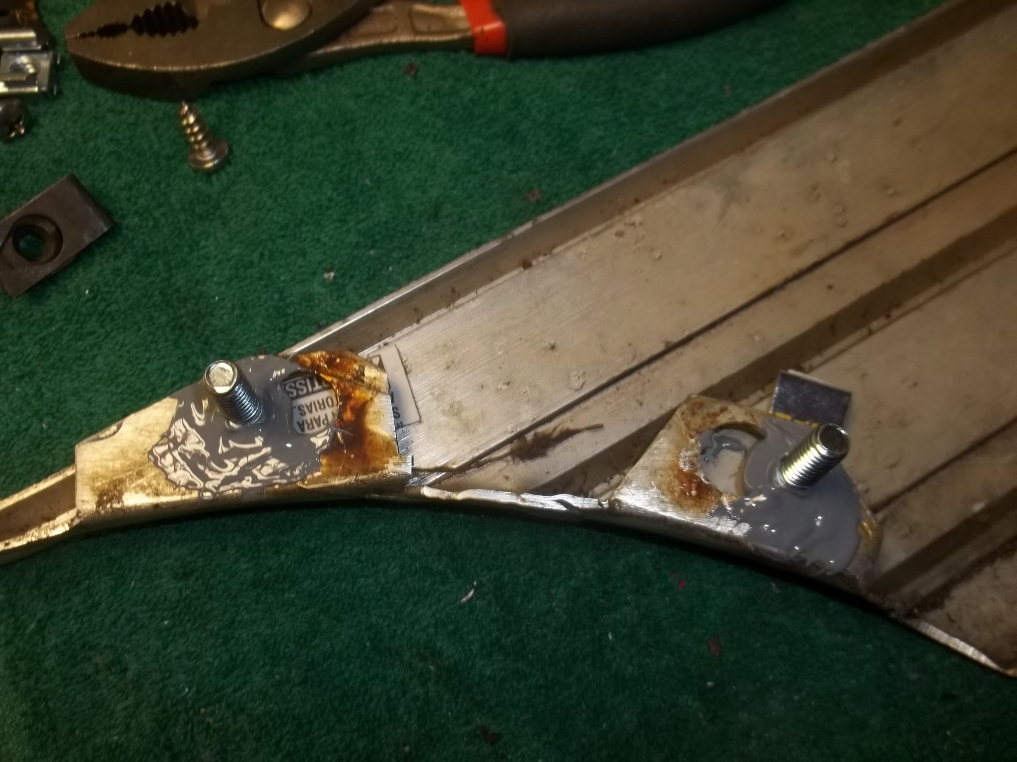

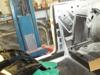

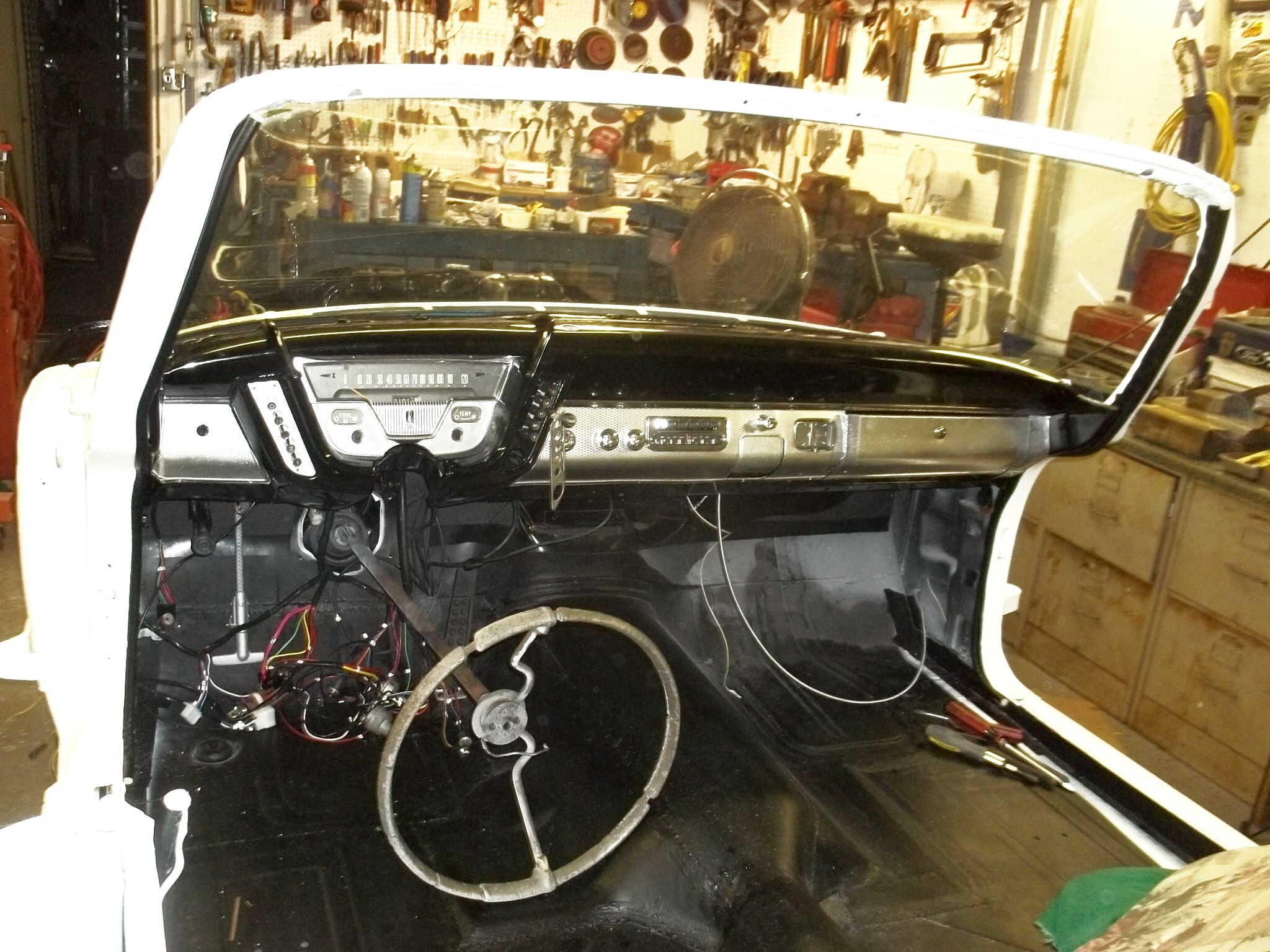

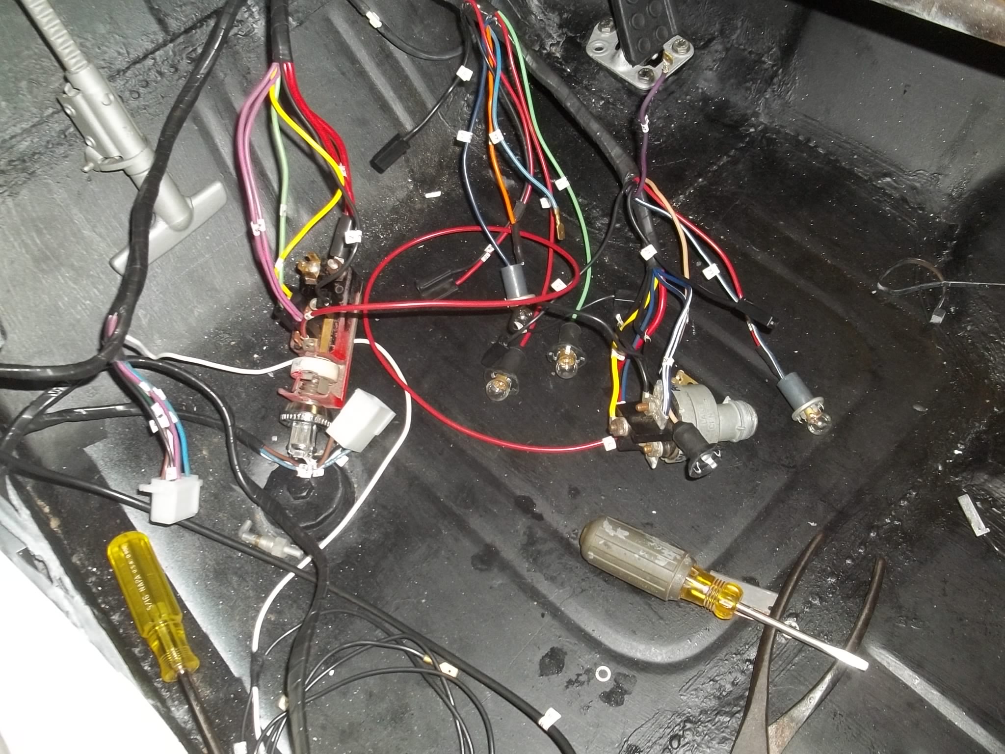

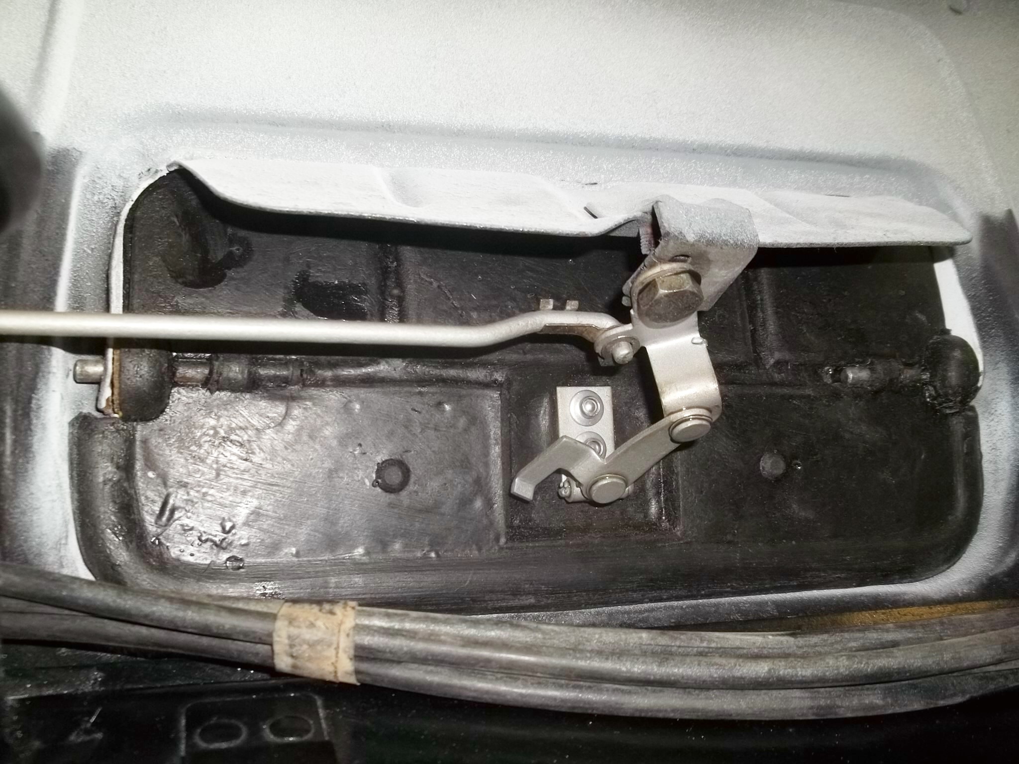

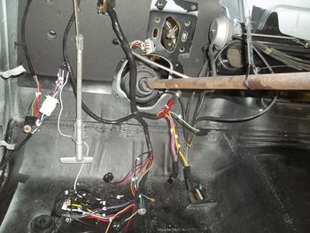

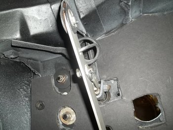

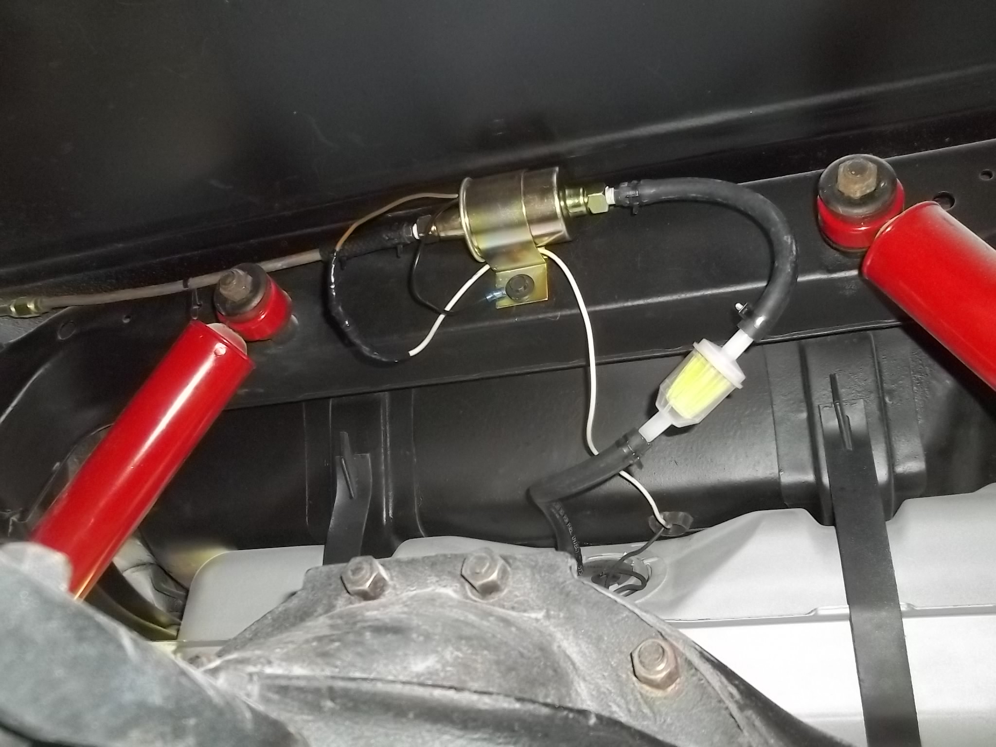

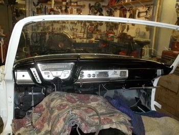

Listen up allayall, never, never, never install the dashboard before you install the door weatherstrip. there are two little pieces of metal that holds the weatherstrip in place at the sides of the dashboard (see pictures). I wondered why the weatherstrip kept falling out in that area on Charleen. Also always make sure you install the wiper motor and arms and the heater valve operating cable before you install the dash. AARRRRGGGGHHH!!!! Roger you commented about me knowing what I was doing, I wish. I also insalled an electric fuel pump so I don't have to crank and crank and crank all the time. The convertible top aluminum frame pieces adjusting screws were frozen in place and they all broke off so I took all the pieces back to the machinest for repair and replacement, they did a wonderful job. I so happy, it's starting to look like a car.
TAIL LIGHT INSTALLED AND WIRED.
FUEL SENDER INSTALLED, HOPE IT WORKS.
IN LINE ELECTRIC FUEL PUMP, SWITH ON DASH, FOR PRIMING ONLY.

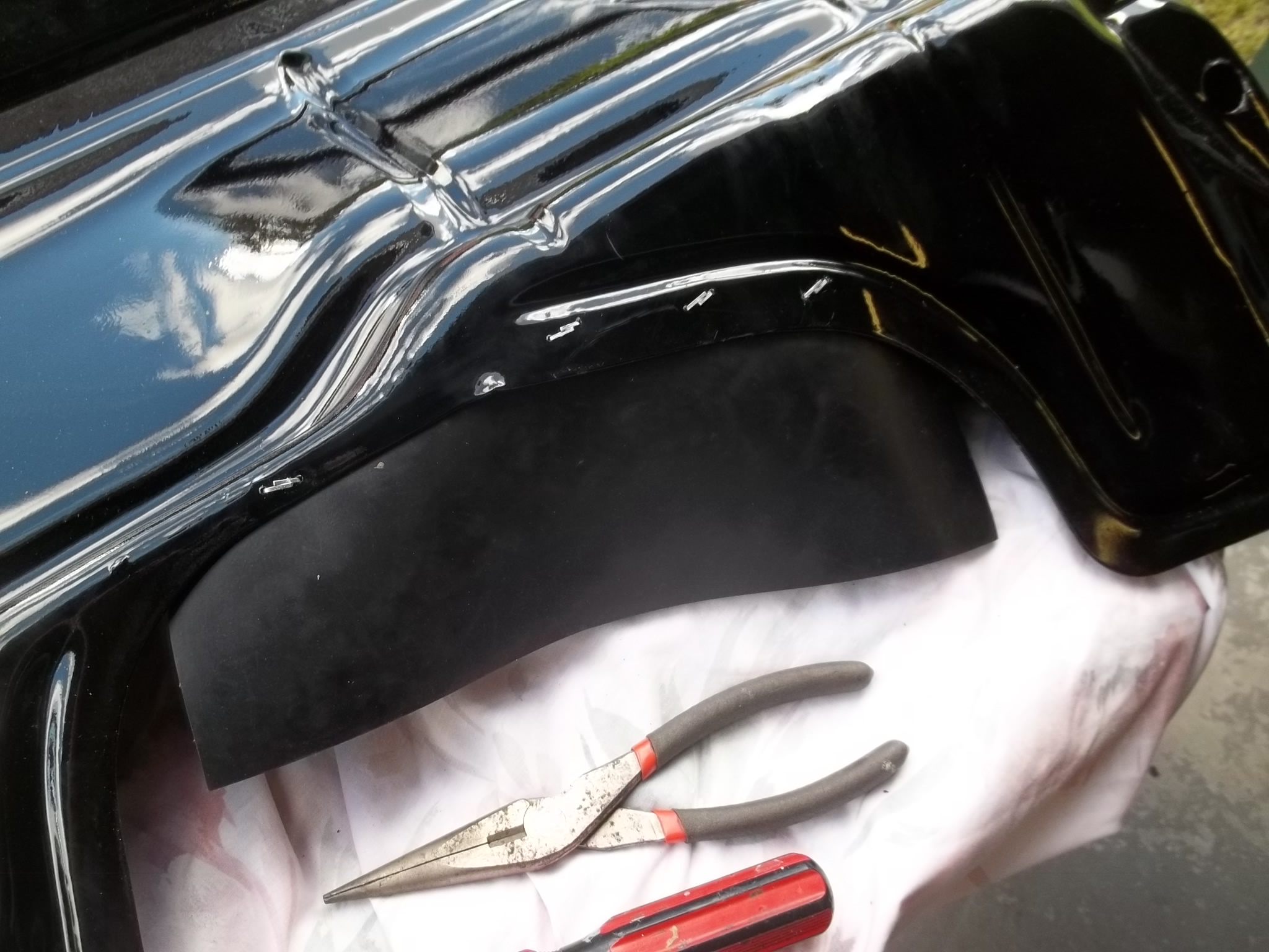

RADIATOR SUPPORT RUBBER MOUNTS.
ALUMINUM CONVERTIBLE TOP FRAME PIECES.
ADJUSTING SCREWS

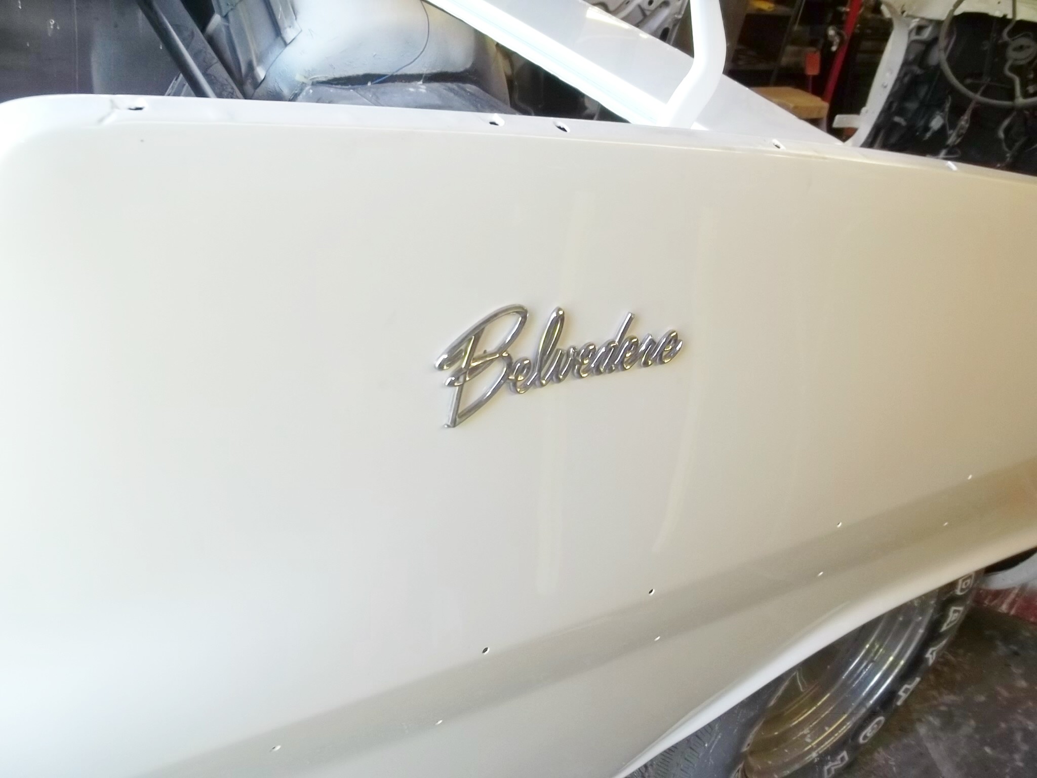

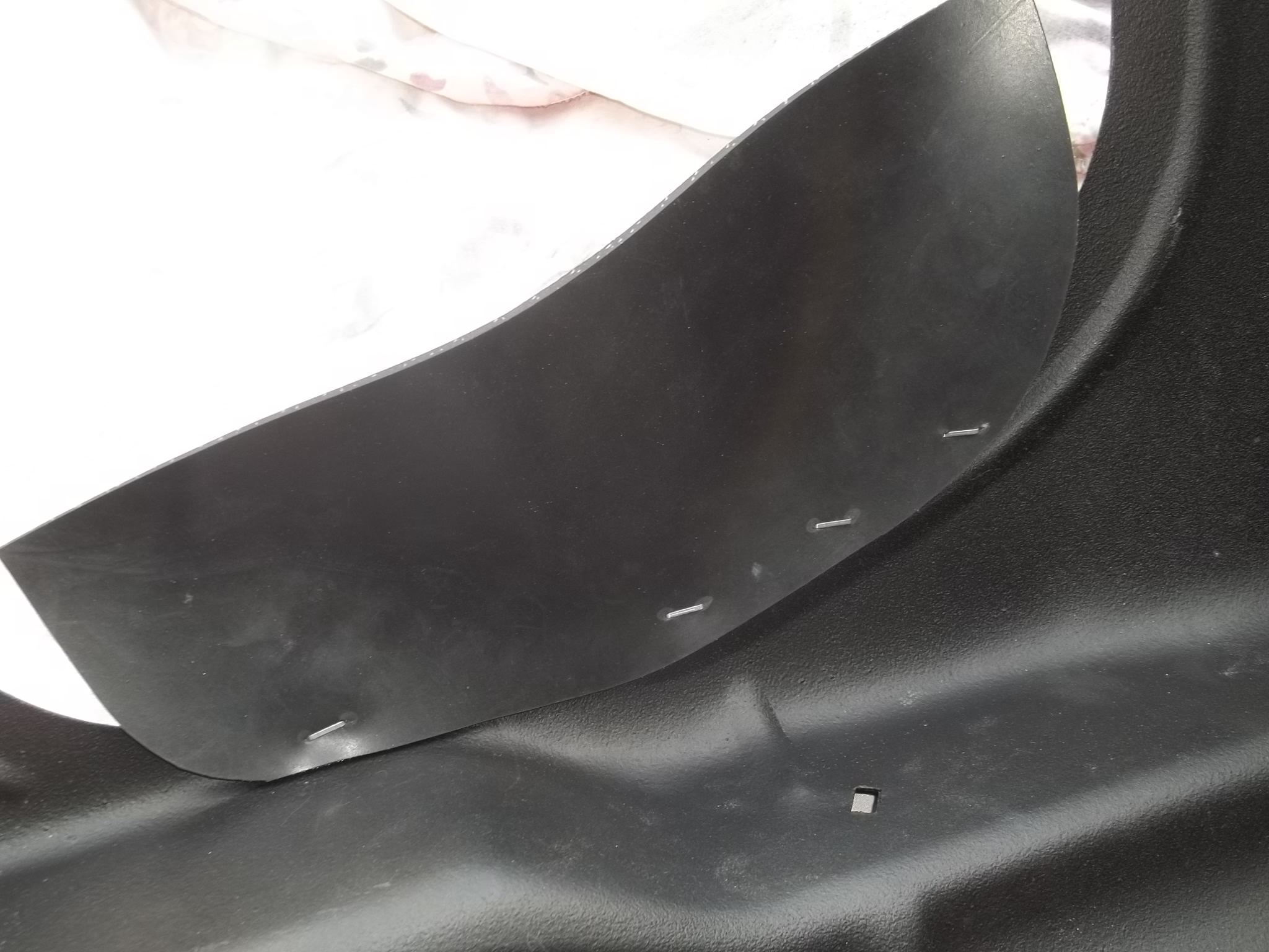

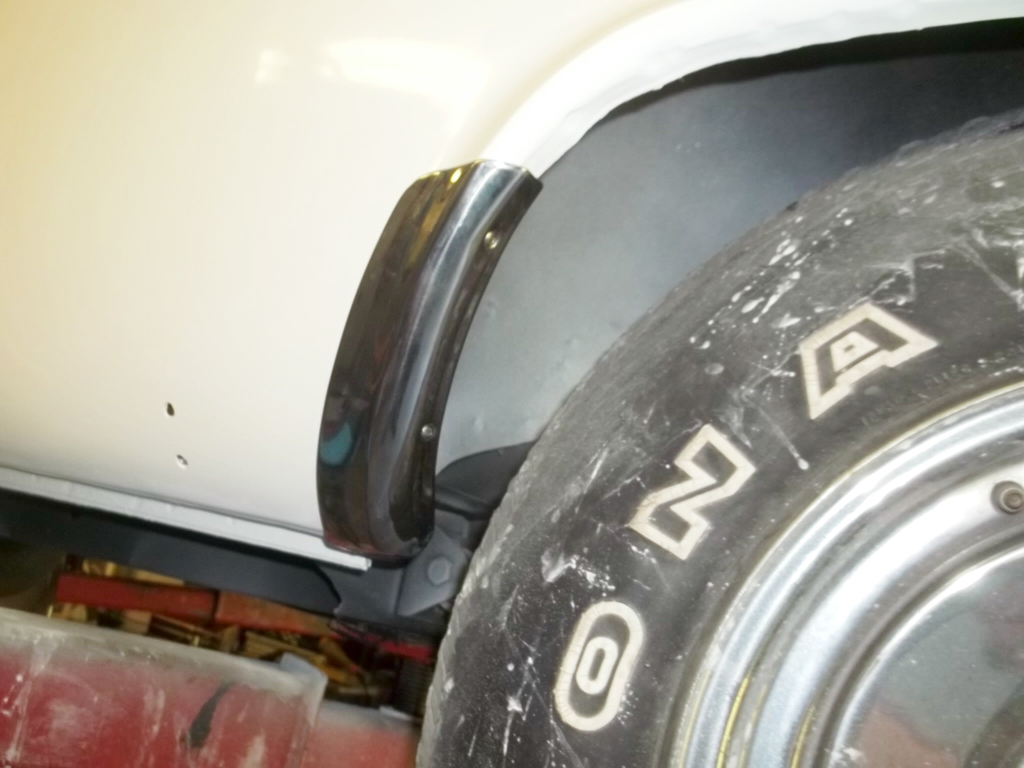

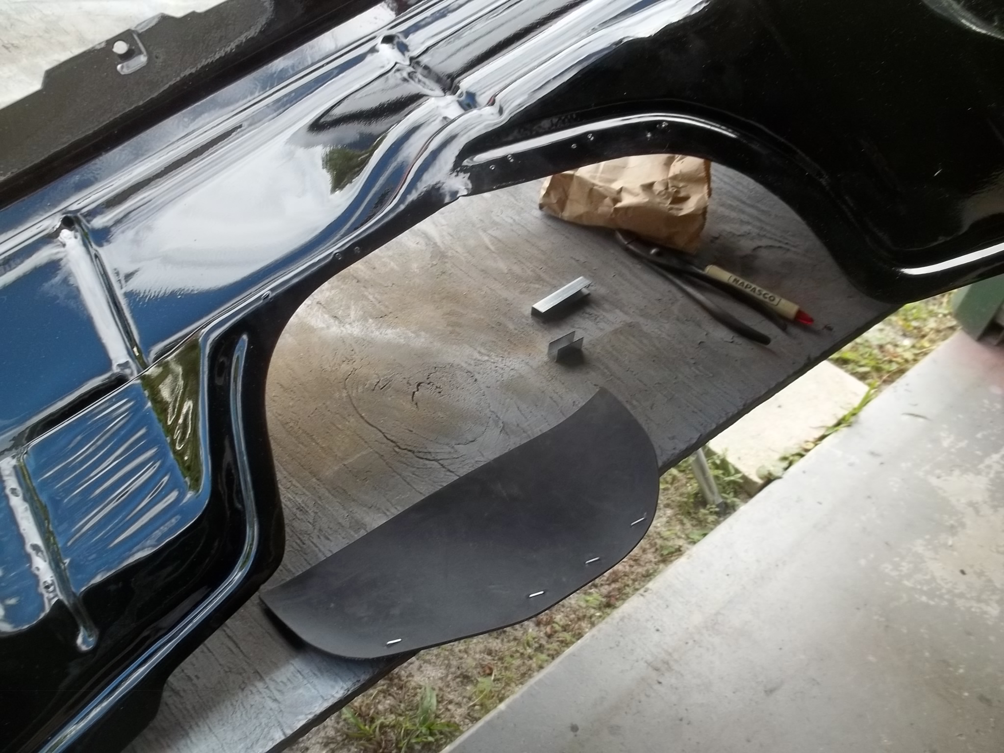

A couple questions - What color did you paint it? Ultra bright white? Looks much whiter than Iceberg white. Any color you want it is fine... The splash aprons, didn't read if they are Gary Goers items or just something you whipped up - I vaguely remember something like that in there, kind of like heavy roofing paper? And what happened to the generator? Thought you kept it.
Lastly, just saying how nicely the tail lights look on the bare body!
Bernie
I remember when I re-did my inner splash pieces, I bought some sheet rubber and made my own. The originals were rubber, not tarpaper, at least in mine.
