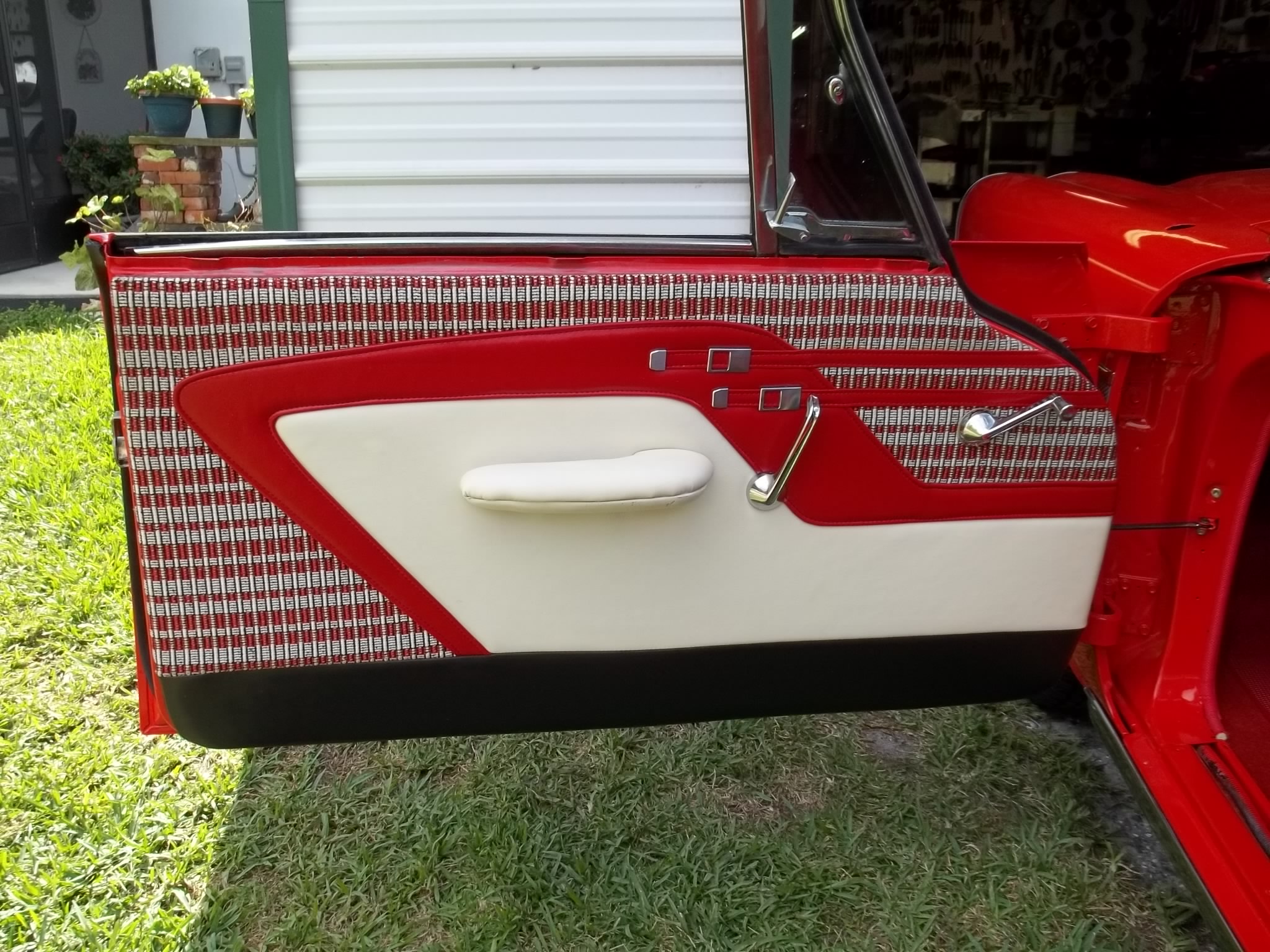

Arrrrrrrrgg! Finally got the Guts back in the doors. What a nightmare, but I got it down pat now. You got to follow the correct sequence or everything gets to be done twice or more. The first door took almost 5 hrs. the second door took 45 minutes.
1. Install the lock.
2. Install the door lock mechanism with long actuating rod attached.
3. Install the lock actuator between the lock (square hole) into the lock mechanish (round hole).
4. Install the rear glass run chanell.
5. Install the window regulator.
6. Install the vent window half way. (the JB weld didn't hold) but after installed it won't move.
7. Insert the window without the X actuators from the top.
8. Install the X actuators from the bottom thru the holes in the bottom of the door.
9. Slide the window into the glass run channels and the vent window down at the same time.
Make sure you oil and white grease everthing real good.
GOOD LUCK.
The window were very hard to roll up and down so I loosened all the places where you adjust it, rolled them up and down several times and they loosened up quite a bit but are still pretty tight. I think it's because of the new glass runs, it should loosen up though.
The drivers side rear window was digging into the rubber weather stripping so I used silicone grease and finally got it all the way up with the intention of adjusting it later. The window was up for a couple of weeks and adjusted itself somehow, now it rolls up and down as easily as the other one.

I don't remember if I told you guys that I adjusted the doors and drilled them so I wouldn't have to do it again after painting, FORGETABOUTIT, with three of us trying we could not get the hinge and backing plates to line up so we could insert the guide pins so we ended up adjusting them by hand again but it didn't turn out as good as the first time.
When I went to install the stainless on the doors the spring clips I had were not long enought to snap into the holes. I ended up using the universal type clips with the little wire on them with a thread and nut. Was able to get nuts on all of them except the one on the end at the rear of the door. Could not get my fat arm into the closest hole so I recruited my 8 year old grandson with a skinny arm to put the nut on and tighten it. So I can alway say my grandson helped with the restoration.

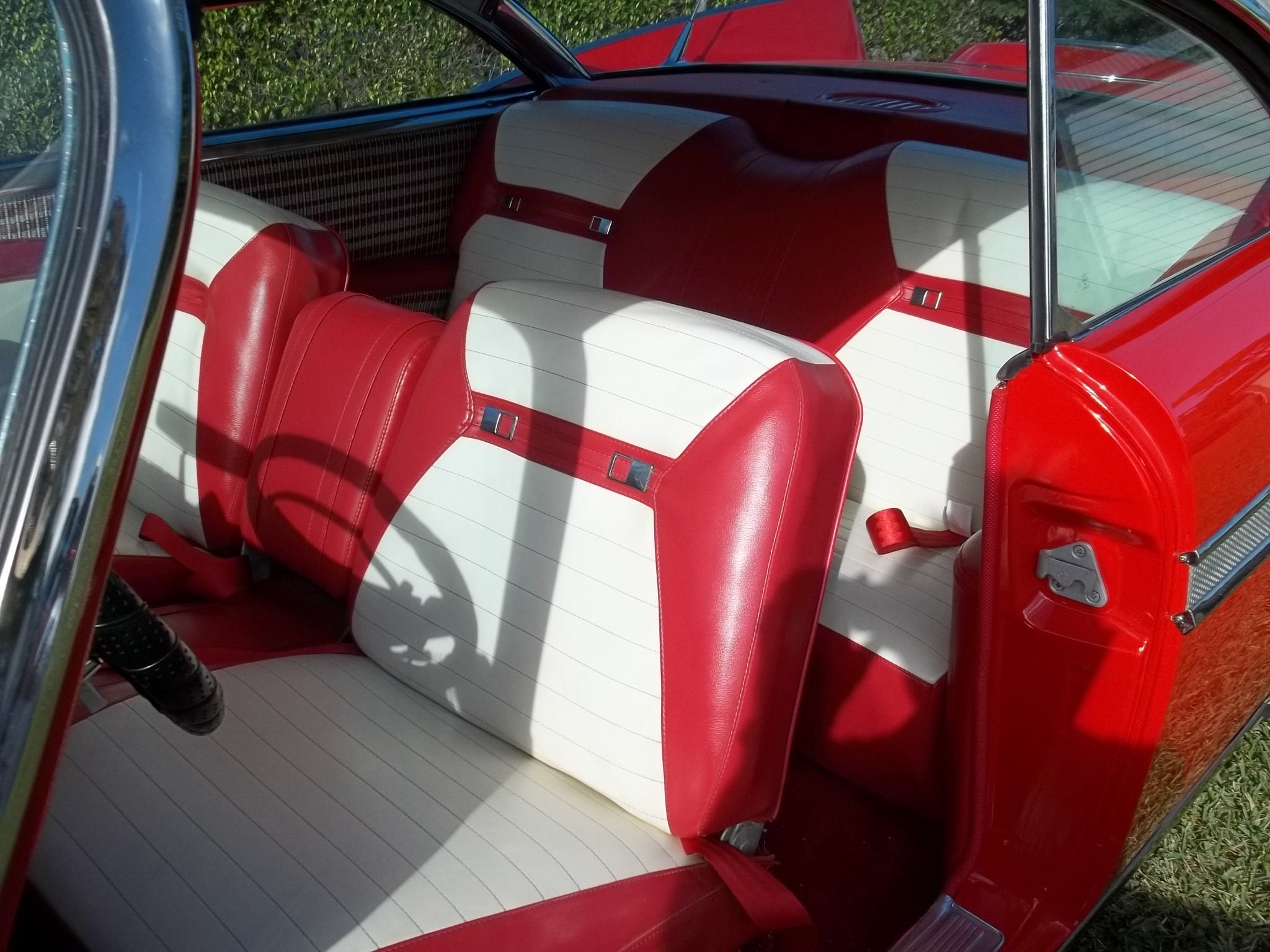

Will have the AC installed next week hopefully, Install the rest of the upholstery and grill then do some fine tuning and get that baby back on the road. Can't wait.

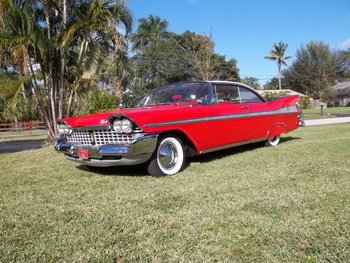

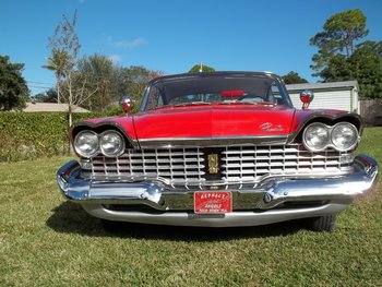

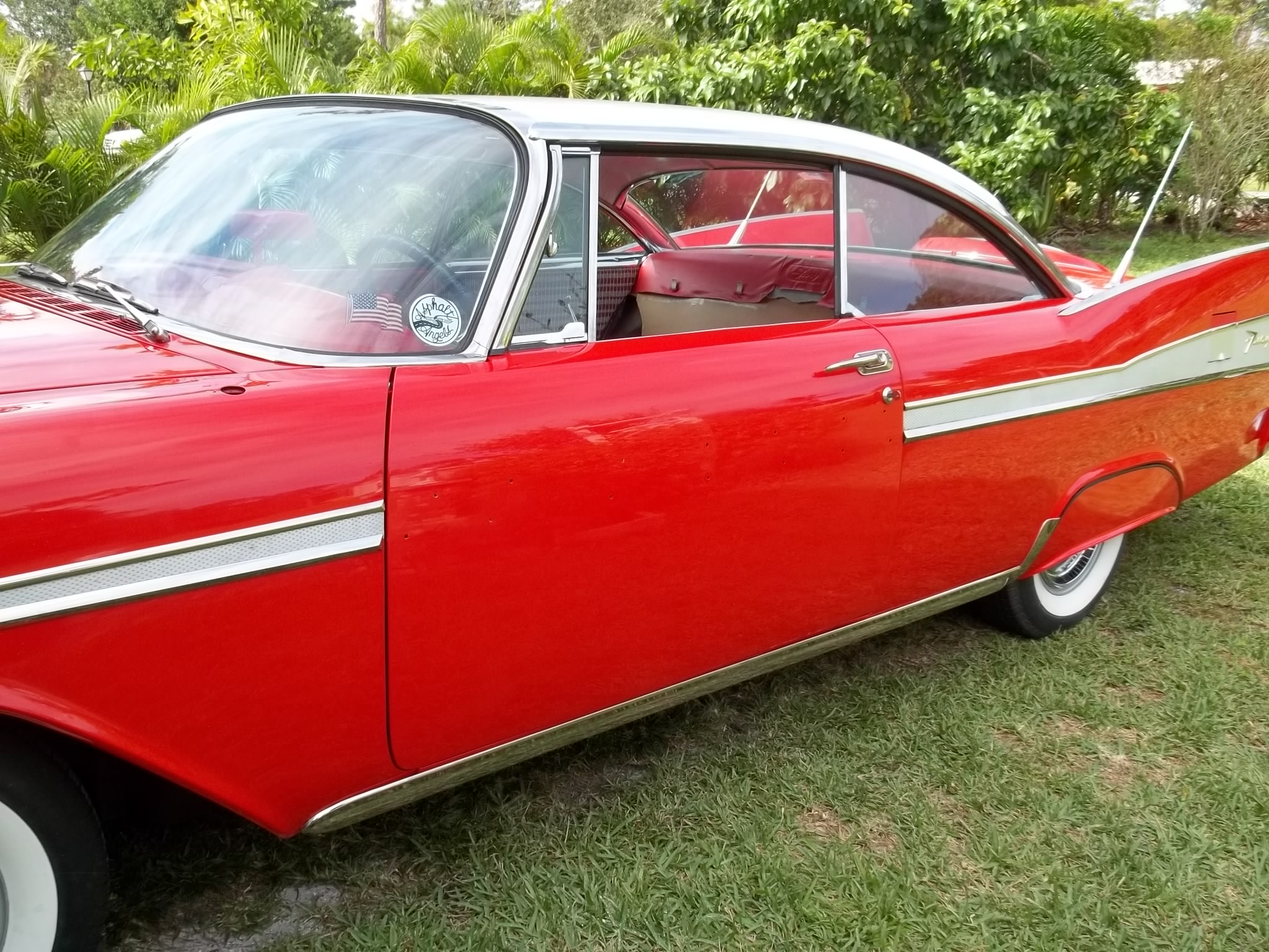

YEAAAAAA!!!! It's done. Just in time for John Q's visit. Here are the last pictures. Haven't been to a show yet, it's been raining all day. Now, where is that convertible.

I am running out of superlative comments for your outstanding work Dick! ( I can't wait to pick it apart when I get there!
Naw, I will be taking a lot of pictures to help me detail like your cars are detailed. See you soon!

Your Jiffy Jet bag is not hooked at the third hanger....har har
This is a stunning and exquisite restoration, done to owner's tastes and specifications. Unique and gorgeous.
Were I in your shoes, I'd be done for quite awhile, after Greenie and now Big Red, but you yourself spoke of the convertible-on-deck!
Pace yourself, Dick!
