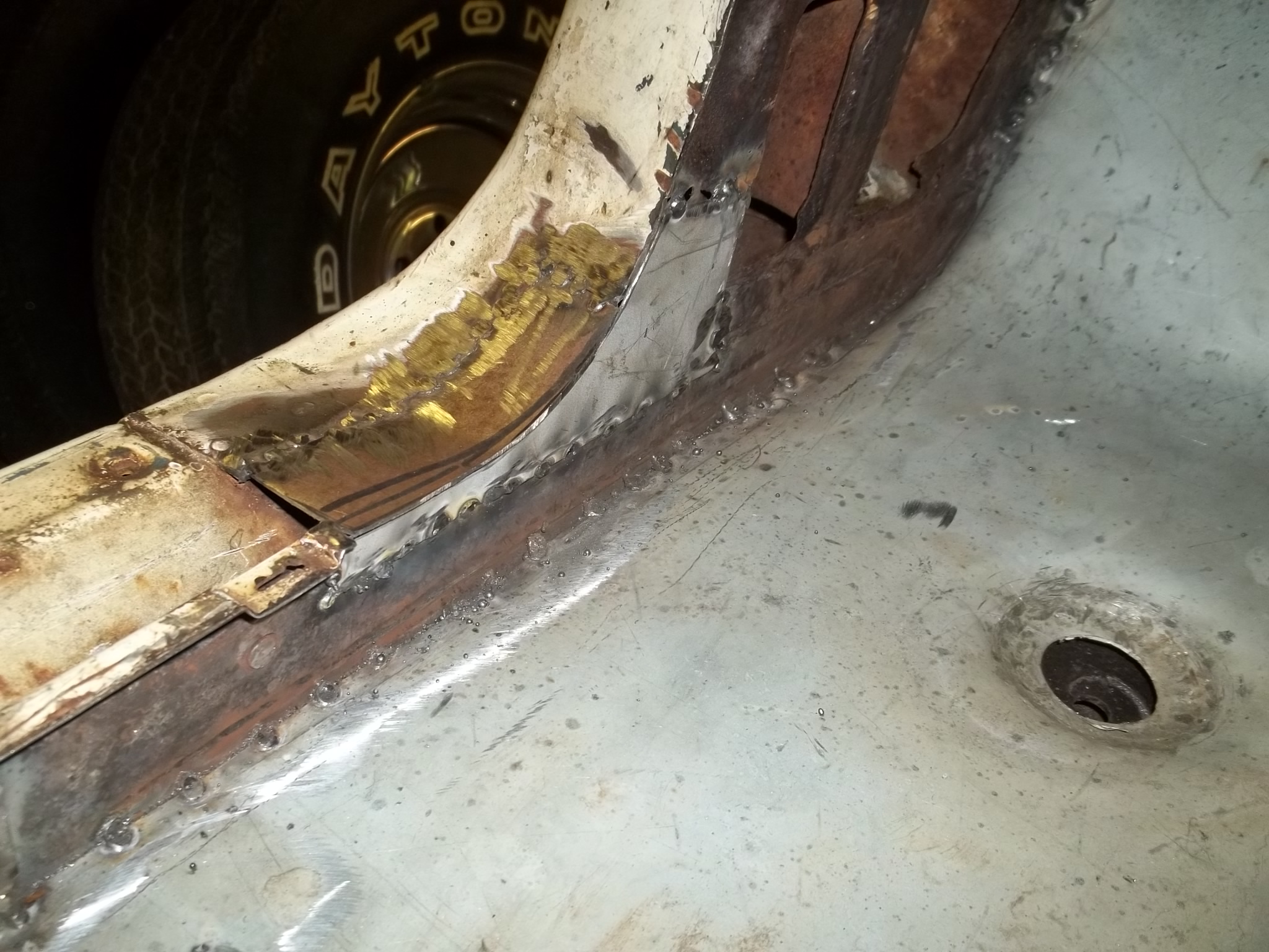

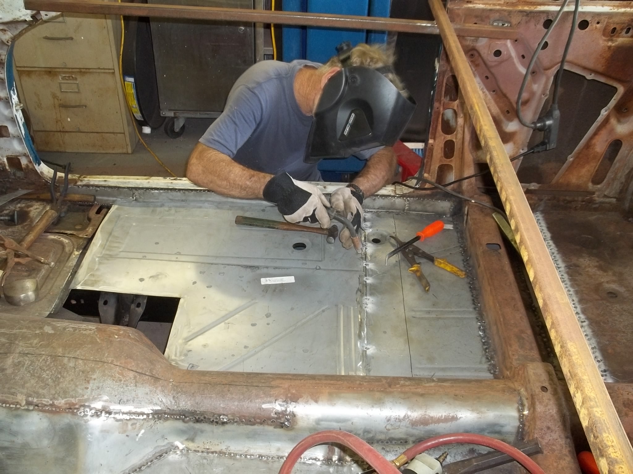

You are right John - The body is in much better shape than the one I just finished. Minor repairs on lower rear fenders, trunk pretty good shape, rockers solid. The only thing major are the interior rockers and floors. A lot of surface rust but that is not a problem.

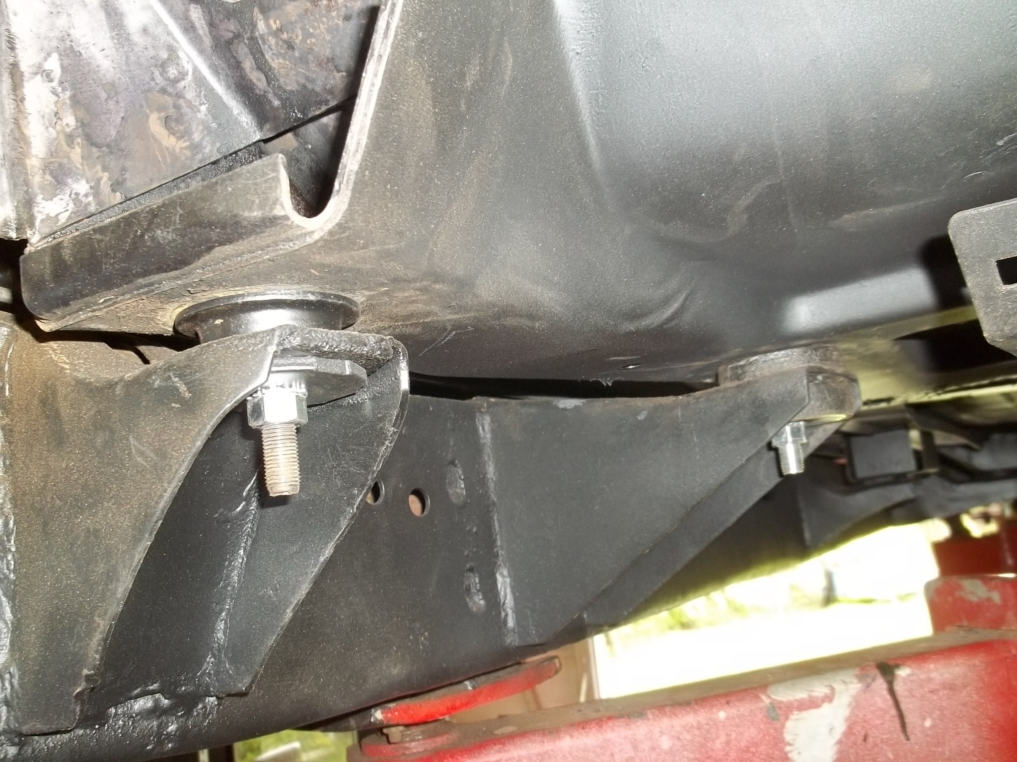

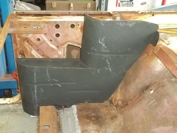

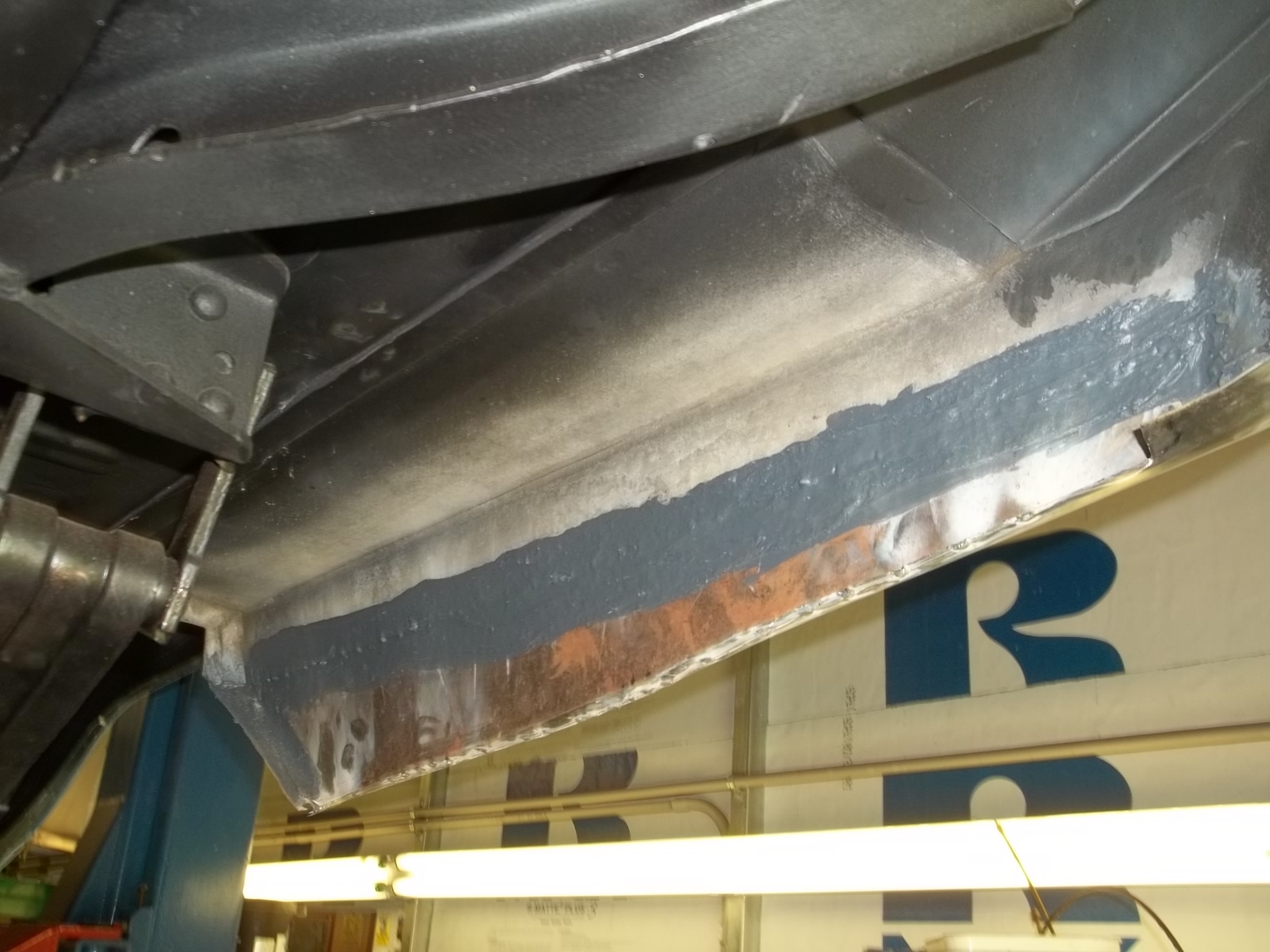

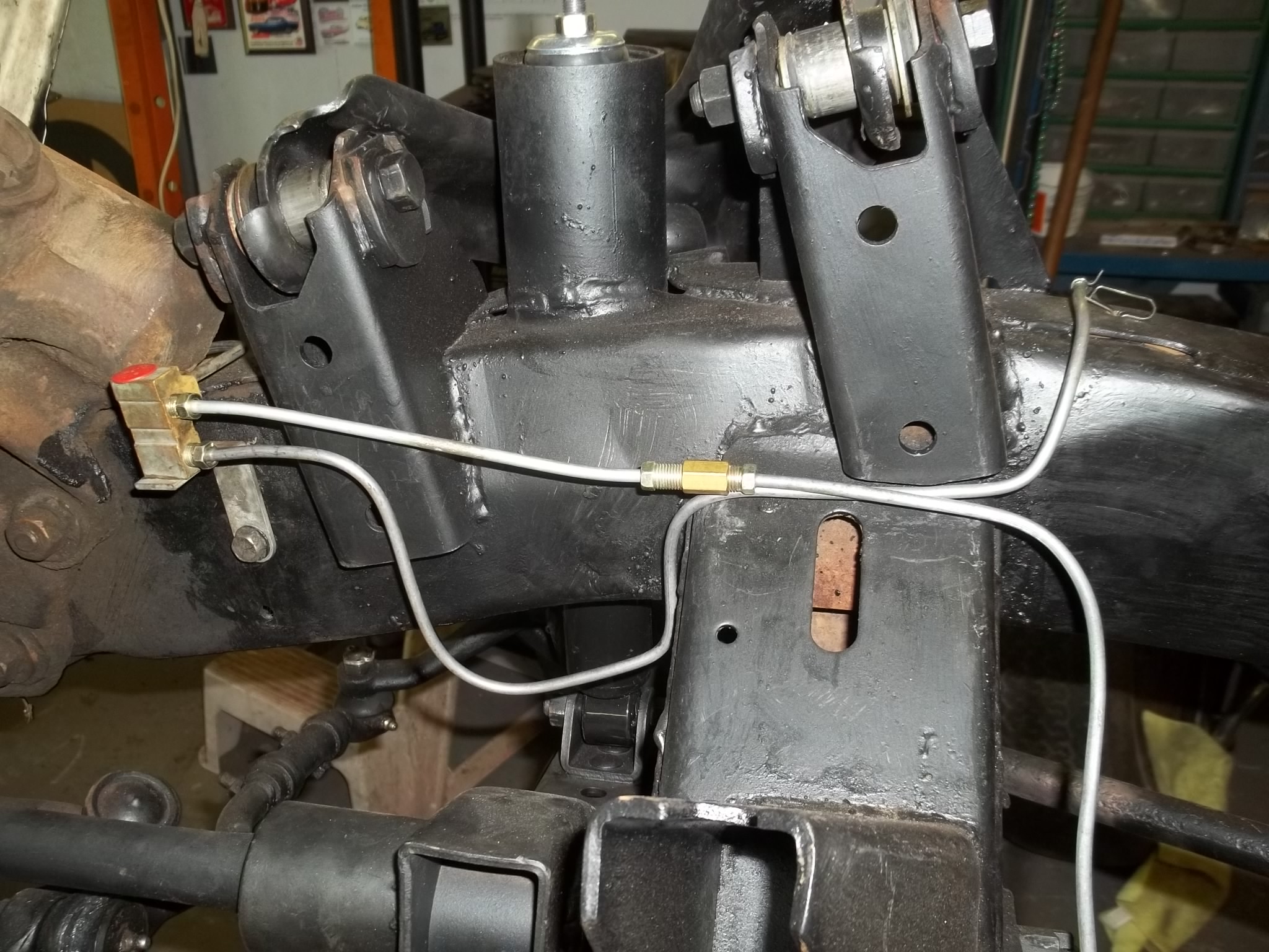

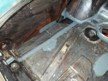

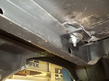

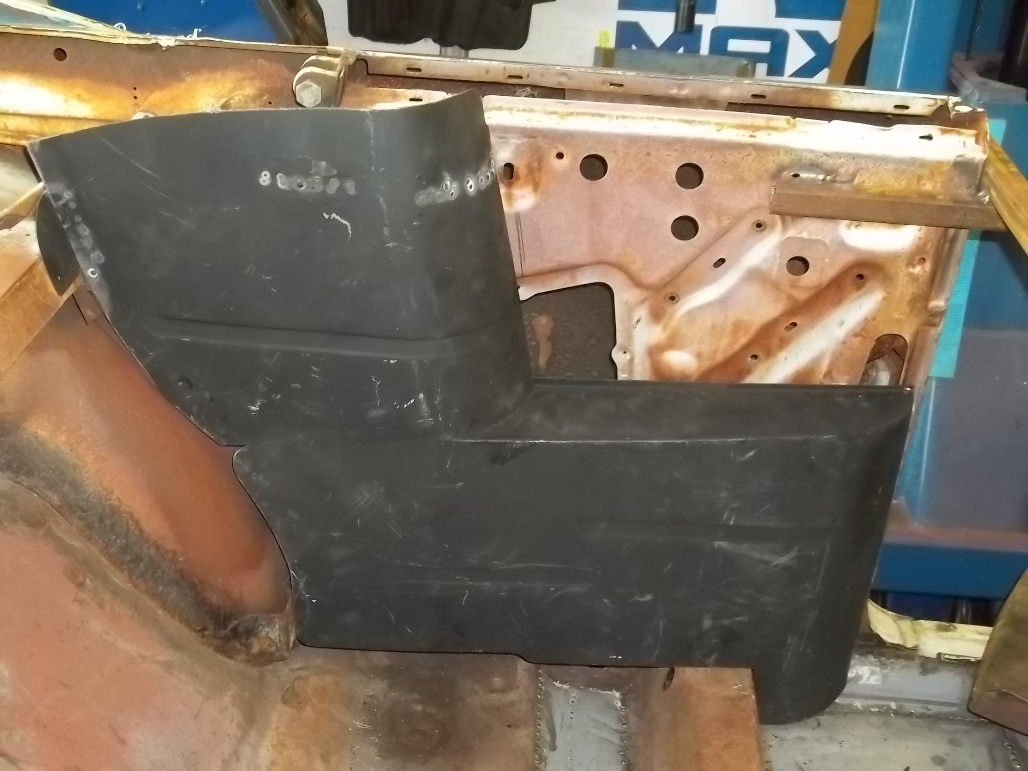

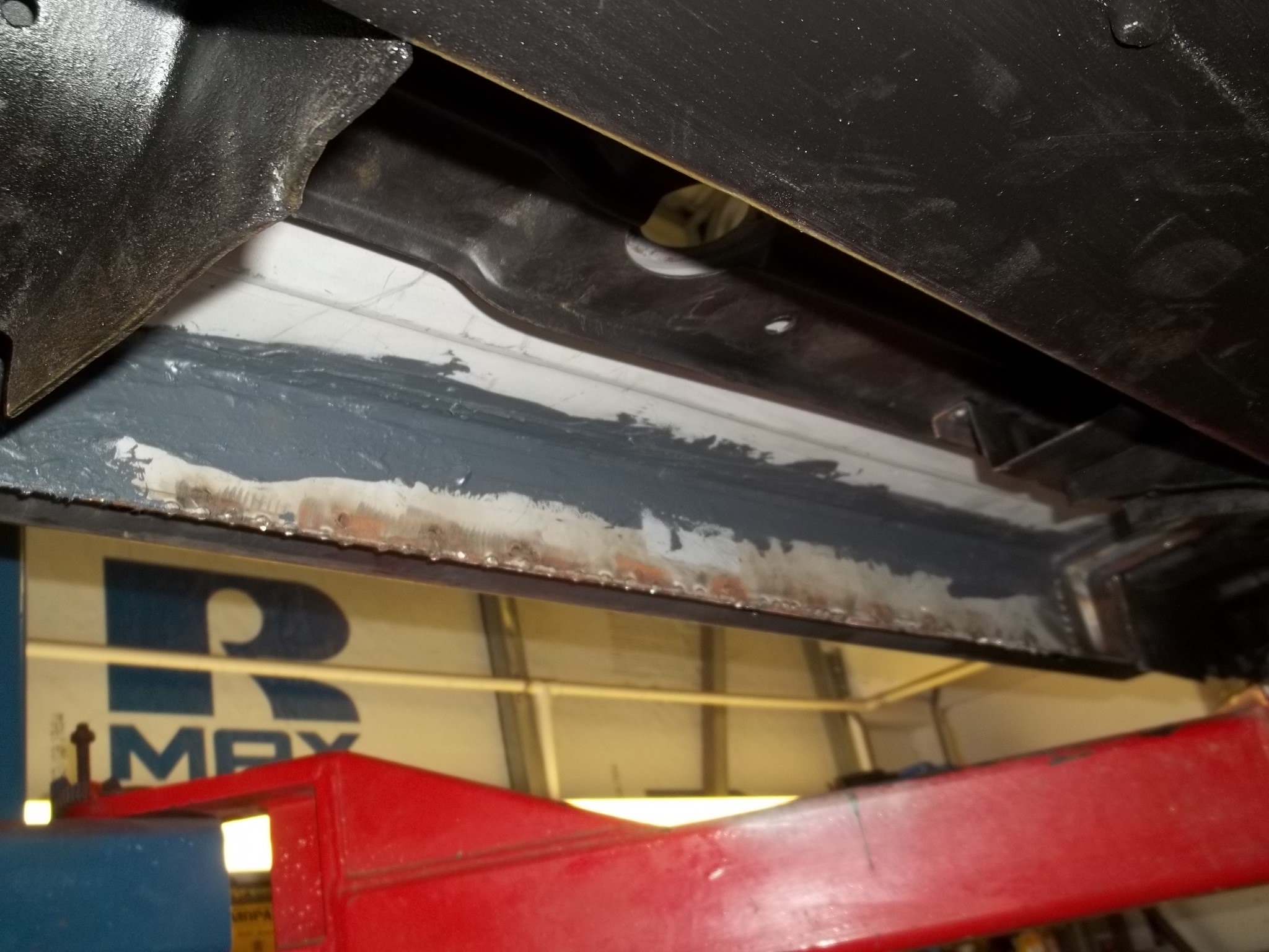

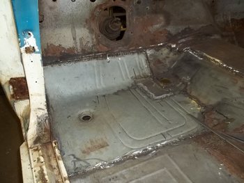

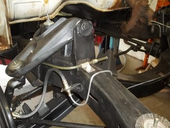

All the welding is done except the two front fenders, they are rusted up under the eyebrow pretty bad, brought them to Larry's house today for repair. The underside is pretty much finished except for the gas tank. I had my radiator guy boil it out and line it for $75.00. He has aready recored the radiator and heater core from the parts car. All the welded seams have been seam sealed and encapsulated on the under side, new control arm bushings, ball joints, strut bushings and front brakes have been completed, installed new gas and brake lines, fitted top cylinder covers that Larry made for me. Next is removing as much rust from the interior of trunk and cabin as I can then apply rust converter and encapsulator then tackle the exterior paint removal.

Everything looks really great Dick. The picture of your dual wheel cylinder front brake reminded me of how horrible my manual brakes actually worked and I wondered if that was due to my negligible skills or MOPAR engineering gone awry. After several near death experiences I installed a disk kit which kind of took care of things then converted to the vintage power brakes. I've wondered if the power brake conversion alone would have improved my survival odds.
Thanks for the compliment Steve - When I first got Christeen (the red and white SF) on the way to the very first car show I lost the brake pedal and had to use the parking brake to stop the car in very heavy traffic. Fortunately I was right in front of an auto parts store, got a wrench and some brake fluid and got home. I never knew what lane I was going to be in when I stopped so I put an AAJ front disc kit on the car with a proportioning valve but no brake booster. That stopped the car well and in a straight line. When I restored it I added the booster, it stops better but I really didn't need it.
My Green SF has four wheel drum power brakes and it stops as well as Christeen with front discs. Go figure? The Convertible, if I ever finish it will have four wheel drum power brakes as well.

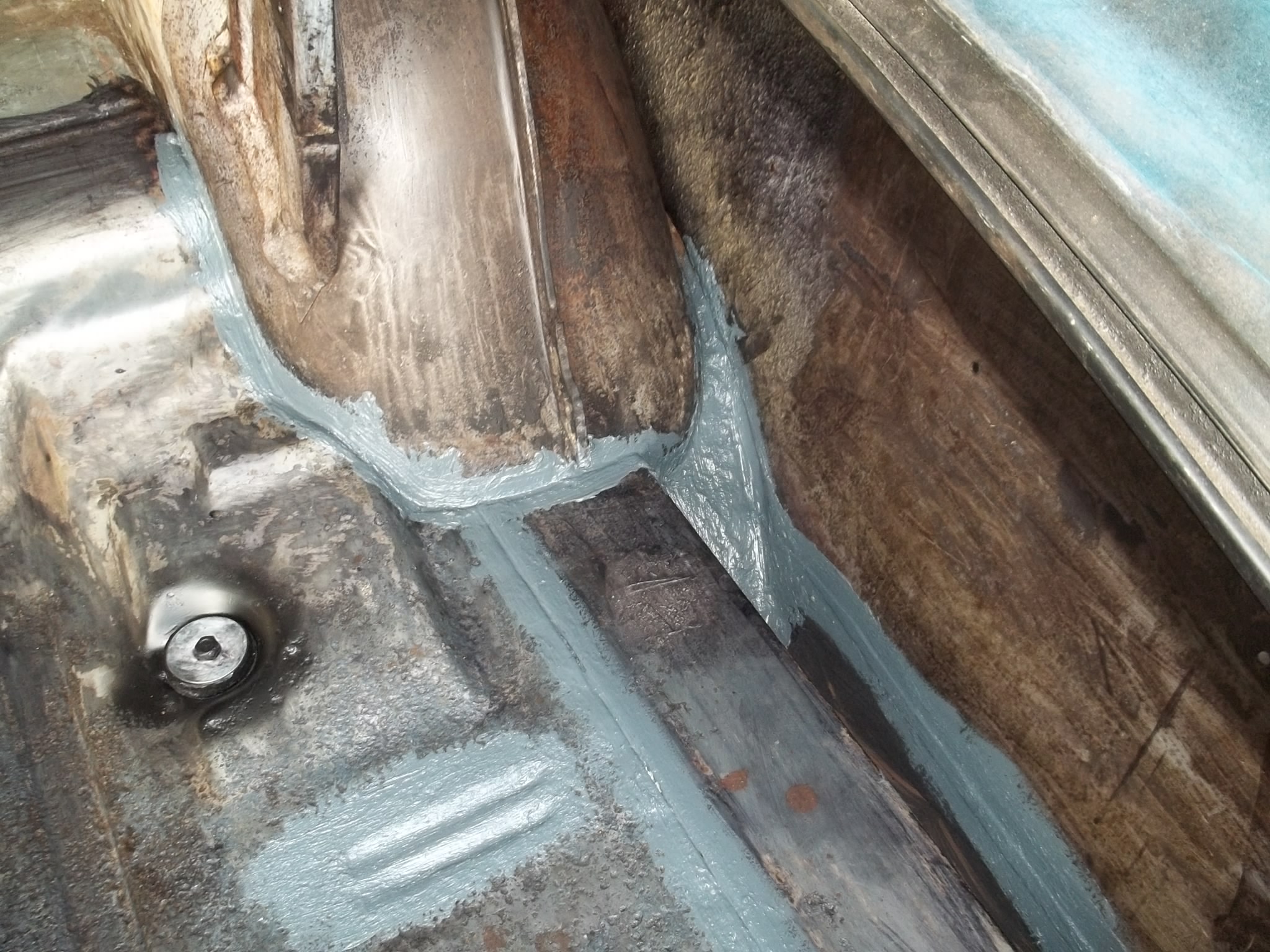

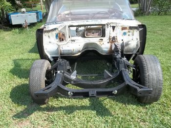

Well, she's a roller now. Now I can take her outside for nasty rust and paint removal. The power steering box that was in the car was frozen up pretty good, could barly turn the wheels using a pry bar. The one out of the parts car turned easily by hand so I cleaned it up and installed it in the car, works great, just hope it doesn't leak when I get the pump hooked up. Installed rubber body mount in the proper locations so the underneath is completed except for the Gas Tank. Got in trunk and removed as much rust as I could on the underside of Fins, over trunk torsion springs and as far forward as I could reach over rear fender wells then coated everything with rust converter and applied seamsealer. Will paint all with Encapsulator.

Wow! Outstanding Mr. Koch! You do thinks much quicker and nicer looking then my work. Keep the pictures coming!
WOW Dick - I agree - keep the pictures coming. The way you "restore" cars; they will last another 50 years!
