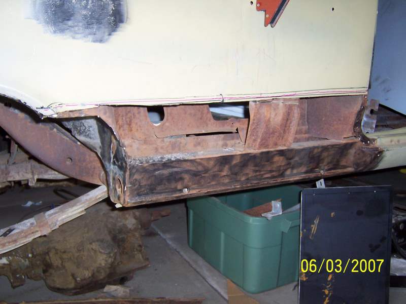

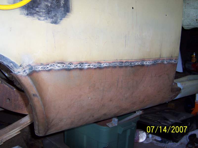

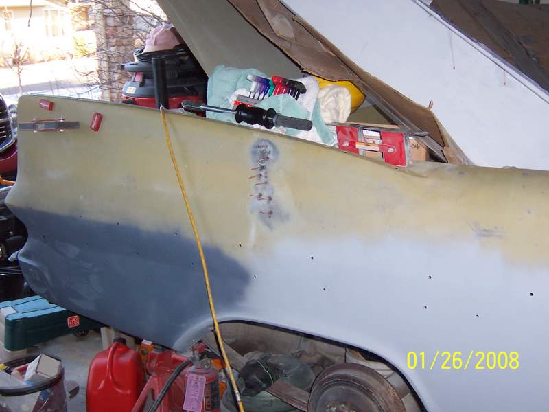

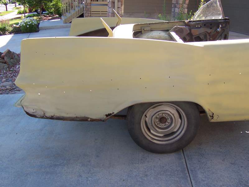

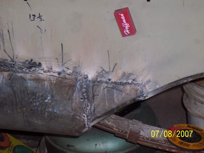

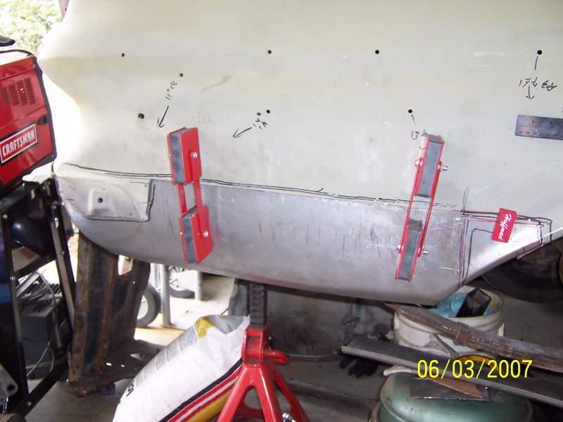

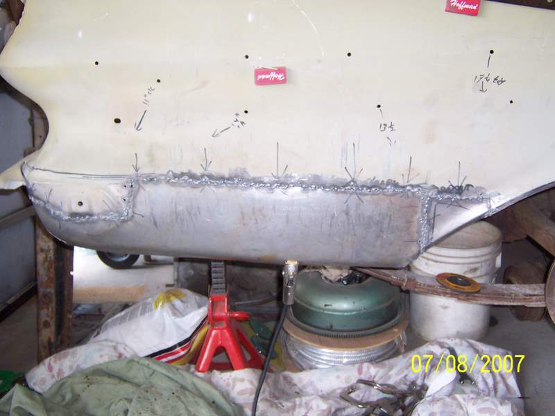

Since it is a slow Sunday morning, I thought I would post some pictures of the work I had done on the convert before it had been painted.
I am not a good welder but anyone can start with a wire-fed Mig welder, a good grinder to clean up bumpy welds and a litlle metal impregnated body fill like Metal-Fill, you can do a decent job.

Your welding looks very good and I couldn't have done it better myself! Keep posting pictures as your project is reaching the final stage, next year you can start cruising, top down and the wind in your hair
And I don't have to say that your drop top looks drop dead gorgeous
I bet you already knew that your post with the pictures today was #10000 on this forum
