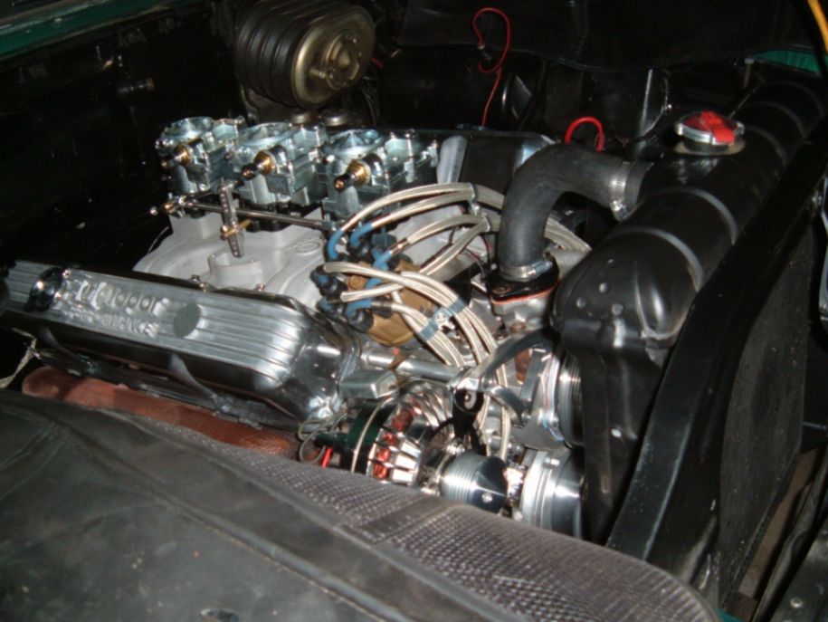

Hey... One of you guys should tell Dan to put some of my newer pics of my engine that I have posted over on FL...

Cool, canwe have some more picks please :D
You can see more (and bigger) pics here http://www.forwardlook.net/forums/forum ... 31&start=1

Seen em! :D Could do with some more detail so i can see whats what, but very nice photos all the same!

What do you want pics of?

Some detailed picks of problem areas if there are any? :)

big block swap issues.
Post by safetymike1977 »
1. if you use a stock later model mount..... The engine is really far forward.
2. if you set the engine back where it probably should be, you have to cut the heater box to fit the valve covers... I chose option one.
Engine mounts.... You have to make them....
Driveshaft will need made.....
Pick your exhaust manifolds wisely... I tried to use my 77 ones first... that wasn't happening.... Had to use the 65 ones.
