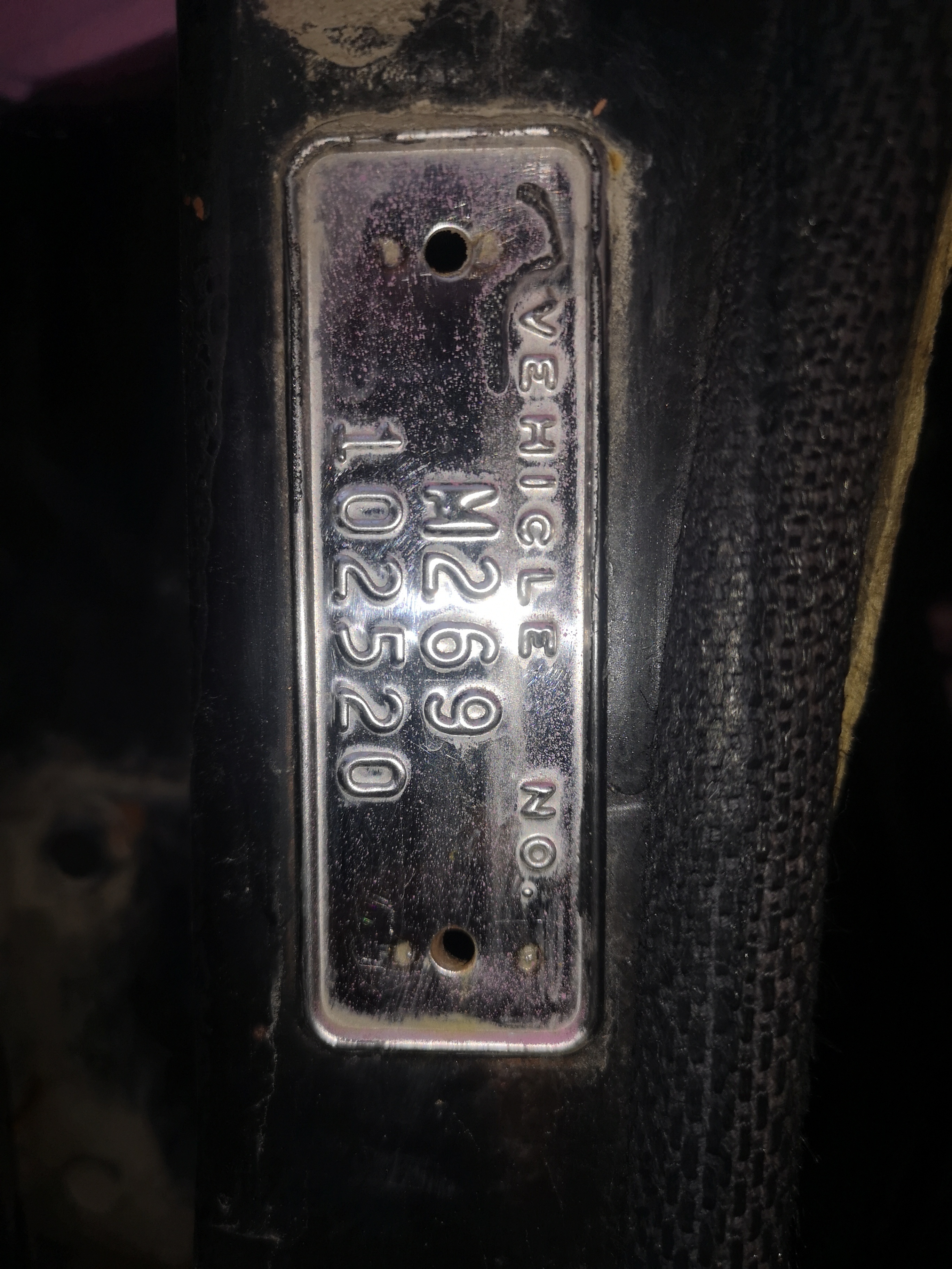

Hello everyone.

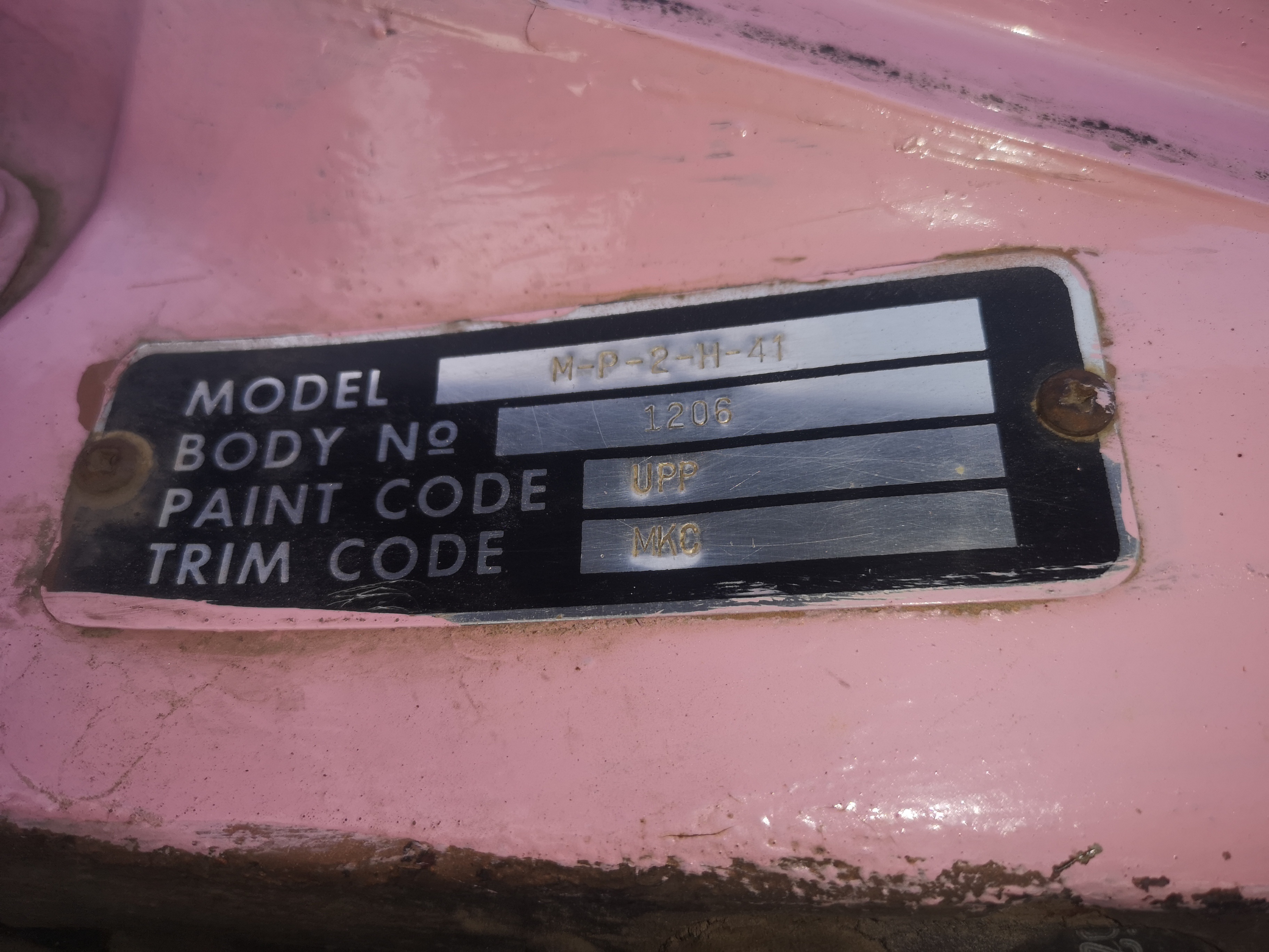

I have attached the model plate.
I still cannot figure out what exact model or car is and what engine package it is for that model.

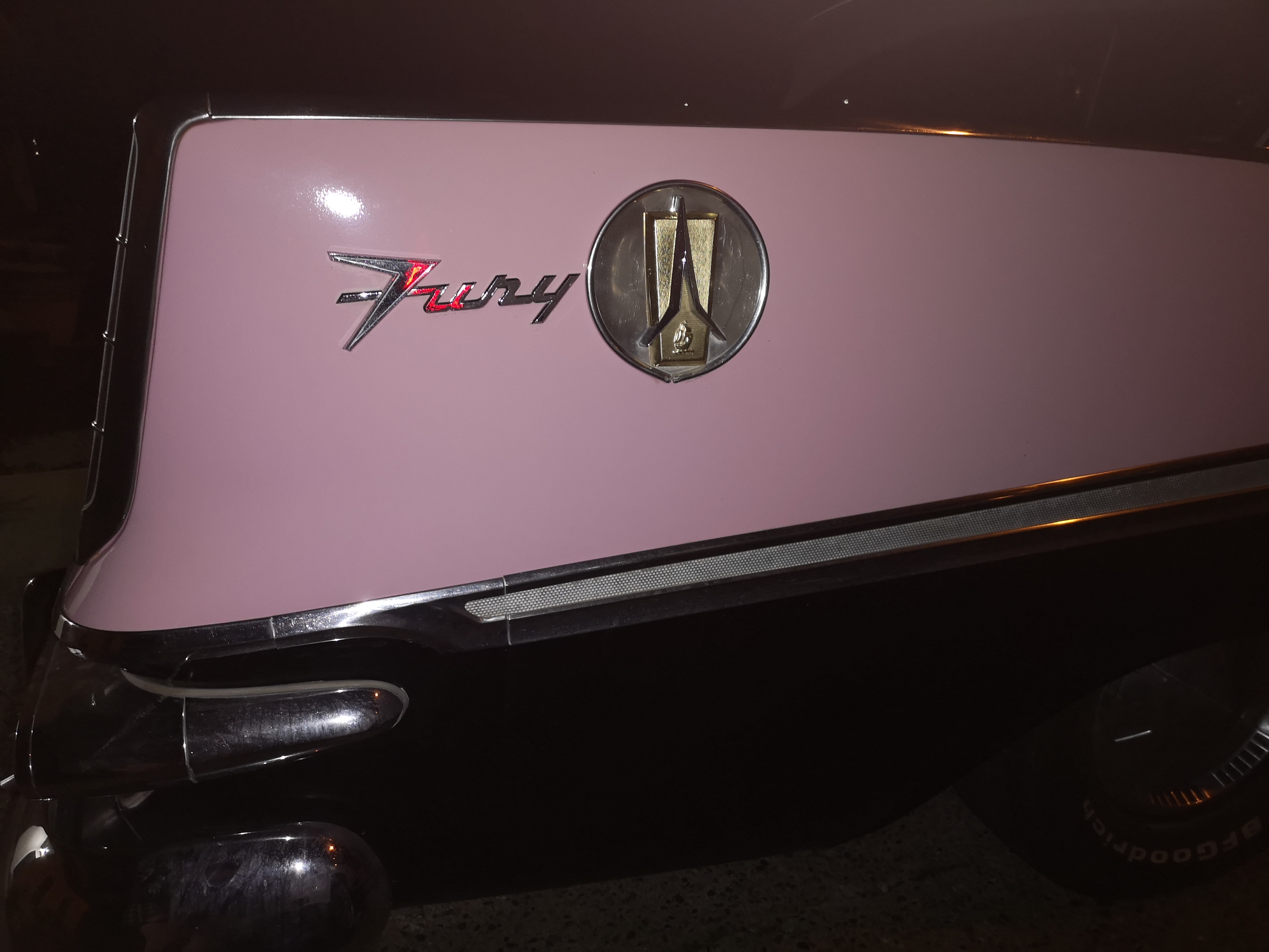

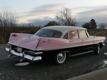

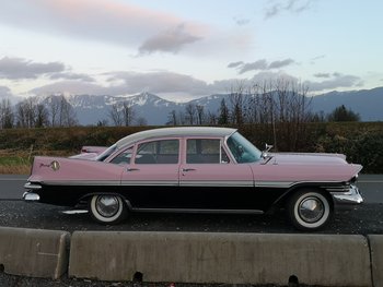

Essentially what I'm trying to figure out is if we have a normal base model fury, or a sport fury, or if our car is a mish mash with emblems and options added afterwards!

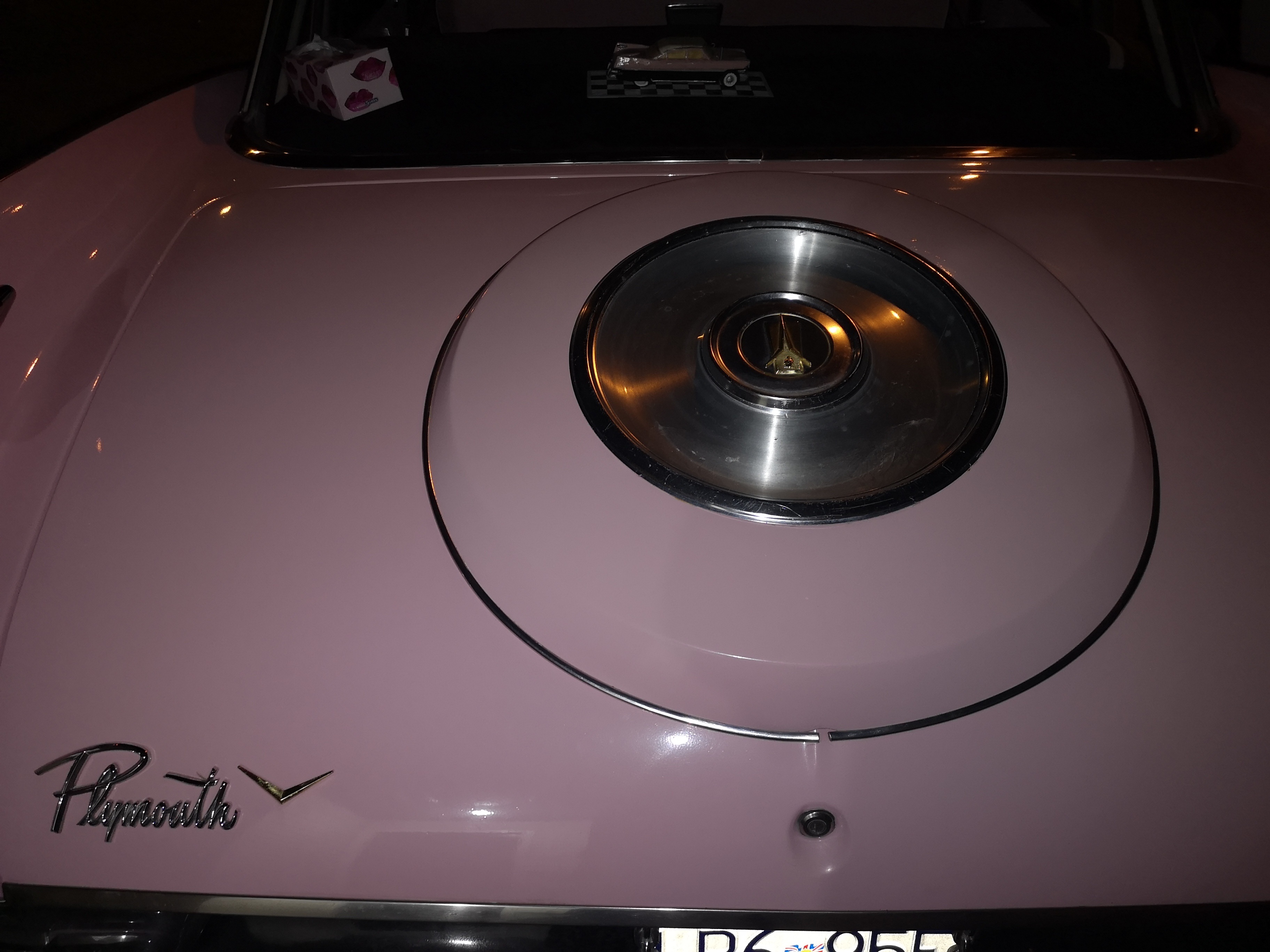

I'm to believe that Sport Fury's only came with the circle upside down V with the "tiffany" medallion, whatever that is...I have attached photos of our rear fins and trunk. Also, out trim piece running horizontally doesn't fit the style of the sport fury.
But, I am also to believe that Sport fury only came in two door only. Ours is four door hardtop.
There's no nameplate or swivel seats.
Ours does have the 318, (313 Canadian). It does have a 2bbl carburetor.

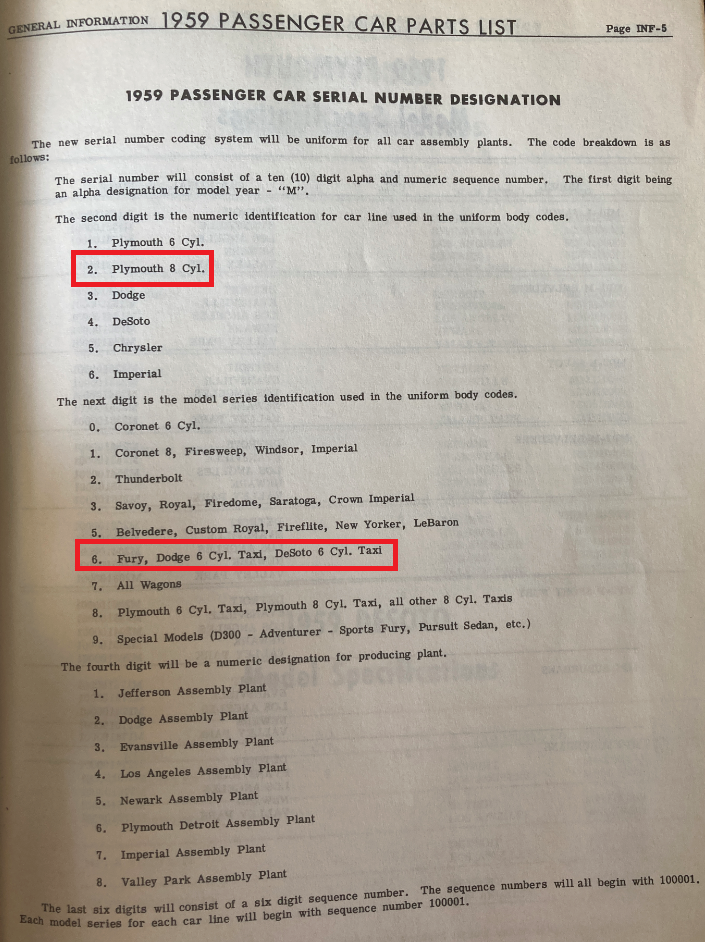

Here's a page from the U.S. Parts List:
The M in M269 means it is a 1959 Plymouth, the 2 means it has a V8 (it doesn't differentiate between Golden Commando or poly), the 6 means it is a Fury (not a Sport Fury), and the 9 means... it was not built in the U.S.! I think 9 might designate Windsor, Ontario but I am not sure. The 102520 on the plate means it was the 2,520 Fury built in that plant (all S/Ns - VINs - began with 100000). And yes, only the Fury and the Belvedere came in a four-door hardtop - Sport Furys were two-door only.

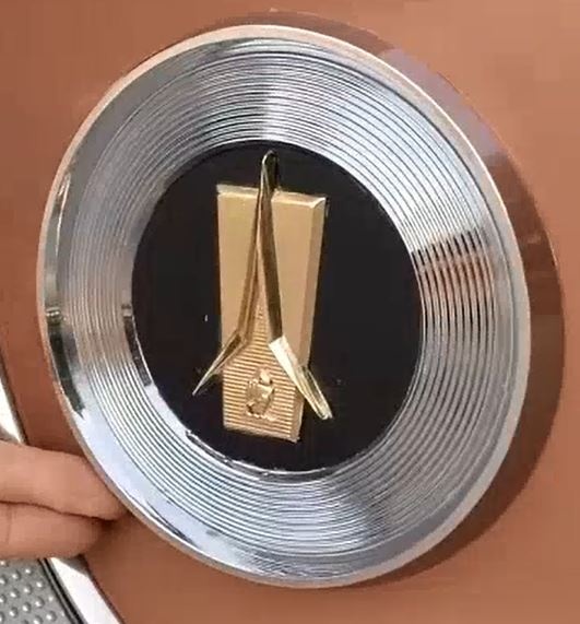

The "Tiffany" medallions are definitely home made add-ons (as are the fin lights!) - here's a factory Tiffany:
[I forgot to add: Tiffany medallions came from the factory only on Sport Furys.]

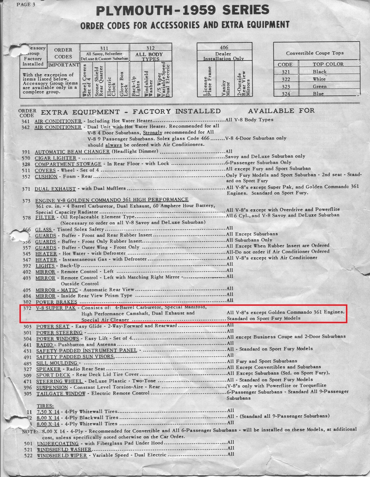

Here's a special page from an order code sheet, courtesy of Matthew Keij - again, this is for the U.S.:
So Mother MoPar did have a special code for the Super Pak, and you could order it for a Fury. But it would have included a 4-bbl carburetor.

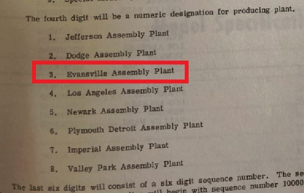

Mike, I don't know what order the author of that article used in numbering the plants. But did you know that if you click on the attachments, they present in full size? Here's a snippet from my first attachment, blown up here:
In the official Chrysler Parts List Book, Evansville is Plant #3. If Loretta had been built there, the VIN would have begun with M263 - but it begins with M269. In that list, there is no US Plant #9.
Most 313 parts will fit a 318. Some won't (rings, pistons, connecting rods, etc.). The US Parts List is online here - if you had a Canadian Parts List, you could compare P/Ns. Where they are the same, you can reliably trust a U.S. supplier. Where they aren't (e.g., the vac advance P/N Dieter gave you, from his Canadian Parts List book), you will have to scrounge around.
By the way, the other evidence that corroborates that this car was built in Canada is the data plate. The paint codes on the data plate are not found on the US order code sheet.

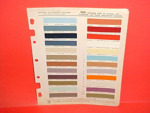

BTW, here's 1959 Canadian paint chips for sale on eBay:
Unfortunately the vendor didn't provide a bigger pic. I don't see Pink as a color, though :roll: In fact, as far as I know, there weren't any three-tone Plymouths available... The other customizations to Loretta are the "Tiffany medallions" and the fin lights. I suppose that puts the car in the modified collector category.
