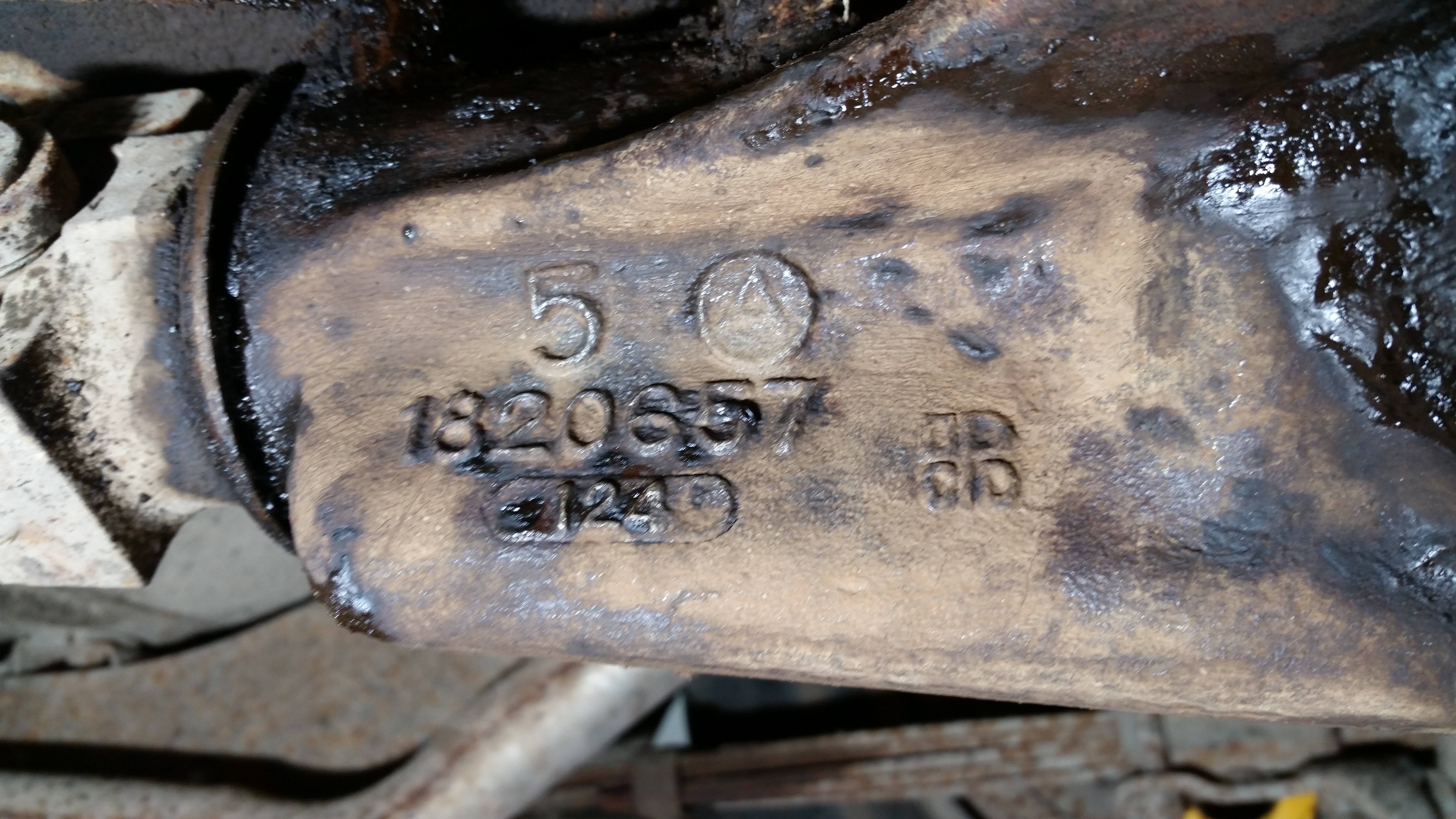

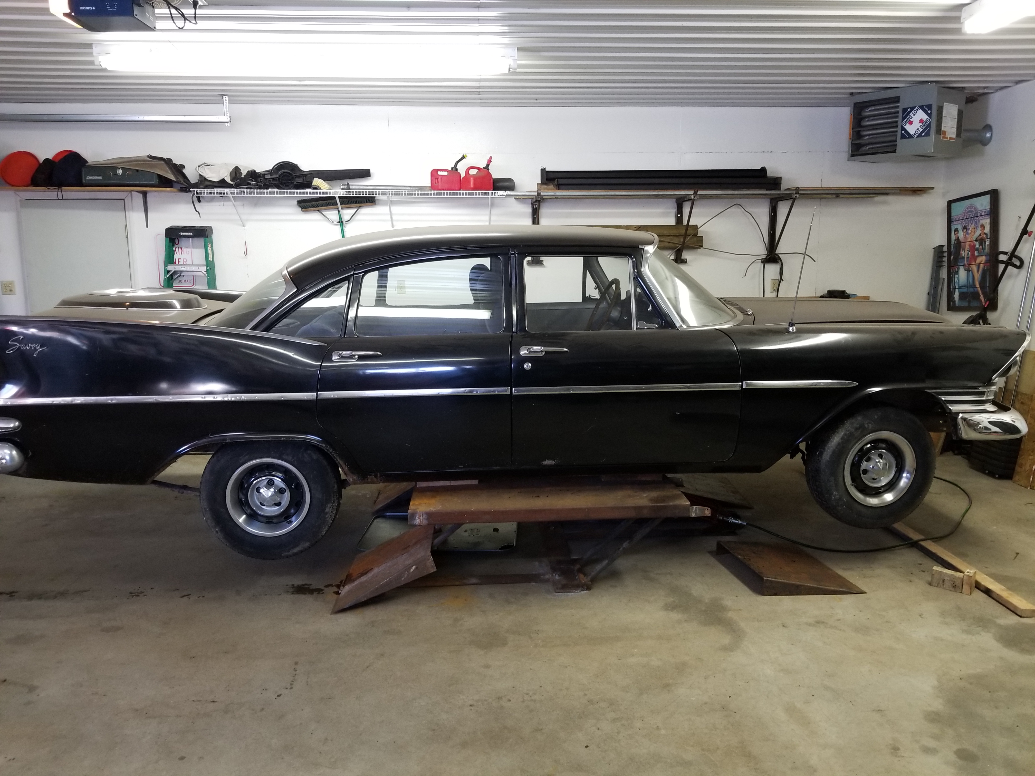

new to the site. I have a 59 Savoy that has a bad leak out of the pinion on the rear end. I know the seal needs repalcement but i don't know how difficult it will be. Do the gears have to come out or can i pull the pinion and replace the seal and put it together? Any tips? This is the car and this is on the side of the rear end.

Welcome to the site, Rex! You can find the shop manual here (the '59 manual is just a supplement to the '57/'58) - and here is the section specific to the rear differential.
I have never done this myself, but I believe you can replace the seal without disassembling any part of the differential. I'll ask Dick Koch to have a look at this post, and respond.

Hi Rex, welcome. Dan as best l can remember all you have to do is pull the flange out of the diff to remove the seal. I sourced a new seal at NAPA. Sometimes the flange is worn, NAPA also has repair sleeves for the flange.

Good looking Savoy! The black on black with black wheels and center caps makes it look tough! Also love that its got a Sport Deck for a touch of class! Be sure and document your experience with the rear seal incase some one in the future has to do the same job.
