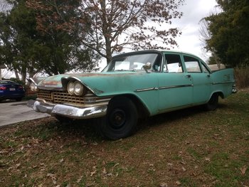

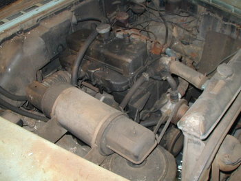

My name is Ed Prichard and I am currently living in east Tennessee and am trying to get a 59 taxi back on the road. It is an undesignated model 4 door which apparently served as a taxi in Atlanta in it's early life. It has been stored since 1977, so it's not as rusty as it could be. It has a Perkins P4 diesel engine that I have recently gotten running after having the starter and diesel injector pump rebuilt in England. They were both Lucas brand parts which don't have a reputation for longevity, but they are working fairly well now. I wrote to Chrysler Historical and they have no build records. I have redone the brakes and the car is driving in the yard. It will only do about 45 MPH with the diesel and 3 on the tree....apparently it was set up for inner city taxi service. Any additional info anyone has would be welcome. It needs a front valance and upholstery most. Not sure what to do about the body/paint.

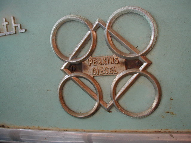

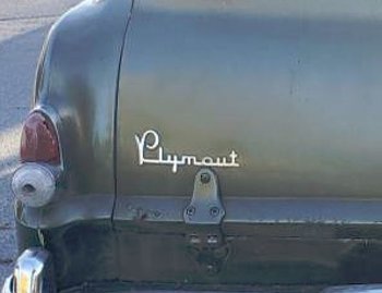

Your trim appears to be that of a Savoy. Another clue that it might have been assembled abroad - the emblem on the fin matches that of my '54 Plymouth Suburban! ...er, except, mine is missing the "h" :oops: :cry:

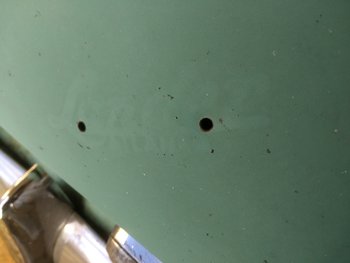

Here's a pic of the "shadow"

I think it very odd that the fin script is from several model years back. If there aren’t any extra holes in the fin - i.e., if it appears to be original - I’m betting it was assembled overseas, and reimported.

The paint is all original and there does not appear to be any old body work under any of it, so there are no filled trim holes. There are two holes on the left front door post where a number plate would have been installed, but there is no evidence that any fasteners have ever been in them.
An update after reading the old post: the P4 engine did not have glow plugs, just one "thermostat" in the intake manifold with a small primer pump on the dash that squirts a small amount of diesel on it to help it start on days when the temp is below about 50 degrees F.

I took the liberty of enhancing the "shadow" a bit - it looks like it says "Lander". Or perhaps, "Landers", where the "s" went AWOL like the "h" in my '54 Plymouth emblem? :oops: Although, given the placement of the pins, I think it unlikely it's missing an "s".
I tried Googling for both names in the Atlanta area, without any luck.

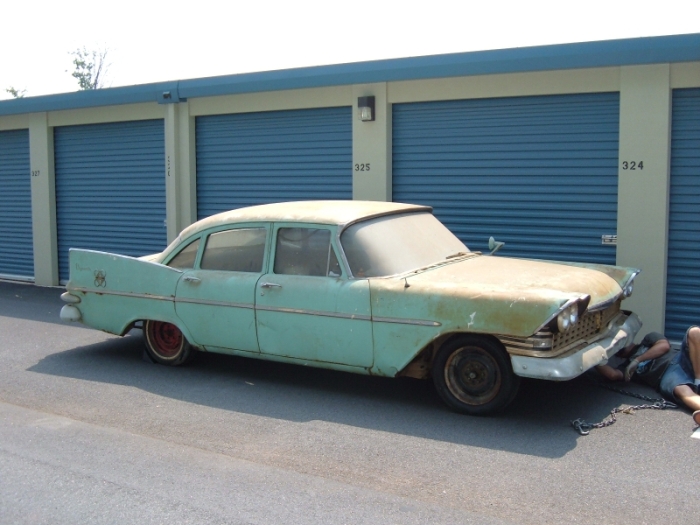

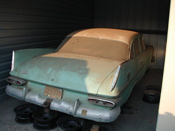

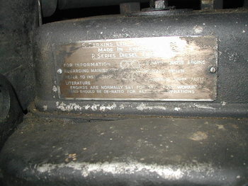

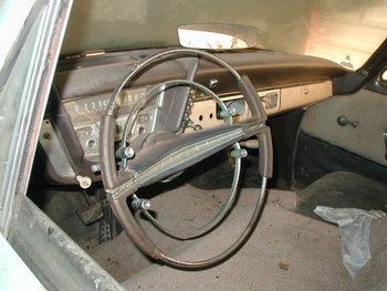

Ed, I just read the extensive thread on www.forwardlook.net that Matthew found. At the end of the thread - almost 6 years ago - folks are speculating what happened to the car. If you're not already a member there, consider joining and updating folks! And just because I'm a packrat, I've snagged Brian's pix from there, to post here:
