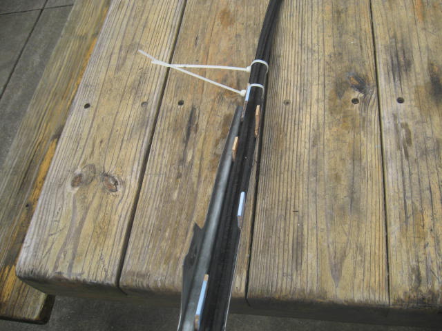

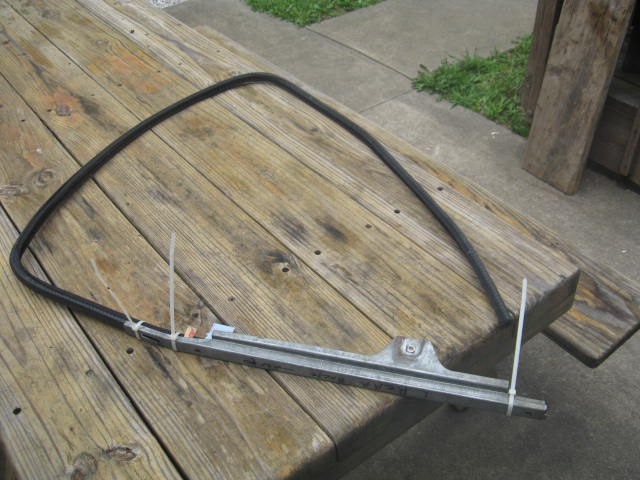

Thanks All; Matt I don't think it's going to make Carlisle this year,it will be close to done by the end of summer.Looking to bring it for next year.Dan the tywrap method worked good.The gasket would come off the fence when I worked the gasket over the glass close to the curve area.With the tywraps I would nip one off one at A time as I progressed upward till I got past it.Oddly enough the lock strip type gasket is also used on choo choos,but that glass lays flat on the cab, way, way easier, I have done those too!! Mark p.s. Dick you are the Guru not the amature.

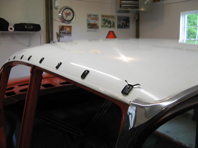

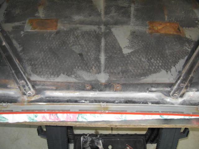

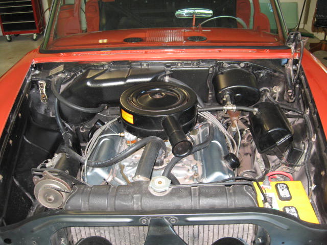

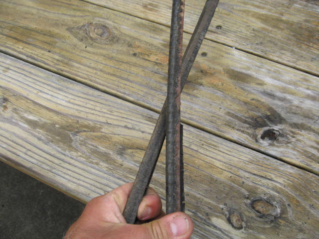

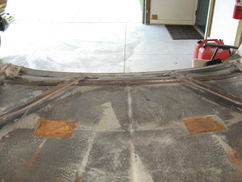

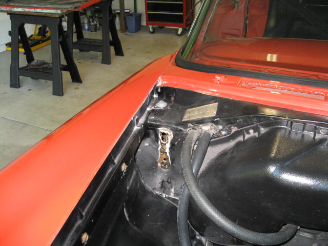

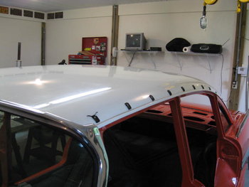

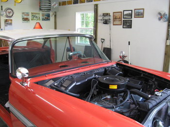

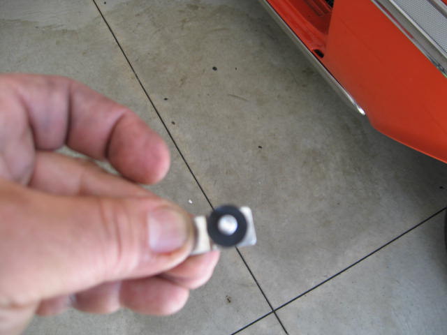

Got some more done. Waiting for the windshield lower trim clips from Gary Goers.Had to take the hood off to get at the mirror hardware. I needed yo take it off anyway for A paint and hood insulation.Came out good. What are those 2 holes in the hood near the cowl rubber( middle of the hood, glass end) used for? Looks like something was attached to them,don't know.ordered cowel rubber as well.Painted the inside of the roof it had some surface rust,light sand etc. I did not paint the shark teeth/adhesive area for the headliner, was afraid it may bleed through.It wasn't bad anyway. Had to use my old roof bow clips A light media blast and paint with new rubber washers and stainless screws. Those clips are nowhere to be had. Mark

Nice work Mark, just in case, l have headliner bows from my parts car.

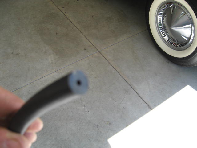

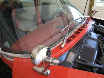

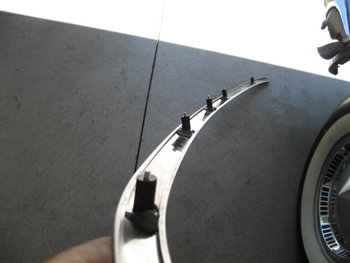

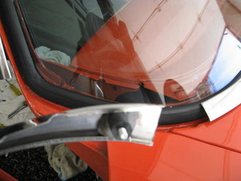

I have found A good for rubber/tubing for making the front and rear lower trim gaskets. It is very flexible, compresses nicely, easy to cut, seals excellent.I was looking at thick wall vacuum hose and came across this. It is sold by the foot for $2.99 I got A couple of feet and is more than I but will have other uses I am sure. Like I said very flexable/stretchy,not hard and fits over the 10/24 thread nicely with A little spray of soapy water. I got it from House of Scuba.com it is called bulk latex and comes in black. The item # is ACC395HA94BLK . It is 1/2 O.D 1/8 I.D. I got the windshield trim done, the grill trim and wipers back on and am going to put the hood back on.Just thought I would share that about that product it worked very well. Also used some more tight putty to keep the clips from sliding in the trim channel and line up with the holes. Mark

Dan; I got it on through amazon while doing searches for vacuum tubing.I will check to see if there is A phone # on the invoice when I get home from work. Mark

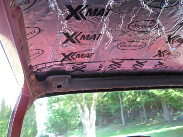

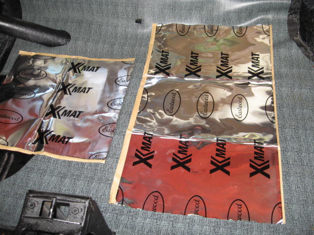

Used Xmat from eastwood. Thought I would try it.Anybody else done it before. It does make it sound dead. I tried to use the scrap pieces and get it inside the corners but I don't think that is that neccesary.I am going for sound more so than insulation. Going to do the floor later and if any left over pieces it will go in the trunk. XMAT from Eastwood#15841. My face did not even get dirty!!!!!!!! Mark

Veeeeeeeeeery nice. How many timers did it take, Mark?
Re: Marks winter of "59"
Good stuff, l used it in Charlene and Bertha Irene.
It took 2 Mark

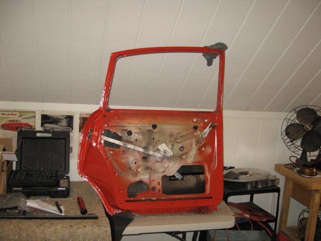

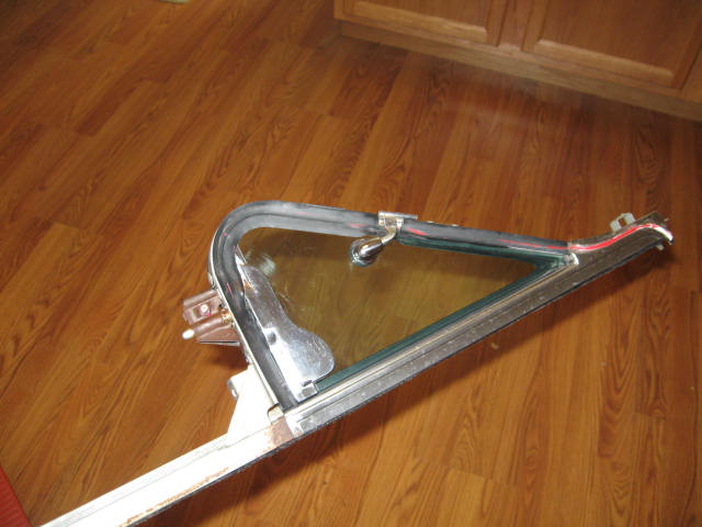

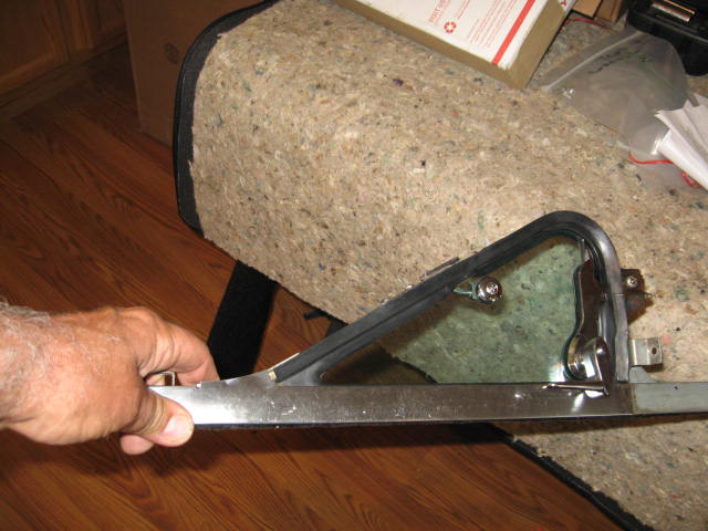

Well I am making A stab at the vinder schliders. Useing 3m weather strip adhesive.The window channel I got from gary goers is narrower and I can not find wider ones.I used tywraps and shimmed it with pieces of A paint stick to center it after I glued it. Later I will use either screws or possibly 2 holes and thin wire to secure them further. The right and left rear doors have different window channel, both are very old but one is wider (the correct one) more indication of some kind of accident very early in it's life(hence the window stop was missing as well, and the windlace on the right side does not match the left, and was "stuffed" in).When I get out of my chair you can see what happens my cat takes over,always involved in everything I do and is like my shadow. He was A throw away, I picked him off the road tossed out as A kitten I thought he was dead. That was 11 yrs. ago, I would not trade him for anything (my buddy).On another note this is for DAN.My Buick came from Philadelphia 6 yrs. ago.I understand you are from Philly. All original originally purchased from Kutner Buick. The badge is still on the back of the car. The original owner name was Thomas Demi 4286 Penn st. Kutner Buick was on Castor and Friendship st. It was the 3rd largest Buick dealer in Pa.I think they went out in 98 and moved to L.A. and became King Buick. They originated at the Philly dealership in 1948. The Buick was built at the Wilmington Del. plant which closed in 2008 and was building Pontiac Solstace.Just thought I would toss that out there Dan if it means something or may mean nothing. Mark

Now for some serious stuff. Like you l found the cat whiskers very narrow, l used a ford whisker with a chrome bead and the correct clips l got from Gary goers. You can also try Restoration specialties
