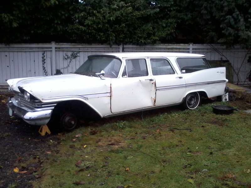

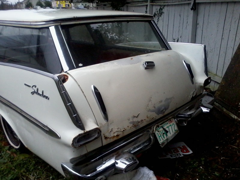

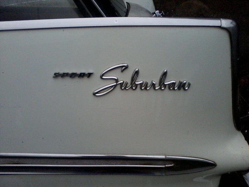

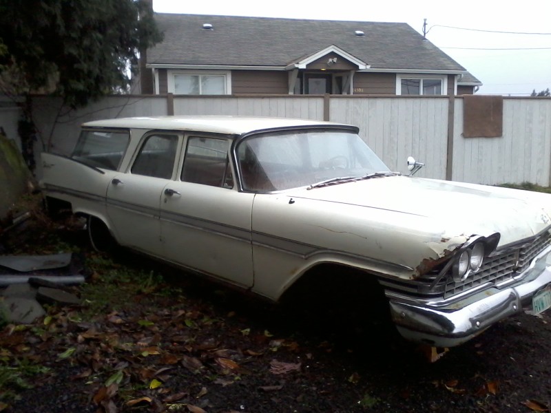

I just got a 1959 Plymouth Sport Suburban that had been sitting for the last 10 years outside with the tailgate window down and the drivers door that wouldn't shut due to some damage. I still saw so much potential that I got it and it was only a half mile from our house all this time but hidden behind a box truck so I never saw it until the truck was moved and there it was. I have pictures of when I first saw it and after the first cleaning and just today had it towed home that half mile and it sits in our carport. I have looked this wagon over very well and believe it or not there is just no rust in rockers or floors. The only rust is in lower tailgate and that isn't bad and the front of the right front fender, that's it. There are a few parts missing but nothing major. The engine is stuck but I have a feeling with a little work it may still turn. I have been in the car business all my life and a mechanic for most of it so I can still do the work my self. The glass is all good and so is the original spare. The mileage shows 48310 and the doors just click shut so nice.

Hi, well a whole lot of good news about my newly acquired 59 Sport Suburban. After getting it home yesterday and getting under it and going over everything very careful I find NO rust in the floors or rockers or anyplace else except the lower tail gate and the right front fender. I am thrilled about that.
The engine was froze up and I put some Marvel Mystery oil in all the cylinders and let it set for a half hour and I could turn the engine over by hand.
The wagon is very solid and I plan on having it running much sooner than I thought.

Dick - When I saw the pictures of your SW and the rubber bumpers on the front bumper I thought you had a California car. The M274 Confirms that it was assembled in Los Angeles. My Green car has the same rubber bumpers and is a M274 Car. Matthew will let you know dates, etc.

I forgot to say having a California car is why you have so little rust.
Re: I am a new member
Thank you. However as to no rust, remember this wagon sat where I found it for the last 10 years with the drivers door part way open and the tailgate window down, both front wheels missing so it was sitting on the ground all that time. Other windows were down as well. The spark plugs were all out of the engine and it was frozen. So I really had no idea what I might find once it was up so I could get a good look under it. I fixed the drivers door so it would latch, same with the tailgate and rolled up the other windows and now that it is home I am drying out the carpet and floor and it all looks good. Nice to hear it was made in California since I was born there and had lived in San Diego for many years.
So I know this will be a great wagon and should have it running much sooner than I thought. One big thing that did help is someone had enough sense to take all the rubber plugs out of the floors where there are any so the water didn't have a chance to pool up inside.

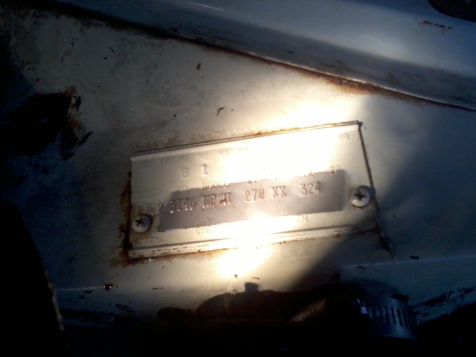

Here is the VIN plate for my 59 Plymouth Suburban. I am anxious to find out more about this wagon.

Alright!
Looks like it doesn't has Solex safety tinted glass and no power windows.
Has a locked luggage compartment and power steering.
Scheduled build date 2nd of April 1959.
BT - Body Type - 278 - v8 4dr sport suburban, 6 passenger
PT - Paint - XX, roof and body Iceberg white
TR - trim - 324, should be grey seat with red bolsters
Car should have a grey dash with this interior

I'm not seeing the rubber guards on the front bumper that Dick Koch is seeing. Are there other photos?
