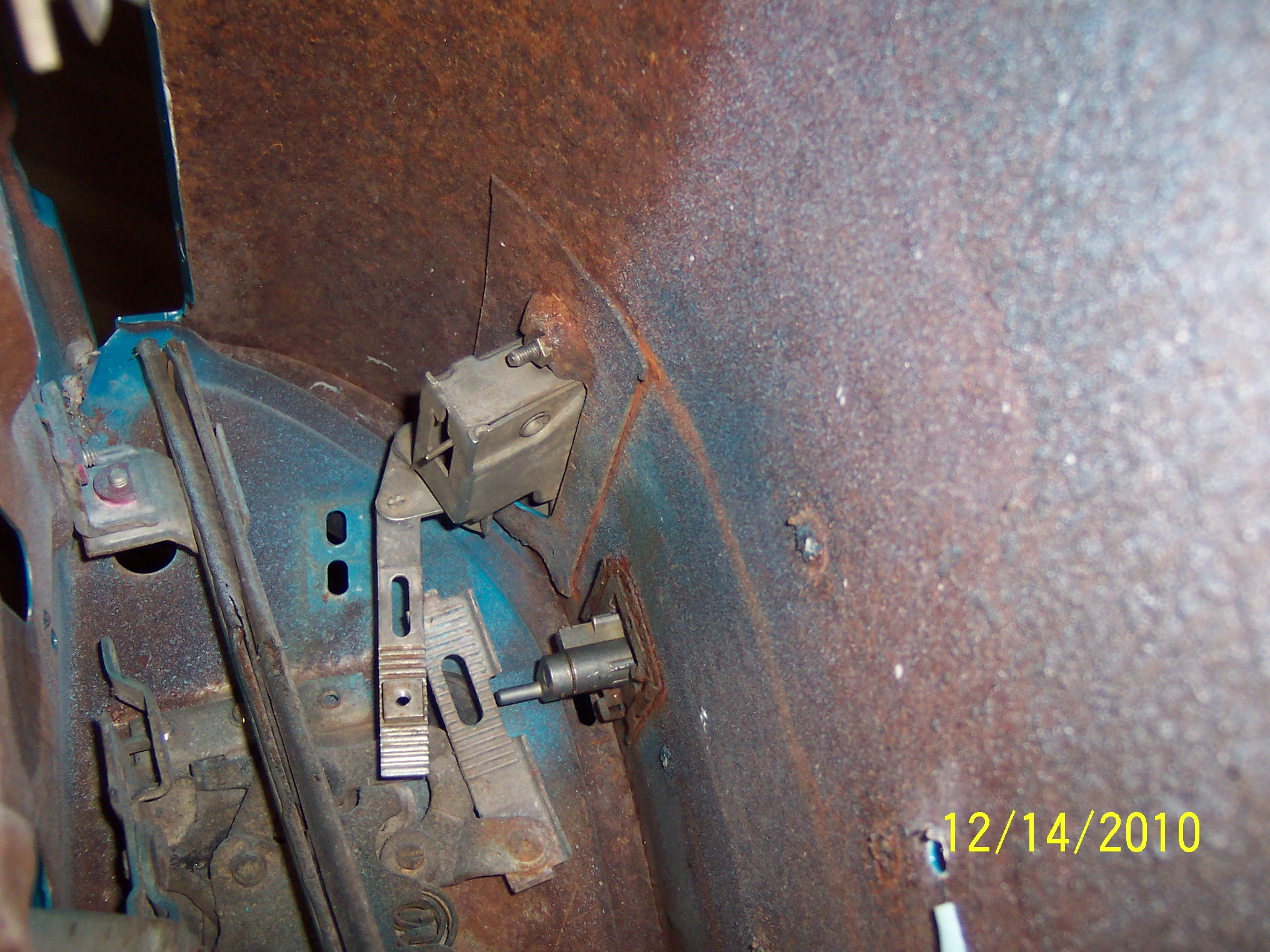

I will try to take a picture of this area to see if it helps visualize the slide tab.

Thanks, as always, John. Your pics remind me the door lock retainers are a bit more complex than the trunk lock retainers. The door lock retainers are a sort of self-contained mechanism, although it isvery difficult to see this from John's pictures.
Use a flashlight, and look for the upright "tab"....

Thanks for all the help, you guys. The visuals are great. I've got the door panel off on the passenger side and have had a good look at that lock. The bracket is a little bent, and I suspect that this is not helping me slide the thing over. I'm also having a hard time getting a good enough purchase on that tab to keep my tools from slipping off it when I give it a good solid pull. I may spray some more lube in there and leave it for a couple more days and see if that helps. I do have the yellow shop manual, but it makes this whole procedure look annoyingly simple compared to how it's playing out in real life. I suppose that's to be expected with anything that has 50 years worth of crust built up on it.

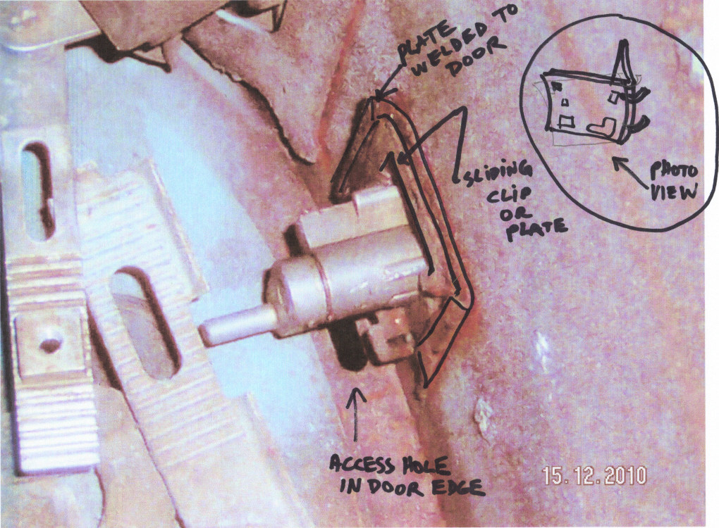

My apologies...I modified John Q's photo for viewing, but now I just can't remember how to properly post it!

Roger,rogerh wrote:My apologies...I modified a photo for viewing, but I just can't remember how to properly post it!
Send it to my email and I will post it for you!
Re: Question about front door locks...
Here's the artwork Roger made, I think this will help a lot!

Hallelujah!! I went in with the hammer and screwdriver and gave the clip a few good taps from inside the door and it finally slid over! I got the lock out of the passenger side now, and I'll do the driver side tomorrow once I get the door panel off. Thanks so much for all the help and the great photos and diagrams! Those were a huge help in figuring out exactly where I needed to smack the thing.
