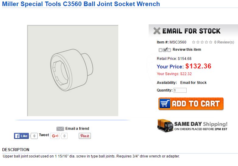

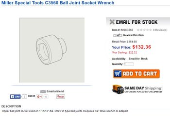

Hi Eddie,
The shop manual (here: http://www.59plymouth.net/59gallery/alb ... ension.pdf) says the tool you need is a C3560. I googled it, and it came up!
It's 1 15/16", and that's 49.21250mm - a 50mm socket ought to do it. I'm guessing a deep well!

Hi guys,
Thanks for all the help! I found several used sockets on Ebay, which are quite affordable (betw. 20-40$). However I'm still confused regarding the size, whether it's 1 15/16", 1 29/32" or 1 59/64". There are even auctions for the same sockets which state different sizes
There are Snap-On Sockets (S9365A) which should be a 1.924 diameter, which is slightly bigger than the 1.915 dia. Mark pointed out. Seems to be good to me. Otherwise I also found a Miller C3560 in a used condition on Ebay. Guess, I both would do it, right?
