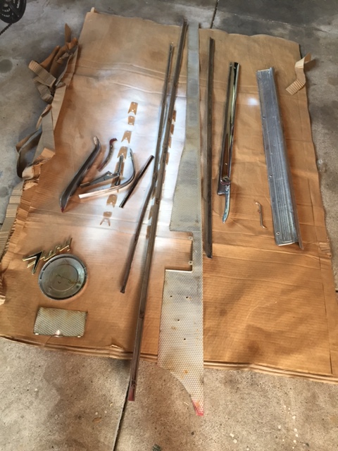

Today I crossed the Rubicon - started removing the trim from Faulkner. My plans include getting all the trim redone (word up, Dick - a PVC tube will coming your way soon), reanodizing the aluminum, getting some chrome redone, putting in new carpet and painting the interior black, a little body work here and there and restoring the paint to the original copper color. I will also be scraping and painting the undercarriage and installing a new exhaust system.
I was futzing with compressing the center of the spring clips, until it occurred to me - if you spread the wire ends, the center compresses and pops through the hole. D'Oh! This was a revelation to me. I've gotten fair warning about the reverse procedure, however - to be very careful pushing the clip back through the hole when it's time to put back on, lest you ding the trim.

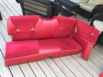

Everything came off pretty easily, although I took my time. I removed the back seat and side panels to make it easier - I'll be painting these black anyway, so the interior has to come out.

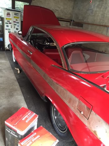

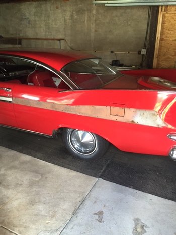

More stainless came off today - just about everything on the driver's side.

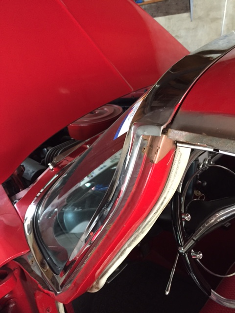

I'm stuck, though, on the top of the windshield. This is the part that the Keijs warned me would be difficult. The three screws are out of the doorpost piece, and the one screw in the bottom - I thought perhaps I could just slide if off, but it won't budge. What's the trick?
And what about the bottom - does it have the kind of clips that hold the rear window bottom strip on, and am I going to have to use the Dick Koch Patented Milk Crate trick to get under the dash to remove?
Also, does the rear window upper trim snap onto the gasket, the way the side trim does? Any tricks here, besides carefully prying off?
Oh, and check out the jackstands and floorjack I scored from Harbor Freight, $200. Six bucks of that was for shipping! Amazing - I'm inclined to take "3 Ton Floor Jack" quite literally.

Windshield:
You got the screws out, the side part attaches to the top part slide outwards if I remember.
Then you get get the top part off. The lower side pieces are screwed on.
Lower piece, yes! Under the dash. Same as the lower rear window piece.
As the top part of your rear window. It's snapped in the rubber. Lift the part that's is closest to your roof and it the trim should be pushed towards the rear

Dan - The center top piece of the windshield moulding is removed by taking the screws out on each end then prying up on the rear side of the moulding, make sure you protect the paint on the car using something like a plastic credit card under your pry tool, use something at least 1" wide so as not to damage the stainless. Under the piece are three clips with a flat rubber washer under them (these washers can be had at ACE Hardware). To install the piece place it on the front of the clips and snap it on at the rear. Do not tighten the end screw too much because it will show when you slide the end pieces on. There is a discussion about this on the site, do a search "2 DR. HT WINDSHIELD STAINLESS MOULDING".

The front bottom clips as Matthew says are the same type as the rear but if I'm not mistaken the two on the ends at the front are longer that the rest. I think these longer clips are holding the side pieces down and will have to be removed before you slide the pieces off. Make sure you use plenty of sealant on these clips when reinstalling them or your feet will get wet in a hard rain. I'm including the site where you can get these clips NEW.

It looks like I have to remove the windshield post trim, before I can remove the top center windshield trim - it overlaps it. But I can't get those suckers to budge. What's the holdup, besides the three screws?
With regards to the lower windshield piece - it's easy enough for me to unscrew underneath the dash, using your patented technique. But, are all the clip nuts accessible this way? Is it possible I have to remove the cowl vents to access some of the nuts?

The bottom of the post trim on the bottom overlaps the middle piece of trim. Under the dash all the nuts are fairly easy to get too. The nuts on the ends hold the post trim down. Besides the screws on the post there is another screw just to the rear of the fender, you can see it when the door is open. The post trim slides towards you, sliding off the middle moulding and also sliding off the bottom end clip. The two screws are under top end of the post trim, you can not see them until the moulding is removed. You should not have to remove anything under the dash.

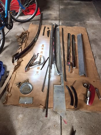

The post trim is off! For all my tugging and pulling, I got nowhere - then, I took a block of wood and a light persuader to the lip at the top. Light taps showed me that it was moving, so I knew I was onto something. Fifty-six years of caked Idaho dirt! Very little in the way of rust on this car, though - those desert conditions have been good to Faulkner.
With a good tug, I can slide the top center trim back and forth with the screws out. But, I came back inside to reread your post, Dick - headed back out to take a wide plastic trim remover to the back lip and see if I can pop that bad boy off of there.

Actually, beer helps. I tried my soft block of wood trick with the rear window upper trim, and it too popped off the window grommet perfectly intact. But I'm getting nowhere with the upper windshield trim. Back in the house cooling off (it's 95 F in the garage!), but I'll be back at it soon.

As for the top trim, I think I pulled the front up and the rear (towards the roof) clicks off.
