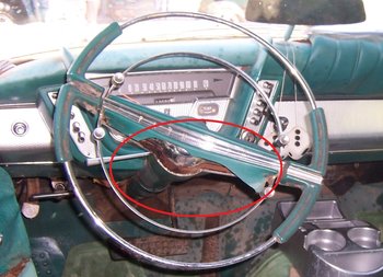

Thanks for the quick reply, John. I'm just looking to replace the original steering wheel, which I assume to be standard since this is not a highly-optioned model -- doesn't even have a radio, which for all I know might mean this is a rare one (remember I'm a newbie). This car couldn't be any more original (father to son to son ownership -- even has the original rubber floor mats). I actually have not laid my eyes on the car yet but plan on taking the significant drive to do so in the next couple of weeks. As for the recast, I got a quote from The Steering Wheel Guy (stwheelz.com, Doug Lepak) for $1,200. Ouch. The major problem has got to be a large piece broken off of the lower center (sorry I don't know the right term). That's why I figure a replacement is probably a better way to go. Even if it needs some work also I can't believe it would cost nearly that much. Here is a photo of what we are talking about. Thanks again for your help, John.

That is the optional deluxe steering wheel 8)
John has a good address to have these recast. The center is some sort of vinyl.
Maybe you can have that part redone too by an interior specialist?
As far as options, on that pic I see the steering wheel, dash pad, heater,torqueflite and windshield washers

Your car's steering wheel is known as the Deluxe steering wheel. It was an option available for the Belvedere.
The standard wheel isn't awful to look at, they are more commonly available and way more affordable.
Where your deluxe wheel shows bare chromed metal, it used to be covered with clear, sparkley resin grips. The re-casting of these grips is costly.
In your photo you circled the damaged center section of the wheel. This part has a foam base with molded vinyl covering.
Heat, sun, and time cause the foam to decompose, and the vinyl to shrink. It is not easy to find a decent replacement, and I do not know who might be remanufacturing them. Just Dashes in california is remanufacturing the dashpads ($800, maybe more?), and might have answers.
If you find a good center section, in the wrong color, take it to your auto upholstery shop...maybe they can dye it to your needs.
