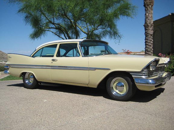

I have been working on my 59 Plymouth for about 5 years and finally have it all sorted out so it drives like a new car. The surprise is under the hood. This winter I plan on pulling the body to install a new clean firewall and Vintage Air. I will also deal with a few small rust issues and make it look as pretty as it drives. I first joined this site back in 2006 but my original pictures are no longer here, so I thought I would post a couple of updates! I really enjoy this great site.

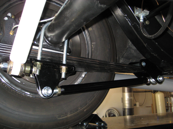

Thanks for the replies! This has been my long-term project and all the mechanicals have finally been sorted out. So far it has been 100% reliable and unbreakable. It can be used as a daily driver and is tame enough for stop and go traffic, but if you get on the gas it is scary fast! The modification that made a huge difference in drivability was the addition of CalTracs traction bars. I installed them to prevent wheel hop, but the best part was how it smoothed out the every day driving by preventing the spring wrap-up with shifting. The engine has so much low end torque it would start to oscilate the springs with regular driving...now it is very smooth with shifting and much easier to drive! Plus it hooks up so well in 1st gear it is amazing, and there is absolutely no wheel hop. Prior to the CalTracs I couldn't use 1st gear, and it ran 13.3 at 110 mph using just 2nd, 3rd, and 4th gear.

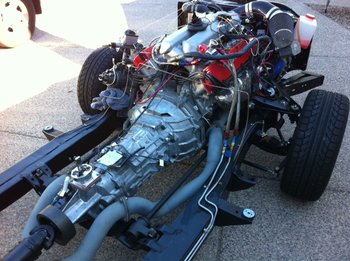

I pulled the body for restoration, and got some good pictures of the drive train.

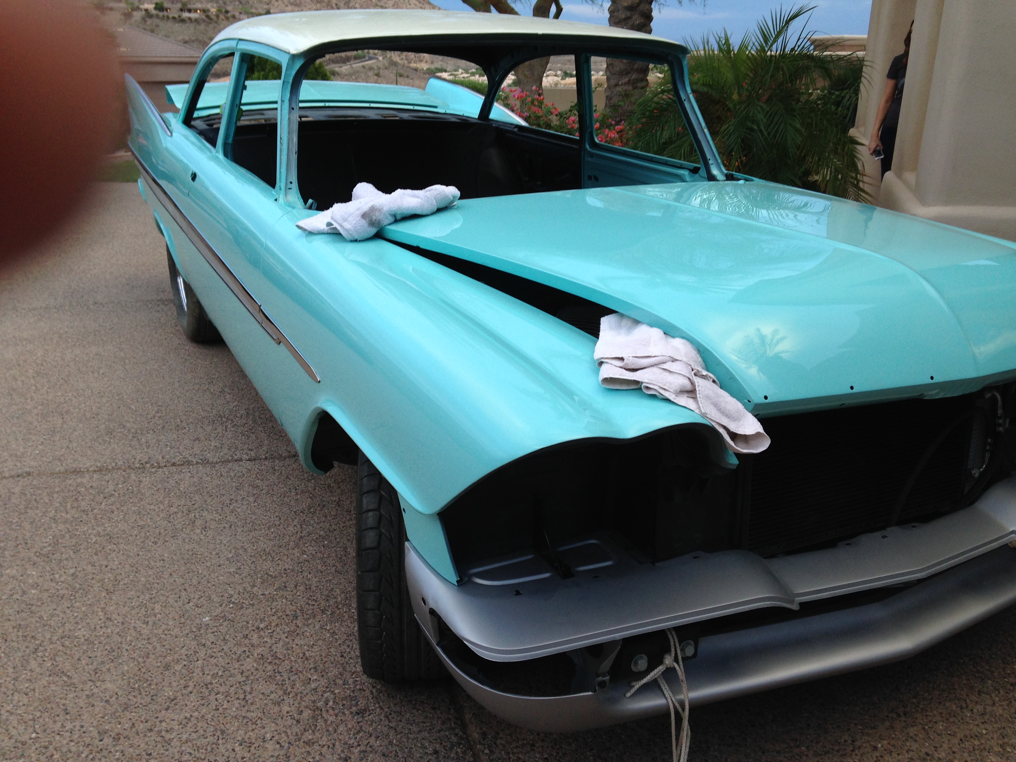

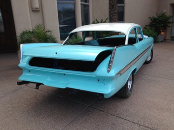

Got the body back from the painter. Now comes the fun part of putting it back together!
