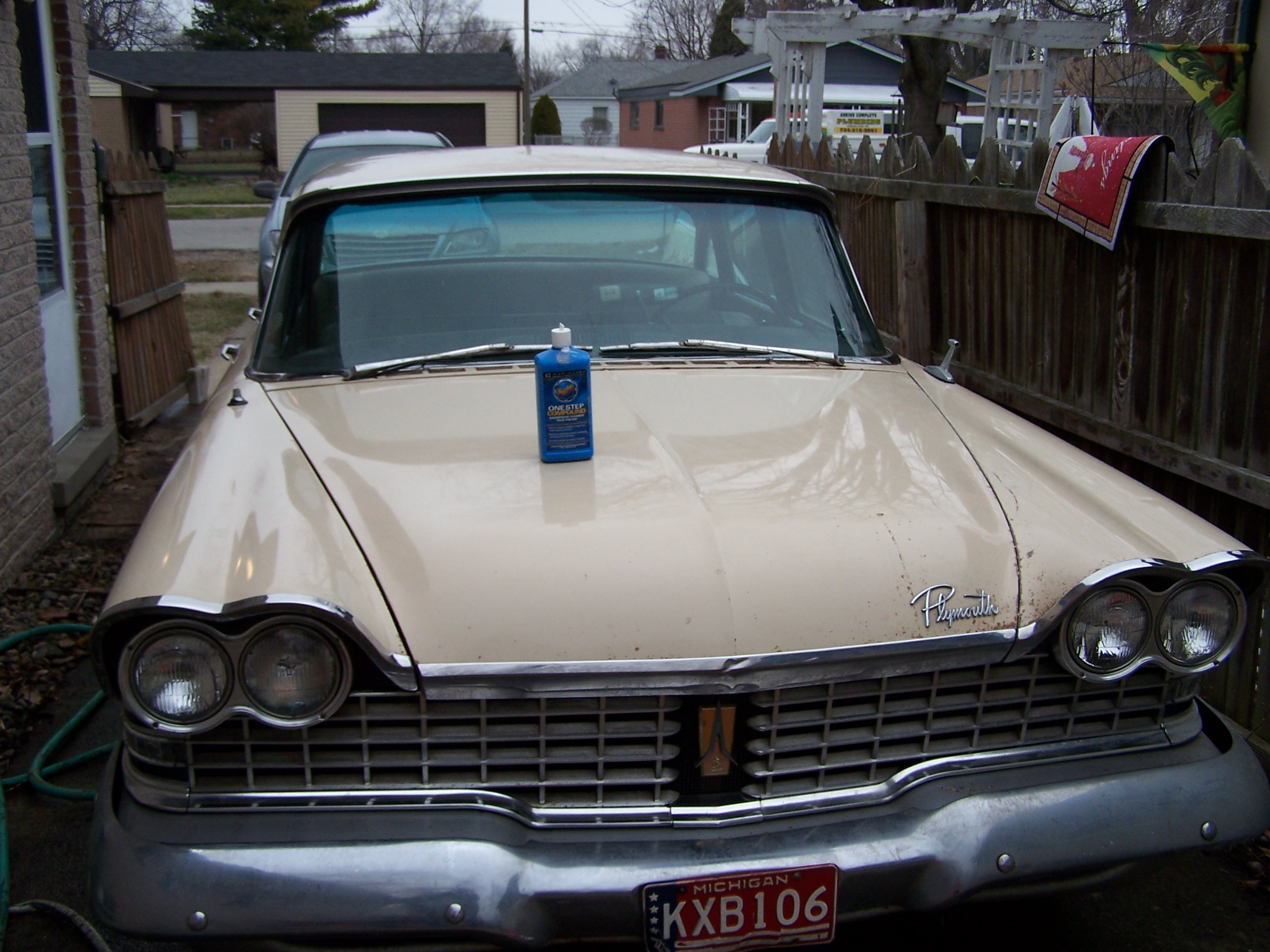

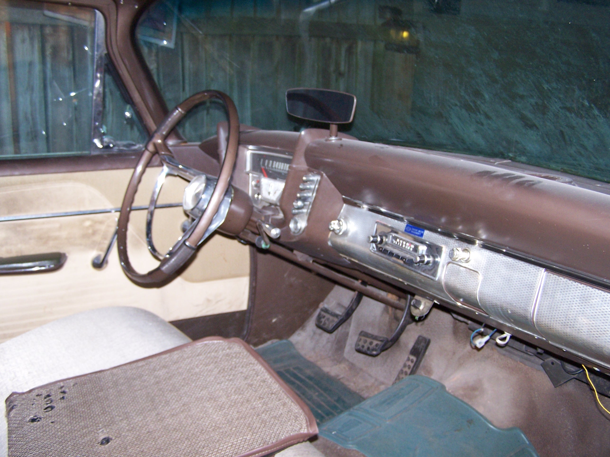

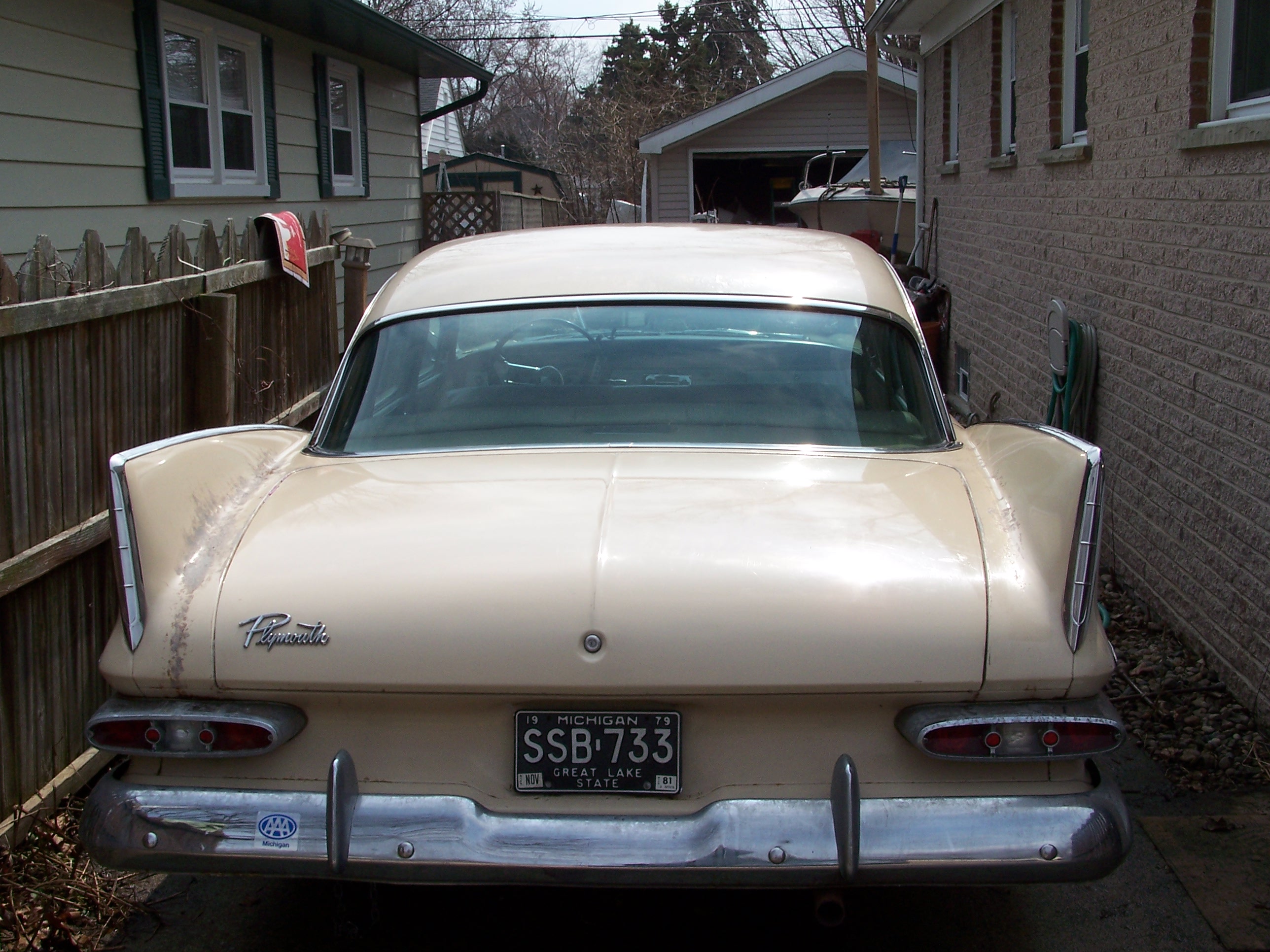

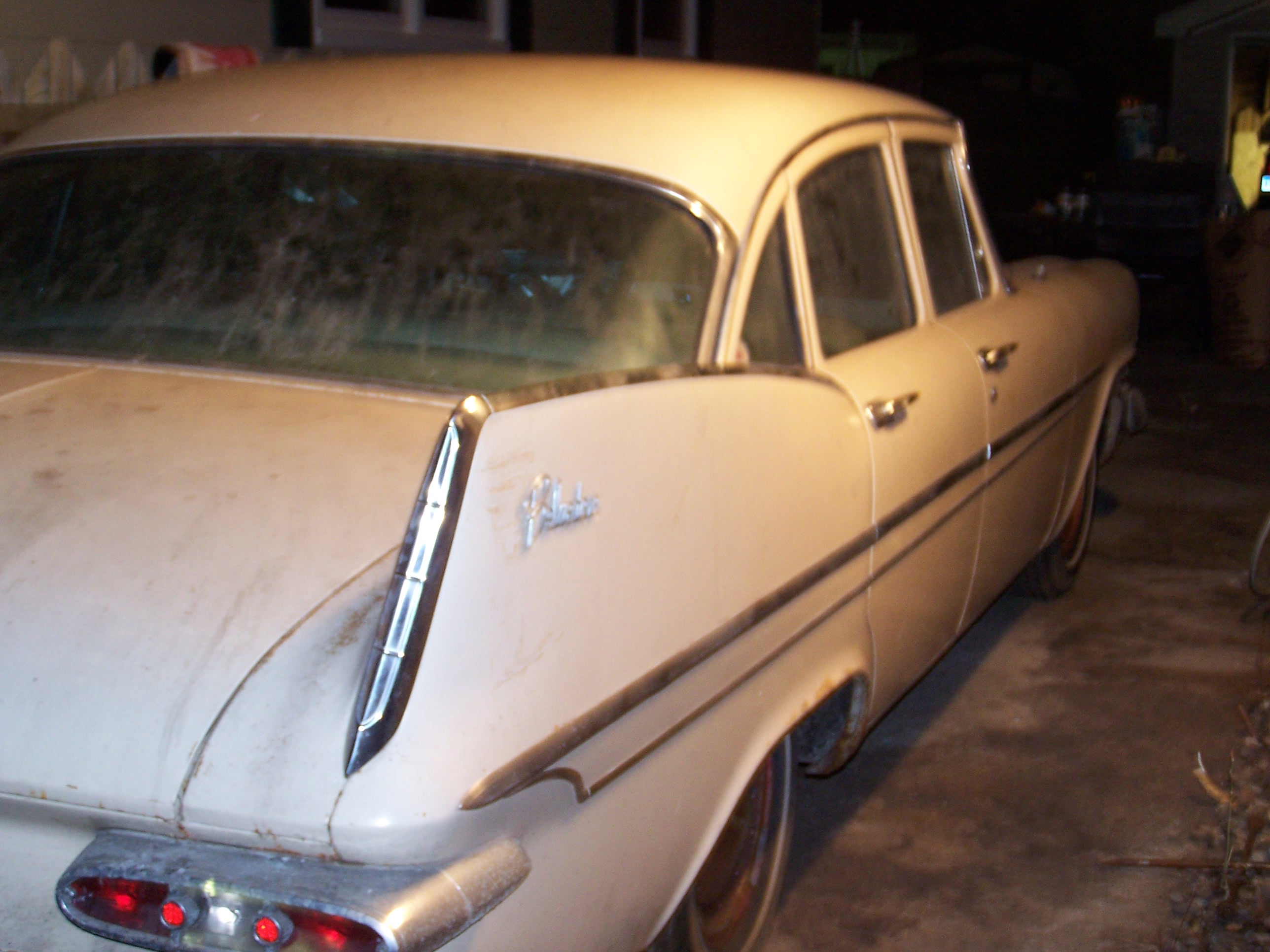

Here she is, my 1959 Plymouth Belvedere. Stored last 30 years. Interior is awesome. A few tears on drivers back rest. Otherwise floors, dash, door panels like new. I would never have anticipated it cleaning up this well. It is running now, off remote tank. Car was undercoated and solid. It's a Michigan car, so small small rust behind rear rockers. Some surface rust. Complete original car. IF all works well, photos will be attached. My computer booted me on first attempt.

That is sure a clean '59!
Someone sure took good care of the car to have it avoid the road salt rust that I remember from growing up in southern Michigan.

Sharp car! And to survive a hostile enviroment like the Salty Roads of Michigan is a miracle...Good find!

I love it.....Very clean!!!
Is that Sand Dune White??

I love it too! So nice to see a 4 door sedan for a change and in great original condition

Thanks all, and Ron yes, I am happy to have the 4 door sedan with flathead. I don't want muscle, I want an original car. When I first looked at it, the seller said he had a lot of calls, but when they discovered she was a 4 door Post car, not hardtop, they passed on it. My luck. Hey Jason, not sure if that is color, it is a beige/tan. I picked up four hub caps today that appear to be 59 for 45 bucks. I have to compare them with catalog when I get home. Great find on the caps regardless. The brake parts and water pump showed up yesterday. I have enough parts to keep me busy for a while. Here in Michigan, it looks like I get one day of no rain on Saturday. After that, the manual transmission is the only unknown left. I am hoping gas tank will clean out.
