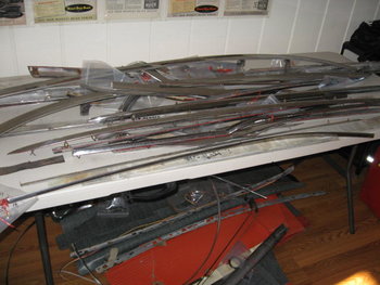

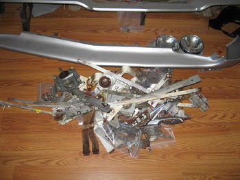

Dan;Thanks for the insight and pics,your dash came out good and I will probably go that way.The windshield trim removal should be A piece of cake for removal as there will be no headliner and all clips/fasteners will be exposed.Been doing lots of bagging, labeling,organizing.I attach all hardware in zip lock bags with notes and sharpie pen with items,the upstairs of my garage is starting to look like an assembly line. Mark

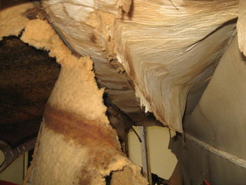

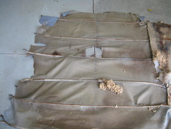

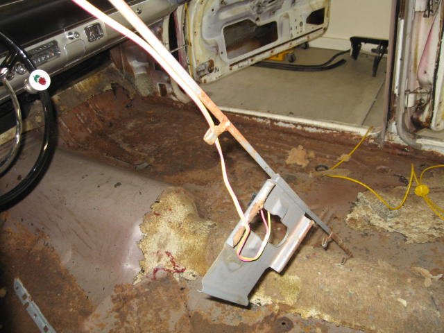

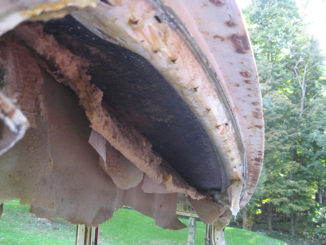

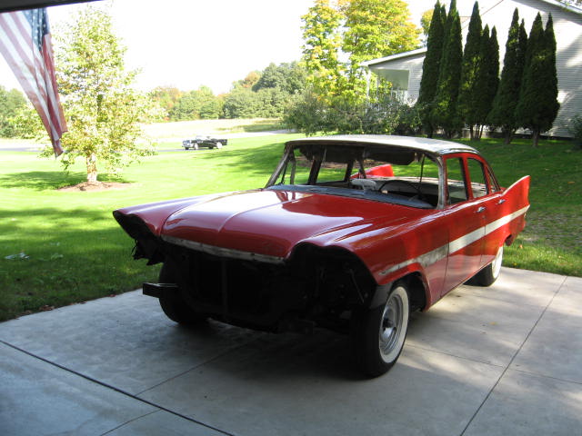

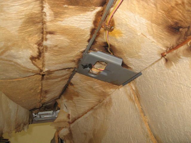

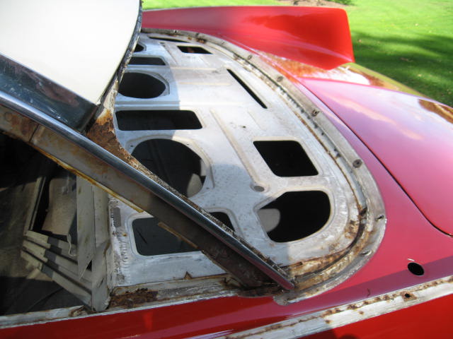

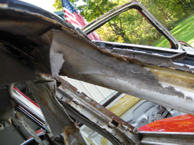

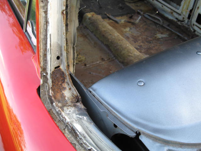

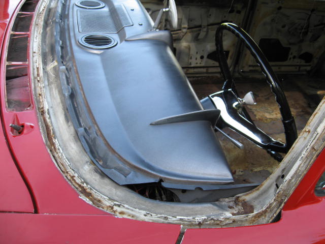

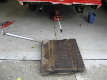

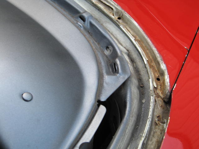

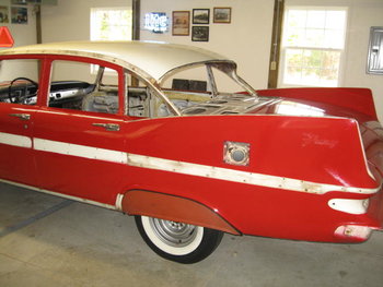

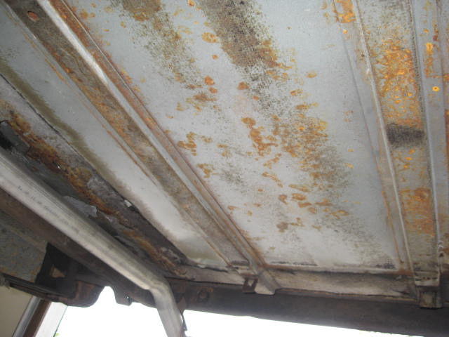

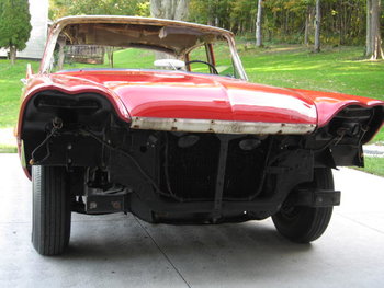

Got some more done.Getting closer to paint,I would like to take the fuel tank out.It does not look too complicated,any tricks to the animal?The windlace in the picture is different,the one on the left went in and around the front door,the one on the luft is from the rear.Why did they use two different styles?Factory mistake?I am positive it was never replaced(fasteners are eaqualy rusted,middle sponge is dry toast,headliner never been out) mystery I guess.Far shot of the Buick(the other woman,hence my screen name "55 SURVIVOR").The front windshield top edge is different than the 2 door hard tops,it is kind of A visor,and different clip fasteners,"bowed".The front and rear glass edging looks very good,minimal rust,the gaskets had to be cut,and removed the outer inner section.They were very hard,no flex what so ever,it just broke apart inches at A time,had my brothe help me lift them out. Later Mark

Re: Marks winter of "59"
Mark - As far as I know the windlass should all be the same. I got mine from Gary Goers, he sells by the foot. Make note, the front door windlace is held in place at one point by a piece of metal abouts 3/4" wide and three inches long and two screws where the dash meets the side panel and where the door jamb goes from vertical to horizontal. The dash needs to be dropped down so you can apply that piece of metal to the windlace otherwise the windlass will keep falling down as in Charleen because I didn't do it right. Now that I've thoroughly confused you and you need pictures let me know.

Dick; The curved area where my dash meets the side panel the windlass is held in by small brad clips.With the dash bolts out there it enough room to install those clips with needle nose pliers to the margin of fabric on the windlass. There is A small retainer moulding below at the floor it has A channel in it to secure the lower kick panel as well. Dan wants some pics I will check them out too post what you have thanks!! Mark

Dick ; I can see in your pics the windlass "snaking" around where the dash goes , the curved portion of the dash has 1 large screw to take out. I then took the bolts out at the windshield and it moves enough out of the way to get at the windlass clips I think there are 3 or 4 of them.When I install the windlass I can mark and punch A hole in the marginal tab of the windlass with A bent finish nail and install the securing clips with needle nose .Should be plenty of room with the dash "loose".Is your windlass held in with screws , rivets ,small clips? I know the first thing that goes in is the windlass , before the headliner and trim go in. Thanks Mark

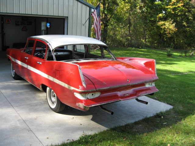

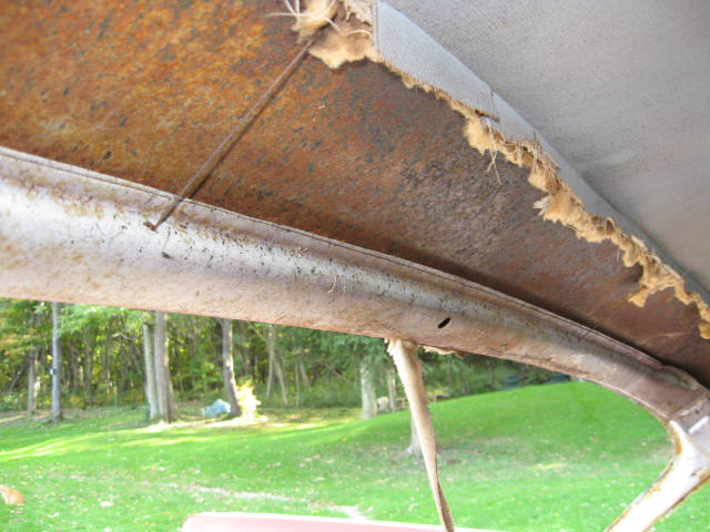

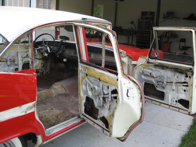

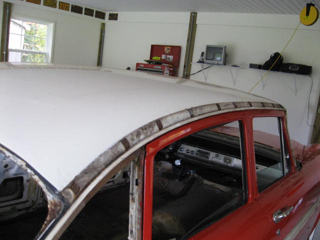

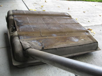

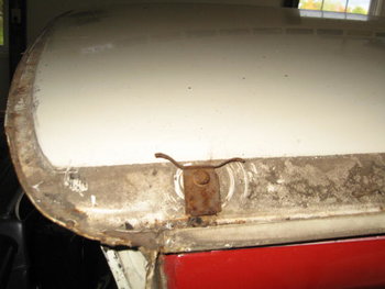

Got some more done,It might be going to paint in A week or two.There is not much more I can do,I took all the glass out of the doors,and removed what was left of the cat whiskers,and the glass guides.I mounted the skirt brackets and need to remember to send them off to paint as well.All looks good as far as rust,the only trouble I had was the drip rail trim.It wanted to roll (sardine can lid) no matter how gingerly I removed it inch by inch.Can that trim be had if I need two of them,I think mine are ok but worst case would the trim from A 69 charger or roadrunner be the same,might be just A length difference,that trim for those can be had.I know some things are similar as in the headliner install methods (5 bows,rear retainer wires,shark teeth on the front and sides). I'll bet the gutter width is the same,I'll need to check the length.Worst case it can be left just painted I guess. I also dropped the gas tank,I want replace the sender and seal the inside,it came out like A piece of cake. Later Mark

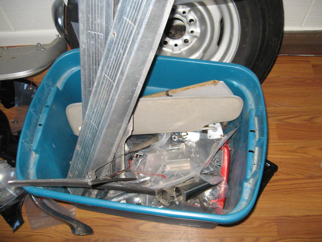

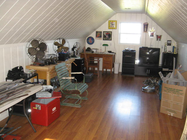

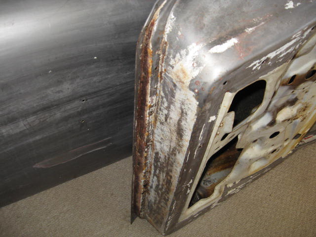

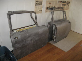

UPDATE!!!! PAINT JOB!!! &*((&^%$$###@#$^&&(*(^&%$$$$$$$$$$$))(^%^%$$#%^&,you know, what Dick said. Seriously I got the car back A week ago,my body guy crapped out,to busy with collision and deer hits,it sat at his shop,got the doors off and stripped,and with the onset of snow season it will be dead in the water for months,if at all.He bought the shop and bit off more than he can chew.Been checking around and have some other sources.Even called "Bob Ore Restorations" He is about 3 miles from my house,advertises in Hemmings.He would not even throw out A number,just hand over the check book. Options 1.find someone good and reasonable 2.Hit the lottery 3.Wait for summer and do it myself(would help if I was retired like someone else I know).Looks like it's going to take time!!! Mark P.S. A shot of my garage upstairs,lots of parts,all bagged and labeled,the doors look great,was thinking do A media blast and prime.I have someone good for just that.
Mark - l feel your frustation, since it may be awhile and if you have not already done it I suggest you wipe everything including painted panels with OSPHO to prevent further rusting. Do not use on aluminum or stainless.
