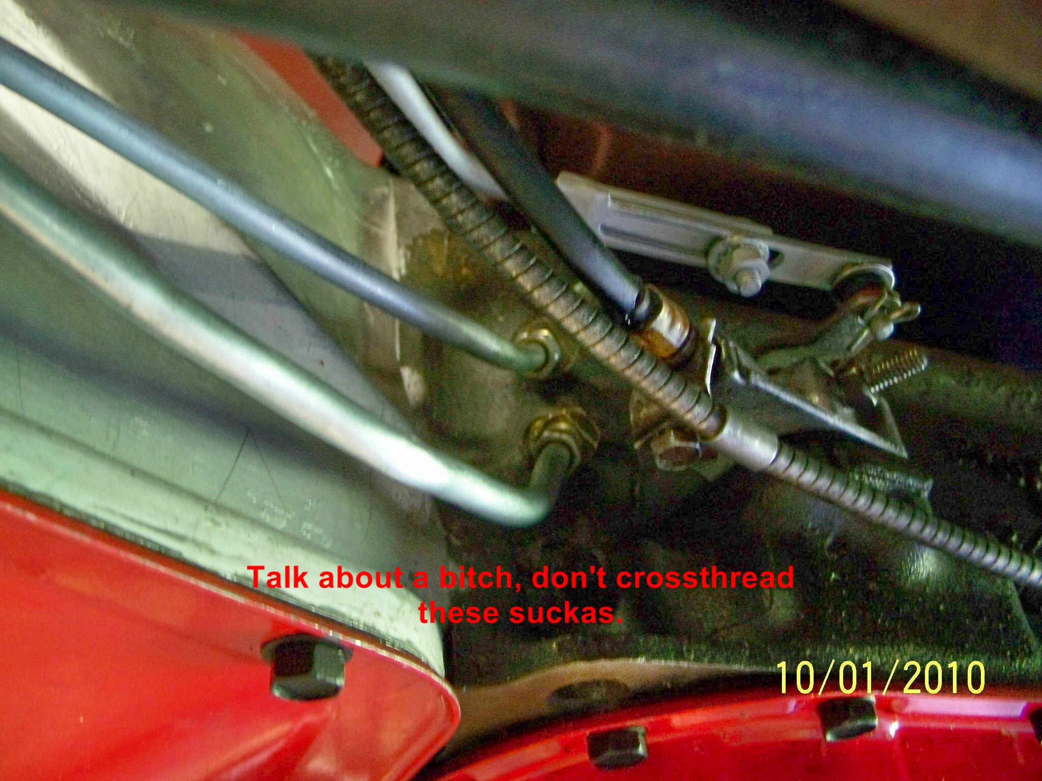

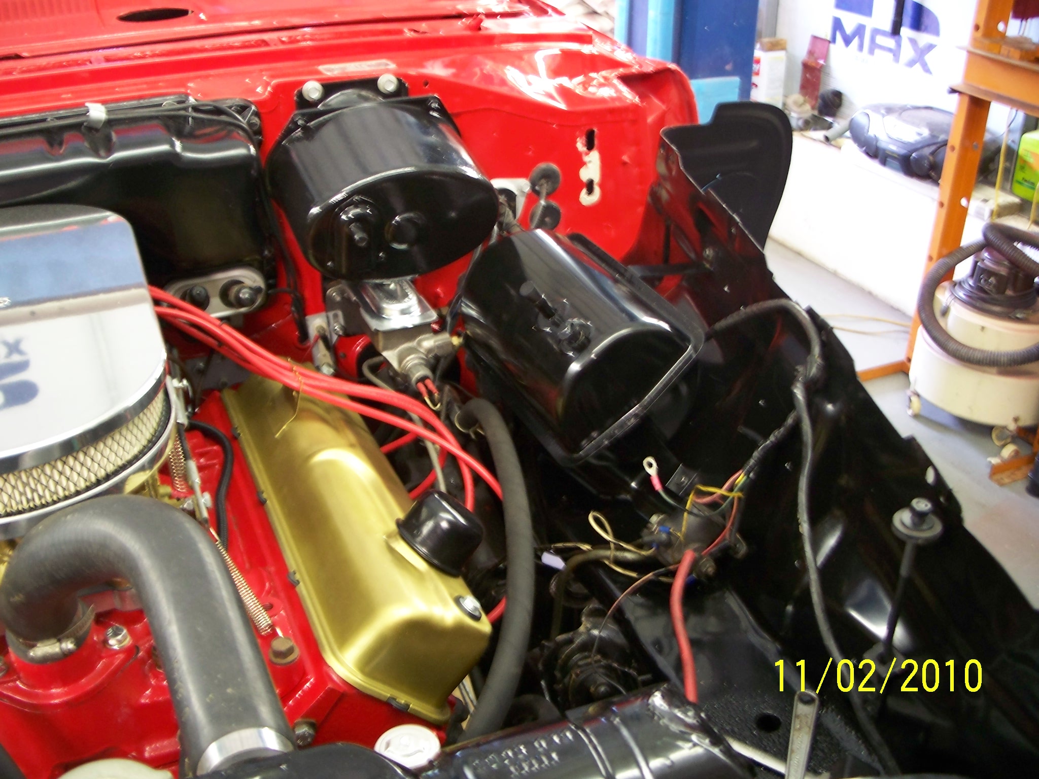

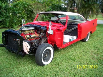

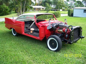

I'm typing this twice, tried to upload attachment and lost everthing. Going to save often this time. Here's some more pictures. Had to make Trans. cooling lines because I couldn't find any ready made. Believe me, its a bitch, took three days, I could not get the fittings to break loose at the tranny so cut the lines, BIG MISTAKE, when threading into fitting I cross threaded the fitting in the tranny. NAPA had one in stock (whew). When I started the engine the suckas leaked, damn, took them loose and could not see anything wrong, put them back, tightned as best I could and walla they don't leak, go figure. Took the carbs apart, cleaned and blew out and replaced all rubber and gaskets, painted same color as valve covers and installed on engine. I figures I would try to get the engine started with the primary carb in the rear and go from there. Put gas in tank, poured some in carb. and walla it fired first time and pulled gas to the fuel pump and kept running, I timed it, adjusted the Idle screws and it continued to run, purring like a kitten, gave the front carb a little throttle and the engine reved up. I moved the car outside so I could put the Desoto on the lift to get it ready for this weekend. I took it to get a tire replaced and on the way home it konked out. Would start but when you gave it gas it stalled, evertime. Had my son bring me a rebuilt carb (2 bbl.) and repaced it in the Sonic parking lot. Try that with one of the new Jelly Beans. GOT IT HOME TOOK THE PETRONICS OUT, PUT THE POINTS BACK IN, REPLACED THE COIL WITH A NAPA COIL (IC-7) AND IT STARTED FIRST TRY AND WOULD NOT STALL WHEN I GAVE IT GAS. A MOPAR MECHANIC FRIEND OF MINE TOLD ME THE PETRONIC NEEDS TO SEE 12 VOLTS, ANYTHING LESS AND OVER TIME THEY FAIL. S---CANED THE PETRONIC AND PLAN ON PUTTING POINTS BACK IN MY OTHER CARS.

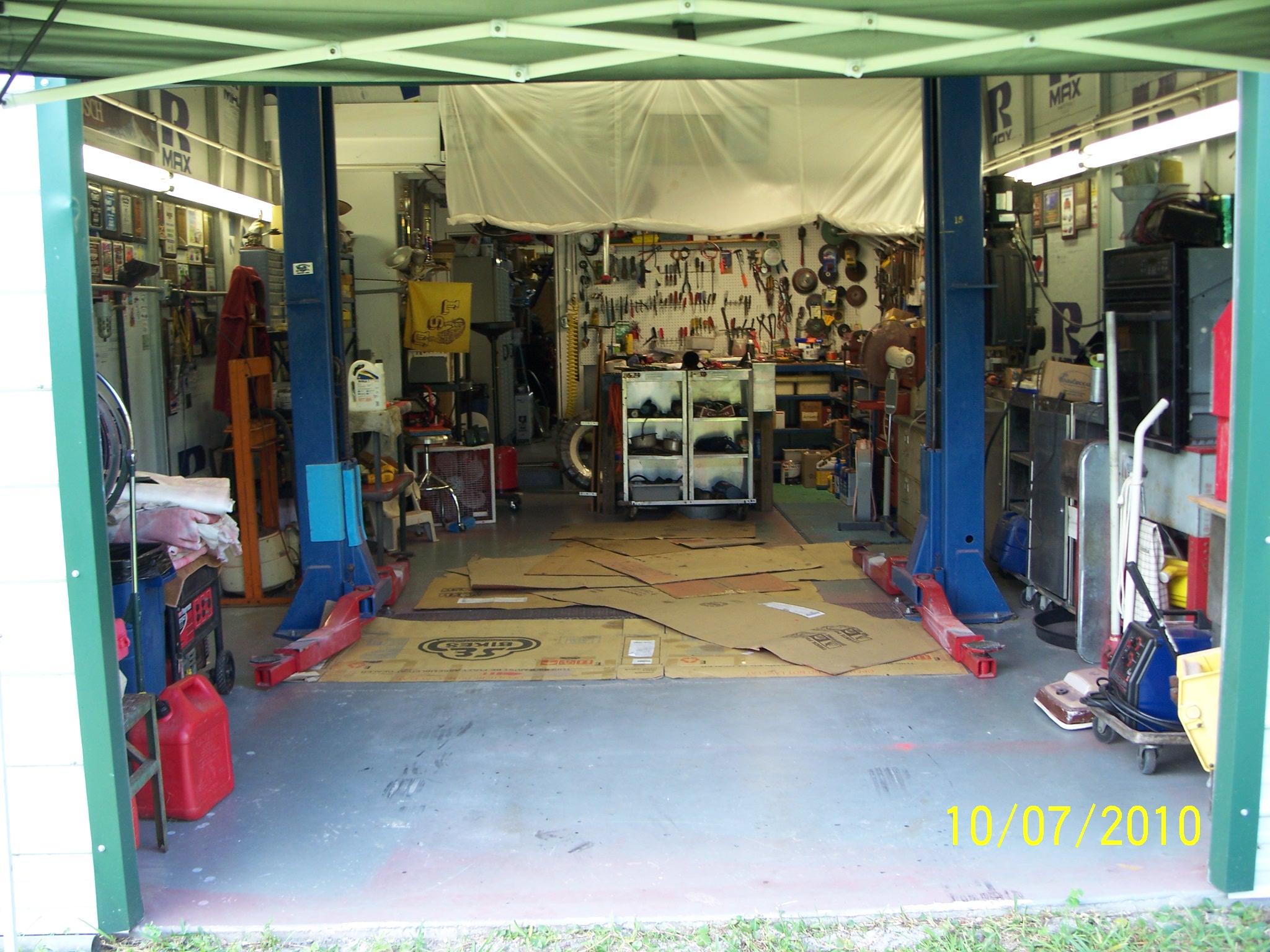

I am not happy with paint job so I will be doing that over. Not enouth coats, orange peel etc. I included pictures of my garage addition and the cramped quarters of my garage. I'm so used to it, it doesn't bother me anymore and I have to take far less steps to get anywhere. I'm going to save this now before I try and uploads.

Dick, I hear you on the trans lines...Cross theading them is easy to do on them. Came close to doing it on my lines but stopped before I had garfed up the threads to far on the fittings. And was able to clean up the threads a bit and they went on with out a glitch, I hope to never take them off!
I do like your garage set up and it may be tight but it is all focused towards the car work at hand. I will be getting a 4 post lift in a month. Can't wait to get it to use my 14 foot ceiling space.

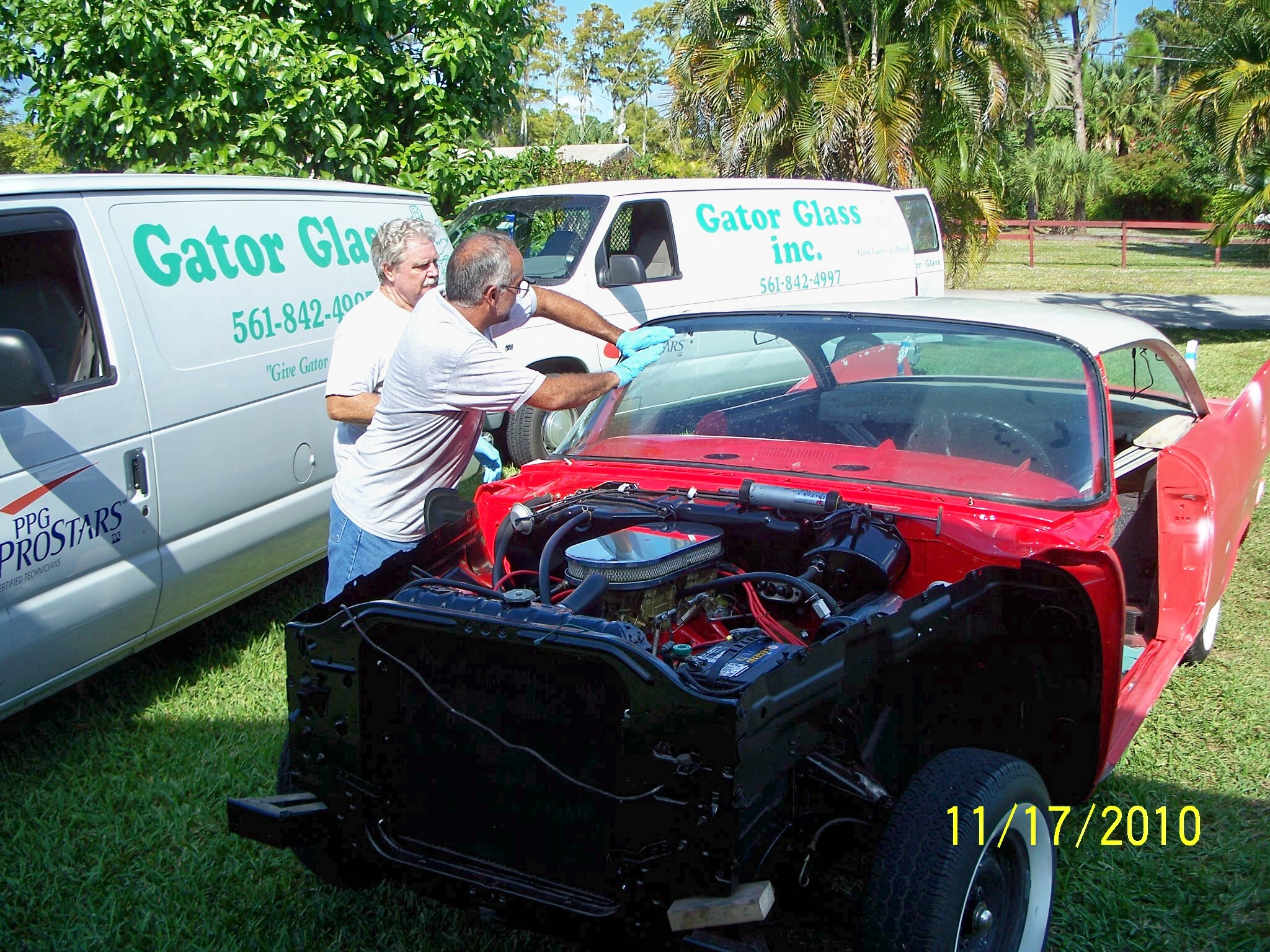

OK, two weeks of fun is over, Ron and Marjo's visit was great, what a pleasure they are. Then Turkey Run in Daytona, 3 wonderful days, saw Ernies beautiful black SF, pictures to follow. These pictures are of the windshield gasket, molded, from Gary Goers, it was in a small box for 4 years and took a shape all its own and grew about 2-1/2" longer, had to cut a piece out to shorten. Finally got it to stay in place and then installed the windshield I've had sitting for 3 yrs. The windshield started this whole thing so this is a milepost for me. This windshield I purchased directly from Pilkington, it was manufactured in 2001 in Mexico. They told me it would not have the bubble of the original but I beg to differ. It has as much bubble as my Green SF. It's a Libbey Owens Ford DW00453 (a division of the Pilkington Group). Next I installed the inner fenders so I could install the power brakes and be able to move the car around more safely, wonder of wonders everything worked OK.

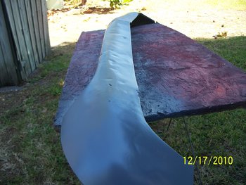

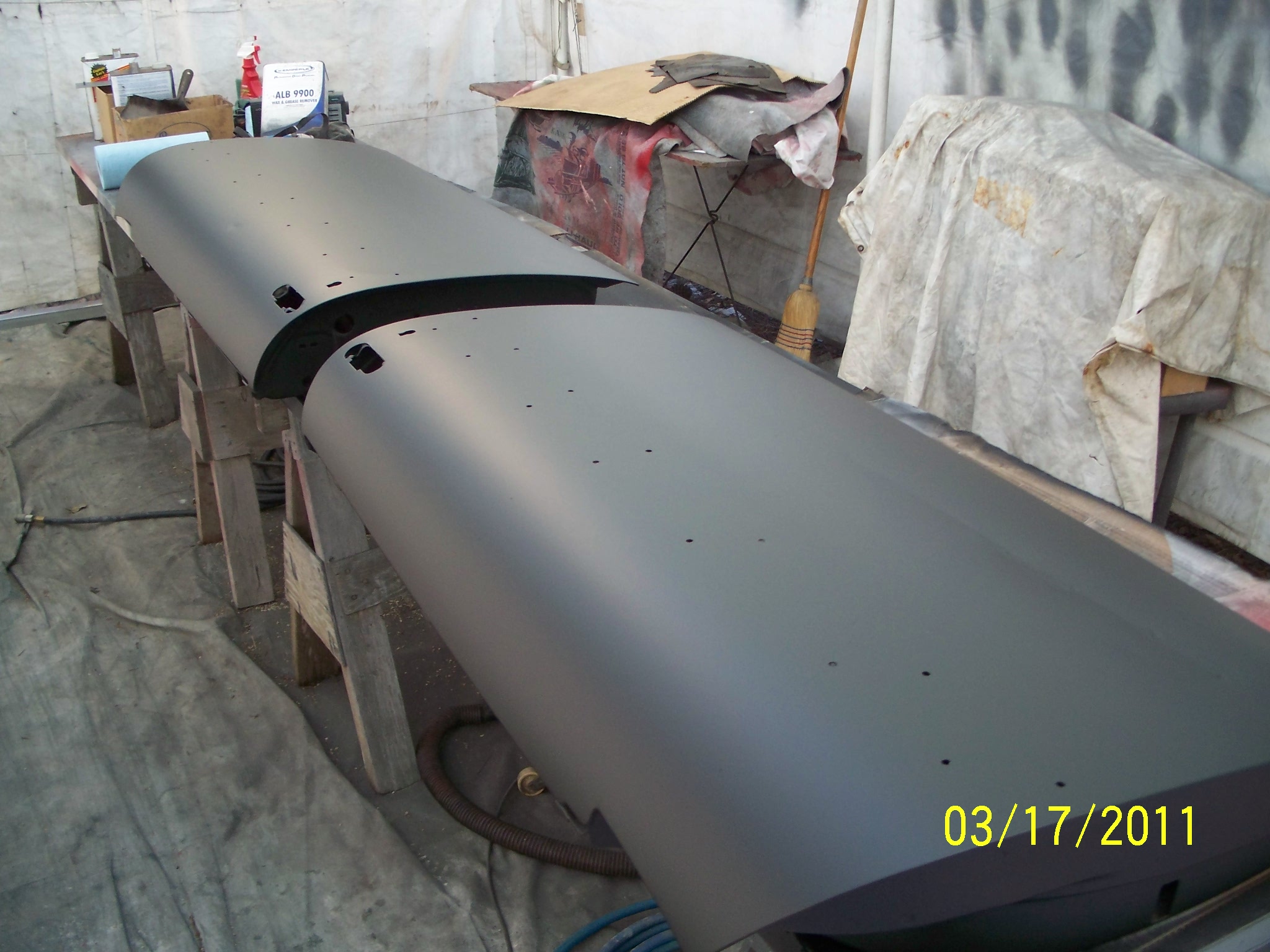

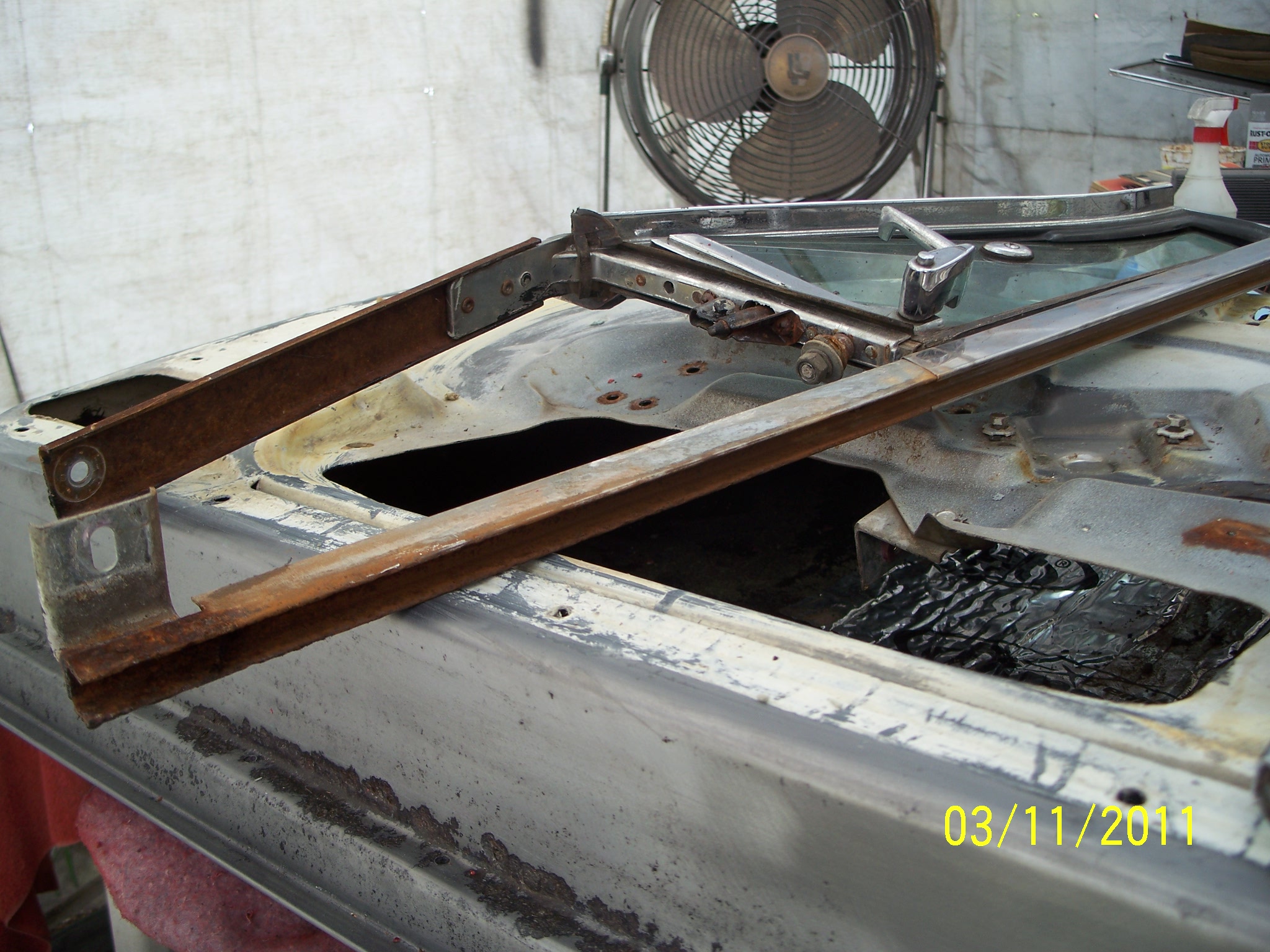

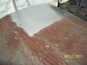

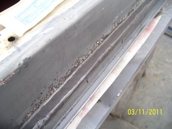

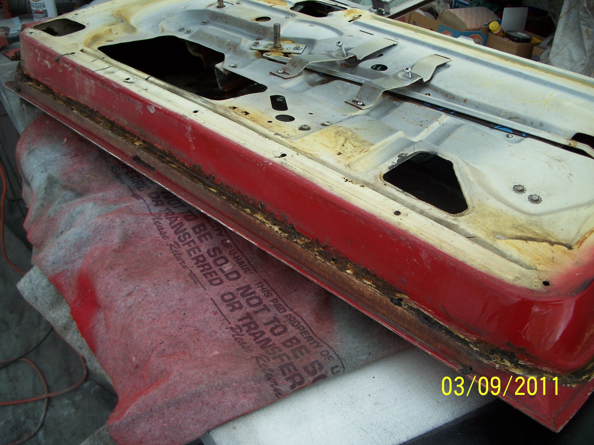

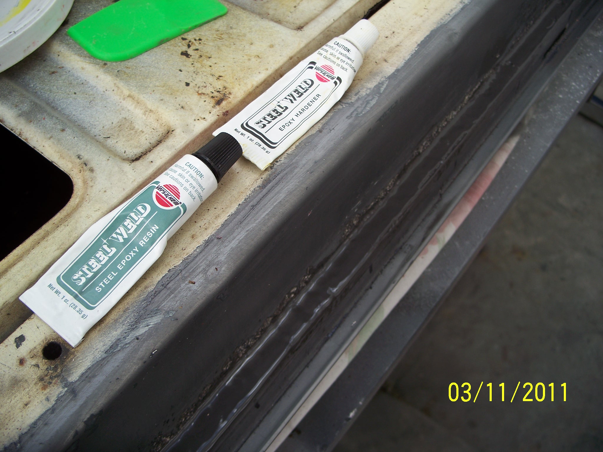

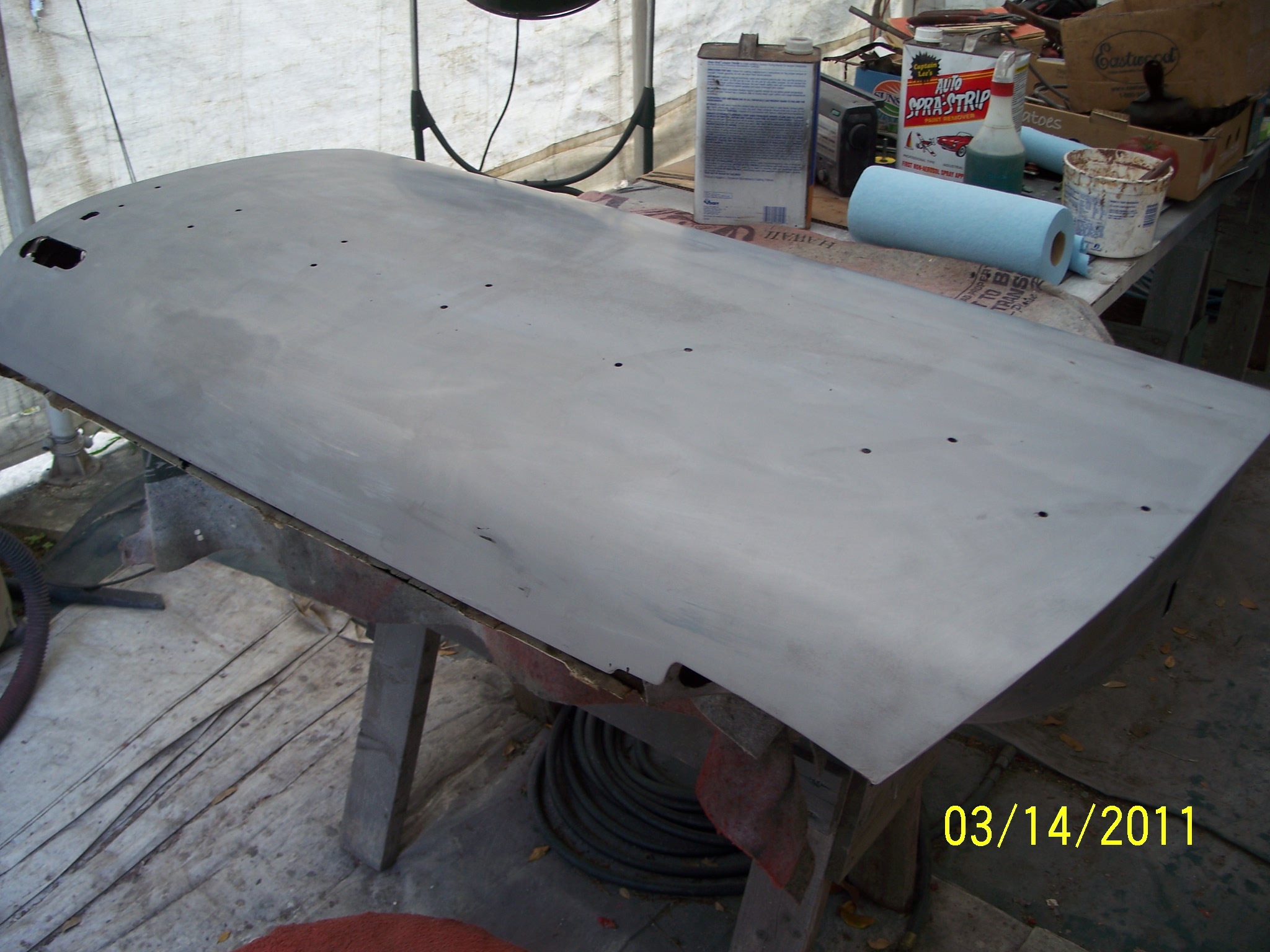

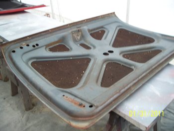

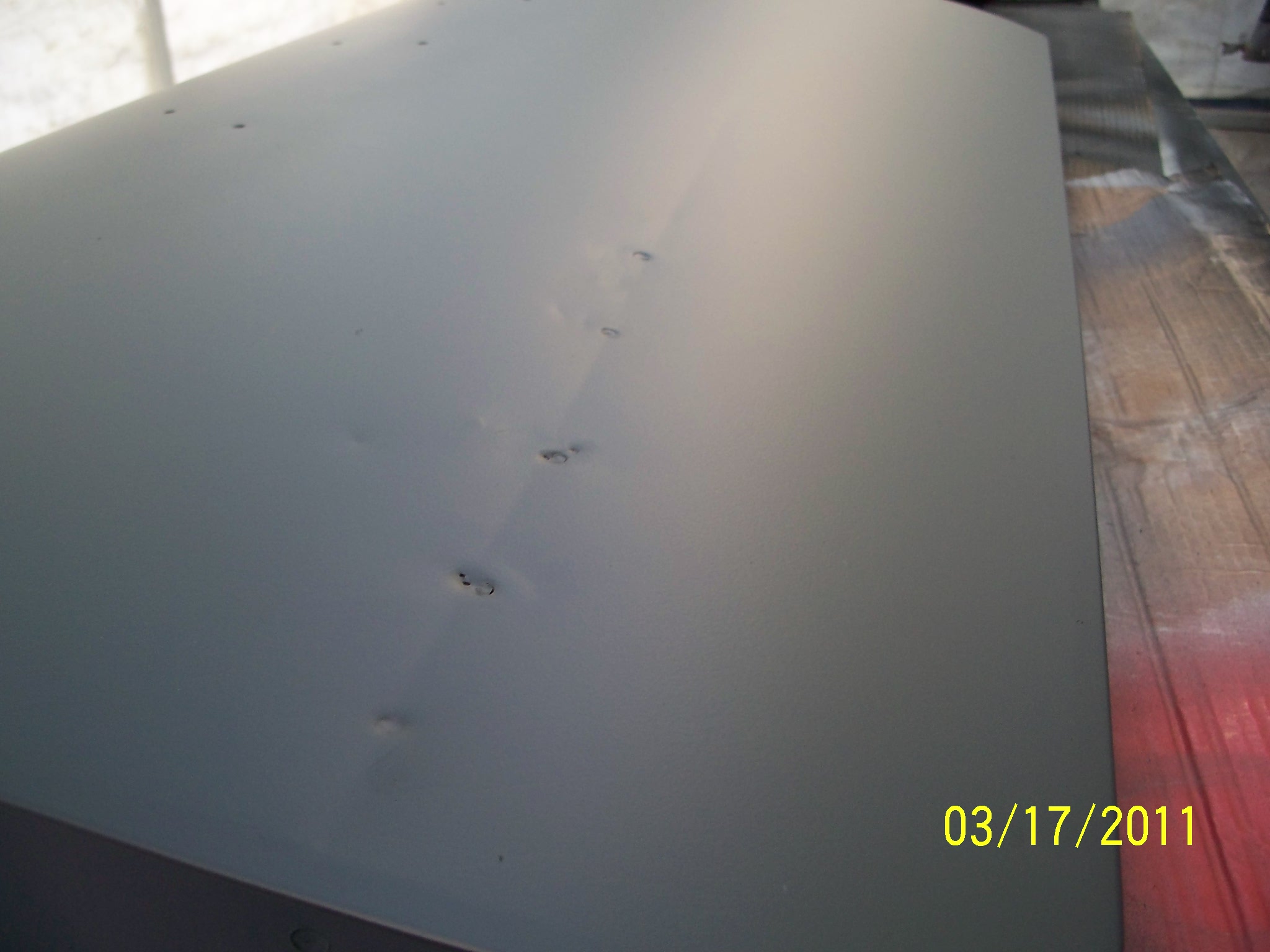

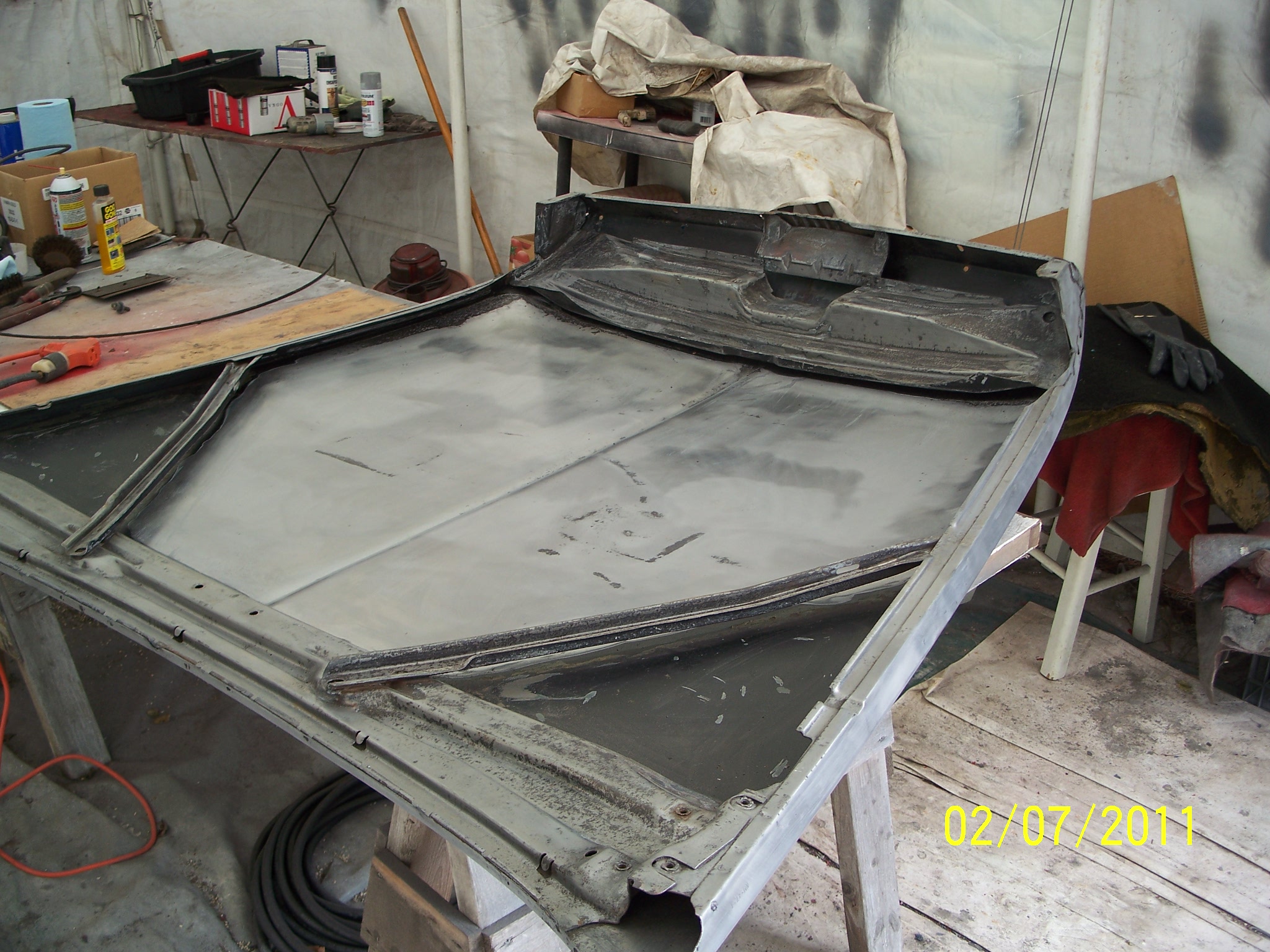

Wow, it's hard to believe my last post here was Dec. 1, 2010. Been busy I guess what with Christmas, New years, Winter "ahem" car shows, Belvie Convertible, etc, etc. So, to Continue with mo pitchuhs. None of it's easy, but I got to tell you, the doors will drive you crazy. Apparently the car took a pretty good lick on the passanger side (sideswipe) starting mid door back to wheel well. Lots of Bondo. After I removed the door gasket there was a lot of rust holes underneath it. I filled and smoothed the area with Versa Chem Steel Weld Epoxy (JB Weld). It laid out beautifully and sealed the area very well. That's why it pays to go all the way to bare metal. Osphoed everything, then appled first coat primer (Eastwood Encapsulator) will block then apply Epoxy Primer, then plastic bodyfiller, block, plastic bodyfiller, 2K primer, block, plastic bodyfiller, 2K primer, Whew!! I'm exhausted. John Q. I was rooting in my stash and found the proper glass runs for the window and door gaskets that I had ordered from Andy Birnbaum way back. After all the sanding and blocking I will fit the doors and fenders by drilling reference holes then take them off and apply paint. Anyway take a look.

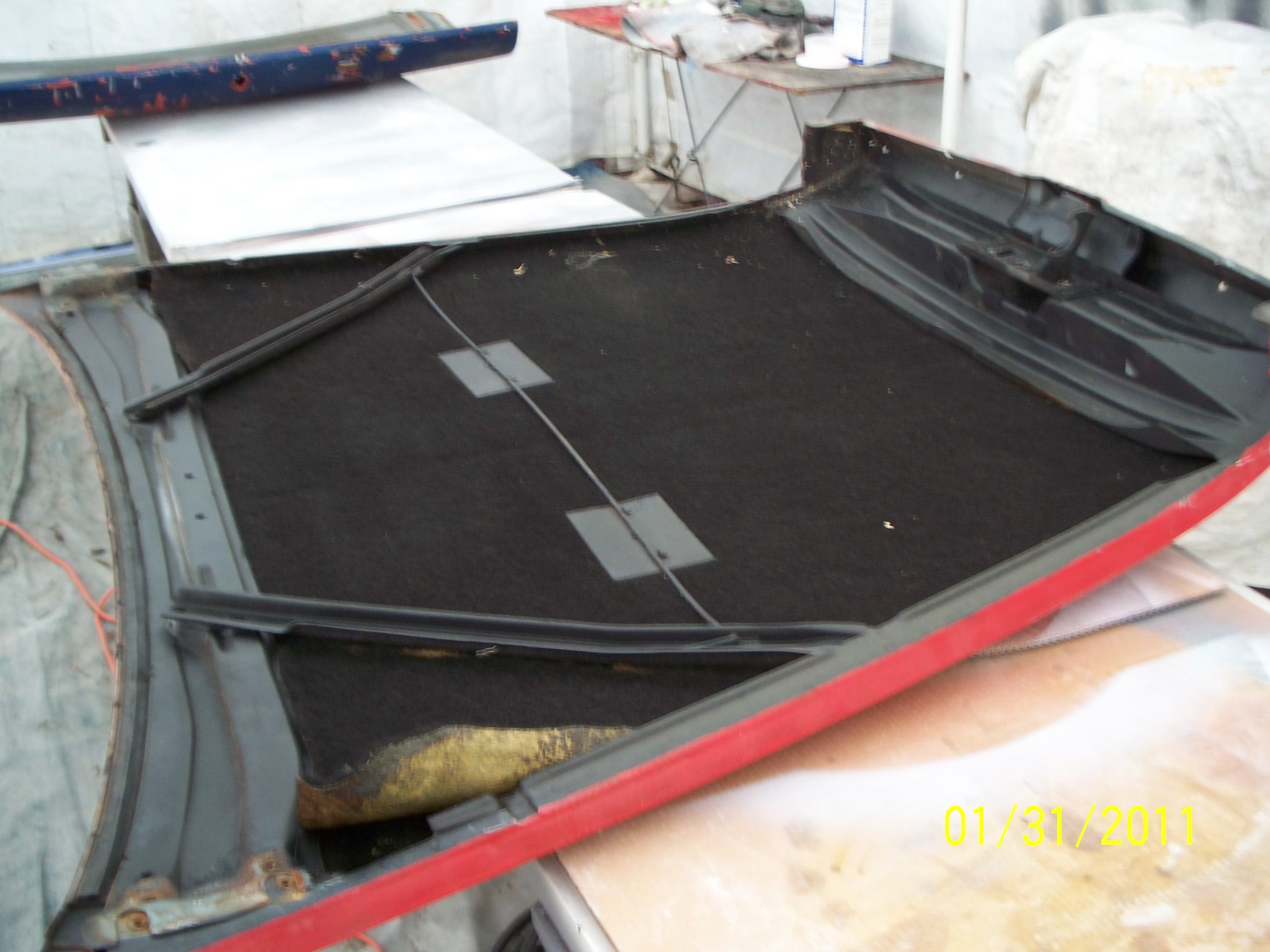

Re: DICK'S 59 RED & WHITE SPORT FURY RESTORATION.
Very Nice Dick, I like the way you did the under hood insulation cut out and around the hood support bow (mine does not have this Bow) very professional!
You are good craftsman on details!
