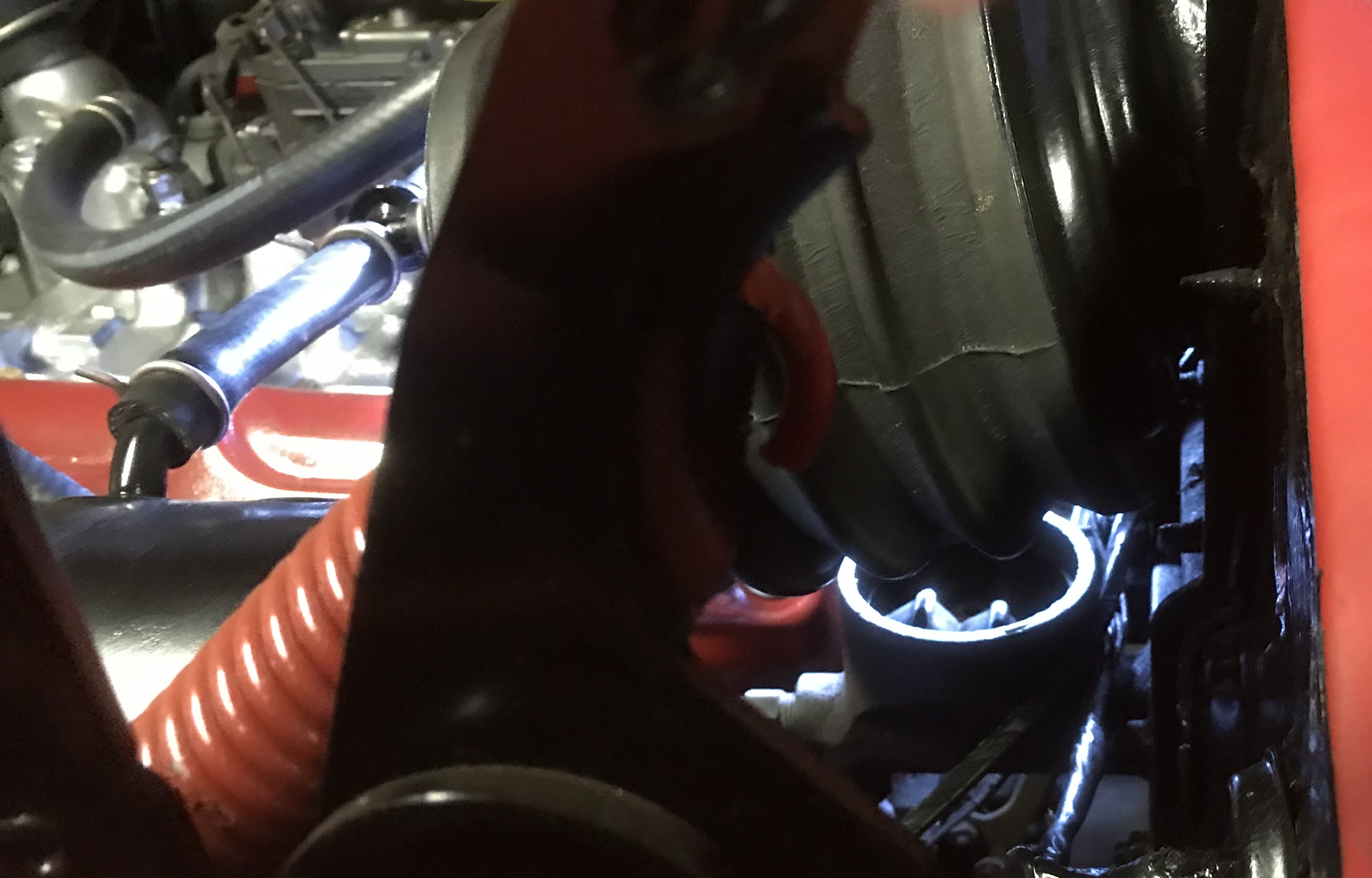

No, don't have power windows. We have those grommets at ACE, the grommets and tubing is to prevent chaffing of the wires. A black thin wall rubber tubing like shrink tubing or split spiral tubing might work.
Re: Faulkner gets a Redo
I have the tubing from Gary. I'm just wondering what keeps them from pulling away from the grommet - my guess is that the grommet goes inside the tube, you snap the grommet into place, and compression keeps it from pulling out. Conjecture on my part, I guess I'll find out when I take it apart.

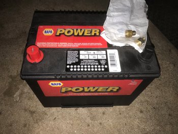

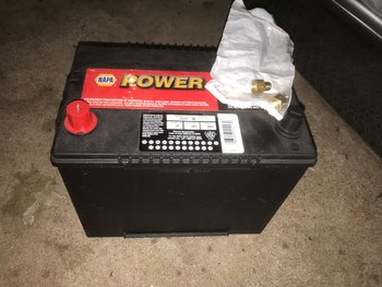

Rushed at the end of the workday to get to NAPA before they close at 6 - and after rummaging around, the guy behind the counter found the exact right brass fitting for the fuel filter. And as luck would have it, NAPA was running a 20% off sale - a perfect time to buy a flat top group 24 battery! Better yet - the fitting was free, he couldn't find the SKU in the computer.
Just waiting on the fuel pump now.

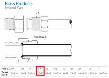

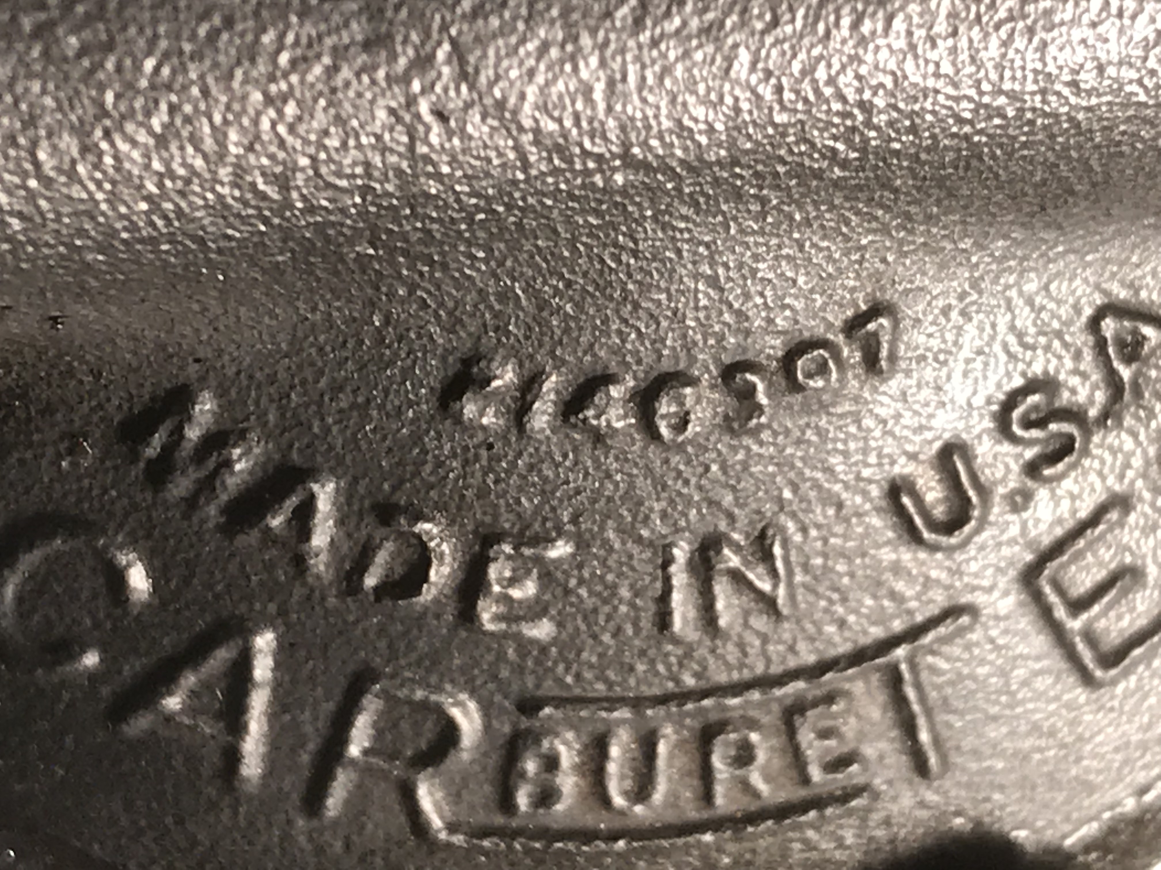

My fuel system woes continued today. The new fuel pump arrived - that bolted on easy enough - and I used yellow teflon tape on all pipe threads (i.e., not flare fittings), on the pump and on the glass bowl filter. I put the new fitting on the output side of the filter, snugged down the fuel line, and gave it a crank. Doncha know Faulkner fired right up! And gasoline was everywhere...
I wiped everything down, and removed the steel line between the filter and the carb. You know, those steel flares look clean as a whistle, I don't get it. So I backed out the brass fitting I just bought at NAPA, and gave it a closer inspection...
Damn! It's for an SAE 45 fitting, there's no seat for the flare!
I'm hoping it's just this fitting that's giving me grief now. I want to keep the glass bowl filter, but I don't know if that rubber grommet is still good and contributing to the leak. (Hard to tell with gas spraying everywhere.) I got new parts for it 14 years ago, from Claude at Fuel Pumps A2Z. They used to have a website back then, but it's now defunct. There's this Facebook page with a phone number, maybe I'll call them tomorrow and see if they're still in business. I can make out the P/N for the Carter filter - 2146397 - and there are plenty of used ones on eBay, I would just like to buy new parts for it.
So, I'm on the hunt for the right fitting. The flared tubing is 5/16" OD, the fitting for the flare is 1/2", and the NPT to the filter is 1/4". I doubt Lowes has it, but I'll check in the morning.

Dan for info only. The yellow Teflon tape you are using is for gas, as in household, not for gasoline! Ace has a compound for threads on gasoline fittings, our ace has reverse flare fittings, but a small selection. My source is NAPA.

Dick, yeah - the use of yellow teflon tape is hotly debated on the H.A.M.B. boards, where some guys say they use it with great success, and others say avoid like the plague. I've never had a problem, but there's always a first time.
The interesting thing I've just read is that the tape isn't intended to seal - it's intended to lubricate the threads so that they turn deeper. Teflon paste actually does seal (and this is what I used on the transmission kick-down adjustment, you may recall), so I guess I'll take things apart and use the paste instead.

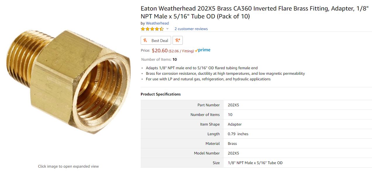

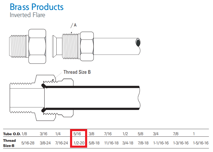

I spent the morning running around - NAPA, Ace, Lowe's, and a specialty plumbing store. No one could match up the fitting I need.
But Google to the rescue, and - I guess - Amazon. It comes in a package of ten, but I've already spent 20 bucks on gas, what the hell.
Kiddies are coming, life is short, and I'm wasting time. I'm gonna pull the trigger on this.

I couldn't find Mary Kay's nail polish, and I'm fresh out of my own , so I went with Permatex hi-temp thread sealant instead for the fuel line. I redid the fittings between the filter and the pump, and the filter to the carb - maybe tomorrow, I'll crawl under the car and redo the input to the pump.

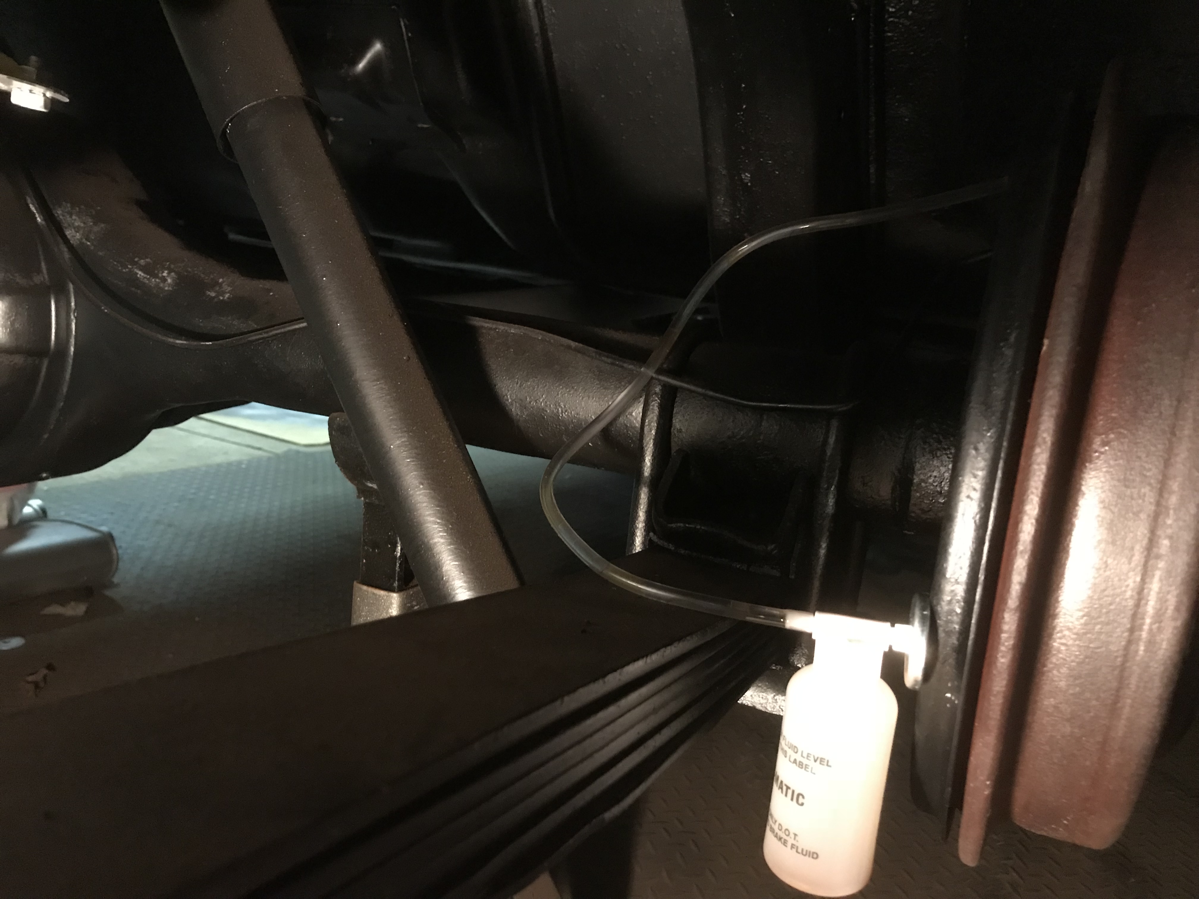

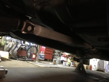

Also got the driveshaft back in, and bled the brakes. For a couple bucks I picked up a syringe on Amazon, it made short work of filling the master brake cylinder so @#$@&#!! close to the bellows. Thank goodness the bend in the brake tubing on the axle housing kept air from propagating elsewhere - it didn't take many pumps of the pedal to clear all bubbles from the fluid coming out. For sure, the brakes will be good enough to back it out of the driveway.

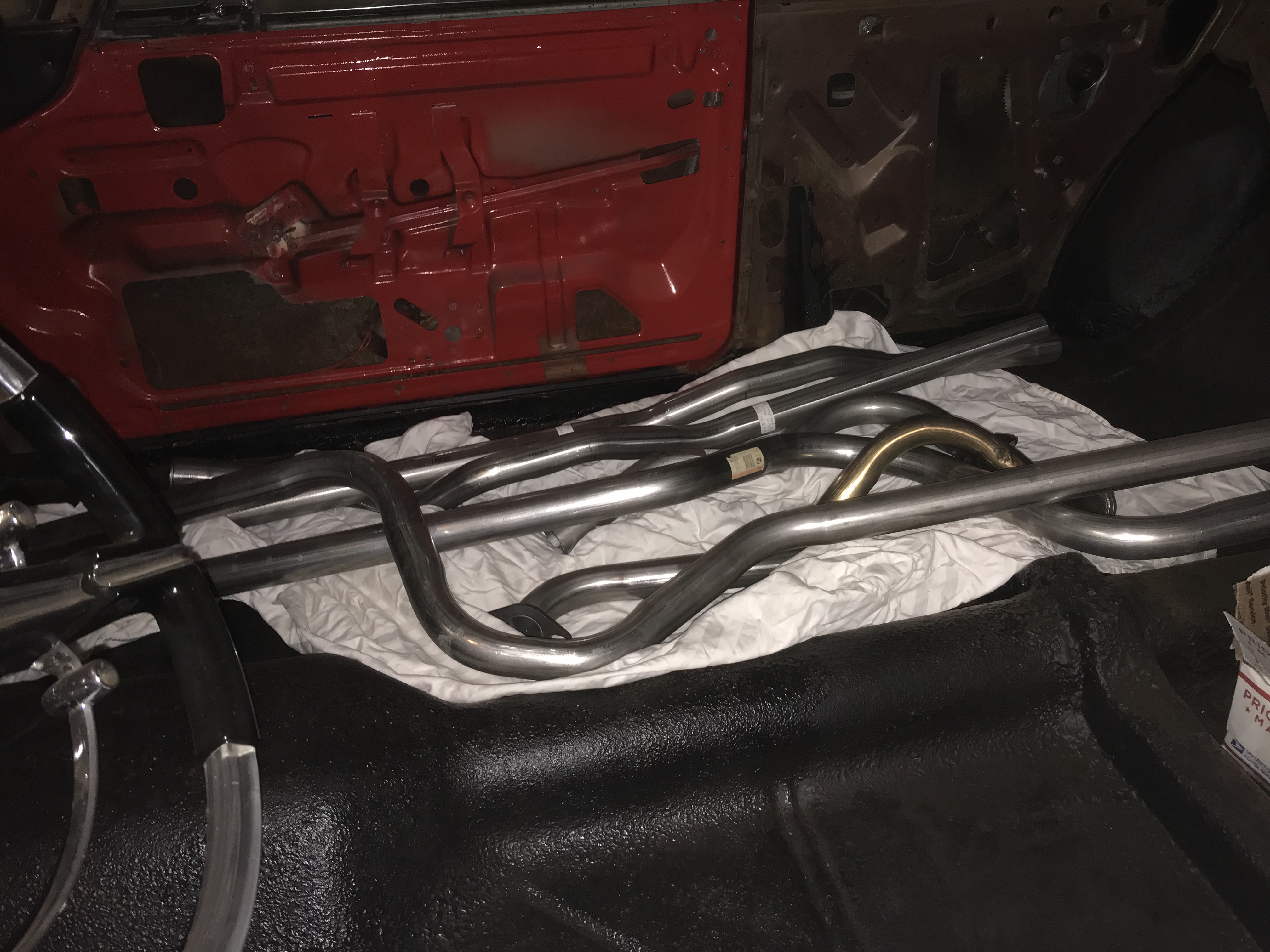

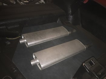

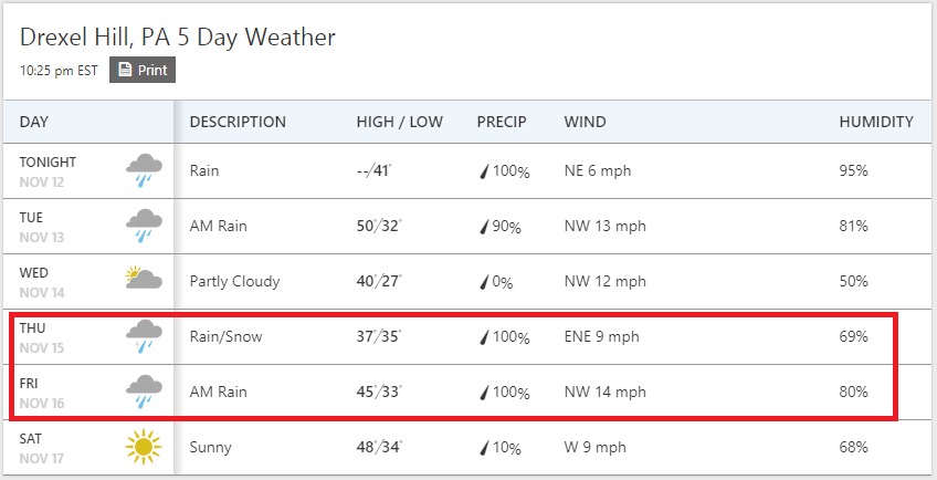

Drexel Automotive thinks they can do the brakes and the exhaust in a day, since I have all the parts (except for the aluminized lead pipes, which they will make up). Thursday evening, the flatbed comes - I'll have Faulkner in the street, he'll spend the evening inside the shop for work on Friday. I'll try to get pix, if they let me in the garage. I only got two tires on before I called it a day, after work this week I'll get it back on the ground and back it out of the garage to test the brakes.

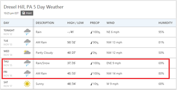

Oh Noes! I guess I'll be postponing Faulkner's trip to the shop Thursday night.
I'll call tomorrow, to see if they can accommodate on Tuesday (for a Monday night flatbed)...
