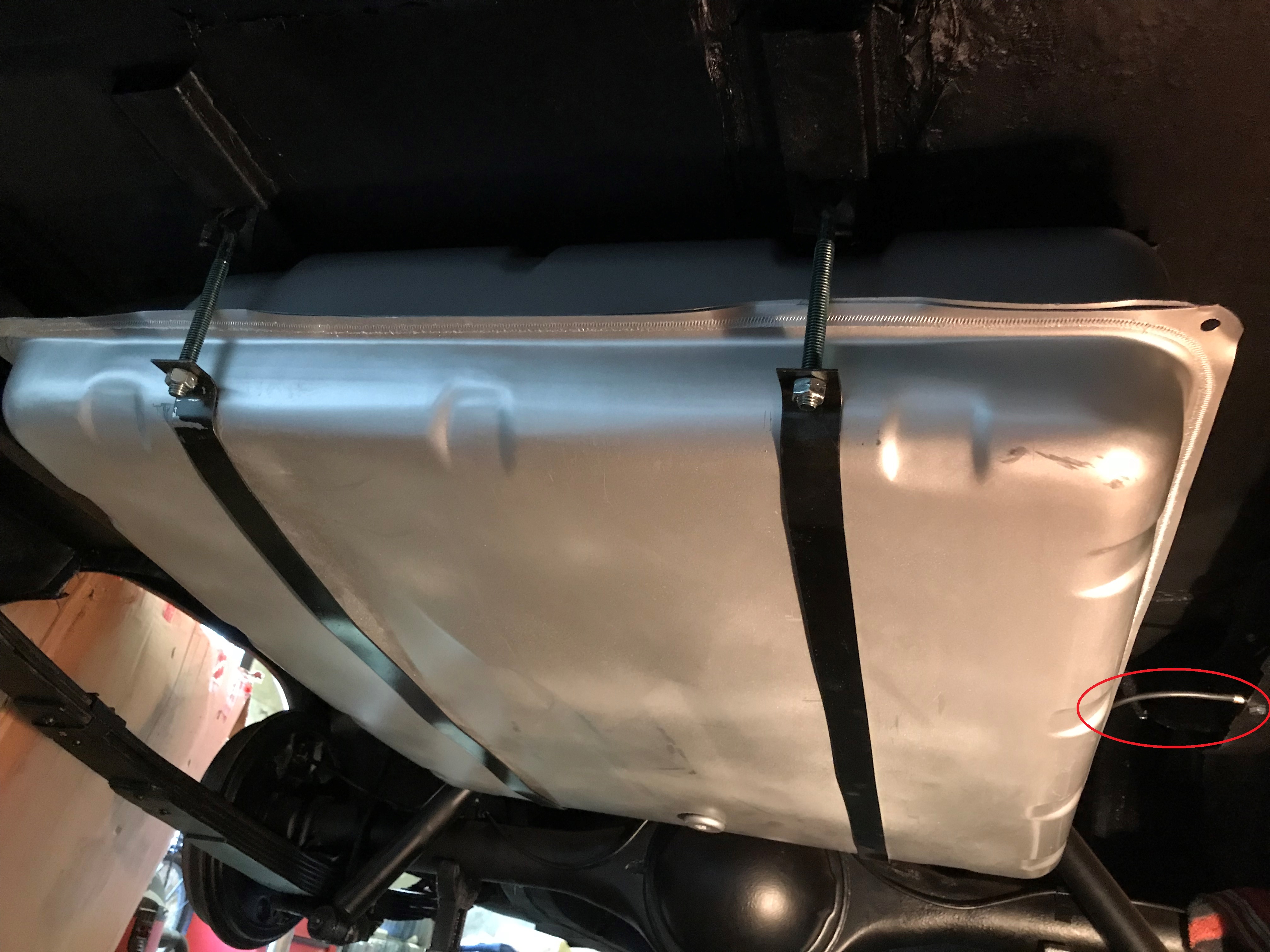

I think I'm going to go ahead and order those long J-bolts from Vans, on the likely prospect that your straps are not for a (rare) 23 gallon tank.

Nope - Mine measure the same as yours. All you need is a coupling nut and a short piece of threaded rod. At my ACE we have coupling nuts up to 3/4" and threaded rod 3" and 6" long or longer.

Thanks Dick! I think if I were going to use a coupling nut, I would just use a bolt at the right length rather than all thread and a nut. But I ordered the longer J-bolts before I saw your reply, so let's see how I make out with those.

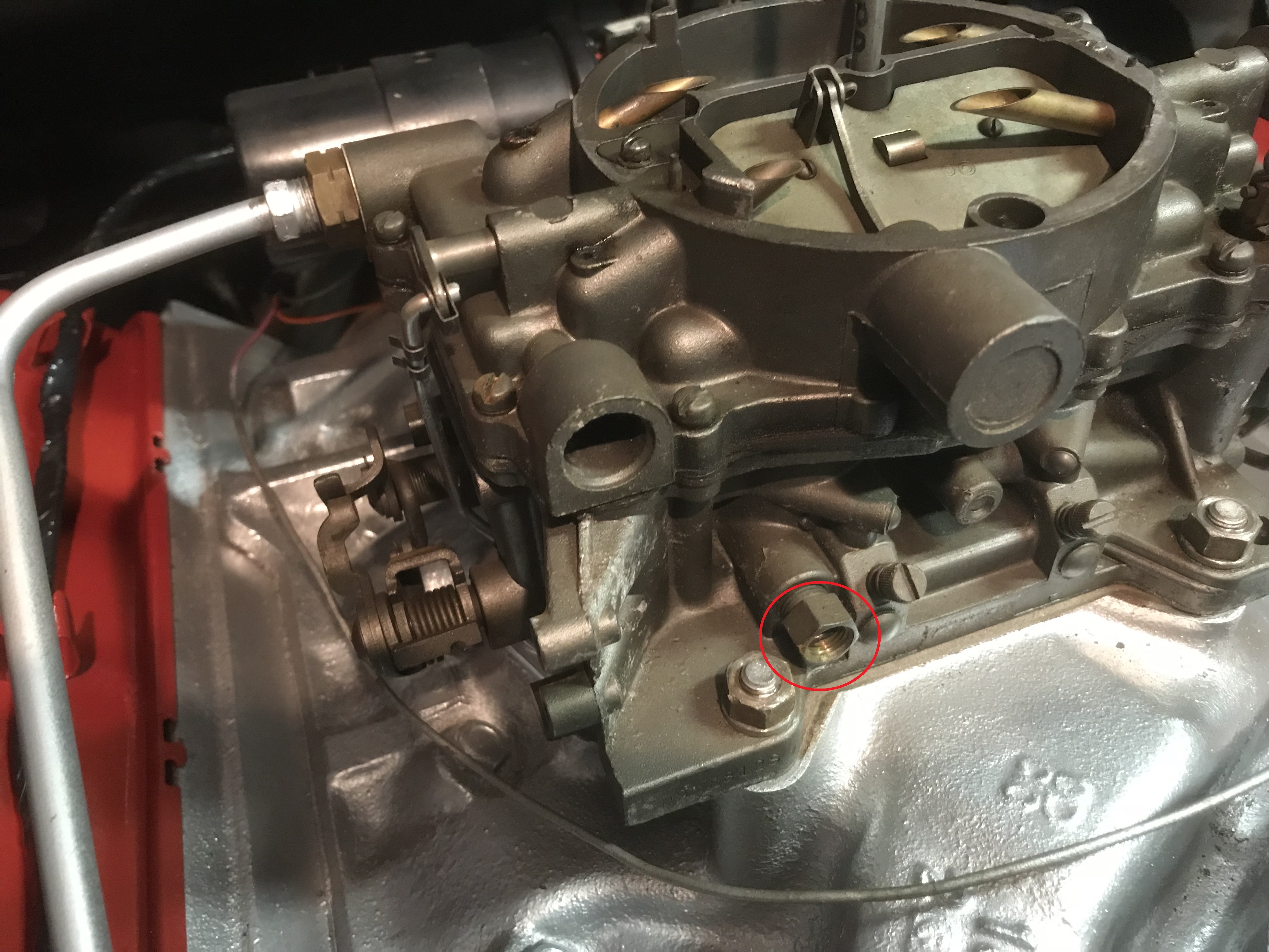

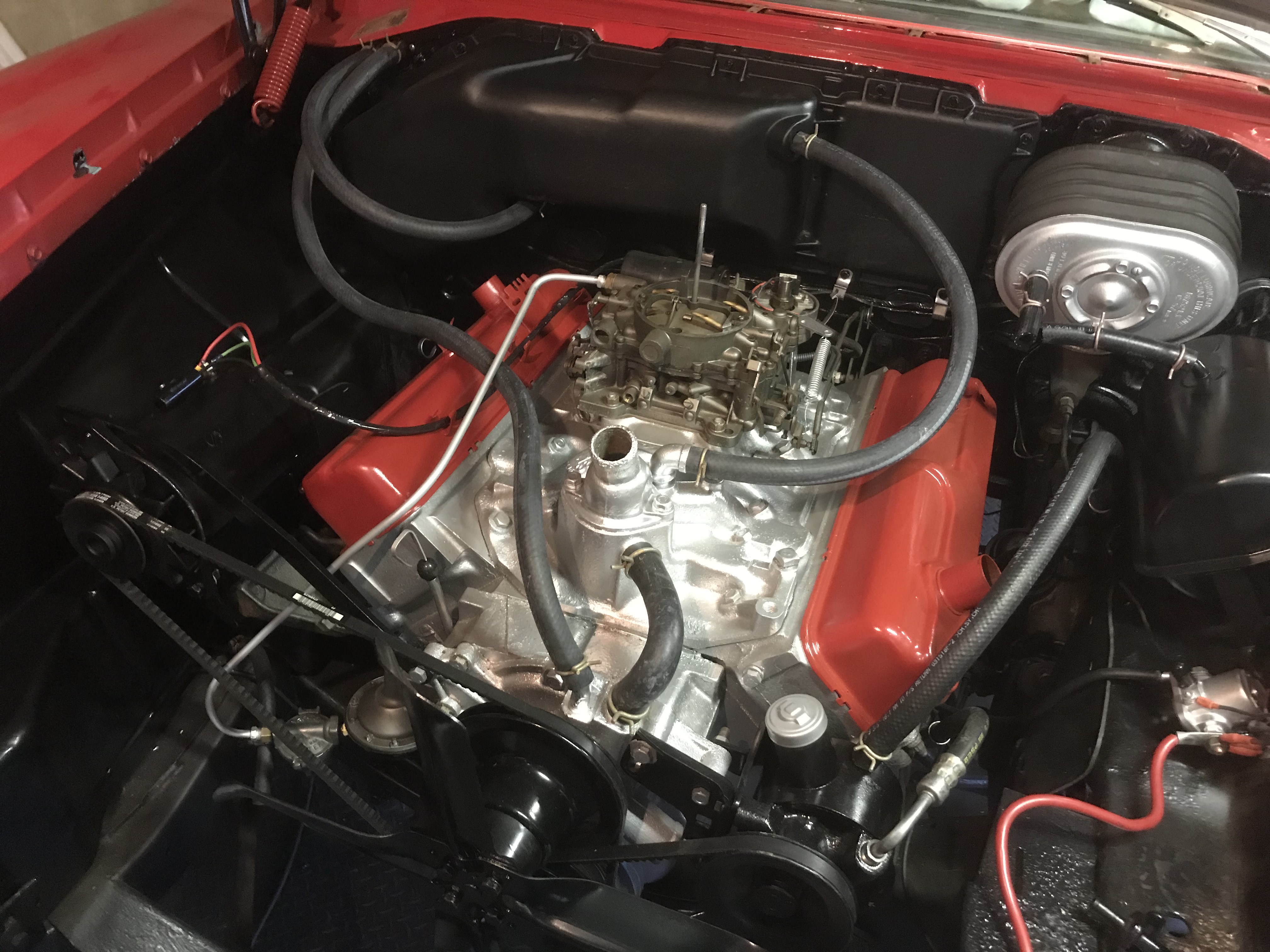

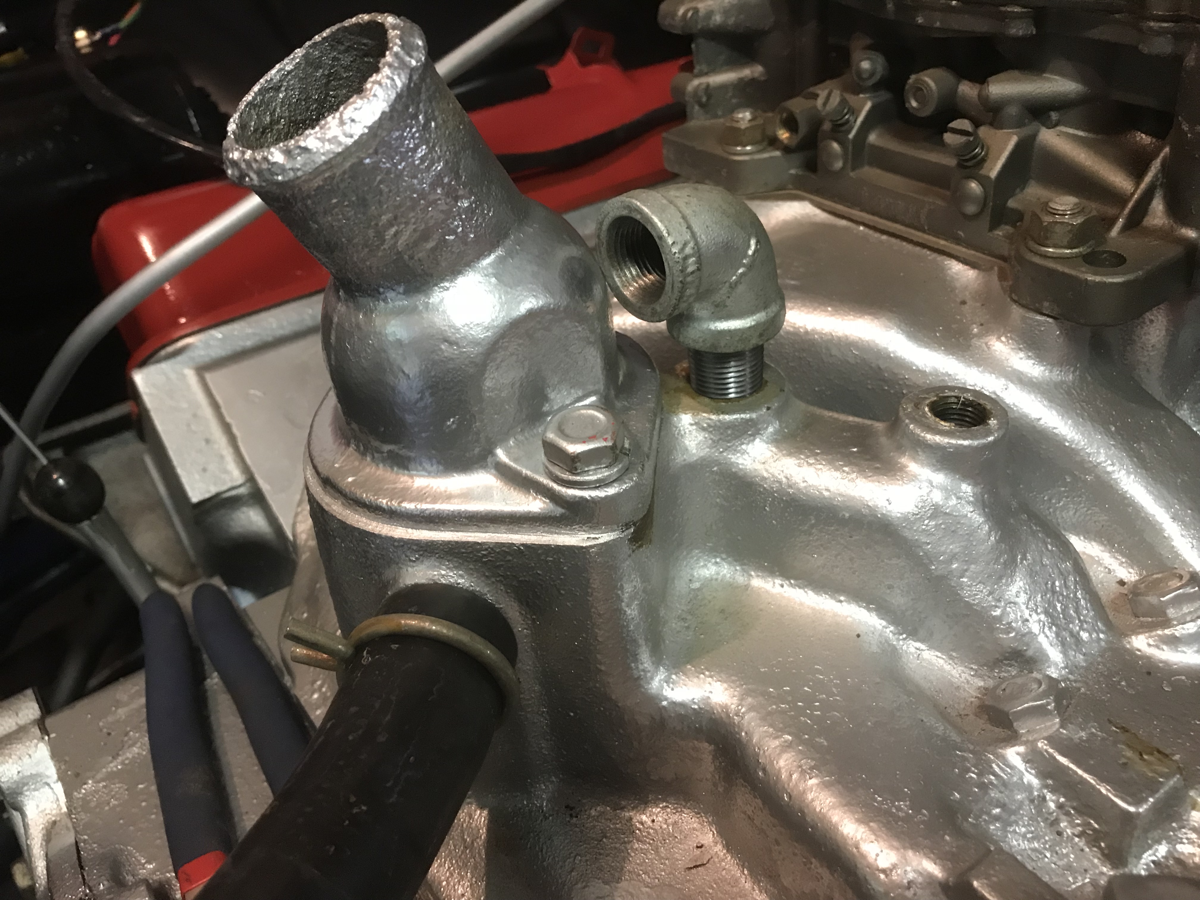

There's a chance the J-bolts will arrive tomorrow. Meanwhile, some more tinkering in the engine compartment...

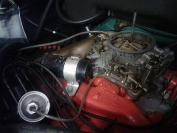

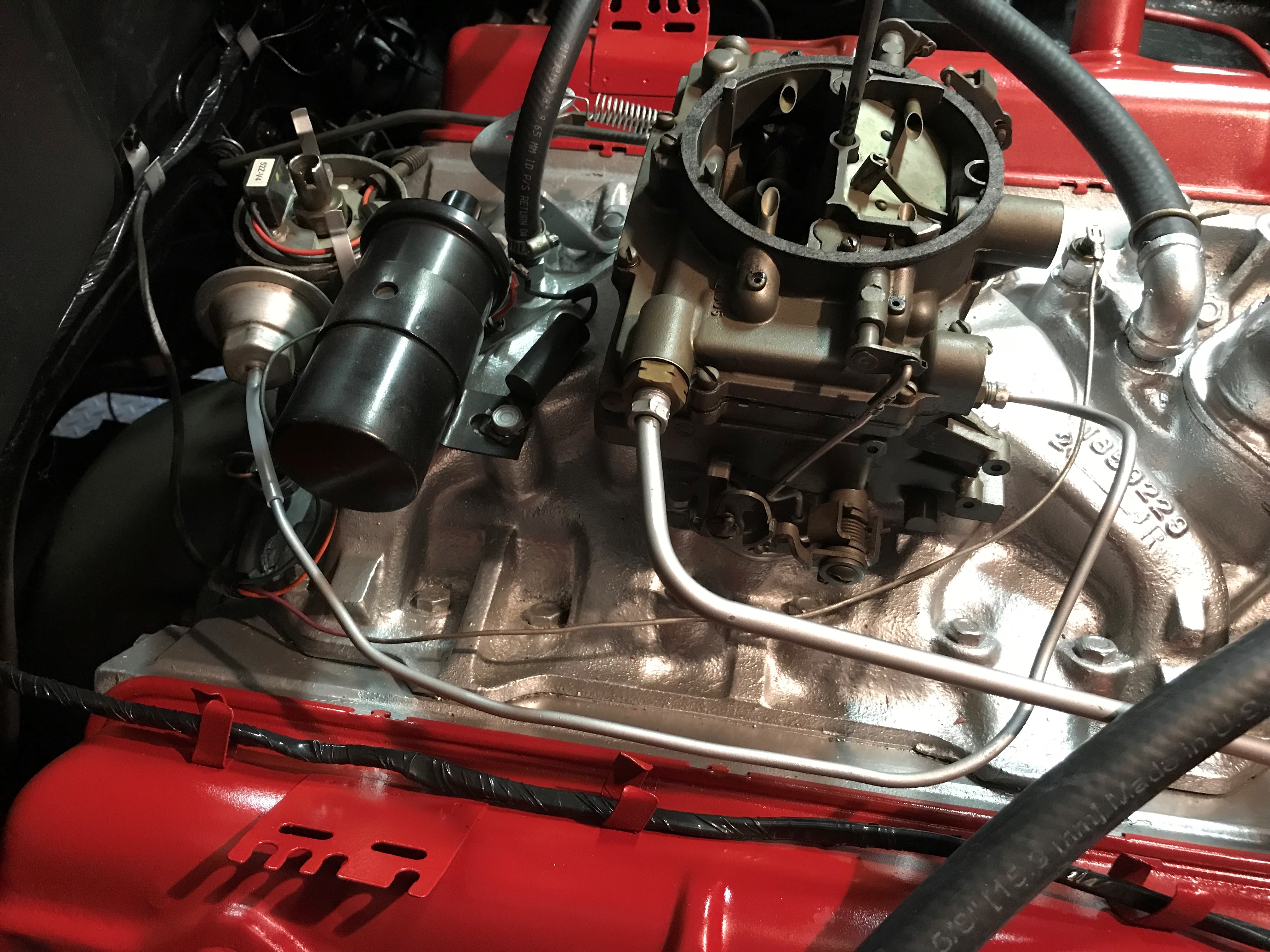

Oh yeah! What's this fitting for in the last pic? I seem to recall it from before, and wondering what - if anything - goes there. Is it for servicing? I don't think I had anything connected to it.

(*Tap*, *Tap*...) Hey, is this mike on?!?
What's this fitting for?
Re: Faulkner gets a Redo

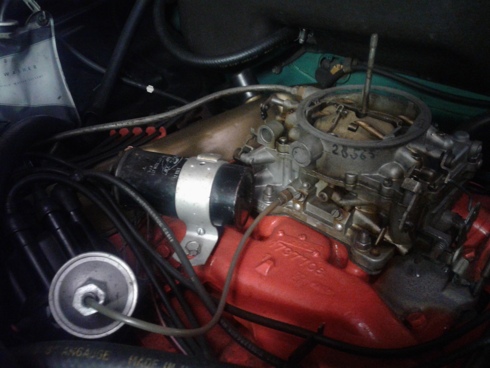

It's the vacuum connection to the vacuum advance on the carburetor. This picture is from the 2 bbl. On the convert.
This is a picture of Greenies 361 four barell carburetor, it's the vacuum connection to the vacuum advance.
D'Oh! But of course. I have to hunt around in my stash of parts for that male fitting, and replace the rubber tubing. Here I was thinking this doodad - a thin little tube off of the rear vacuum line for the power brakes- was where the vac advance had been plugged into. But now I realize, that's for the dashboard heater control switch. I'll have to put a cap on that until I'm ready to redo the heater controls.

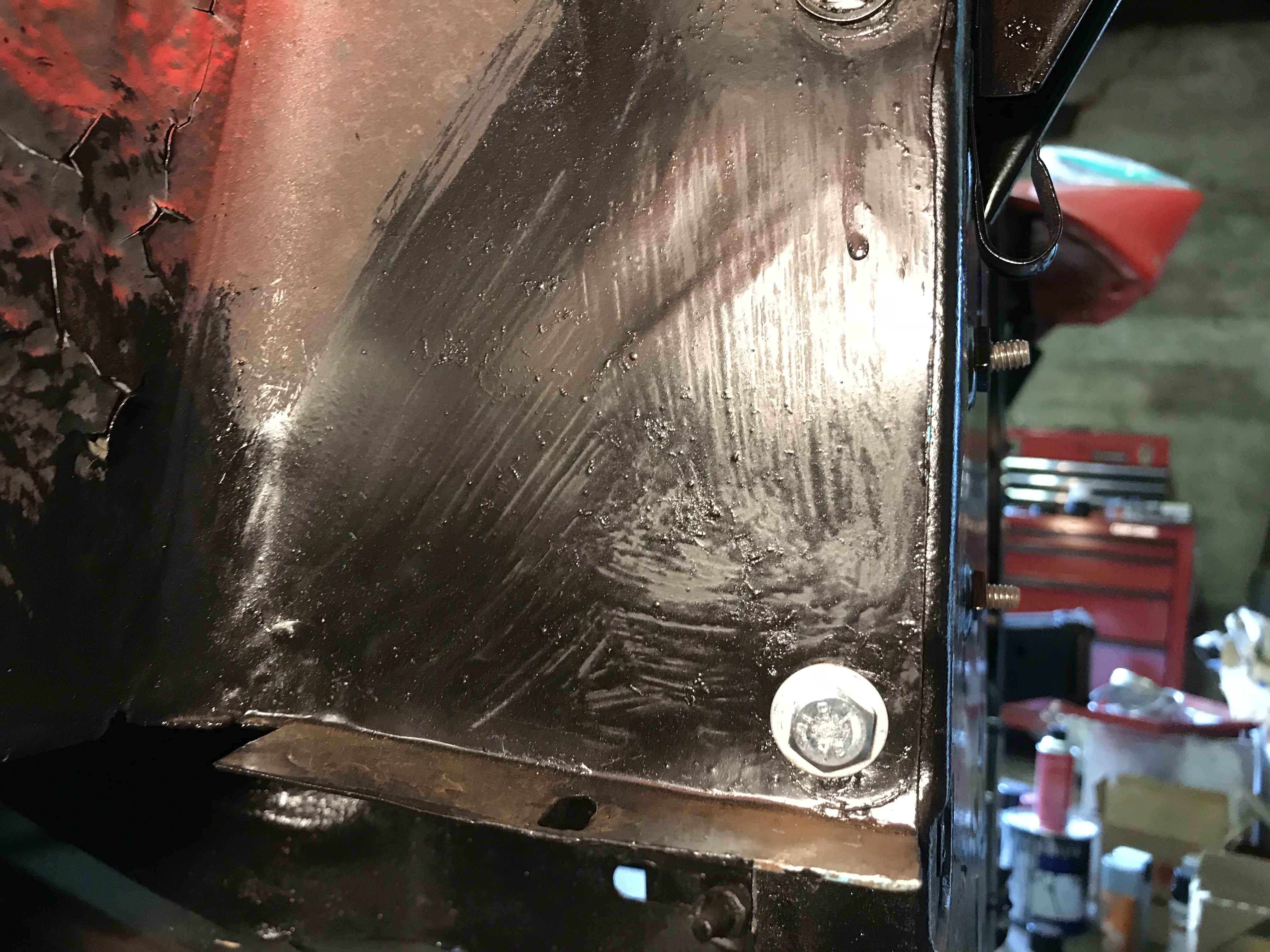

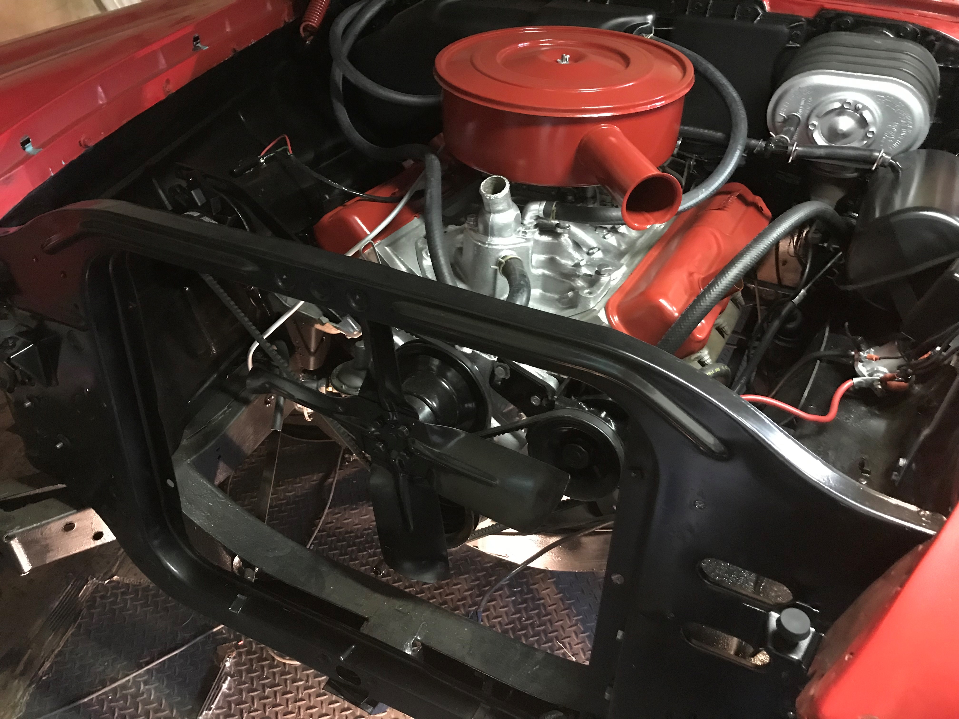

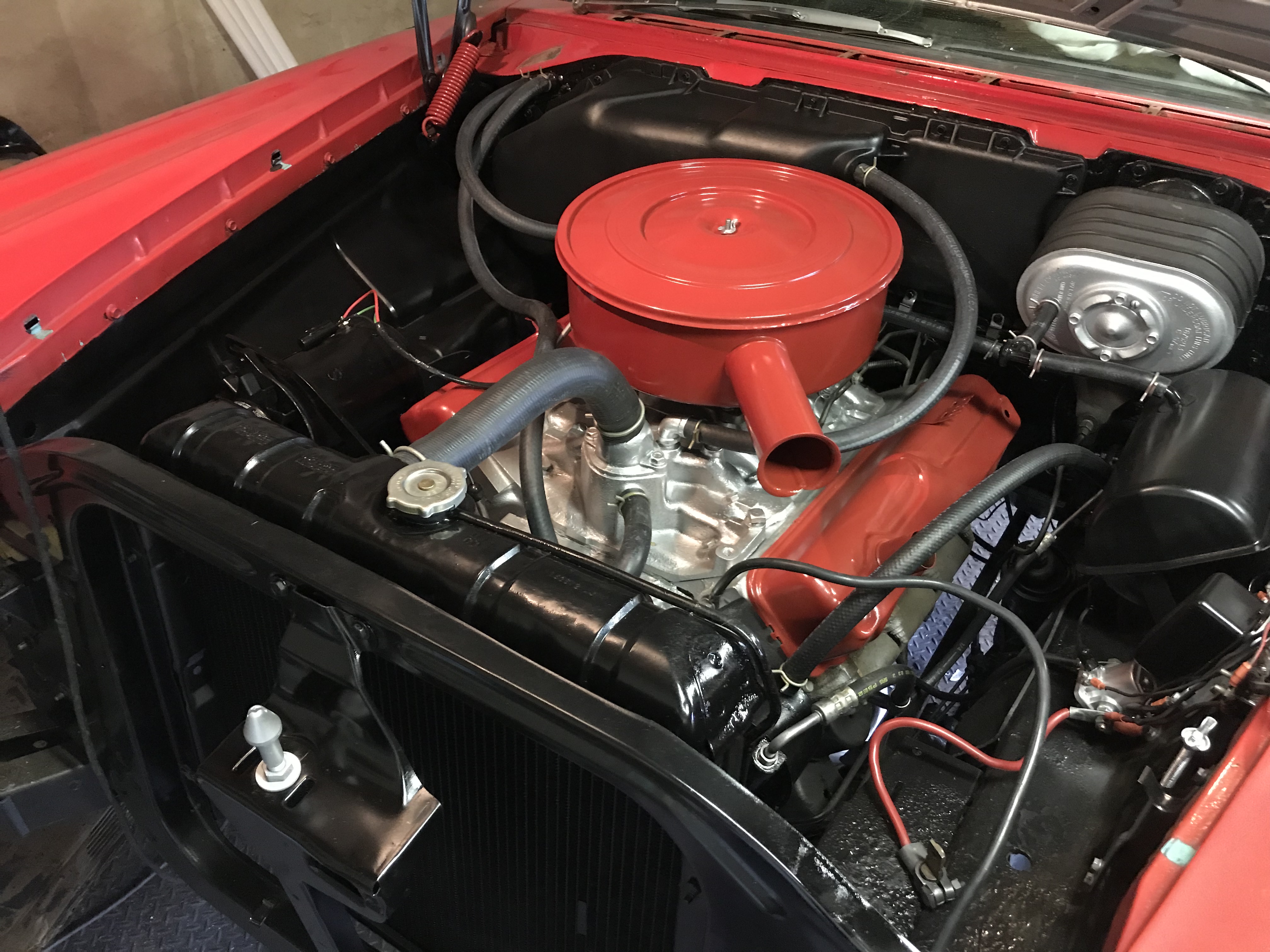

I never got to hang the radiator today, but I did finish the power brake hoses and install the radiator core. In the process, I also managed to snap a bolt It's in an inconspicuous spot, and wouldn't be noticed - but it's bothering me now. I guess I'll drill it out... (*sigh*.) Nibbles of the elephant.

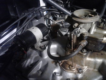

I would suggest that instead of rubber hose you use the white poly tubing, thats what is on Greenin and zero chance of collapsing. Can be sourced at ACE.

The J-bolts arrived from Vans, and they are quite longer! Now to reshape the straps, and bolt the tank in.

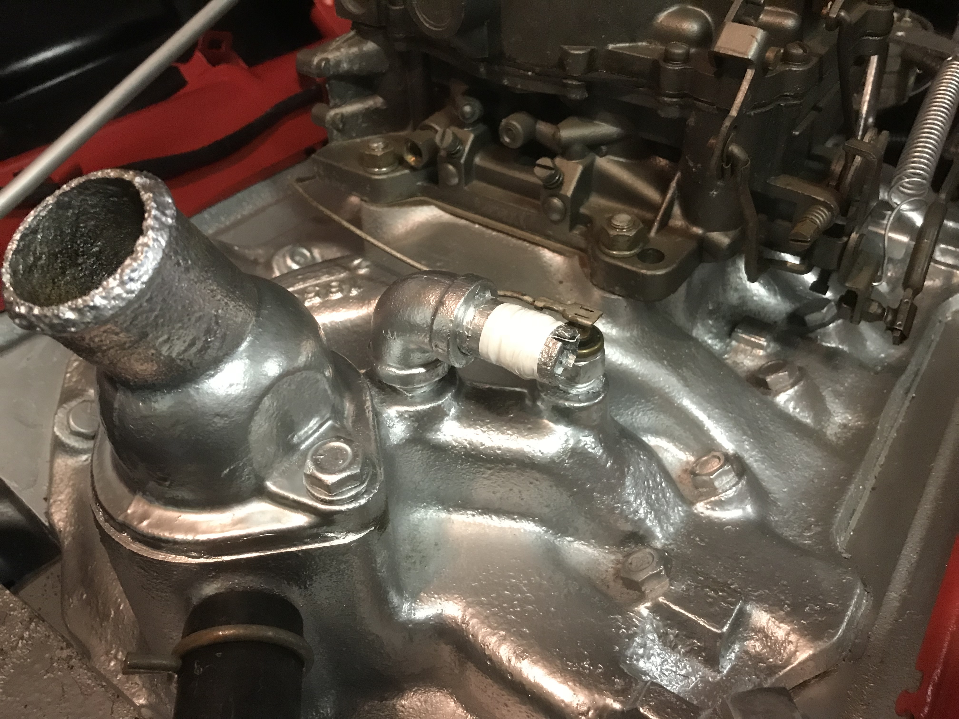

I did find the vacuum fitting for the carb - and it was attached to the metal vacuum tube! I bought some of that white poly tubing to make up the connection to the vacuum advance - I recall it being black, but I think I tossed it because it was dry-rotted.

...and the tank is in! Those extra long J-bolts were what I needed.
