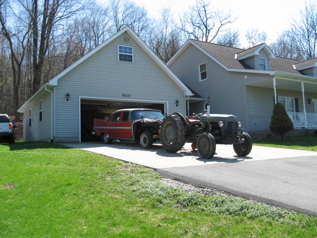

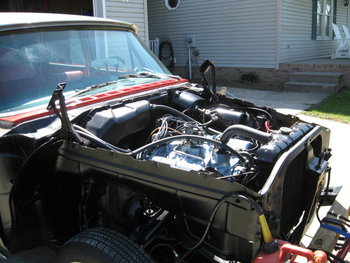

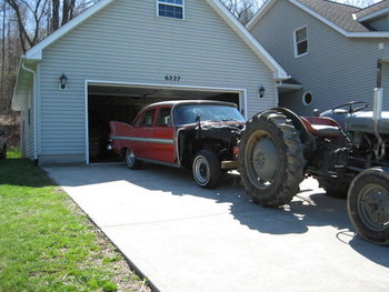

Guys; Allright where was I,oh yea the plymouth.Well she is A L I V E !!!!!!!!!! And well I might add.I wheeled her outside and ran it for some break in.The fellow I had rebuild the motor said run it about 1500-2000 rpm 20 to 30 minutes to break in the flat tappets,I am running Brad Penn SAE 30 "break in oil" high in zinc phosphorus.Oil pressure was steady at 50 lbs the motor was running surprisingly cool (normal) for A first run,they usually run a little on the hot side at first although the 160 thermostat I put in probably helps.Posted A few pics check it out bye for now Mark M
Re: Marks winter of "59"
Photos show a beautiful day, and the positive report makes for an ideal closing
to this particular chapter of "Mark's Winter of 59".
Mark - I envy you, You are close to taking a ride in your beautiful car. A long wait for me! Would you share what paint you used for the engine and are the valve covers the same.
