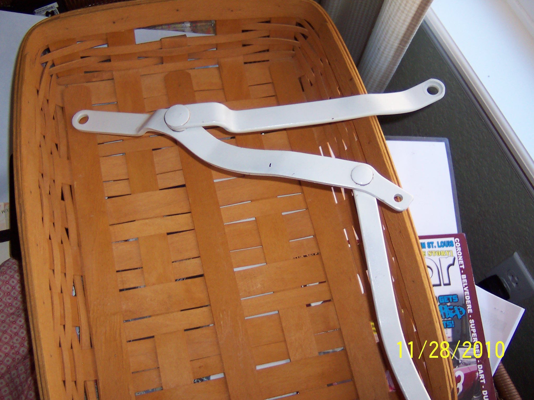

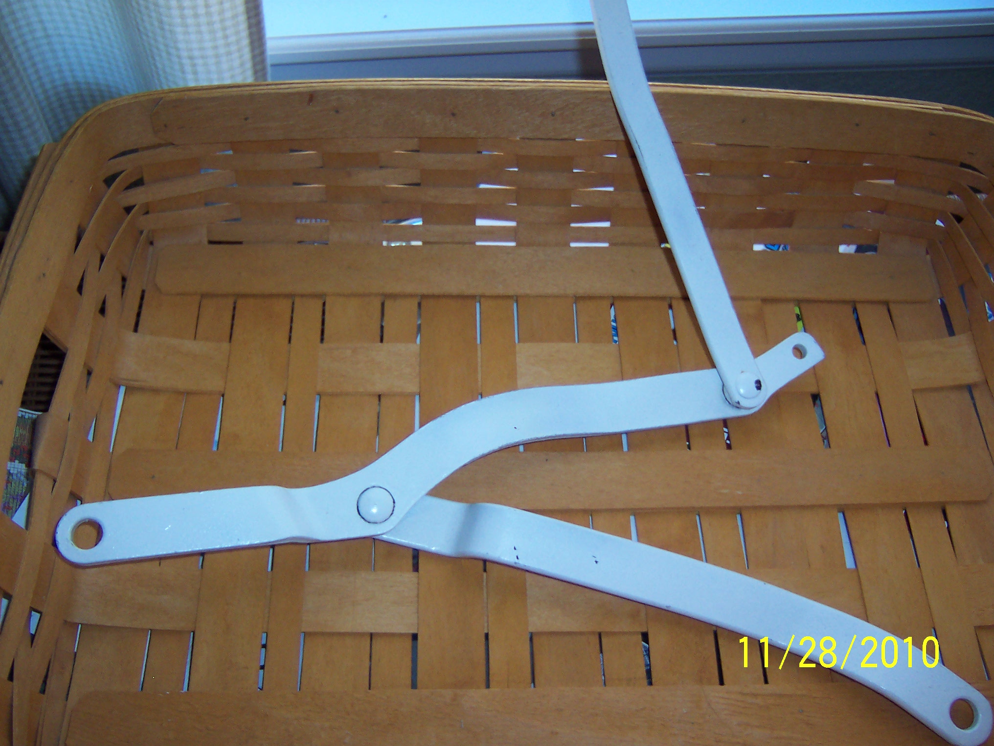

Do you think they are in need of this multiple linkage unit..Part # 1866519, identified as Linkage 23-58-269, on p. 23BH-4 in the 59 Parts Book-
It will probably be quicker to have the part fabricated.

Roger, i just got out of the garage with the parts book and that is indeed what i need.

Here are my parts of the joint that failed. Luckily these sections of the top are not aluminum but heavy steel. So the can be welded back together again. The pivot point is a hardened rivet that would have to be drill out or ground off. Another rivet could be reinstalled but you might just want to put a dowel rivet in its place would be quicker and easier. Use teflon washer or a bronze thin washer if you do. Helps on the parts slipping together.
The picture you have that you had a caption that says 'making a weird angle.." is suppose to pivot a little when the top is actuated. It is part of a normal opening and closing function.
I do not have this part as a back up. (there goes my Diet Orange Sunkist) but that can be repaired or a replacement fabed up. Just keep the bends in the correct orientation of you are going to fab a replacement part. Heating of a replacement stock like a Blacksmith is needed to do the bends.
