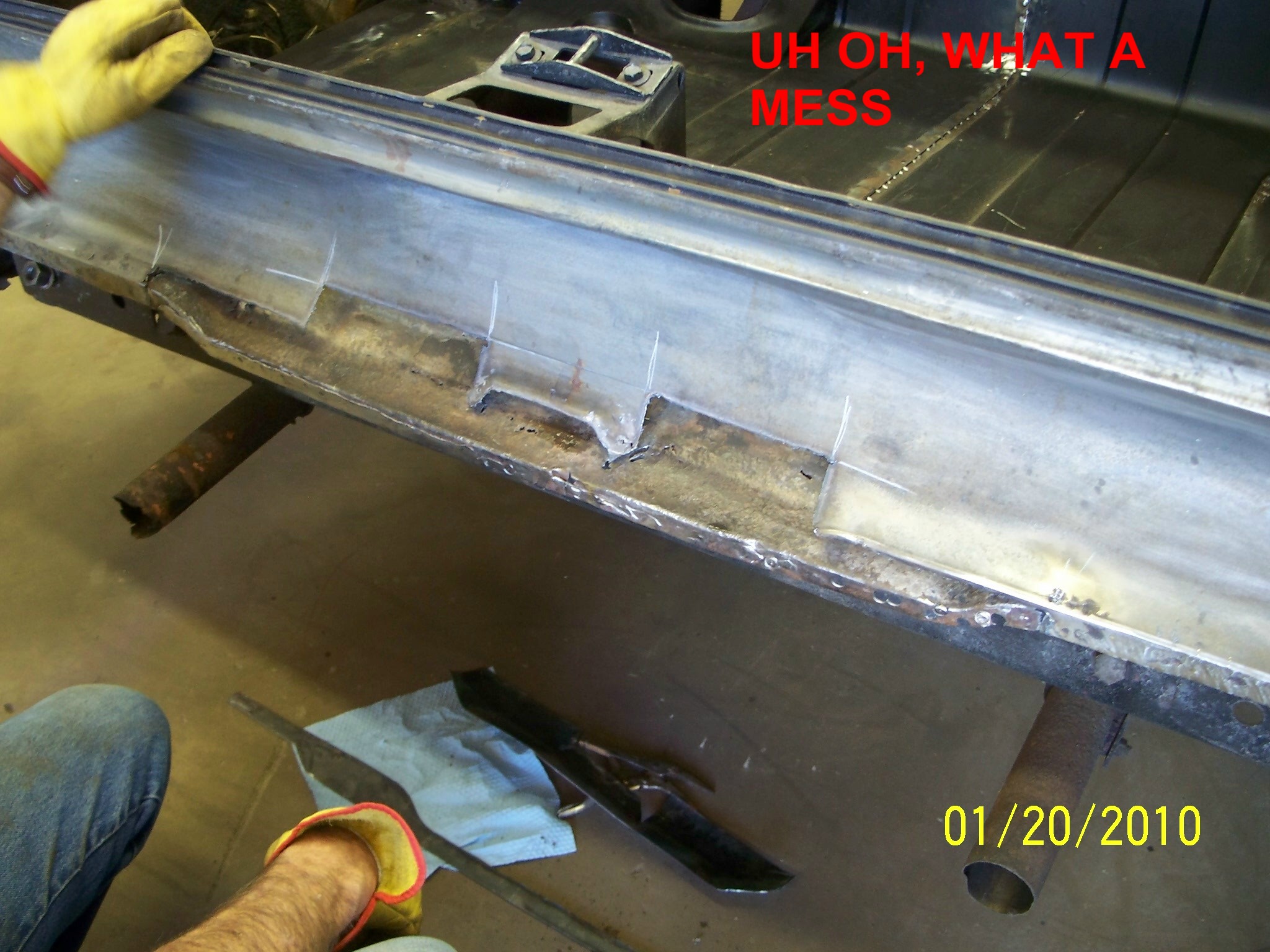

OK, more pitchers, my body man told me to be ready for hidden rust, I hate it when he's right.

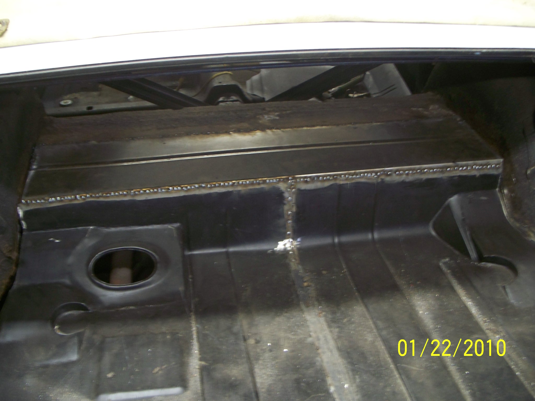

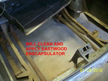

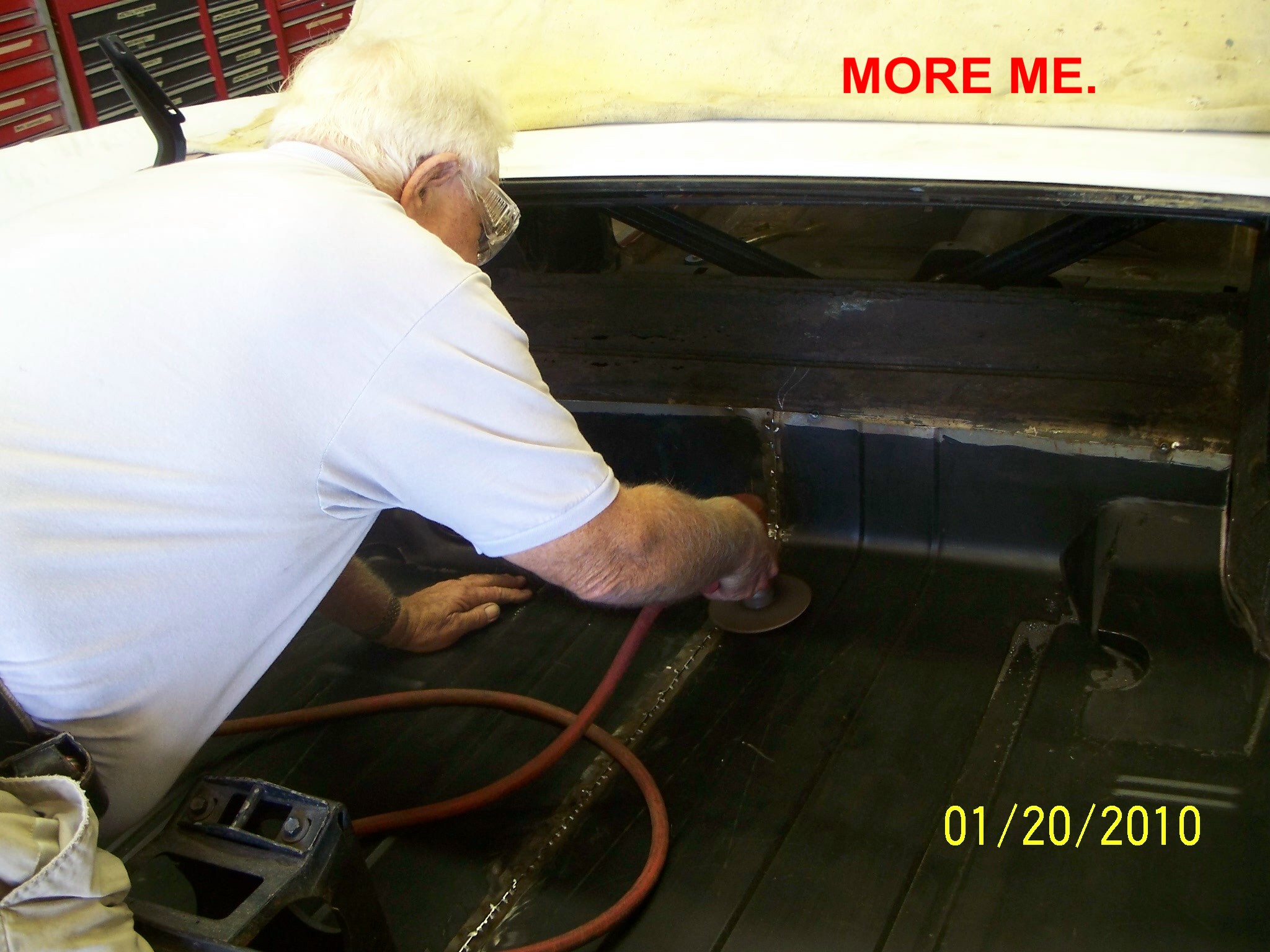

I see the gas filler hole on the left, but what is the structure on the right side?
Re: DICK'S 59 RED & WHITE SPORT FURY RESTORATION.
Hi Roger - Glad you are back and your computer is working again. I don't know what that structure is, the old floor had that too. As soon as I get it up on the lift I'll take a look and advise.

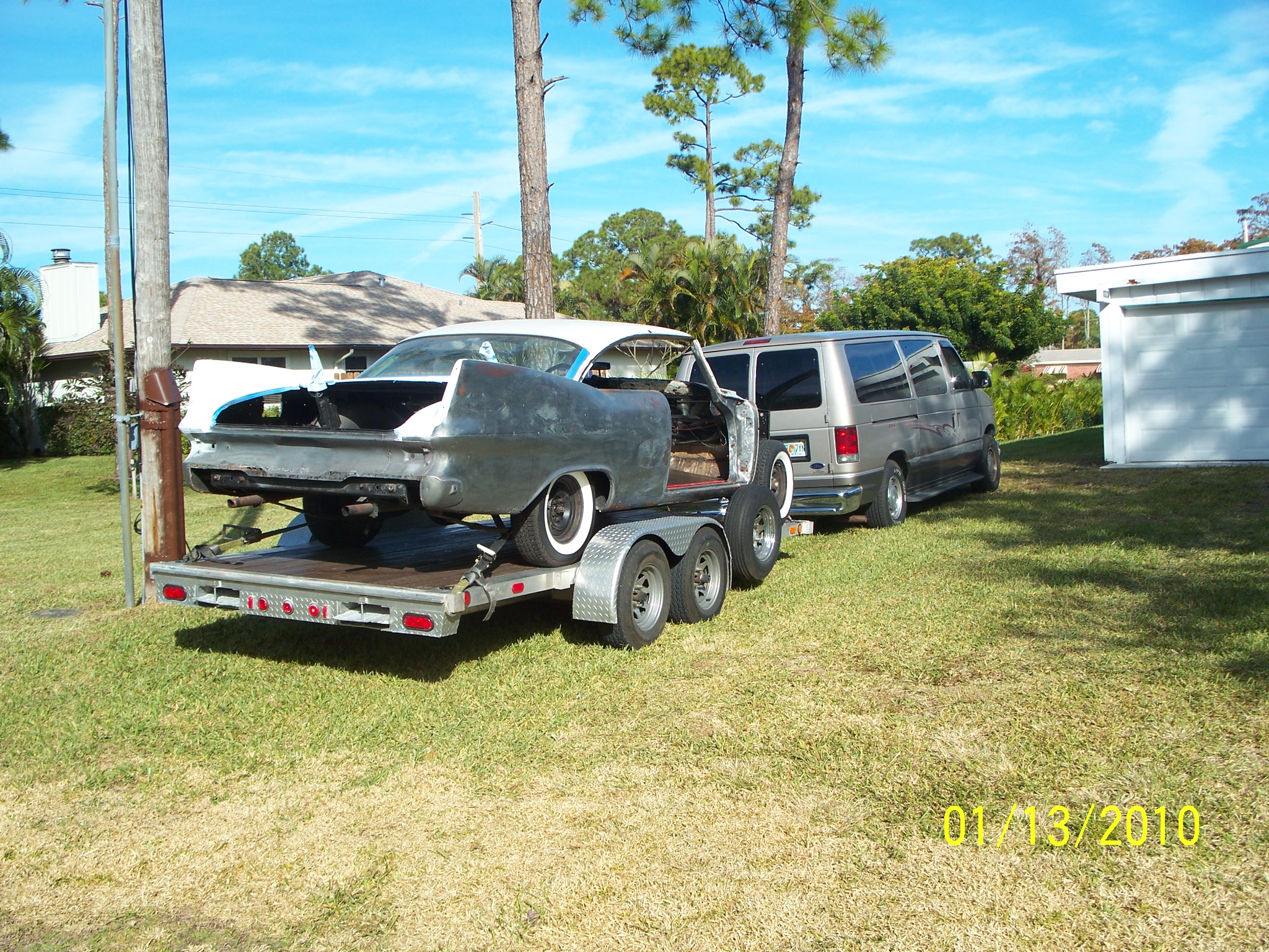

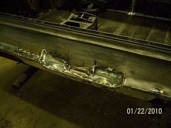

Roger - At first I thought those structures were to clear the upper shock mounts but that's not the case, they are there so the trunk floor clears the frame rails. Got her home, will send pictures later. Had to get out of the garage where she was, Larry will finish the welding that still has to be done at my house. meanwhile I will start dressing down welds and apply seam sealer where needed.

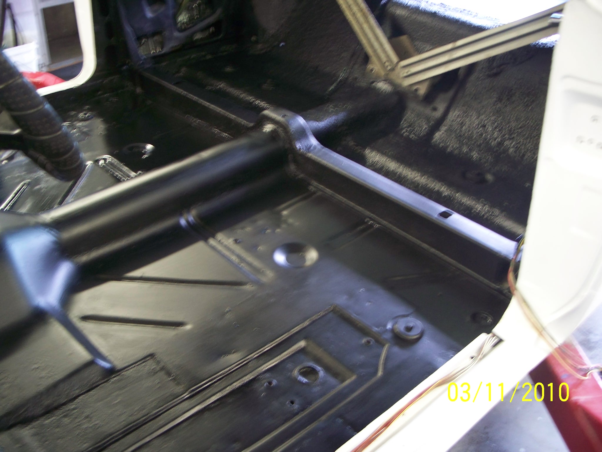

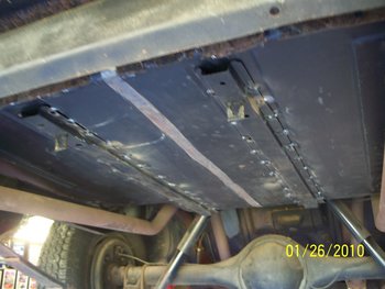

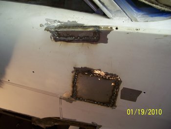

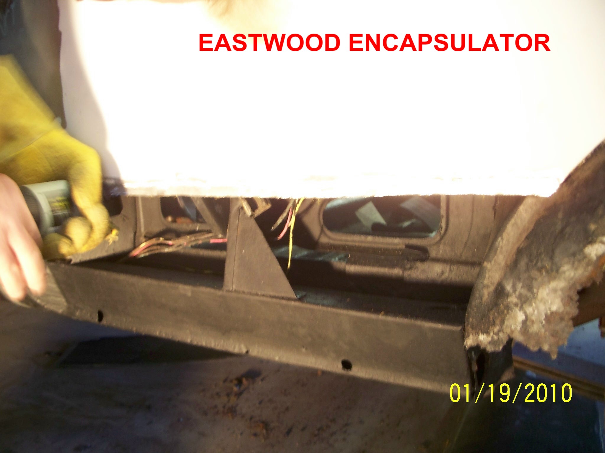

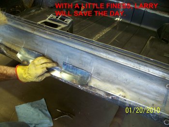

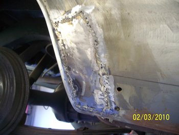

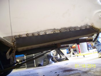

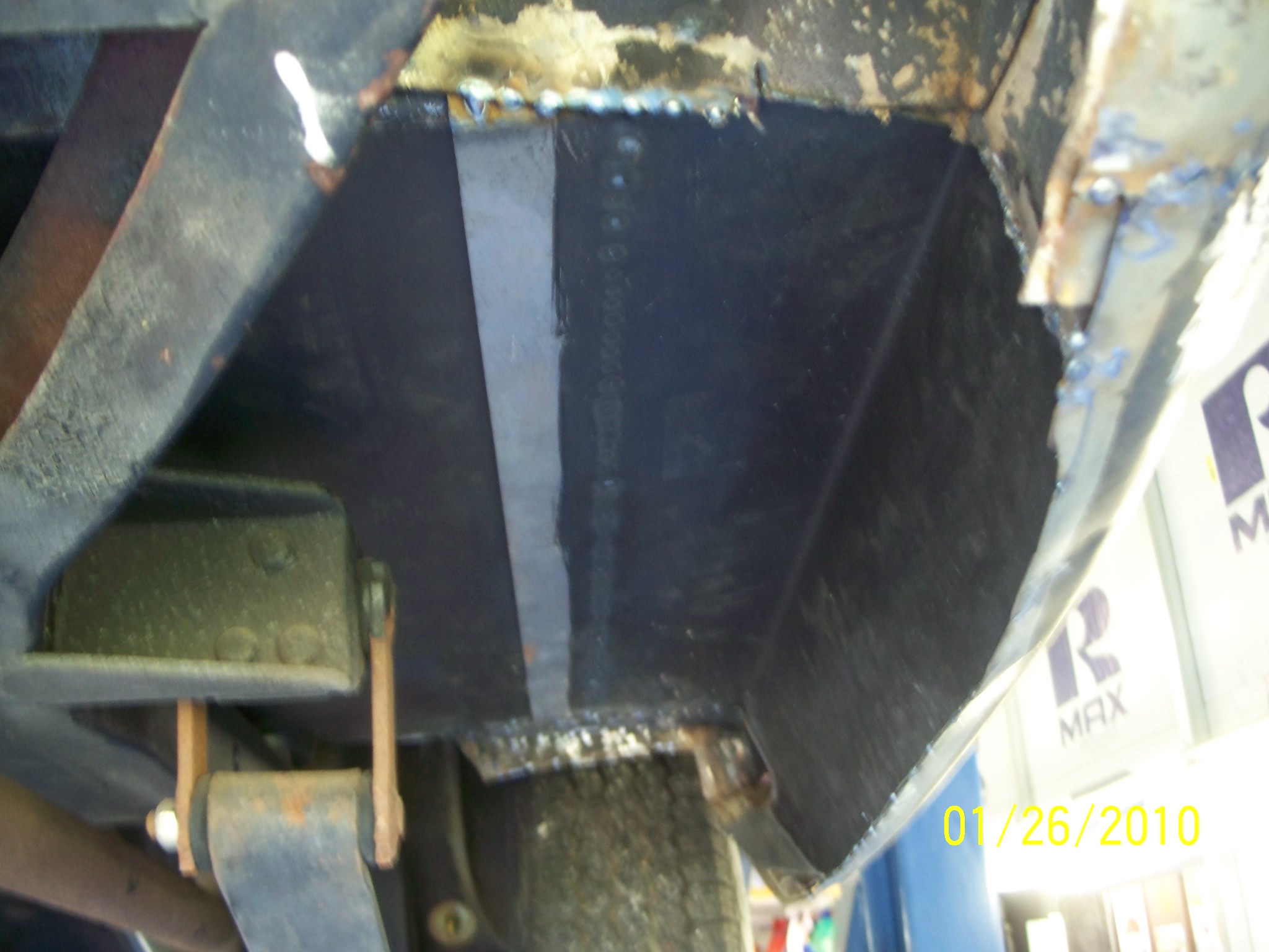

As I was posting pictures I got a message that Interner explored had quit working so here goes again. As you will notice the front floor pans are nearing completion. The repair panels were not meant to replace the factory floors but to be welded over them. As we saw it, it would have been a nightmare to replace them so we decided to weld it over the ones there. I made sure all underling metal received 2 coats of encapsulator. Anyway they are a lot stronger than before and should last at least another 25 yrs. Besides I won't be around to hear the moaning and groaning over it if whoever decides to look under the carpet.

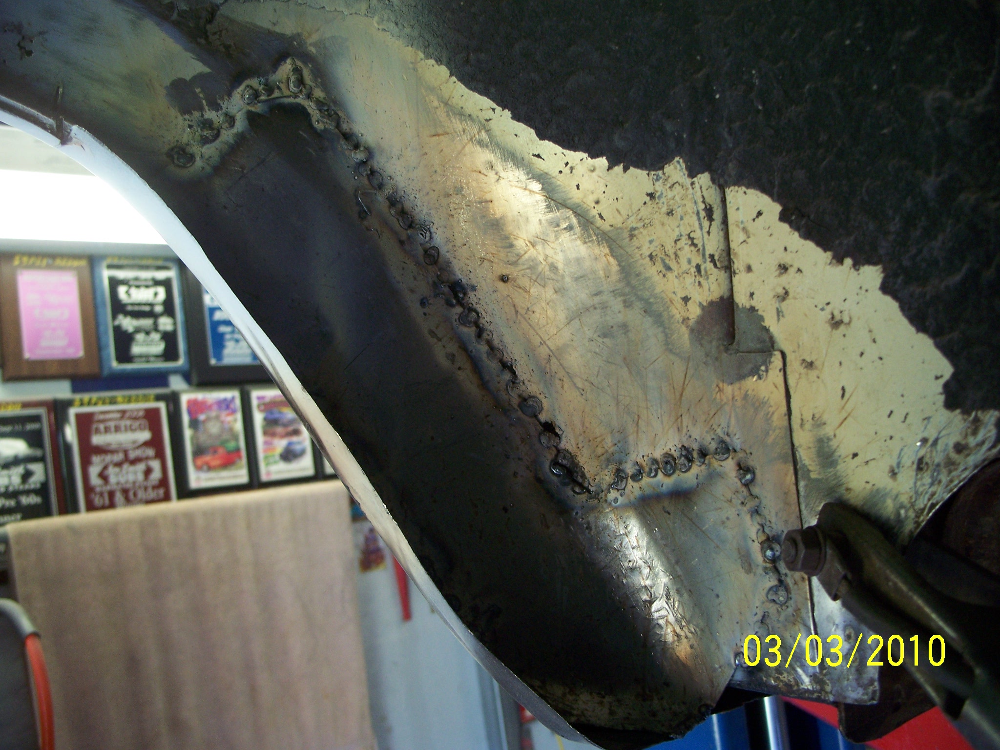

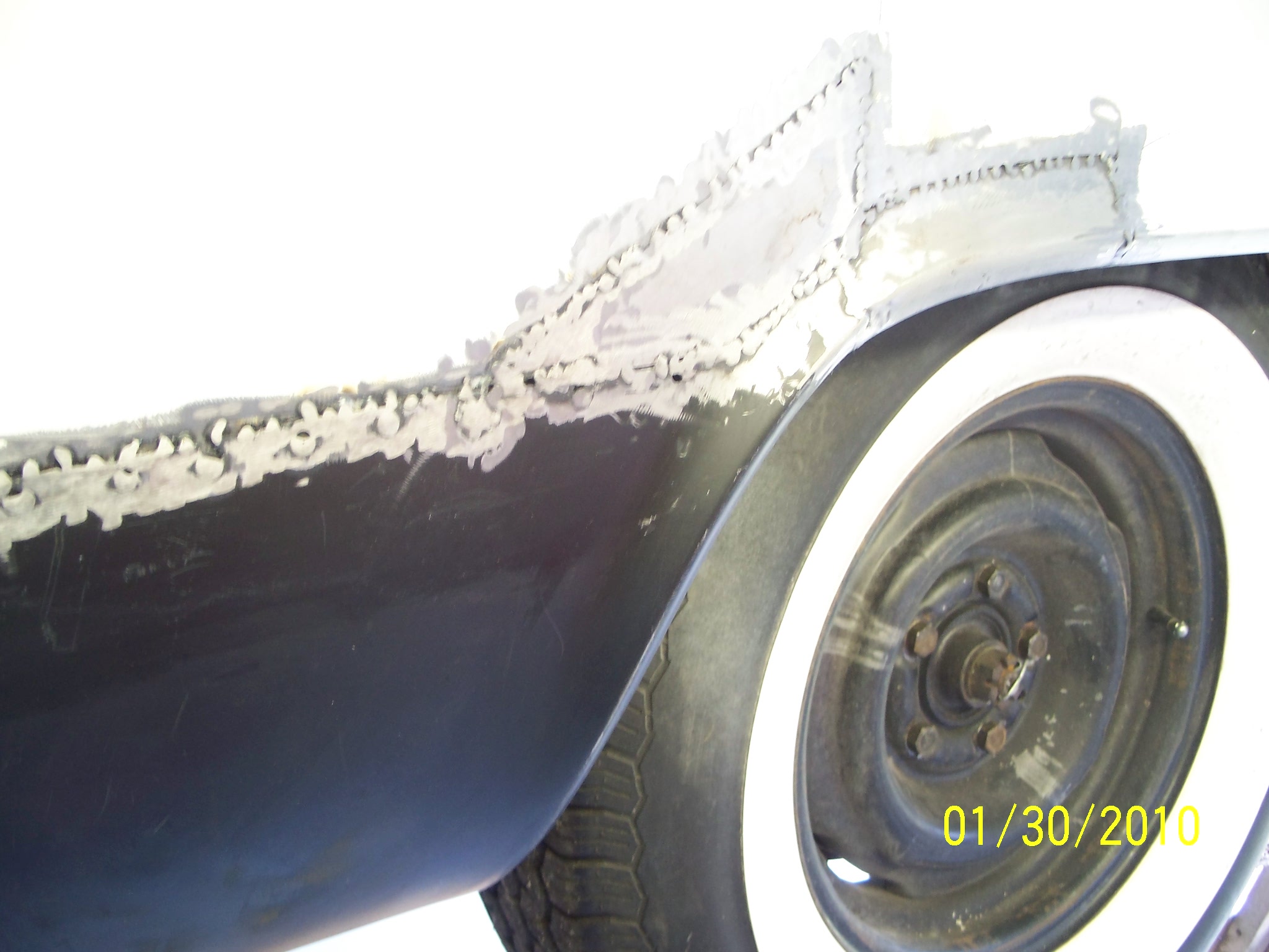

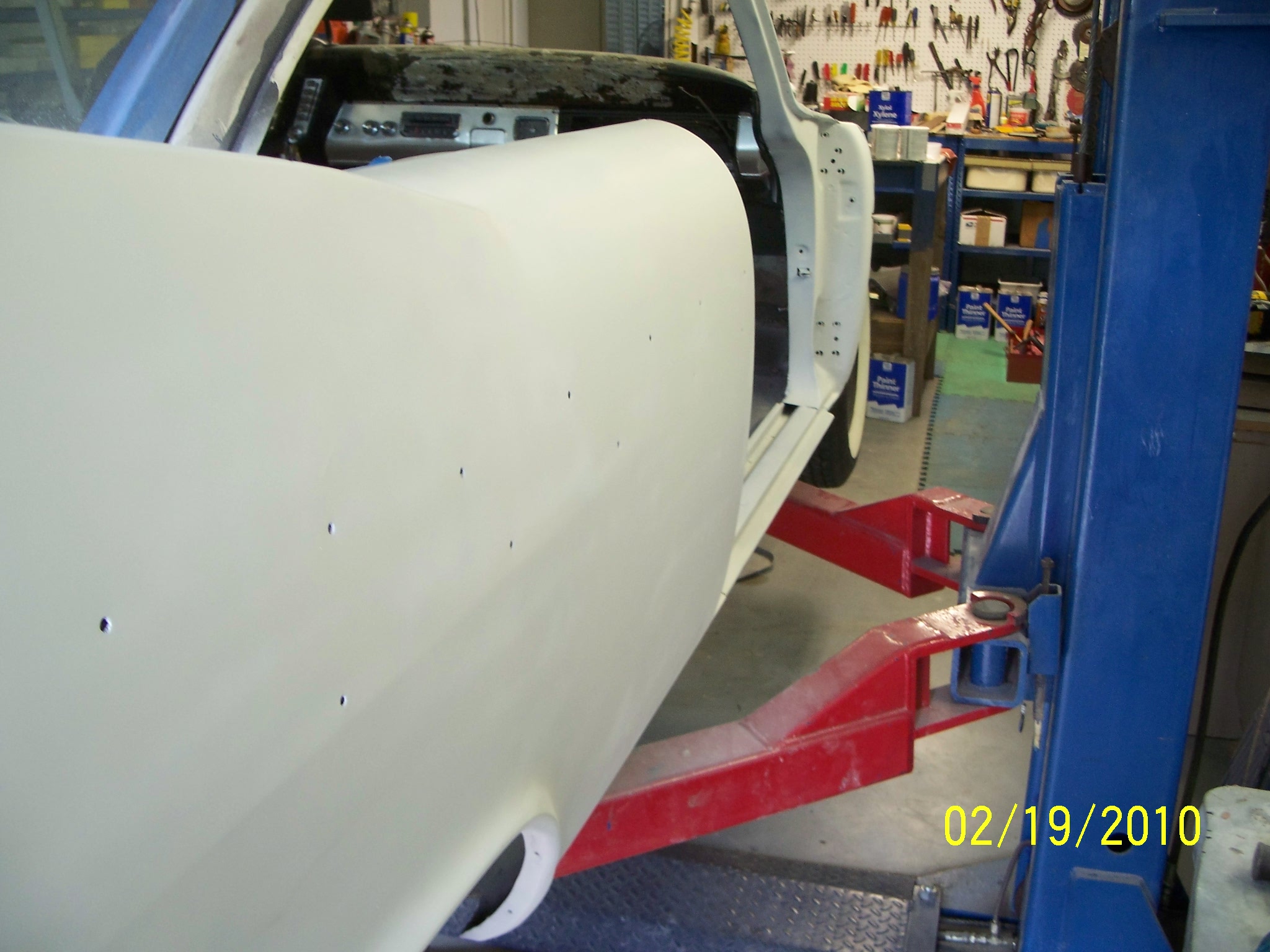

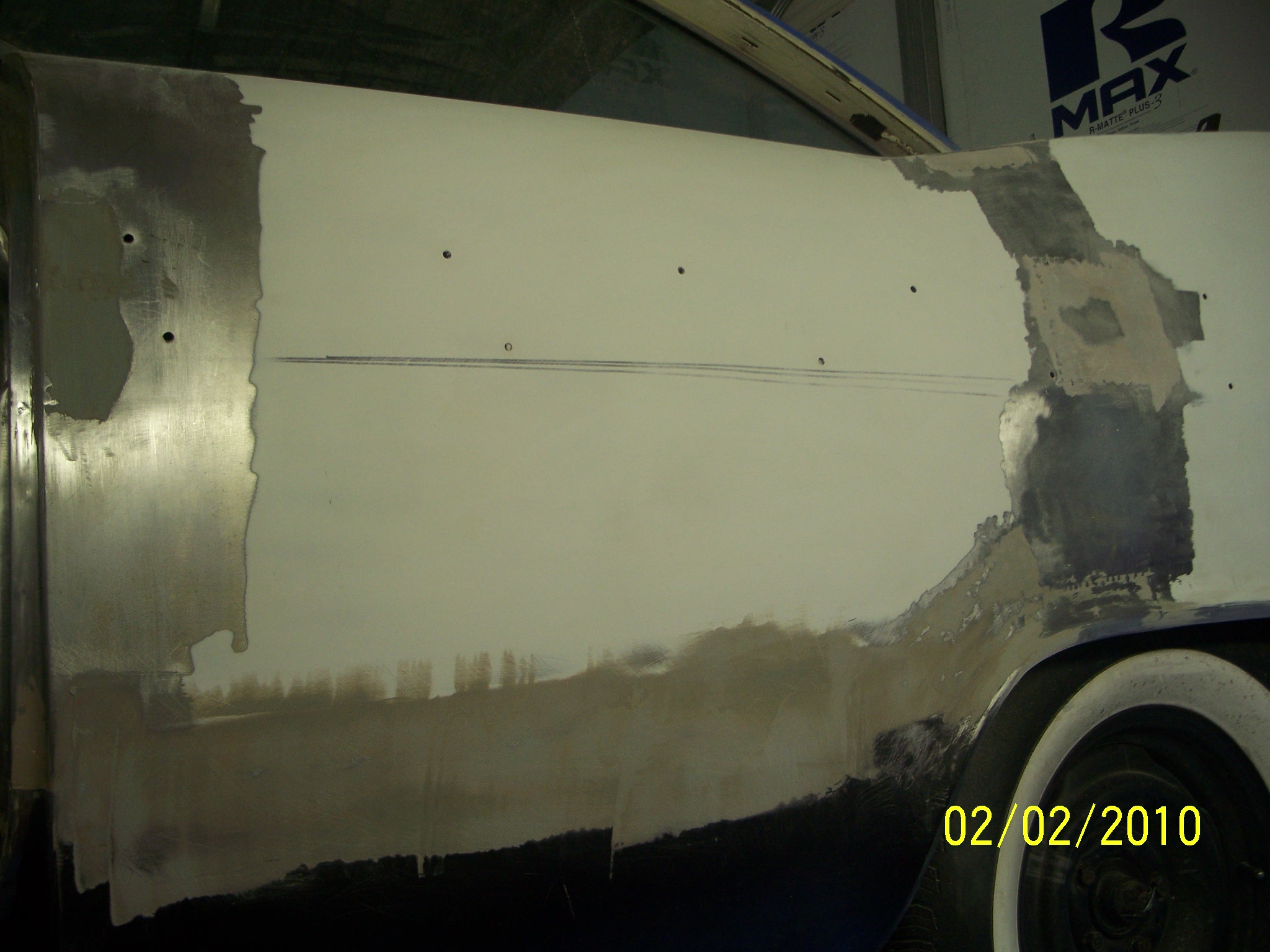

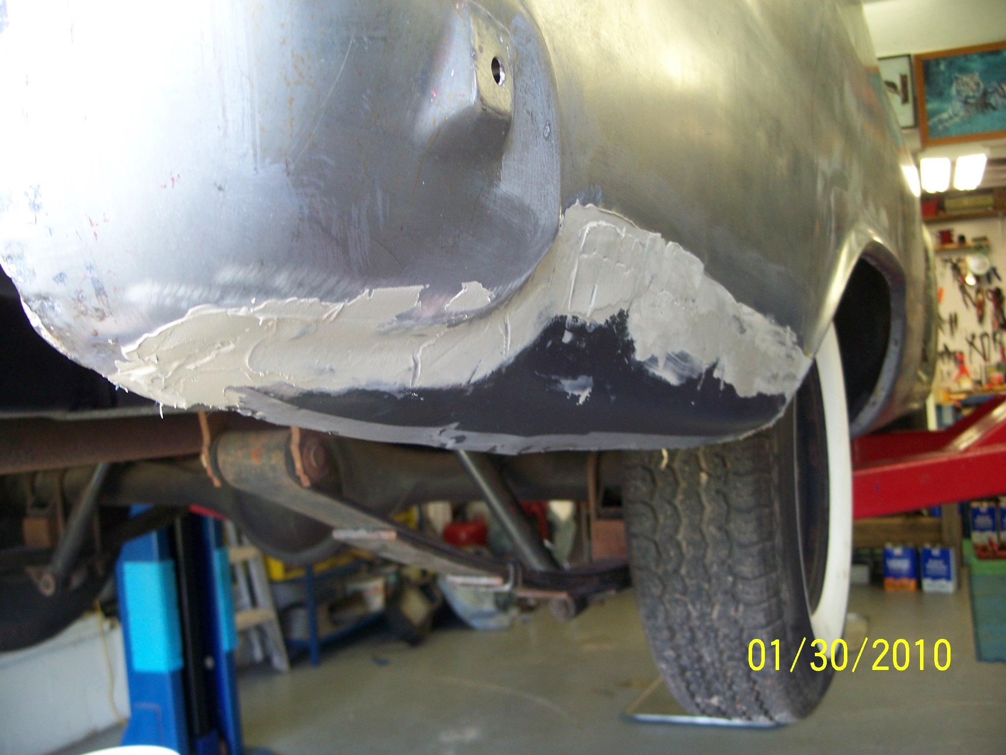

OK - here's a little progress. Starting to feel like I'm getting somewhere. Oh, and by the way, that's not Bondo, it's Body Filler. Right now I'm removing all the undercoat and crud from the bottom, it will get Osphoed, Eastwood encapsulator, and the sprayed with truck bet liner, including the trunk.
