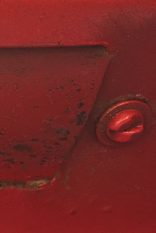

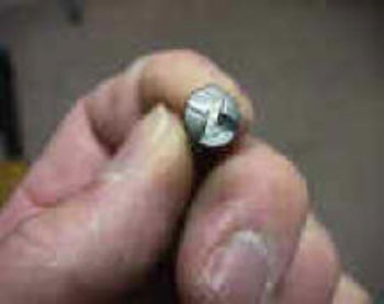

Yeah, but the paint is the least of my problems. These are security screws...
Shown here, and discussed here. How to get them out?
Re: Faulkner gets a Redo
You are not going to believe this but l have been working part time at the local ACE Hardware for a little over a year and a half. I help customers in all departments but one of my primary jobs is the faster dept. Friday l was tasked with sorting and labeling all the security screws. We always have one of those tools in the drawer, coincidence or what. As per the article try thier methods or grind the head off.
Good luck,
Use your Dremel to make a slot in it for a screwdriver. That's how I always do it

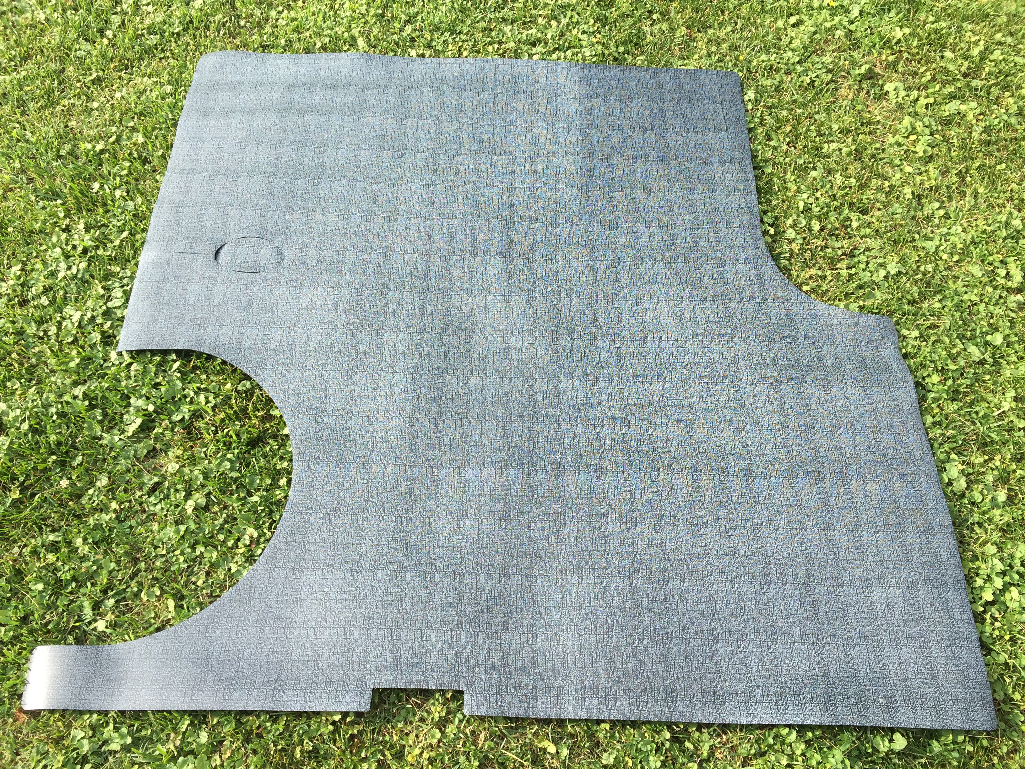

My stuff from Muscle Maniacs came today!
Mark '55 survivor' wrote: Like I said there is an extra part stitched on the top side. I don't know what it is for as I ran it up the seat back.Today I just folded it under as I am working on the car and placed it in for pictures.It has cut outs for the filler tube,I notched it out for the trunk latch base and A small acsess in the middle for my air shock stem.Plenty heavy and has some weight to it. Iam happy with it.
Mine didn't have that extra section, Mark - and, it had the cutout for the trunk latch base and an oval cutout for the filler tube:
It really is good quality! Have to be careful with what you use to clean it, though...

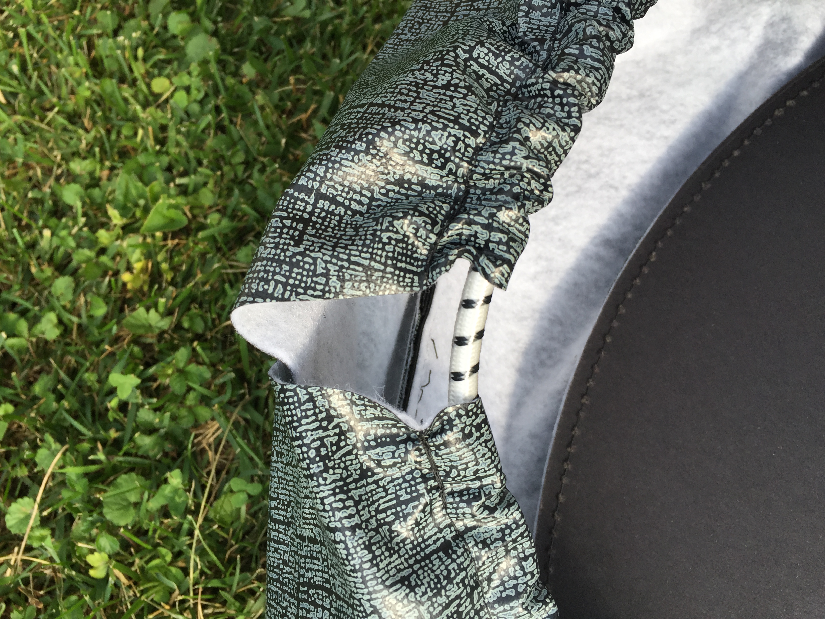

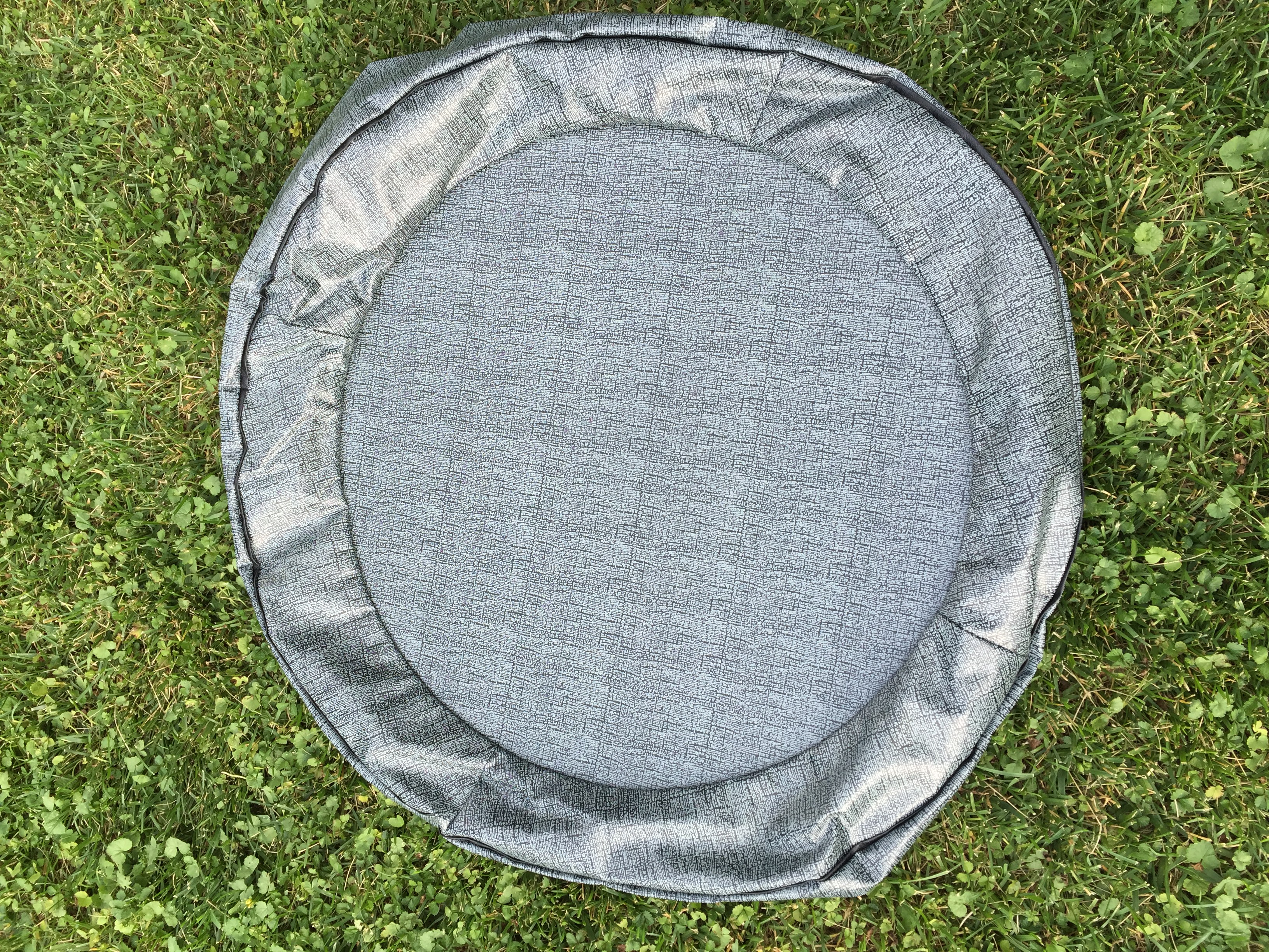

I also got the spare tire cover. Nice! It has a stiff backing for the top, and an elastic band around the bottom to keep it snug.

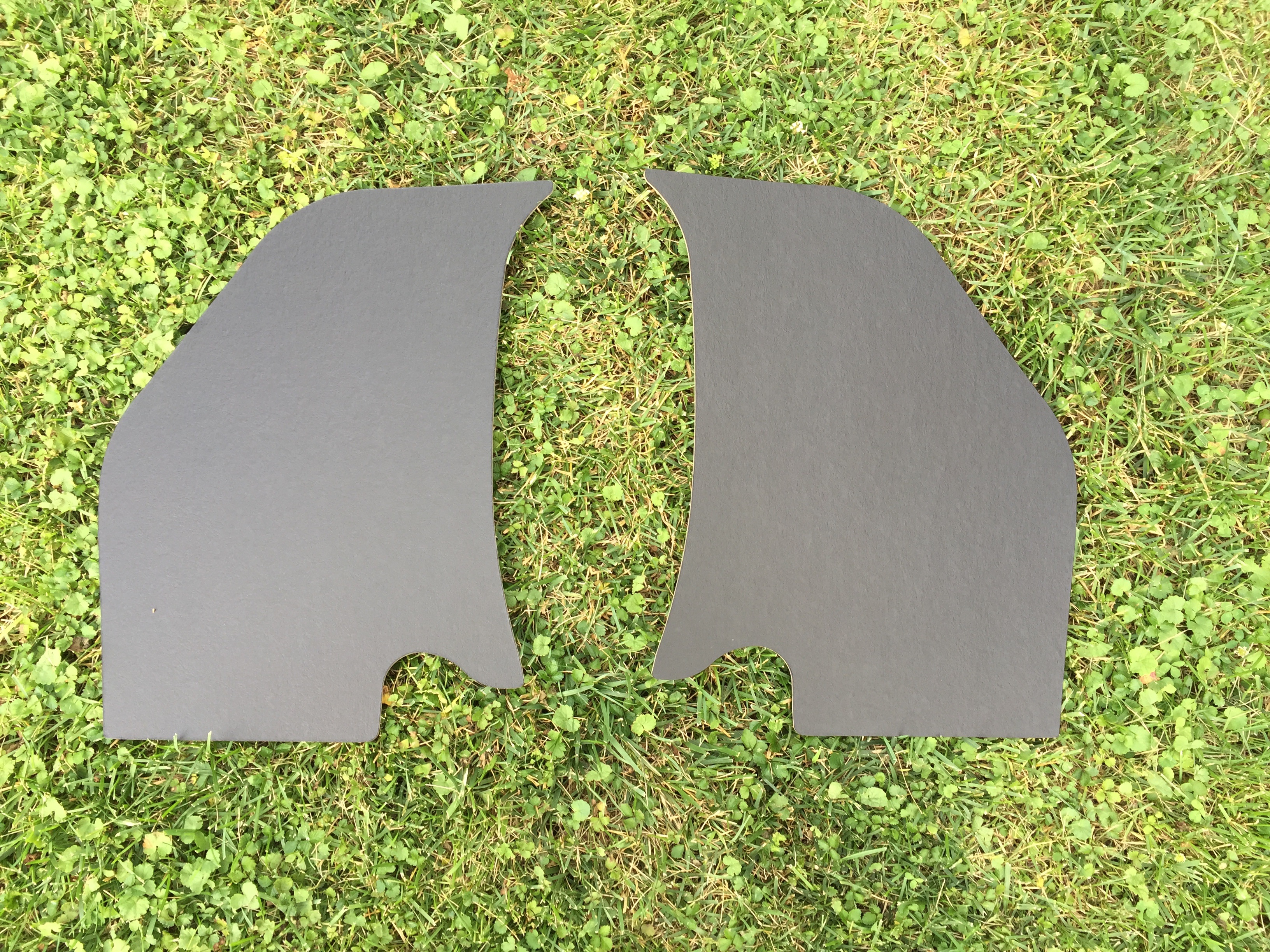

I also got kick panels from them. They seem to be the right size, but I don't know what that scallop is all about:

Dan; looks good, mine must have been at the early side of production. I will call about the tire cover. I think I got my glove box from him as well. Mark

The scallops are to fit around a brace under the dash, you will see when you install, you may have to trim a little.

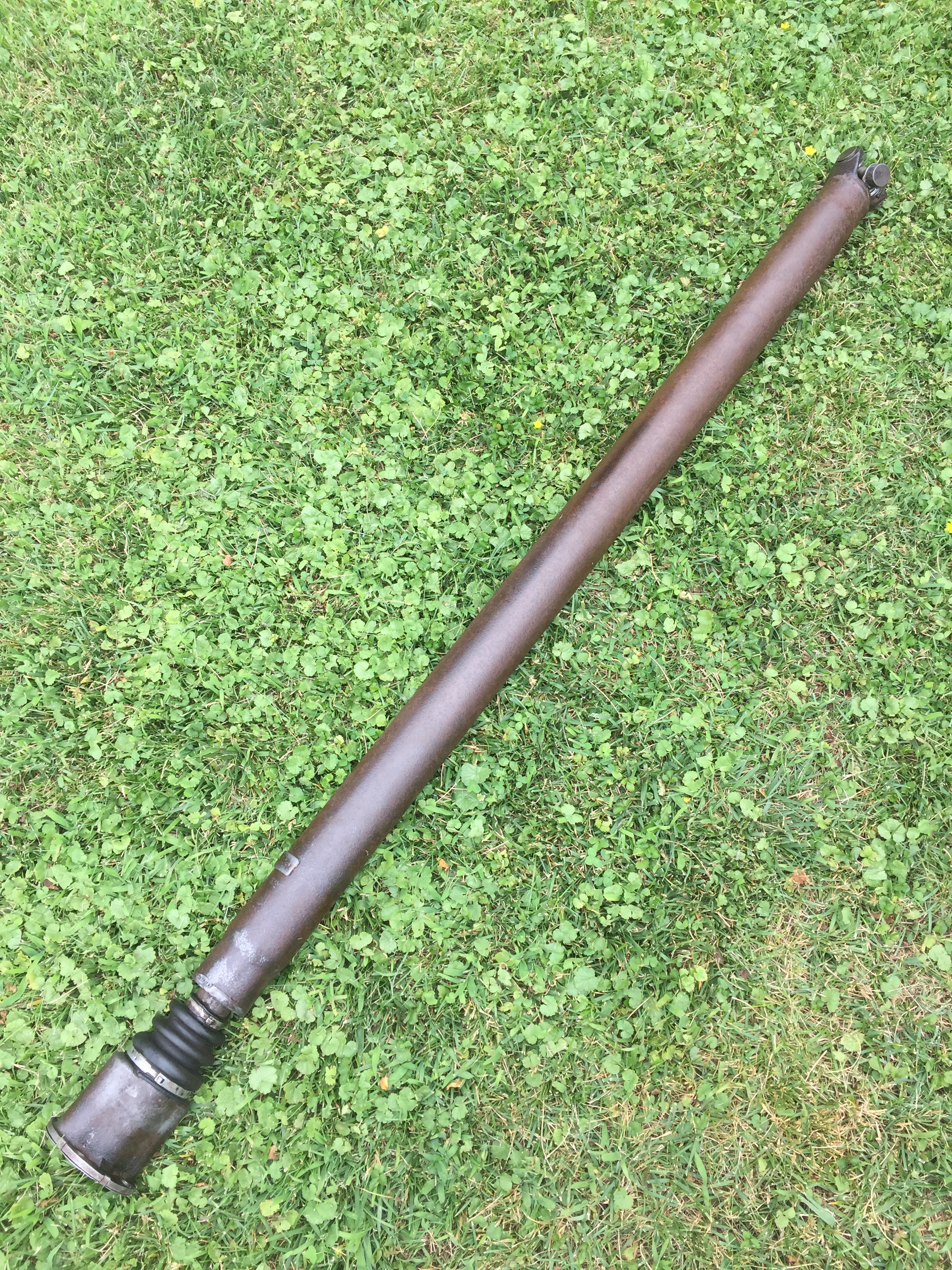

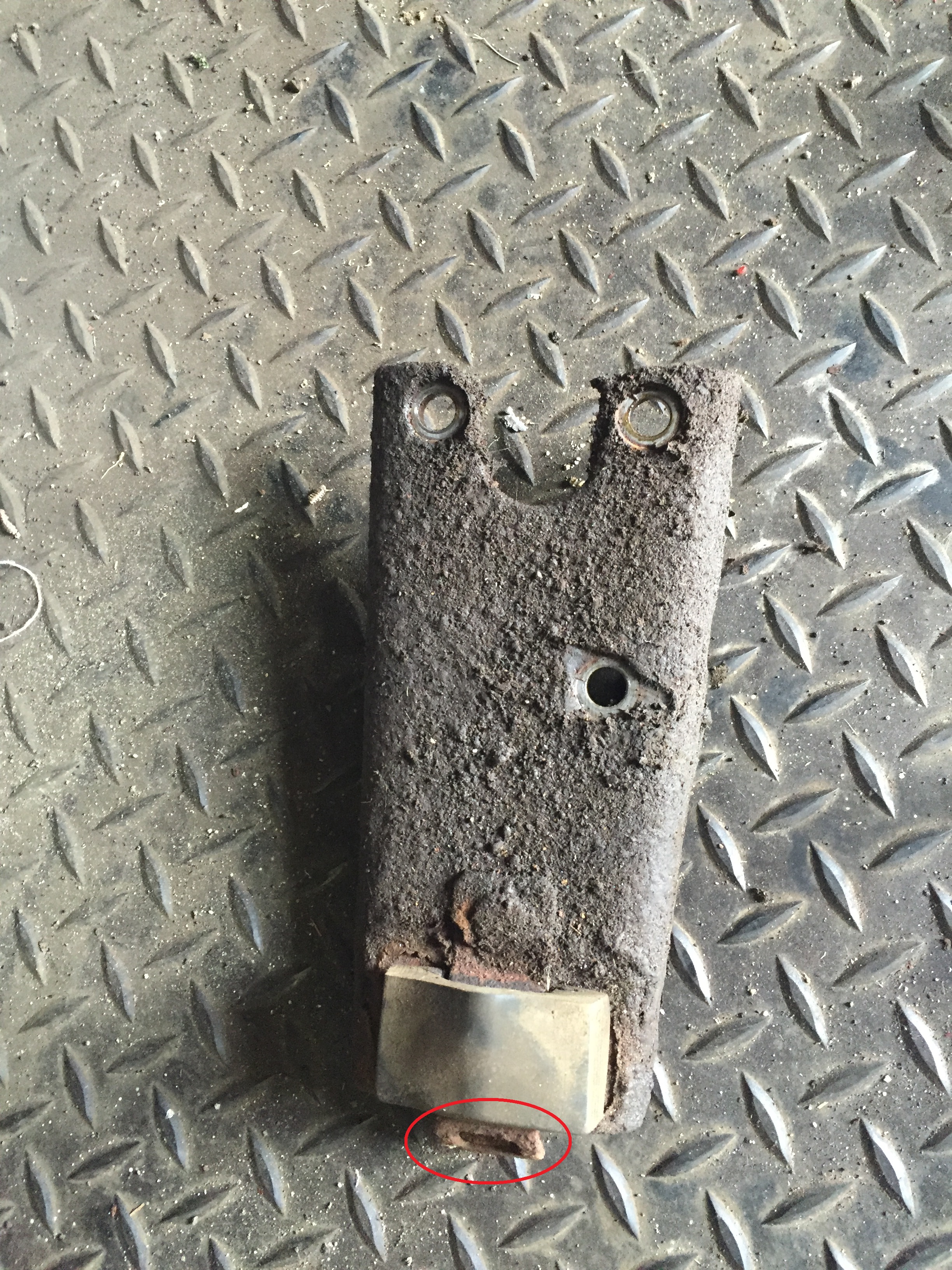

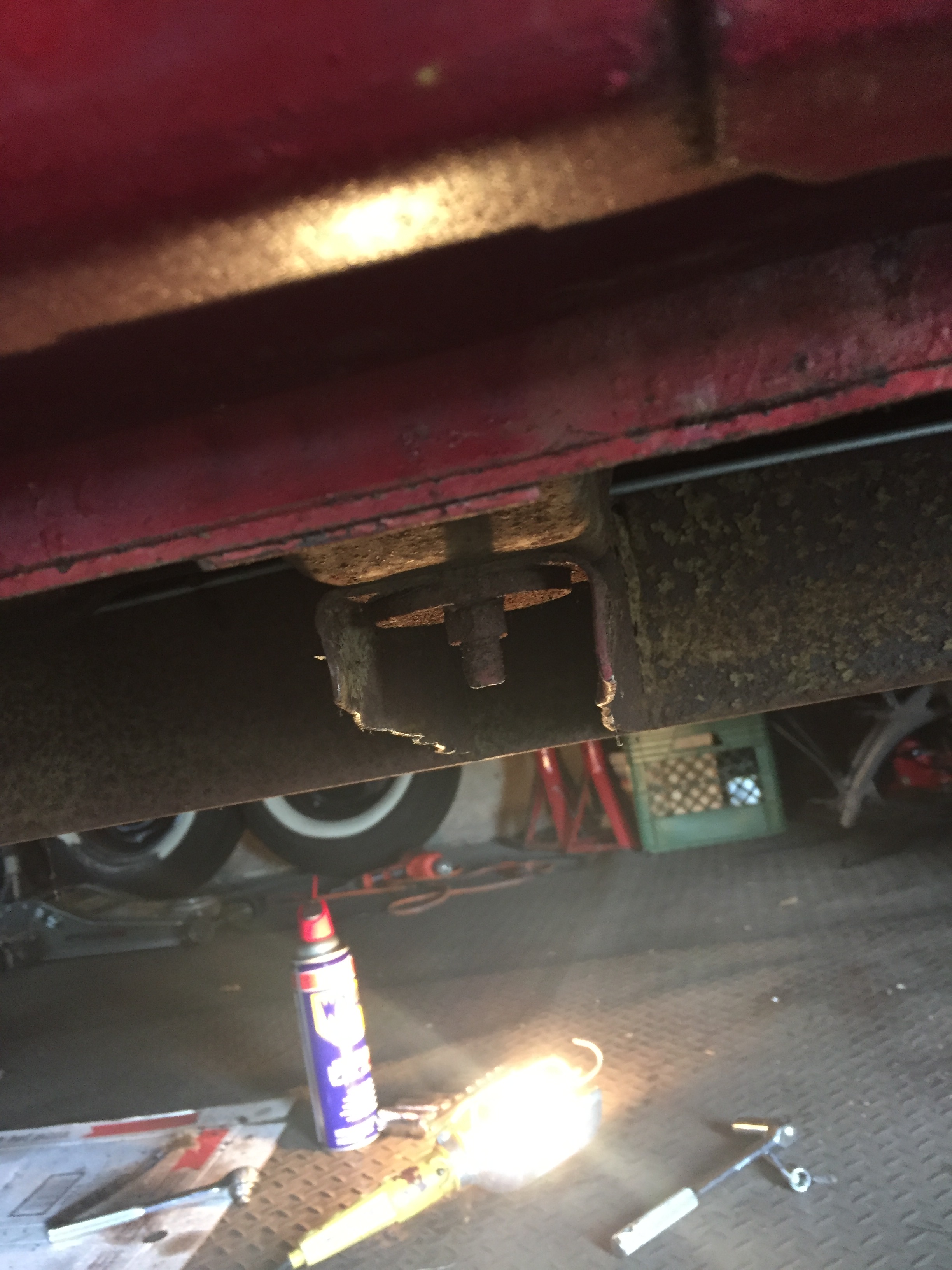

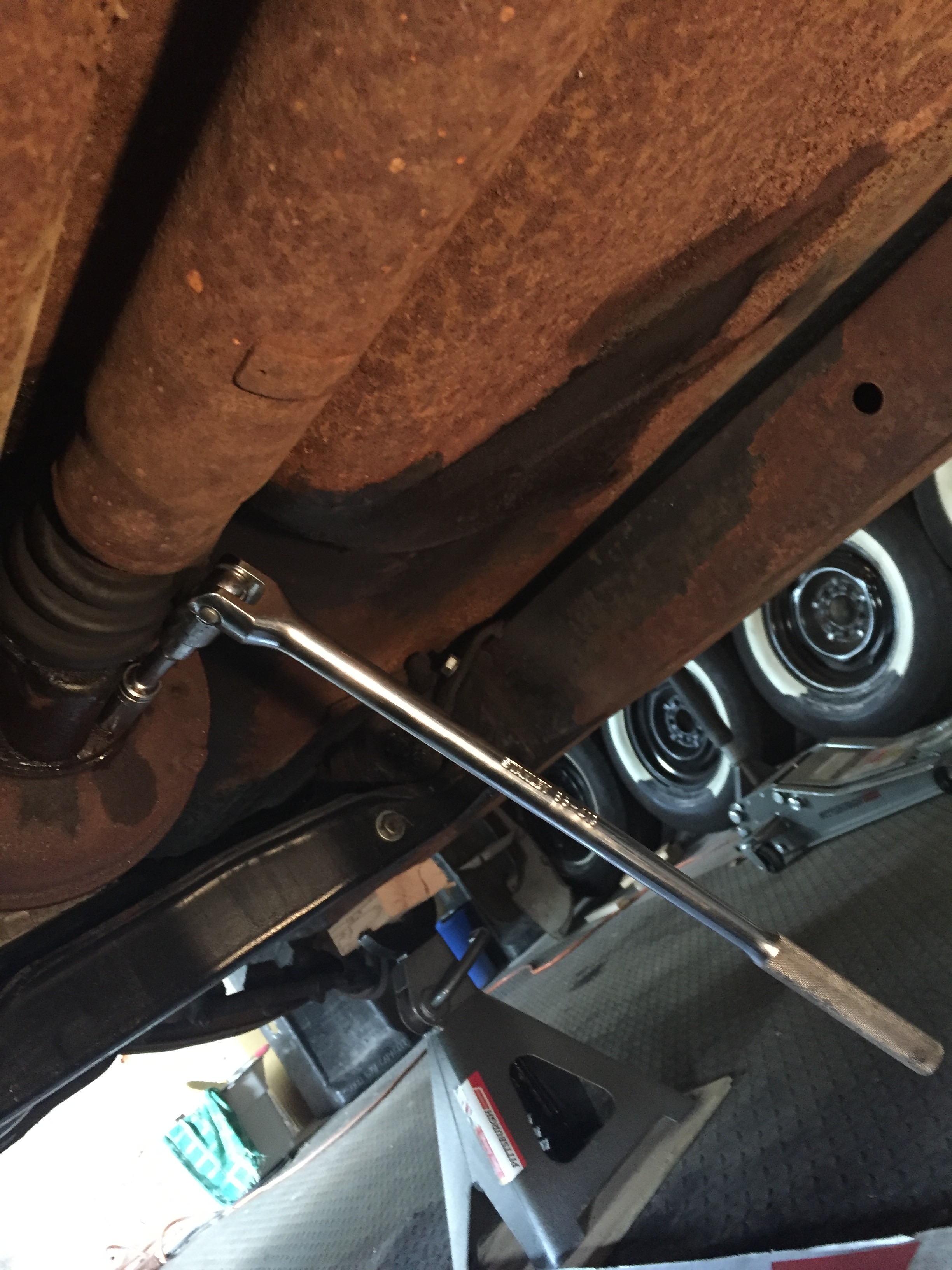

T.W. Sam finally got his butt out to the garage today and attempted to remove the driveshaft. The rear was easy enough, the retainers for the universal joint came right off.

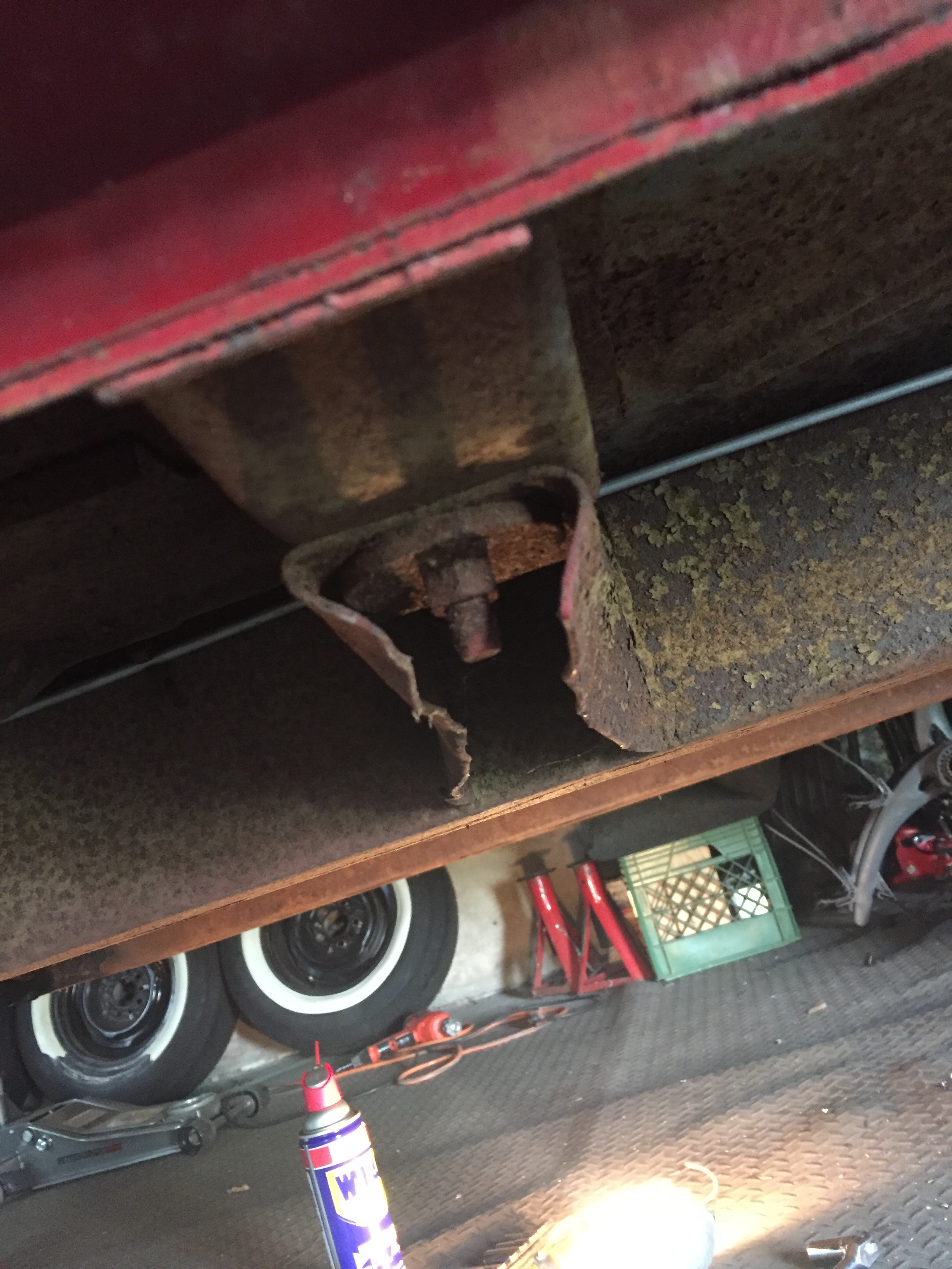

But man oh man, the nuts on the emergency brake drum were tightened up way more than they needed to be. I took a hammer to a small breaker bar, to no avail. So I did it the right way: I wirebrushed the threads, soaked in WD-40, gave the nuts a tap-tap-tap, and let it sit.
I decided to attack this casualty of driving by the Braille method:
Close enough for government work.

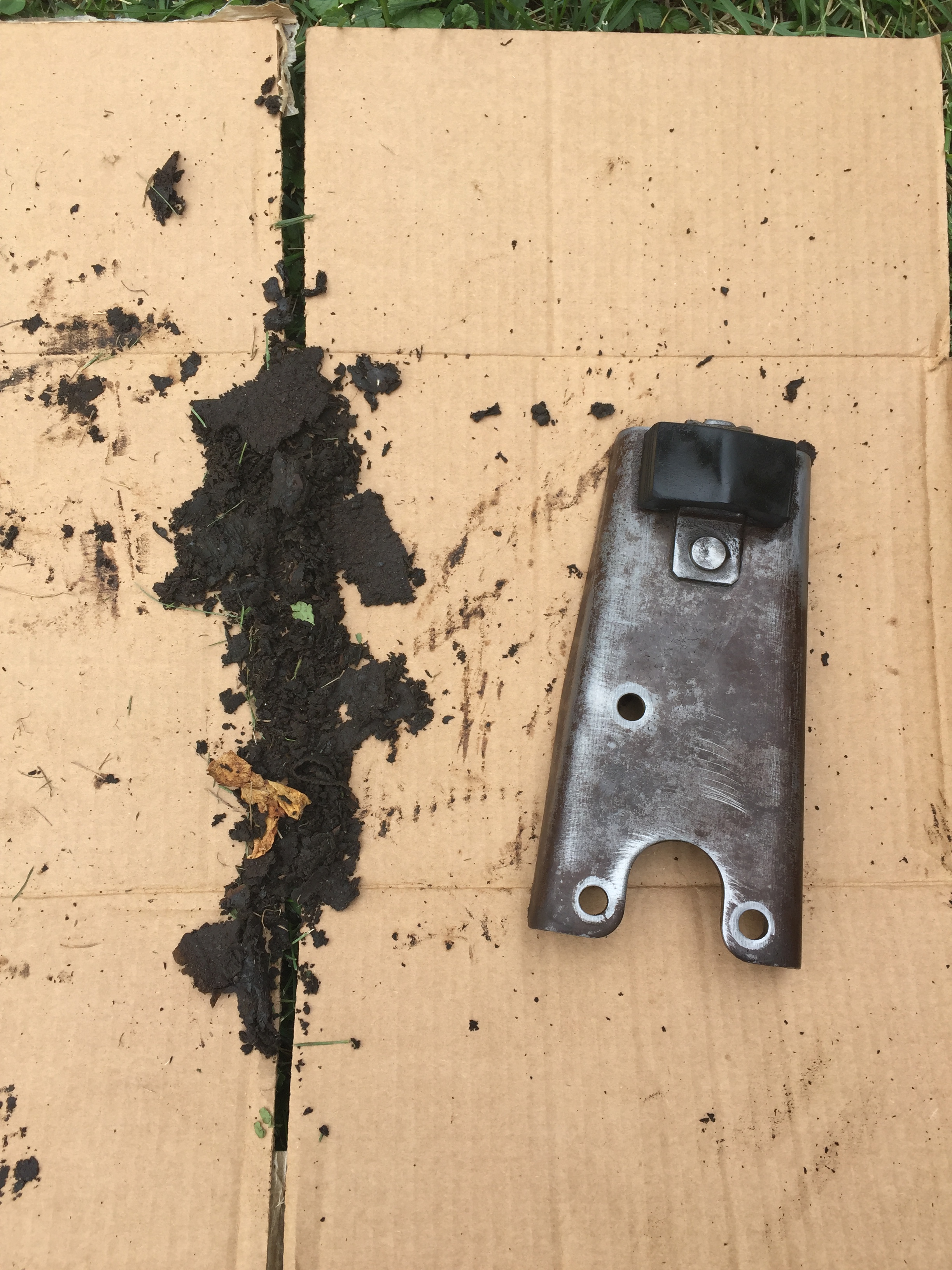

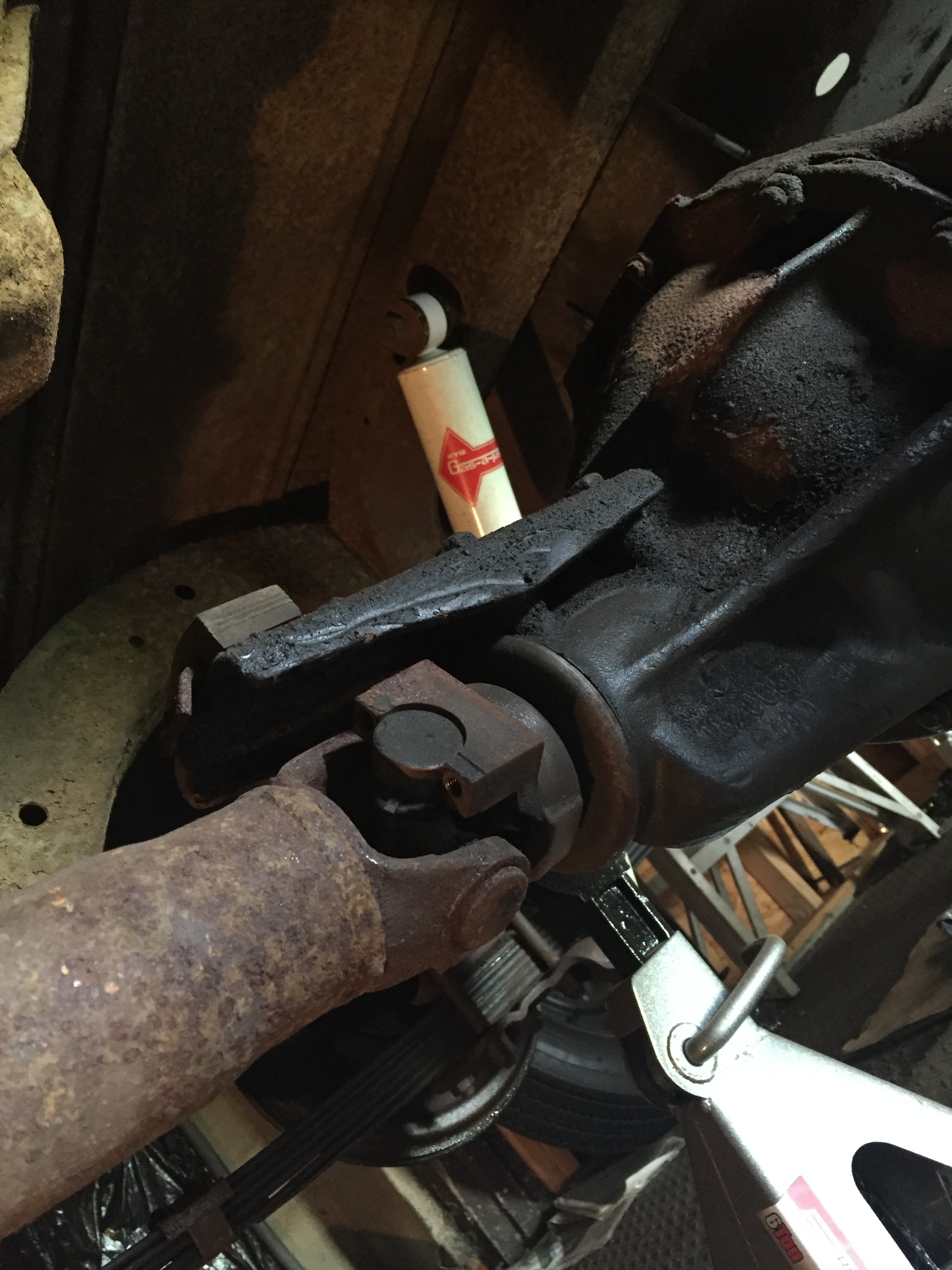

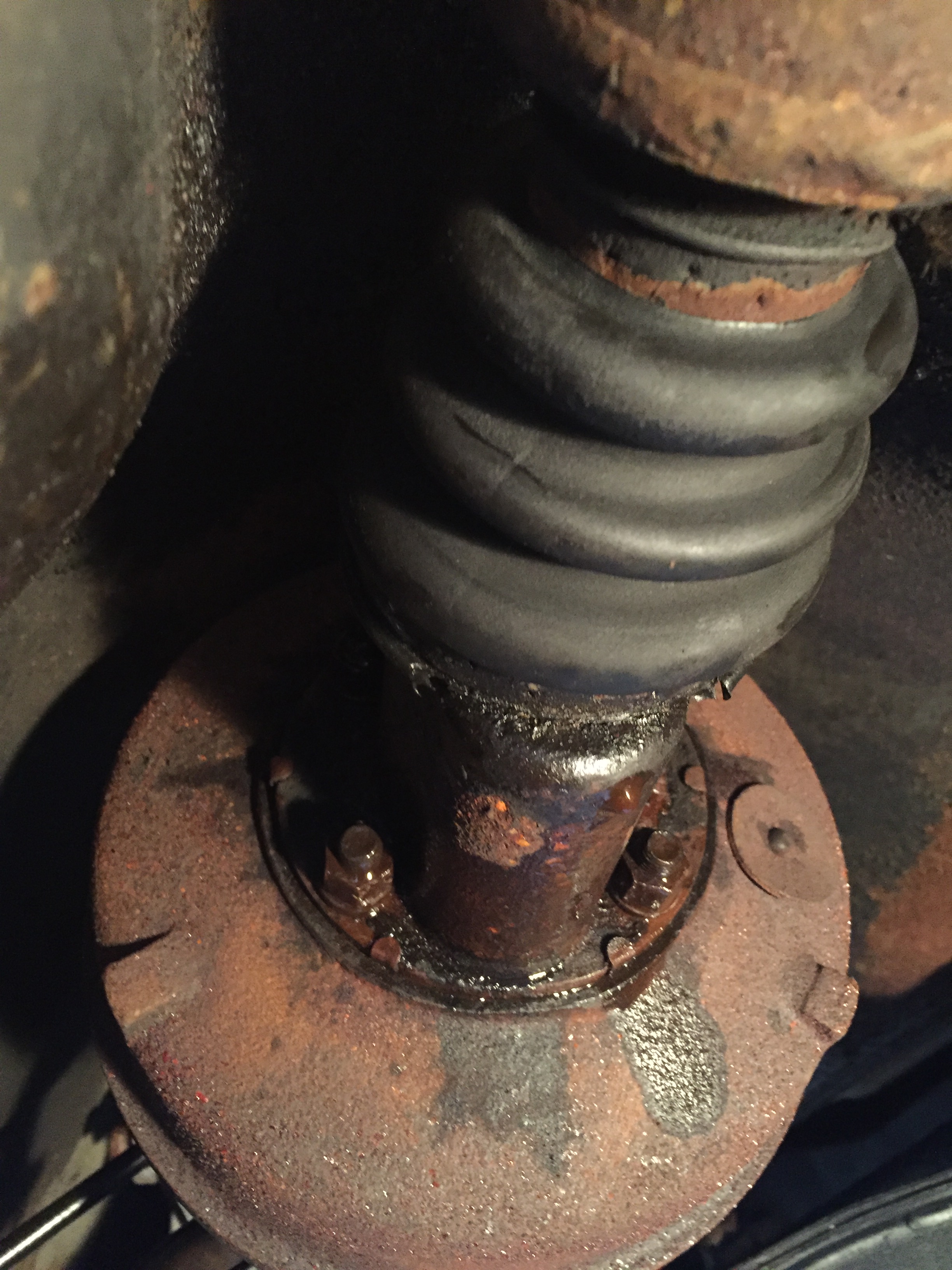

I then removed the plate bolted to the differential, that protects the rear universal joint (e.g., when the Sterling daughters were speeding over speed bumps). Man, was this caked with grease. Scraped it all off, wiped it real good with mineral spirits like Dr. '59 told me, and osphoed it. Came up real nice. Notice the the bumper retainer clip had come off the nub, a couple well placed taps with a flatblade hammer popped it back on.
Then I returned to the driveshaft. Preparation pays! And so does a big-ass breaker bar. Doncha know there was a "crack" with each one, but they came right off.

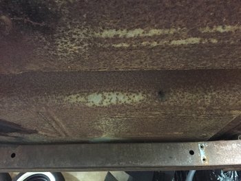

With the exhaust and driveshaft out of the way, I've got plenty of room to work. And there is plenty of work to do... In rust we trust! Those dry desert conditions were good to Faulkner (if the Sterling girls were not) - no rust through, all just surface stuff.

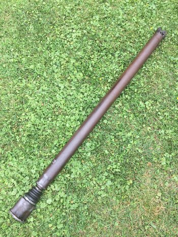

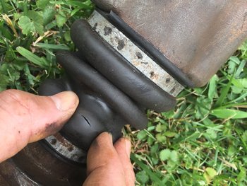

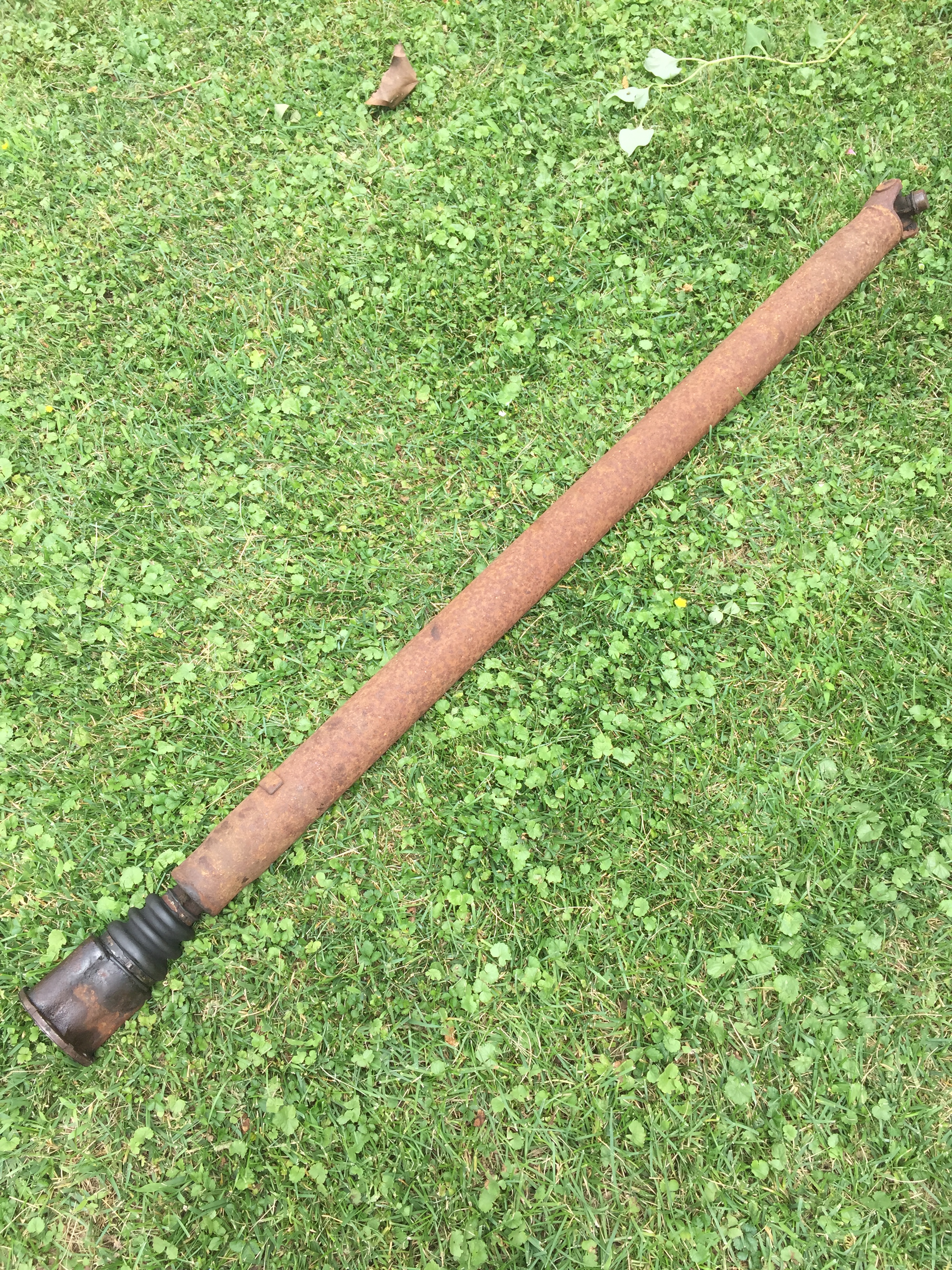

The driveshaft is in very good condition - tight joints, and even the boot is good and very pliable...

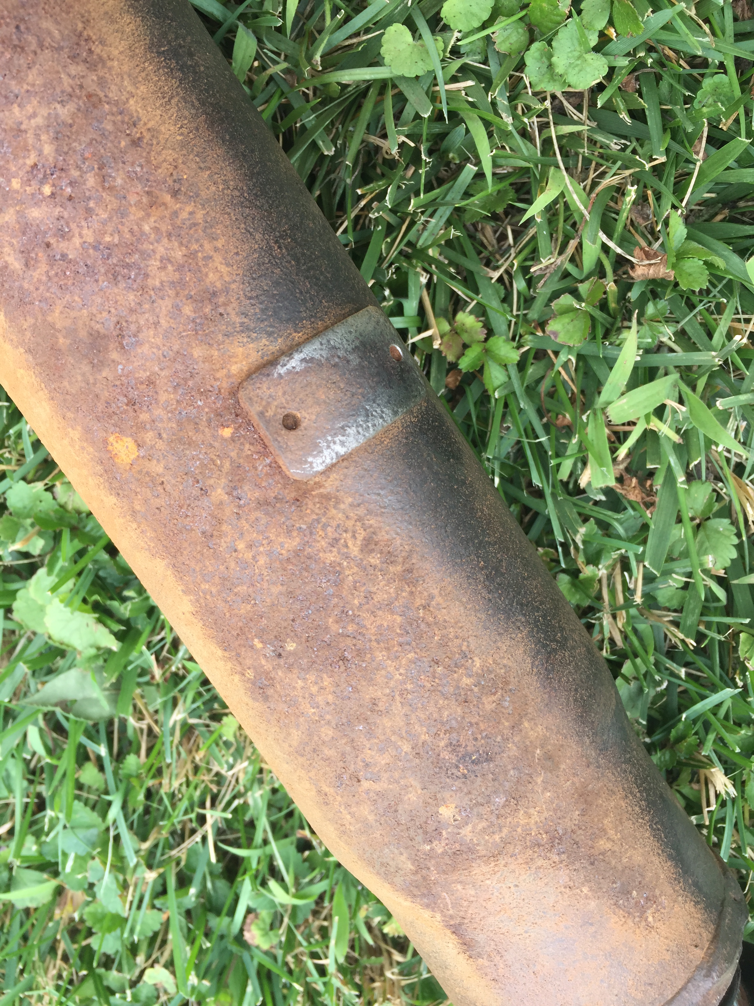

...except for one spot. I'm thinking I'll degrease the area, put a spot of silicone on it, and leave it be. Easy enough to fix if conditions worsen.
Since the rust I'm removing is fairly uniform, I assume I won't need to have the driveshaft rebalanced.

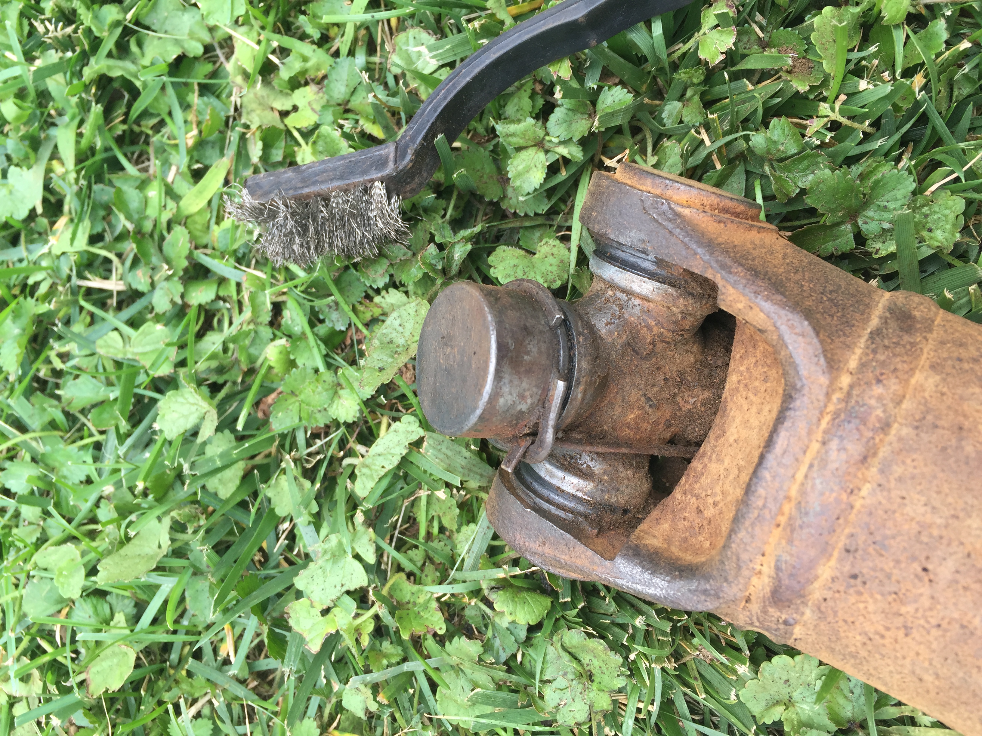

I used a hand held brush to get to those tough areas... I wiped greasy areas with mineral spirits, osphoed and then used my Yuengling Timer before I wiped it down.

Ya doing good, goop for the boot, l keep a small tube of goop in every car right next to the small roll of duct tape. I suggest you go on a rampage and spray every nut, bolt and screw
