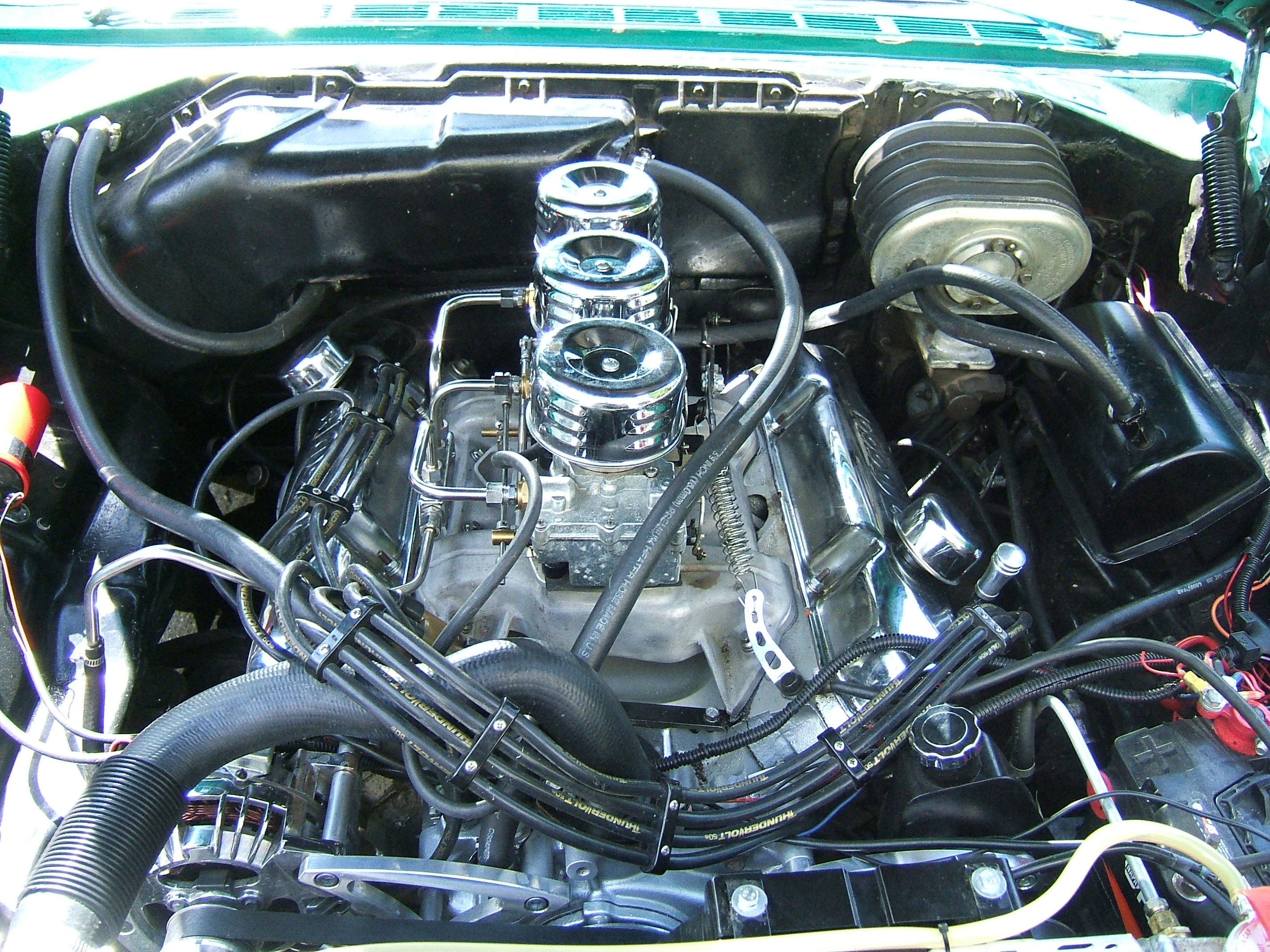

This is what the engine looked like when i bought it. I've changed many things but don't have a current pic

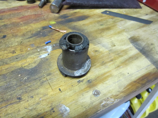

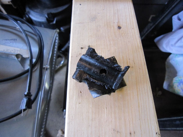

I had the front end rebuilt last summer, as you can see the bushings were shot!
After the rebuild there was alot of play in the steering and I know Mike had put in a rebuilt box. so after a little digging i found that the insulator bushing is shot, this is what i'm currently working on. I ordered a new bushing from Andy Bernbaum yesterday. hopefully that fixes it.

I installed the insulator and put the column back together then took for a spin. WOW!! what a difference! I thought i was going to have to replace the steering box, but all it took was $7.50 part to fix the problem! On to the next project!!!!!!!!!!!!

After trying for three years to get the Tri-power set up to run i've given up! No matter what I do it has no off idle power, I've gone through the center carb twice and tried a few different things and nothing! It would idle great and full throttle was good but in between sucked!
Before
I removed the Tri-power and installed a Edelbrock intake and a Holley 750 vac secondary. WOW! what a difference! It's like a new car
