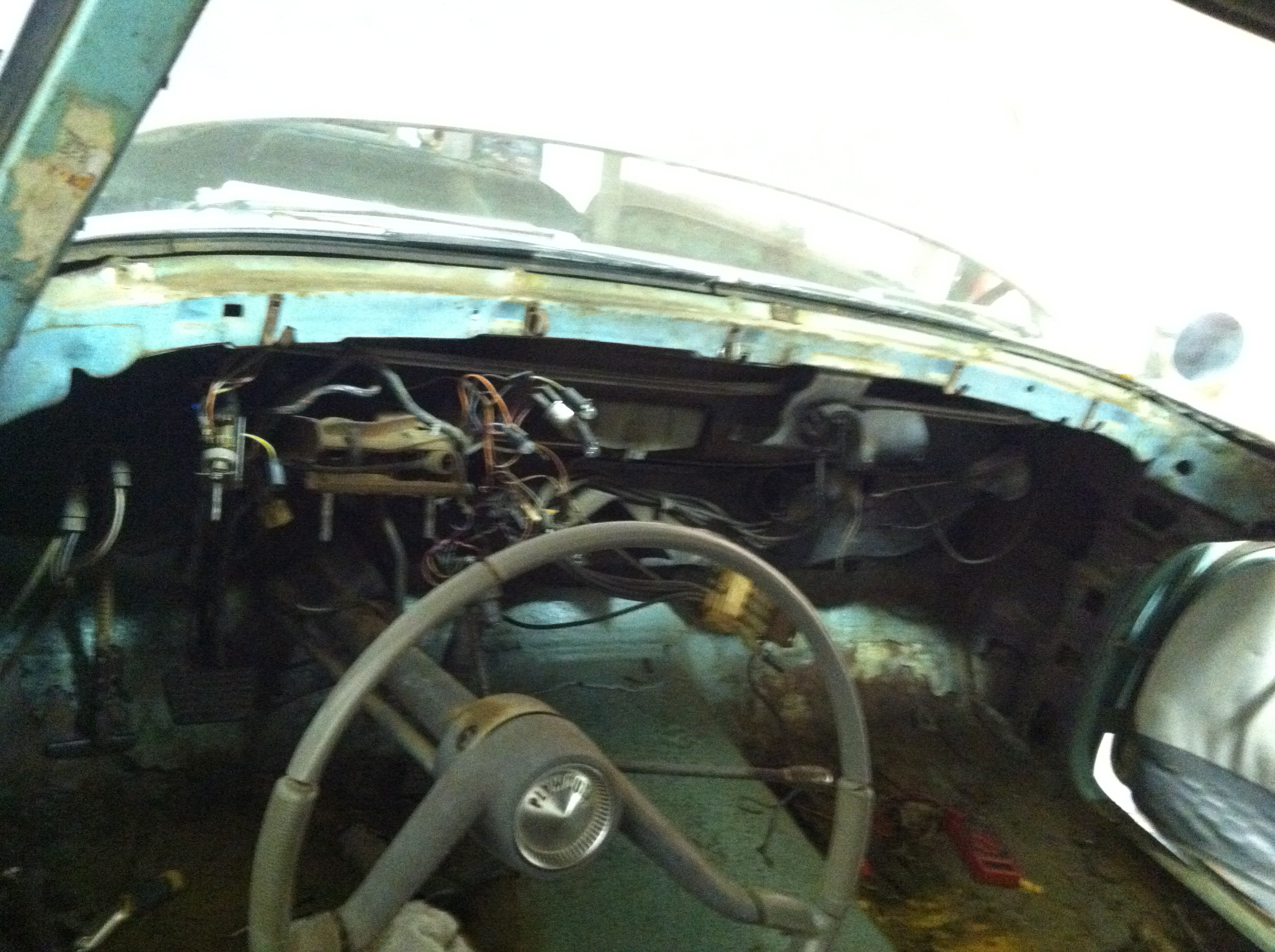

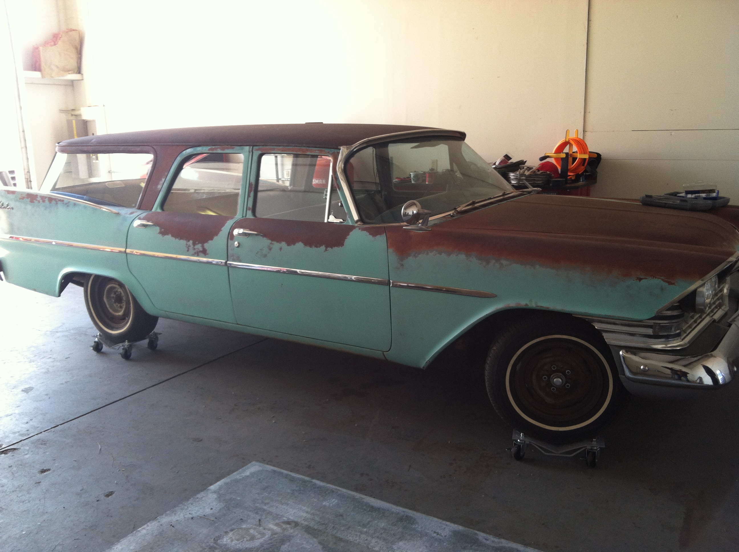

OK so here is where im at:
It became apparrent that the electircal would need to be completely redone due to the heat the burb was exposed for all those years. So interior came out to get redone, then the rust floor got cut out, then the dash was removed, then the front clip and as soon as my cherry picker starts working again the engine and tranny are coming out. I have a new wiring harness (painless) and have to figure out what to do with the heating defrost. The years destroyed the plastic buttons for the heater control and all the vacume hoses for the heater vents etc. Considering getting something from vintage air for combo heater defrost etc. Going to get the tranny and the eleectric overdrive unit out and to the one shop in town where someone alive has worked on them in the past. Having Gary Palovich in Santee Ca help me withthe 318 but have to wait for the tax man to get his cut before I can get going on that. Headed down toe see John (Big M) in Williams Ca next week to get a not rusted out inner fender and a few other things.
Lots to keep me going. More pics on the way. The site wont accept my photos from my camera as they are a little too big so will get some iphone pics downloaded. Any suggestions would be greatly appreciated

Love it, keep us updated with photos!!!!!!!!
